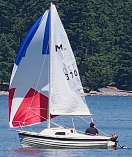

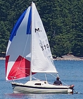

Montgomery has not been mentioned. They make a 15
Big :plus::):beer:
for the Montgomery 15. It is a true Pocket Cruiser. Took me all over the Pacific NW for 19 years.
Then I fell in love with a new mistress and she found a new home.
A great boat design.

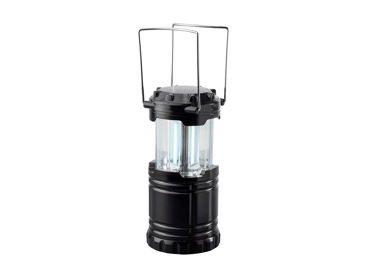

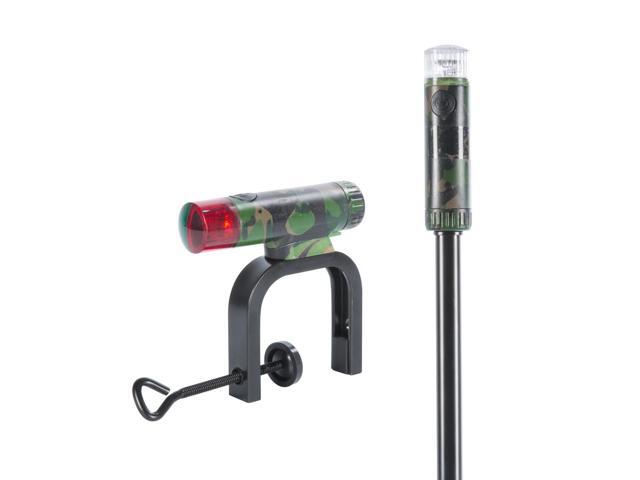

So most of us don't do a lot of night sailing on our boats but we still set up the boat as if it will be sailed 24/7. So all of that work and material needed to set up nav. lights, steaming lights and anchor lights sits unused for 99.9% of the lifetime of the infrastructure. When you start thinking about redoing the electric, you might want to buck conventional wisdom and NOT rewire the boat but instead go with something like this for the navigation lights...
hang something like this from your boom for an anchor light...
and use a few well placed puck lights for the cabin lights...
You can do the entire job for under $40 and it will take you 5 min. to hang the puck lights.
Put the nav. and anchor lights in waterproof box with spare batteries and tick that off of your to-do list.
