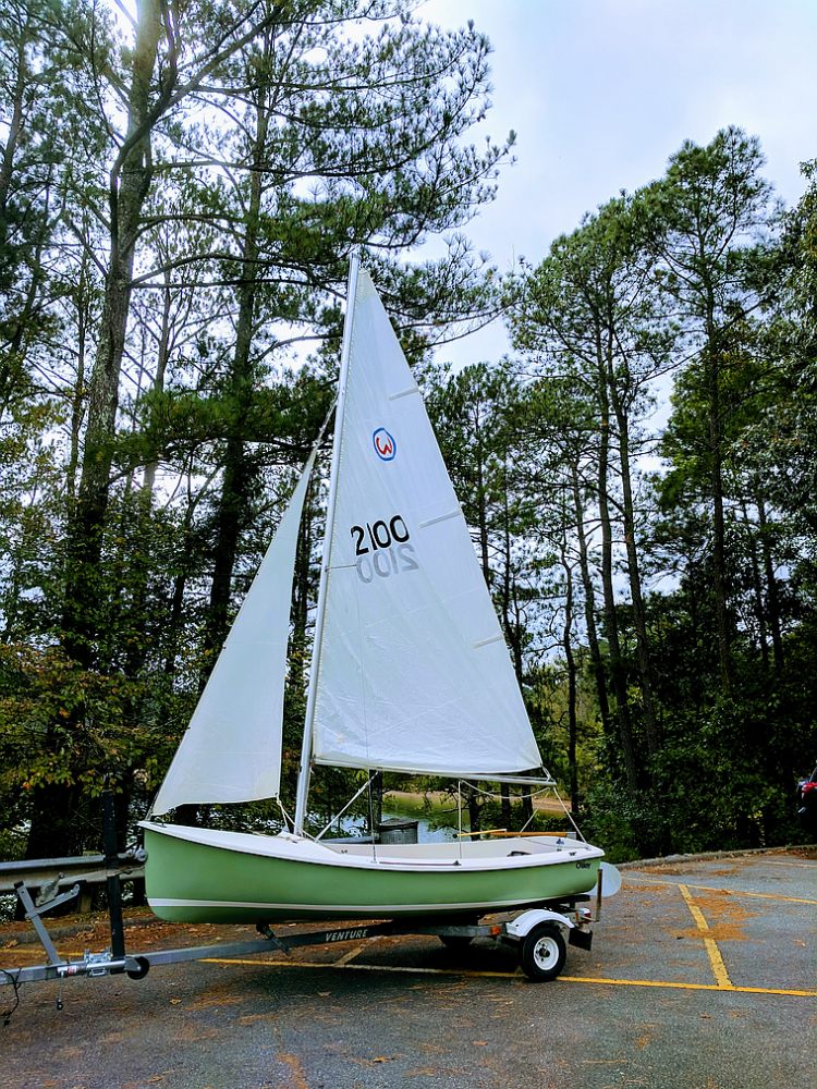

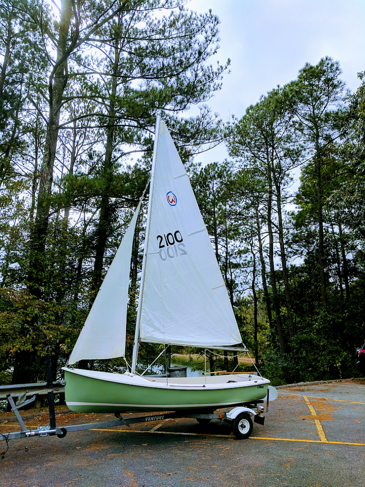

You had a FWD minivan? If so, that's inspiring. I've been towing my little Widgeon with no problems up ramps, but after reading some stories, I see where I could get into trouble with more weight back there.
I think 2WD pickups have it the worst though on ramps - no weight in the back (although, "live ballast" in the bed works to help with traction).

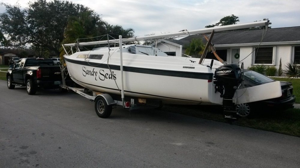

The Ebay one is interesting, I'd go max $1500 and probably take the motor for $2,000 if it looked and ran ok. I'd plan on new sails so budget $2-3k. He says he paid $3k for that 20 hp motor so it was used, That seems like a big motor to me so consider that too, in my lake area I think I could flip that motor for $3k.
He says he has the original receipt, and "paid new" $3300 for it. I wouldn't know what they cost new, so don't know if that's realistic or not. (Actually, just checked, and they're $3k at Worst Marine, 15" shaft, so probably more for L or XL shaft)
I agree, that 20hp is oversized for the boat.
Does anyone else think the trailer looks undersized? I know the boat doesn't weight but 1600lbs, but I'd guess the tongue weight is next to nothing with so much boat (and outboard) behind the axle. Remember, no solid ballast, so that's not a weighted keel sitting on the trailer frame.
IF I was to win that auction (a big "IF"), I'd probably spend a few days down there and trade up to a properly sized trailer, maybe even new. It's 10 hrs, 600 miles to get back home. I don't like risking things when towing.

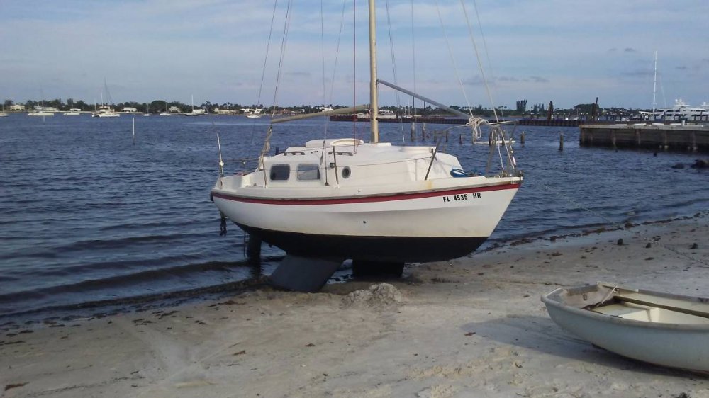

I think I'd be more apt to pick this up in Miami/Ft. Lauderdale than that MacGregor:
https://miami.craigslist.org/pbc/boa/d/1970-westerly-pageant-23-6hp/6636690475.html
Not too much fun to rig and launch, but that'd be a "moored for the season" (or... forever) type boat for us. I like the fact that she could go anywhere! Built like a brick. I could see spending a few days/weeks at the coast in something like that, then trailering it back home until our next hoo-rah.
Some people trailer their Westerly Centaurs (bigger sister at 26' LOA) on a flatbed trailer (backwards!), and crane on/off. For this purchase, I could rent a trailer, and a truck, and tote her back to my lake.
If it had a trailer, I might have already left to go see it. Good excuse for a road trip at least.

Trailer is not right. I think it could damage the boat if traveling that far.
Research trailers firts, they are not usually available and are custom made for a boat.
:plus:
More to the point... that trailer is WRONG!

Regarding the pictured trailer above with the name Sandy Seas, two problems with the first is the unlawful overhang which in many states is illegal warranting a ticket. Then the damage to the hull from oil canning with damage to the ribs/stringers/ bulkheads.

That actually looks like a jetski trailer to me.

That actually looks like a jetski trailer to me....
I also thought the trailer looked really short in the picture above but then looked at the listing and ...
... in a front view there it looked to be about the same length as the original Mac trailer. Since we tow long distance I added a second axle with brakes. Also lengthened the trailer and added a third bunk to ours since we tow with a lot of weight in the boat.
The S is about 1650-1800 lbs. dead empty (has 1200 lbs. of water ballast) and for most people the combined weight of the trailer and boat with reasonable items in it is probably 2800 to 3100 lbs.. It does launch easily in shallow water and the ...
... aft berth is huge which can be a benefit for more than two people. With the 16"-18" draft you can easily beach it with the swing (no weight) centerboard and rudder that kicks up and go places a lot of sailboats won't go. Love ours,
