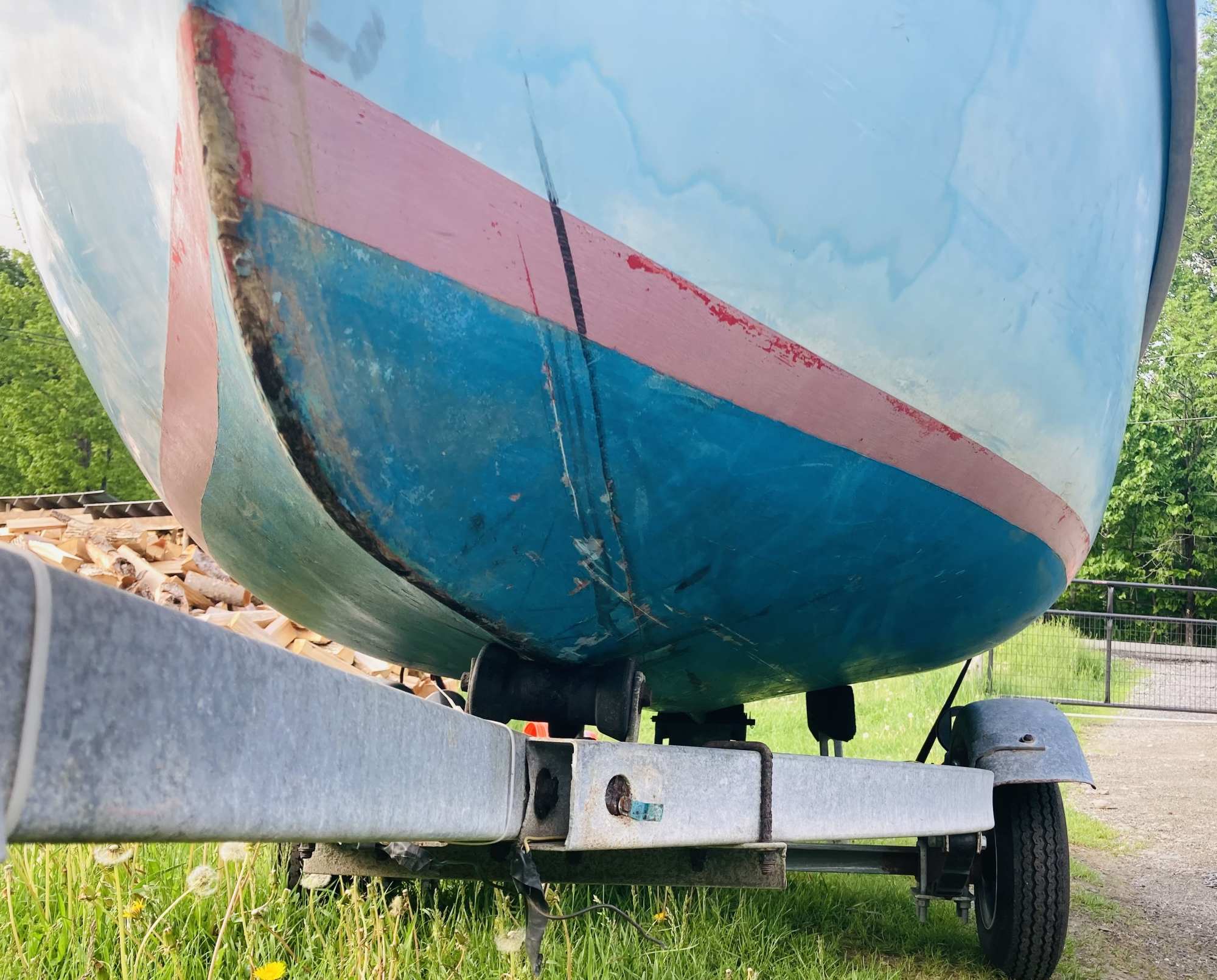

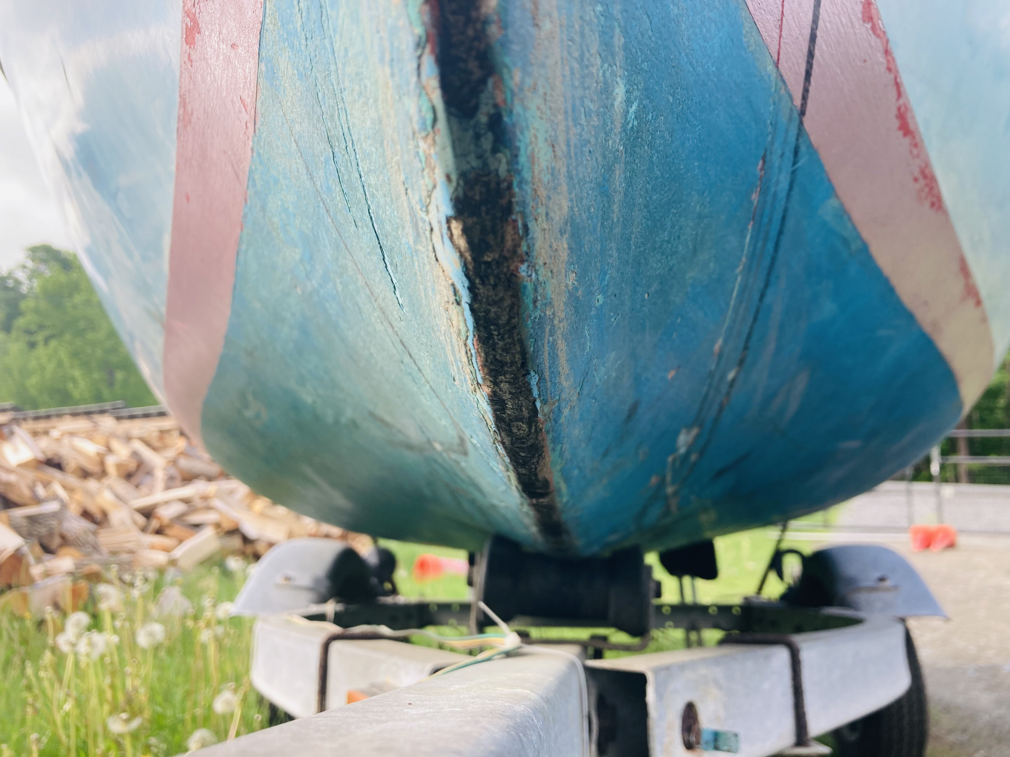

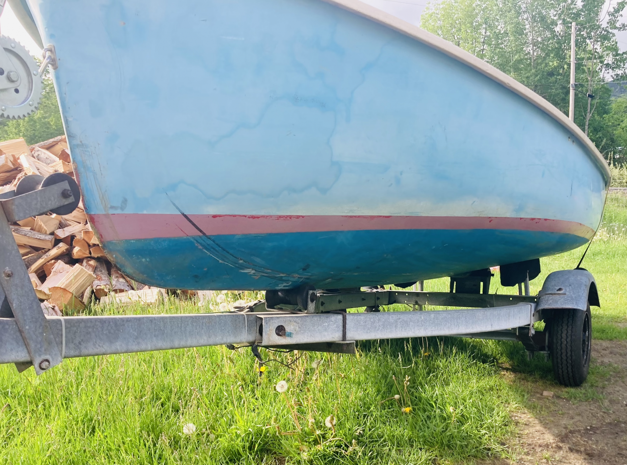

Hello all!
I bought a O'Day Widgeon this spring, and have used it roughly 7 times now on three different lakes. My latest time out was on the biggest lake yet for me (Lake Sunapee, NH) and the wind was 10 knots with up to 25 knot gusts.
Now my question is, can you plane in a Widgeon? I think the hull is a semi-planing hull but i'm not sure. Could you all take a look at the attached photos?
Thanks in advance!
Edit: FYI, I didn't manage to plain on my last time out, although I tried to by moving slightly aft and running on a broad reach when a gust would hit.

Probably. You would probably need to fly the spinnaker in order to get enough power to put the boat on a plane. Weight and balance will also be a factor. Don't be surprised if you end up capsized as you learn. Practice just surfing waves on the lake.

At 180 lbs and a SA/Disp ration of 45.2, with a strong wind and a crazy crew you could probably get the boat to plane while sailing on a broad reach. You might find that control will get a bit squirrelly due to small rudder, but that would be some of the fun trying to push the boat to the MAX....
The boat is an older design and likely the hull was over built. If you want to plane at lower wind speeds you would need to lighten the boat as much as possible. A new carbon fiber mast for one. Perhpas new center board and rudder. In order to hold the bot down in a breeze you might add a trapeze for the crew.

Yes, it will plane, without a spinnaker.
It hums like crazy when it does.

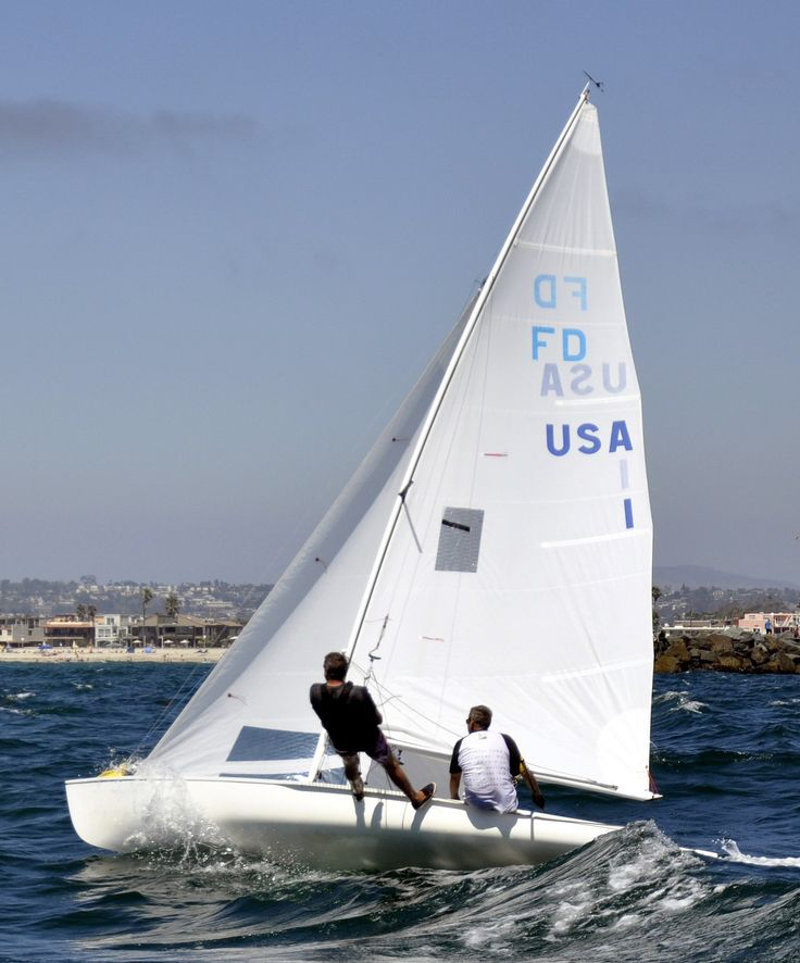

If you "Have the Need for Speed", you will find one like in the video will be faster than possible with the Widgeon. THey are just made differently. Different materials, shape, systems.
In my youth I raced FD's (Flying Dutchman) off the San Diego coast.
They were a lot of fun. It was not as fast as the dinghy in the video but they were plenty of fun. You can see the hull in this image is very flat where the helmsman is sitting asl the way to the stern. These boats were built to plane.
