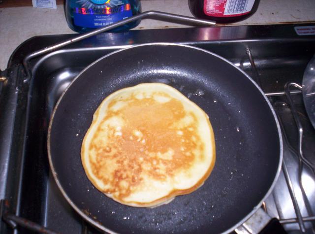

Hmmm, pancakes on a Cookmate 4200 pressure-less alcohol stove. Now that's excellent temperature control. I made a big batch (shake and pour) so I'll try the rest for sandwiches.
