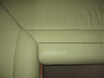

There's been a lot of upgrades to the interior.
  • New salon cushions in celery colored Ultraleather. When we did the upgrade we made the port setee wider (the line on the photo shows where the original cushion ended. It makes it a lot more comfortable to curl up with a book. The firm high density foam doesn't bottom out like the original cushions. We picked the color a couple of years ago, now all of a sudden it's the "in" color. Who'd a thunk it!

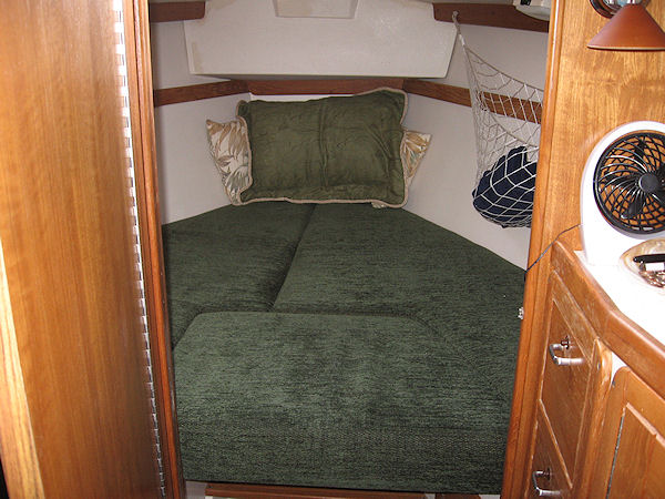

  • For the berths we went with a darker colored material over medium density cushions. The darker color creates an optical illusion that the cabin is larger.
  • We picked up two Froli kits at the boat show last fall that are supposed to make sleeping even more comfortable.

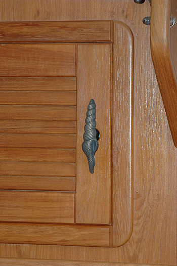

  • We added a lot of small touches, like custom door pulls for cabinets and decorations.

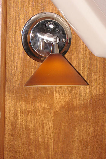

  • All the original lights have been replaced. Most are Imtra and all the bulbs are LED.
  • We picked up some really bright Imtra galley lights for above the stove at the winter boat show. You really need good lighting for cooking and washing up after dinner.

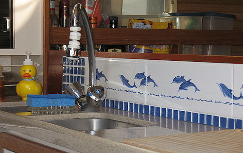

  • I added a new backsplash to protect those cushions. It's solid cherry and I had some hand glazed dolphin tiles made up that I inset into the wood and surrounded by blue glass tiles.

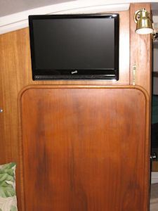

  • I added a 12v TV/DVD combo mounted on the bulkhead.

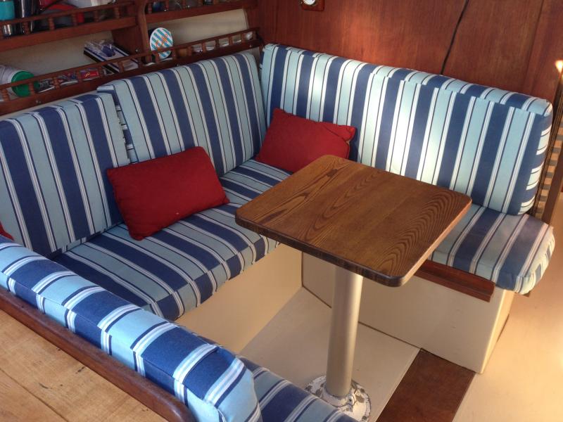

Finally doing an upgrade, up to this point I've just been replacing broken and/or worn out "stuff". New insert that will go over the electrical panel. Will also have a cigarette lighter and 2 USB outlets along with a goose neck light.

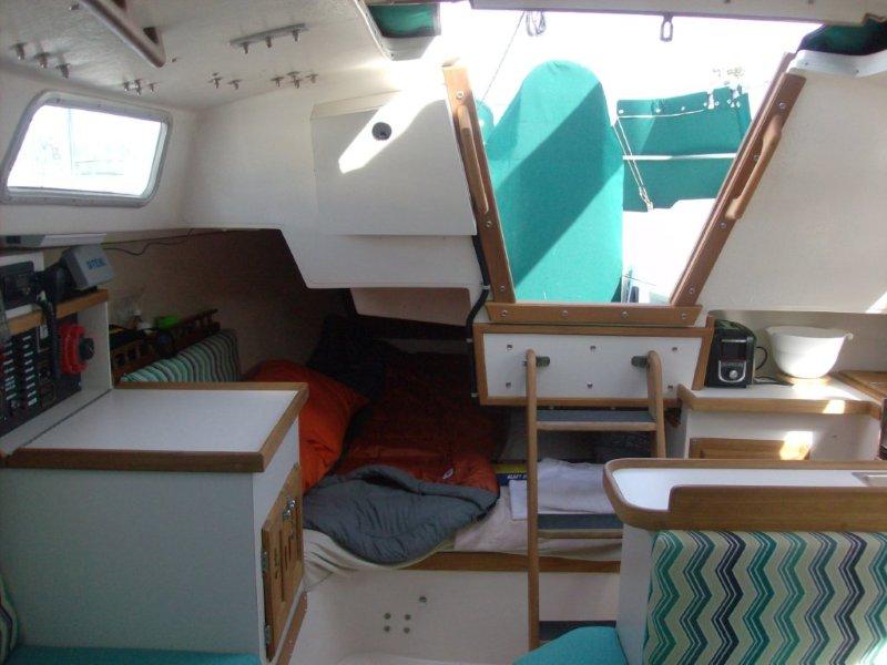

Made new chart table cabinet and laminated inside of top/storage area. Made cabinet to cover the backside of the gauges on the bulkhead. New Peninsula cabinet and all new counter tops. I reused all the teak, and I prefer Semco natural teak sealer on my teak. Hence the lighter color of the teak. The other thing I did was where the steps connect to the bulkhead. Covering the surface with for Formica® brand color was Pearl white. I used very thin felt pads at the top where it meets the Formica and also on the bottom of the steps these were a little thicker felt pads. Also made a box to hold VHF radio on top of battery switch and breaker panel.
To remake these two cabinets and counter tops and laminate other items was fairly inexpensive to do, mostly just labor. To remake you cabinets all you need is a router to trace out the old pieces on new material such as Formica and MDO Plywood.

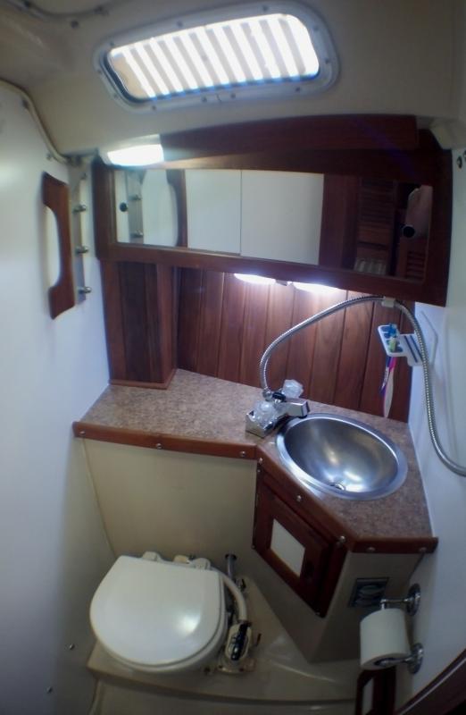

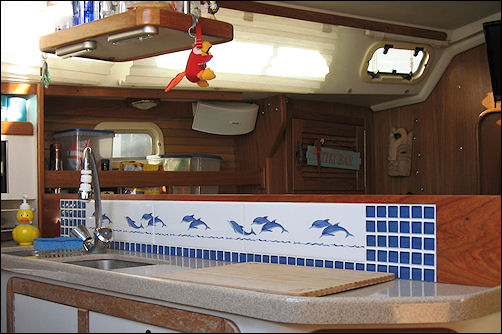

5) Replaced head formica counter, built backsplash and A/C raceway from tongue and groove teak. (Raceway hides ductwork going thru dinette bulkhead on port side. A/C project to be completed after haulout this year.

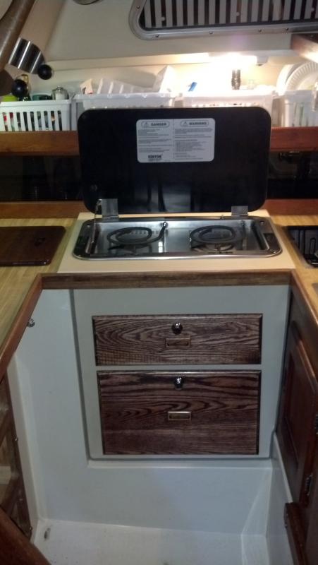

11) Removed old pressurized alcohol range. Built 2 large drawers in a 3/4" Sand Colored Starboard front panel. Found an almost new KENYON combination electric/unpressurized alcohol cooktop for $100 on EBay. See photos. Used pushbutton drawer locks to prevent the drawers from opening during heeling.

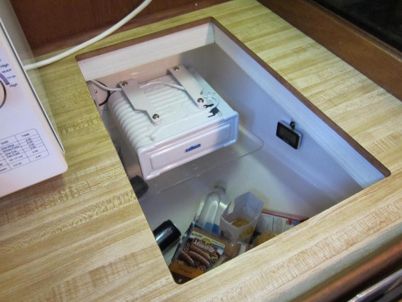

14) IsoTherm ice box conversion with freezer section (I can MAKE ICE!!!)
IsoTherm 110v switchover unit to allow refrigerator to bypass the battery bank and use shore power whenever in the marina. (mounted in the Nav station cabinet.)

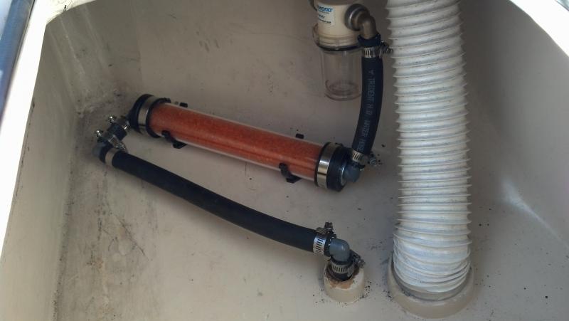

17) Fuel vent line desiccator cartridge and strainer. Strainer catches a surprising amount of rouge splashes into the vent inlet, which is mounted too low on the hull IMO. Just unscrew the strainer bowl and dump the water. Desiccator crystals in 12" long a 2" wide clear tube remove all water vapor. If you don't protect the vent line, this water and vapor winds up in your fuel, a wonderful environment for all kinds of microbial goo to ruin your fuel system. Crystals are orange when dry.... when they turn green they are water-saturated. You recharge them by putting them onto a pie tin in your oven at 175 degrees until the water is driven off, and they are once again orange.

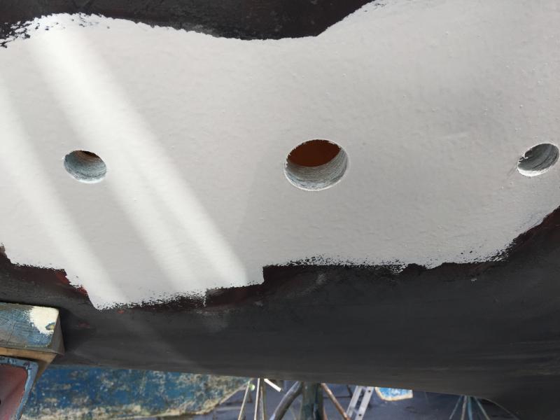

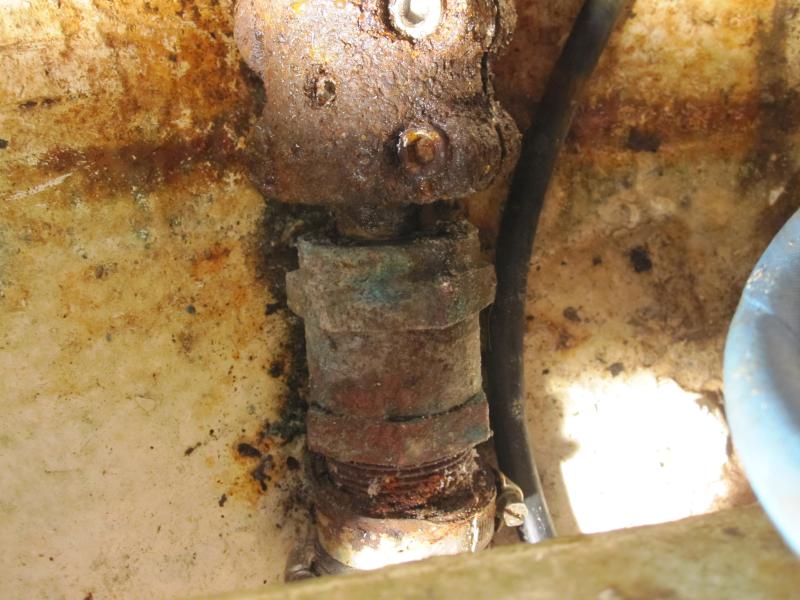

It has been a while since I checked out this thread, but I wanted to say again - thanks to all who posted. You have both inspired and informed :)
Since obtaining my boat (from a close friend) 2 years back - boy, time flies - I have slowly chipped away at the jobs on her, trying to hit the safety items first and cosmetic items second. Wasn't always successful, but I feel like I can finally share a little of my work.

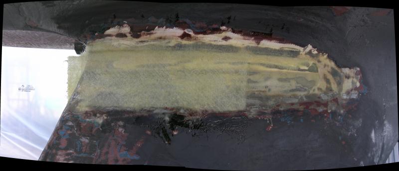

Year one haul-out I tried to get the majority of the old bottom paint off so that there was a smooth surface to work from. It was VERY orange peel looking with all the layers. "Most" of the old paint was removed, and I now work on the remaining bits each time she comes out. By 2016 I'll have it all smooth. It is amazing how much the old paint weighs when I clean up the ground after scraping.
I repaired the classic Hull-Keel joint separation with West System G/Flex epoxy.
I also replaced the prop shaft, the engine coupler and put in a PSS. Like many of you I just couldn't STAND a wet bilge. (Plywood core issue aside.)
Next was all of the accessible wiring. The boat got a complete redo on everything possible. I will attach a copy of my wiring diagram. Everything was made as large as possible and I put on solar, added Golf Cart batts, put in a monitor, did the 1-2-All switch update and converted to LEDs.
That was enough of a bleed to the wallet for one year. Couple of grand easily.
Year two (right now) my list was even longer.

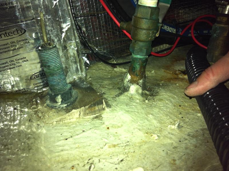

1. Pot (epoxy) all of the deck fittings and replace hardware using butyl. MANY holes were leaking.
2. Replace lifelines with uncoated 3/16" wire and replace all hardware
3. Re-weld all the stanchion bases as some had hairline stress fractures
3b. Make aluminum backing plates for stanchions
4. Paint bootstripe/covestripe with Polyurethane
5. Test drill the bilge plywood. Then reseal and apply gelcoat
6. Install stainless keel bolt bars to extend life of plywood core
7. Replace Bowmar saloon hatch glass
8. Inspect and service all steering chain and cables
9. Check all wiring for corrosion, heat issues, or abrasion.
10. Remove and glass over all old transducers (2)
11. Move the location of the forward sink foot pump to behind bulkhead.
12. Install true seacocks
13. Head sink and Galley sink – add soap dispensers
14. Rebuild the winches
15. Repair the UV strip on genoa

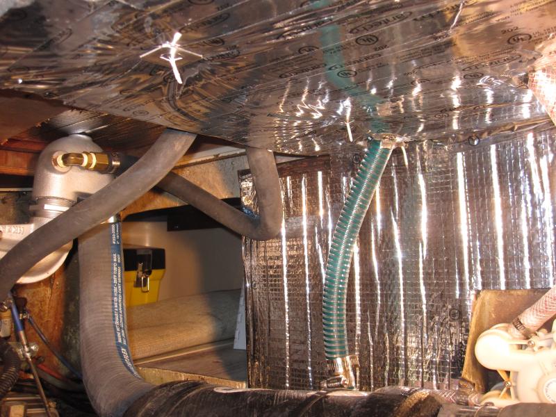

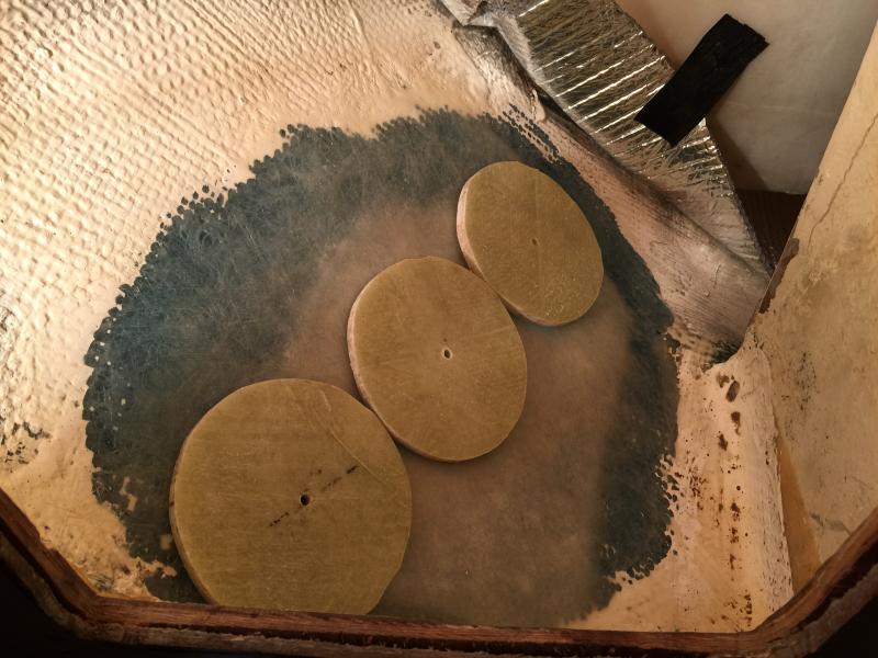

16. Install reflective hull insulation in all lockers
17. Install new Campbell Sailer Prop
18. Remove and try repair of hour meter on digital Tachometer (in the end - repair not recommended)
19. Check inside the mast for water – It had some. Drilled a small hole at base for drainage.
20. Remove, inspect and clean and the engine exhaust elbow (3YM20)
21. Replace all engine fluids
22. Add a gate valve in the primary water tank main feed to tap - stop water flowing out sink when heeled over.
23. Pettit Captain's Satin Varnish on the galley wood. Exterior varnish refresh on all outside wood
24. Forward water tank – clean out and add access port.
25. Replace stuffing in rudder shaft
26. Replace diesel filler cap O-ring, replace water tank O-rings.
The attached photos are all of the jobs, rather than of the boat. I really need to put all the cushions back and get some good interior shots.
BTW - I mentioned adding a Campbell Sailer prop. This was an upgrade from a Michigan prop previously and when I tested it out this week the boat went from max 4.5kts under the Michigan to over 6kts with the Campbell.
