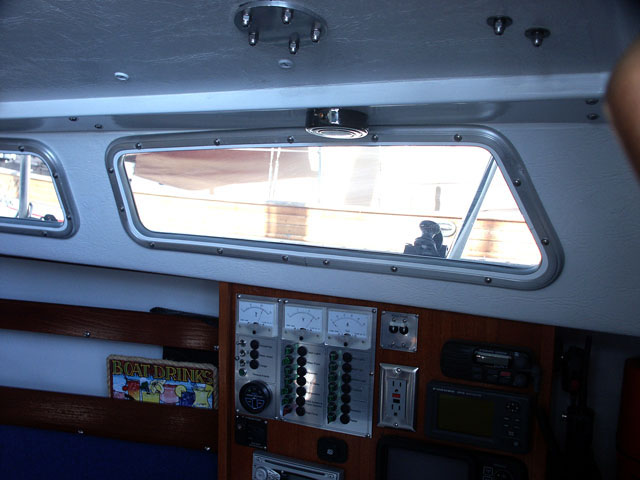

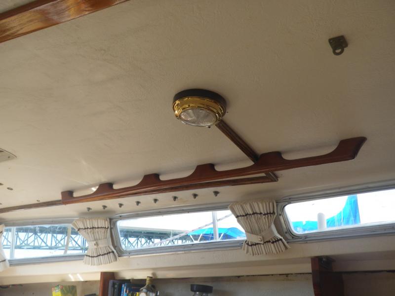

Elysium mentioned LED lighting.
When I bought the boat, all of the original lighting was shot. The lights in the fore and pilot berths actually had water in them...
There is no way to fish new wiring through the head liner, so created some pine wooden runners that I screwed to the headliner to run new wiring to. And then capped them with a thin piece of wooden overlay. I mounted LED cabin lights over the table and galley on 1/2" think wooden disks of pine that I stained. I also stained the runners.
In retrospect, I like Old Skool's set up. It looks like some type of white composite attached to the headliner just about the windows, I would assume with low profile LED lighting installed.
I also installed amber LED strips under the headliner near where the topsides meet the hull, which is hidden from view. I bought 6-8 12" LED strips on Ebay for about $3 a piece. I 5200'd them to so scraps of wood and screwed those in place. They create a very nice low level lighting at night.
Here are some pictures of my cabin lighting. The channel is a custom fiberglass/wood sandwich lamination painted to match the headliner. The fixtures are ebay specials - @$5 - as pictured they have high consumption halogen lamps but about 6 months ago I changed the lamps to L.E.D. wafer style.
