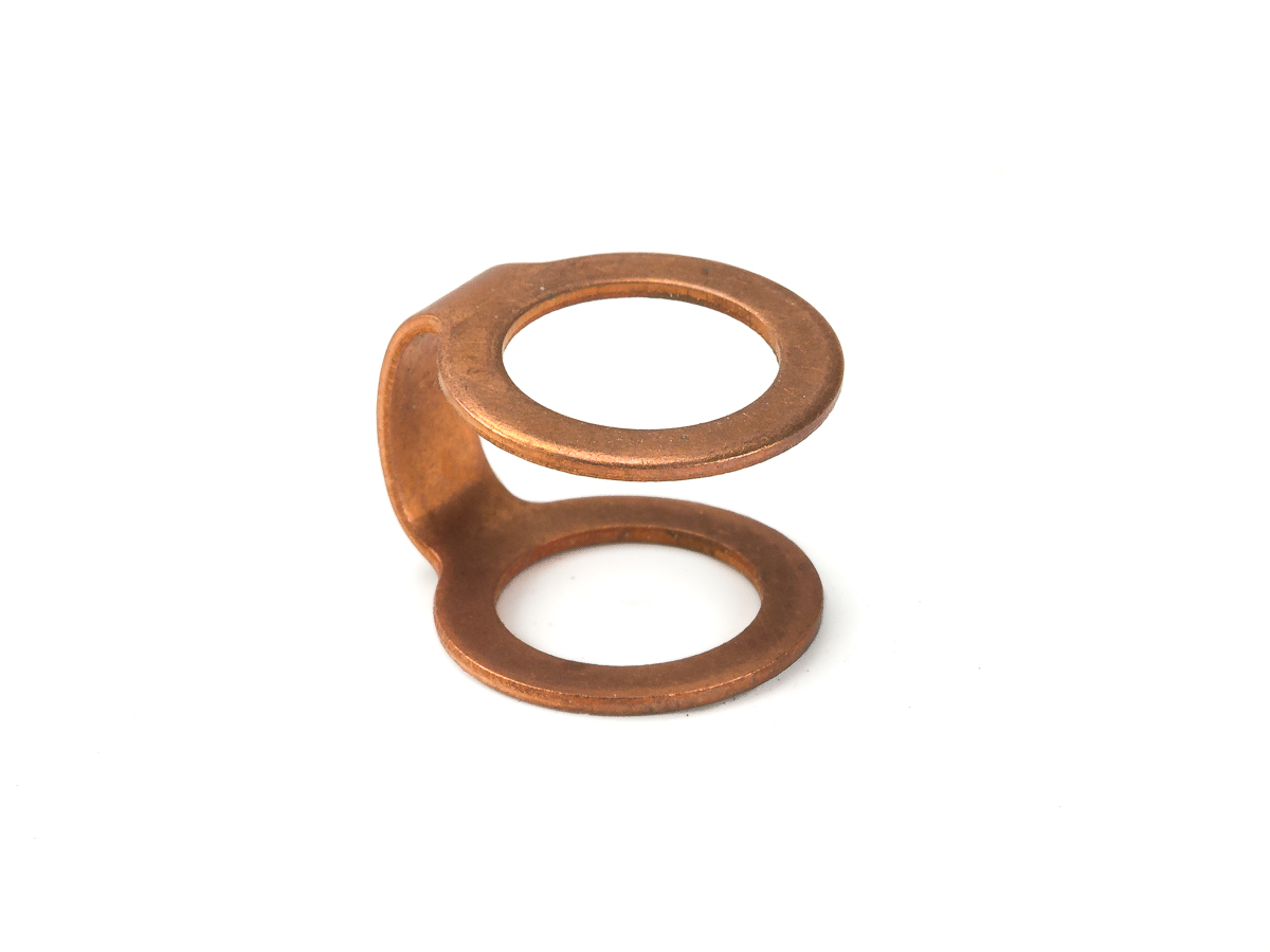

Copper washers with rubber strips are strictly a Yanmar product. Only about a dollar or so a few years back. Cheapest thing I've ever bought from the Yanmar dealer.
Hmm, my local yanmar dealer, toadmarine, and torresen don't supply those.

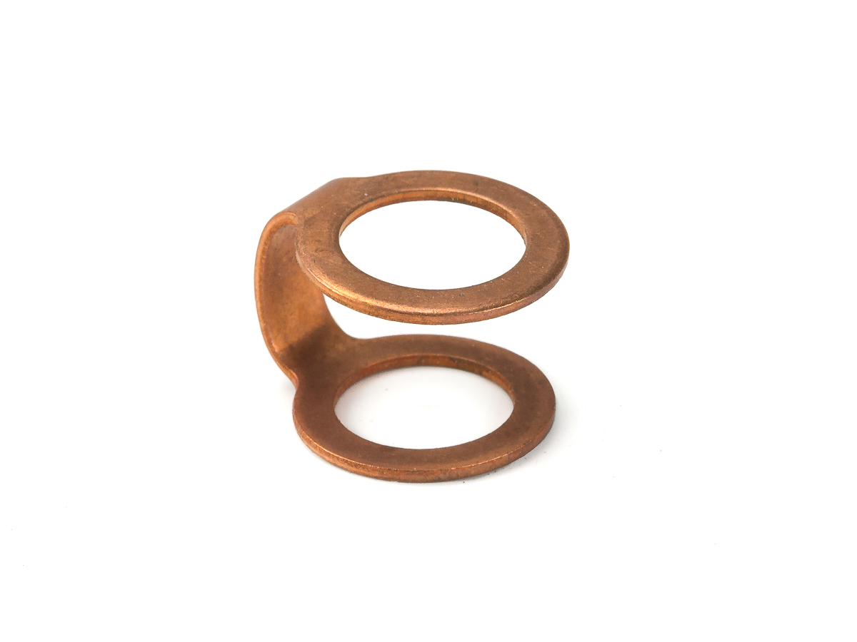

23,804
I was finding it a challenge to get the 2 copper crush washers to center over the banjo fitting. Then my Injector specialist included a few of these in the box with my newly serviced injectors.
Problem solved.
The copper seals that Ralph is referring to are called Dowty Seals. Yanmar uses them on their newer diesels. The part numbers are 22190-120002 for the larger ones and 22190- 080002 for the smaller ones.

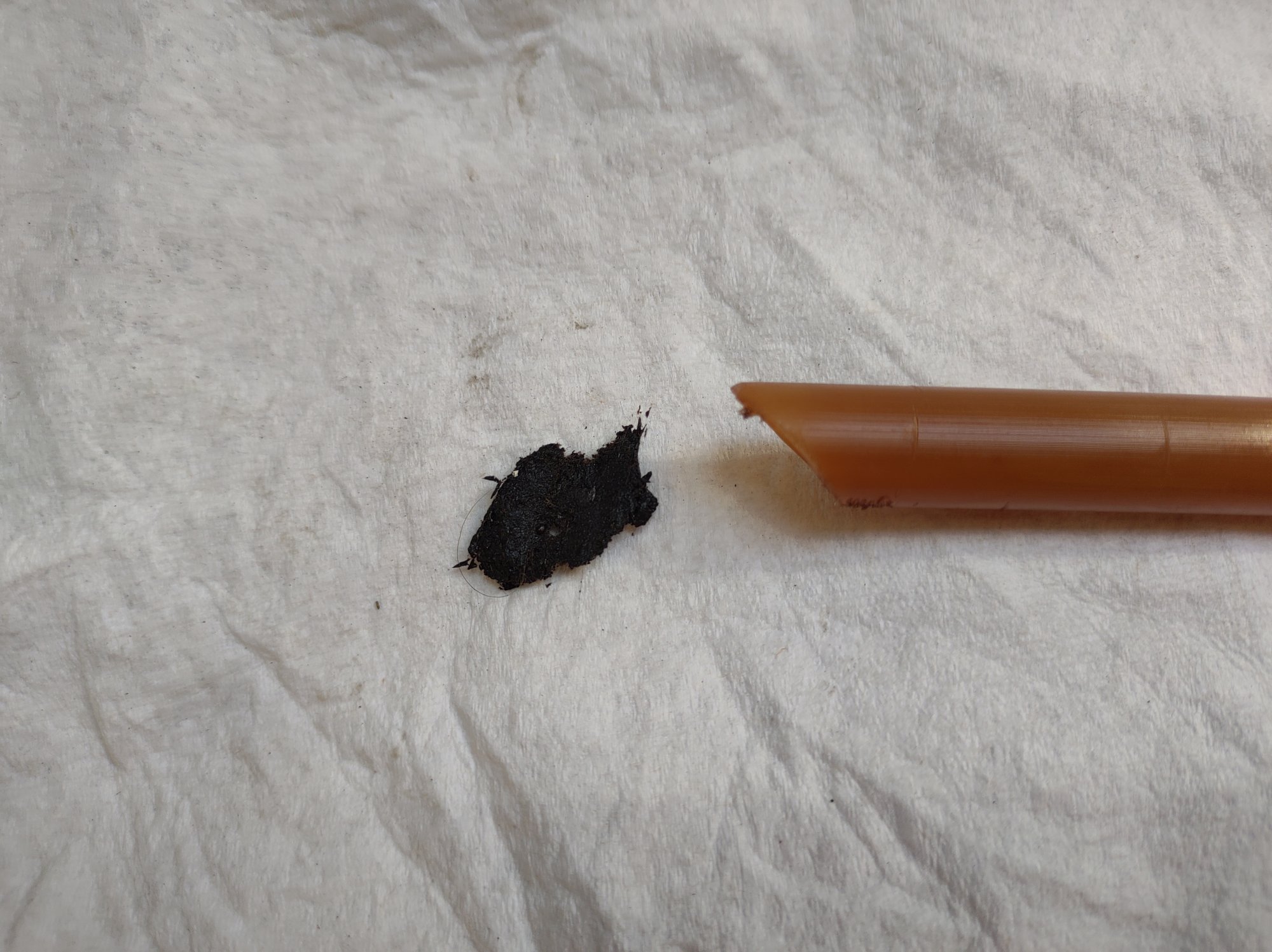

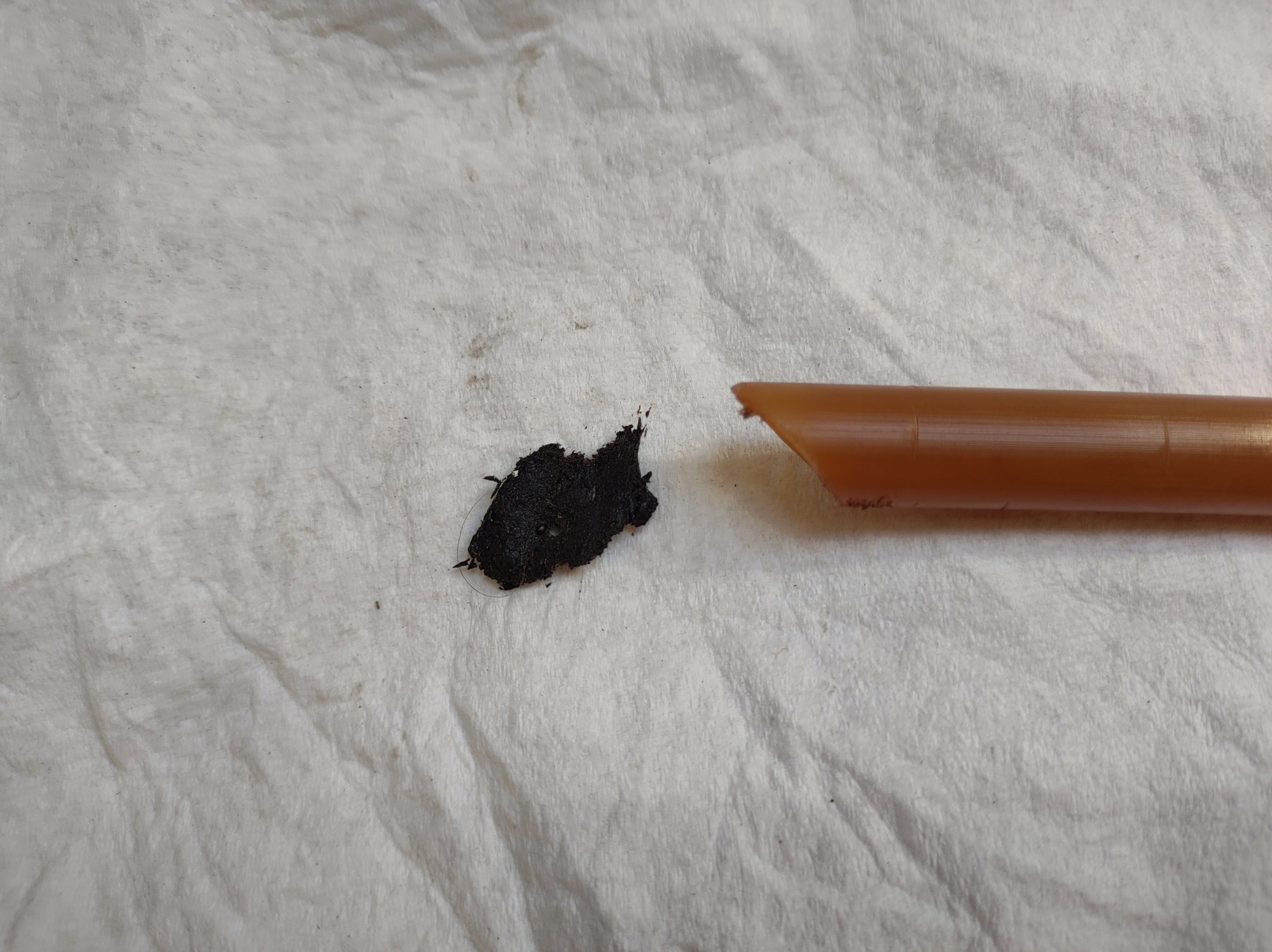

I was surprised to find zero debris except for one piece of what appeared to be a fibrous gasketing material that was a little larger than a quarter in the bottom of the tank. I ran a thin wire in the tank to pierce the material and take it out. This piece is a little larger than the original pick-up tube as shown in the photo, and I could image it could easily clog the tube. I have no idea where this is from, maybe it was in there for years.
Afterwards, I reattached all the fittings and put about ten gallons of fuel in the tank. I ran the engine at various speeds under load for over an hour and fifteen minutes with no issues.
I can’t thank everyone enough for your help. Hopefully I'm in the clear now.
I have submitted this information to "Ripley's Believe it or Don't" and they replied "horse biscuits."
What are the chances of that piece of gasket sitting partly inside the pickup tube and then periodically fully plugging the tube ? 1 in 1/0 maybe. Time to get out and buy a lottery ticket.
