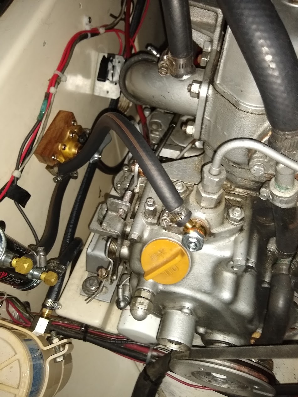

Actually, it's not too hard to do at all, with a few plumbing bits.
Just get the appropriately-sized banjo fittings that have a barb on the end, and run a short piece of fuel hose between the output of your lift pump and the input of the high pressure pump.
Here's a picture of what it looks like on my engine. As I mentioned, I bypassed my on-engine filter entirely, and run directly from the electric pump to the high pressure pump. I rely on the huge Racor 500 for all of my filtering needs. That filter always seems to stay clean, by the way, but I change it every year or so "just because."
By the way: The diverter valve shown in the photo allows me to divert the flow from the electric pump to the injector return line, which runs straight to the tank. This makes priming the large Racor really easy when doing filter changes. It could also be used for fuel polishing, I suppose.
