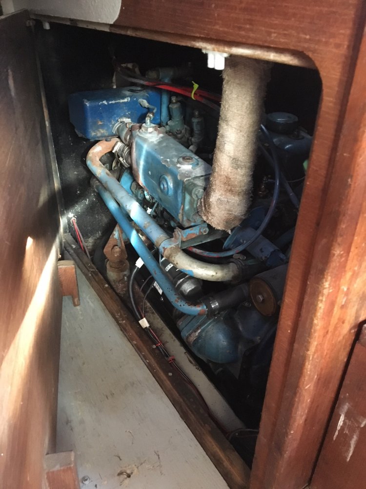

Old Blue.. is too mundane. Engines do present a personality at times. This one has a lot of space around it but was put in backwards. The engineers conveniently located the serviceable parts on all 4 sides of the engine as if it was designed by 4 separate guys from the 4 corners of the planet. Then the boat builder, being a bit of a minimalist stuck bulk heads on both ends in places to stringent the boat but to make servicing the motor impossible. Perhaps he thought “It’s a sailboat the owner will never need that stink pot motor but will put it in there and jack up the price of the boat. Then when he tries to use it and it stops running we’ll sell him parts for it that he can never install at absorbent prices. It is just the thing that keeps on giving. Maybe we can all retire and go sailing.”
Perhaps a picture of the beastie... Granted I caught her bad side, it’s early here, and she is just getting up.
