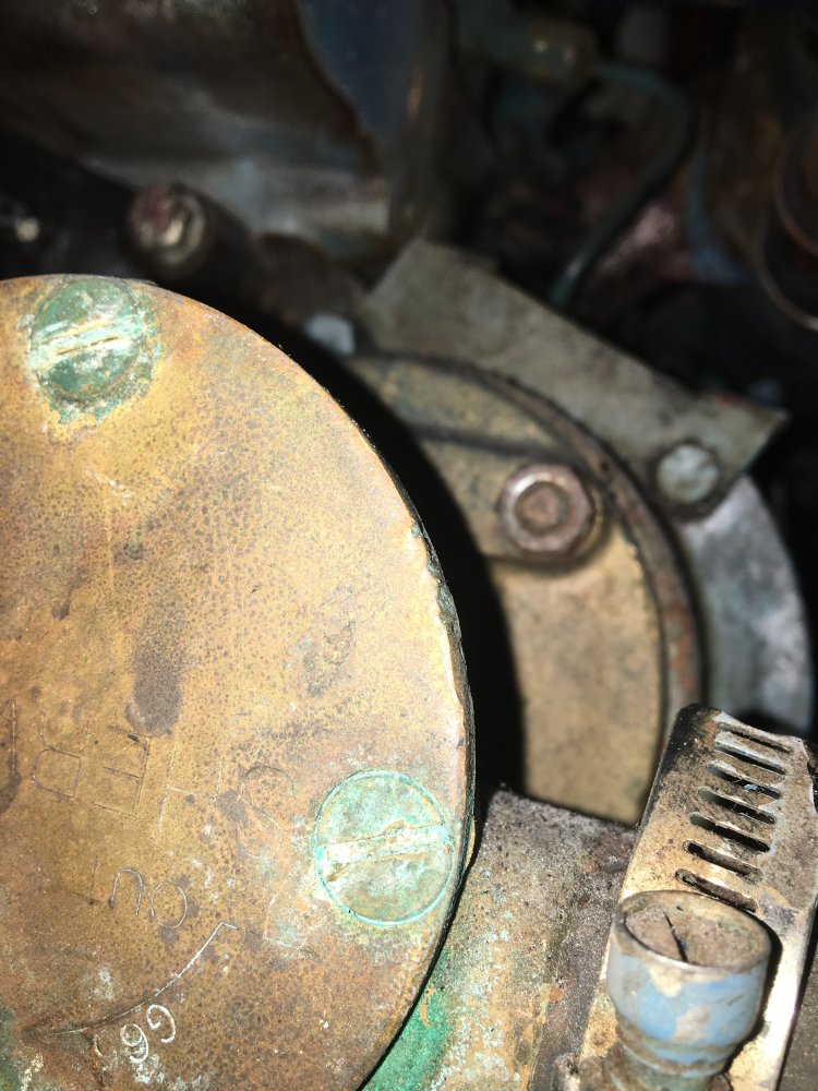

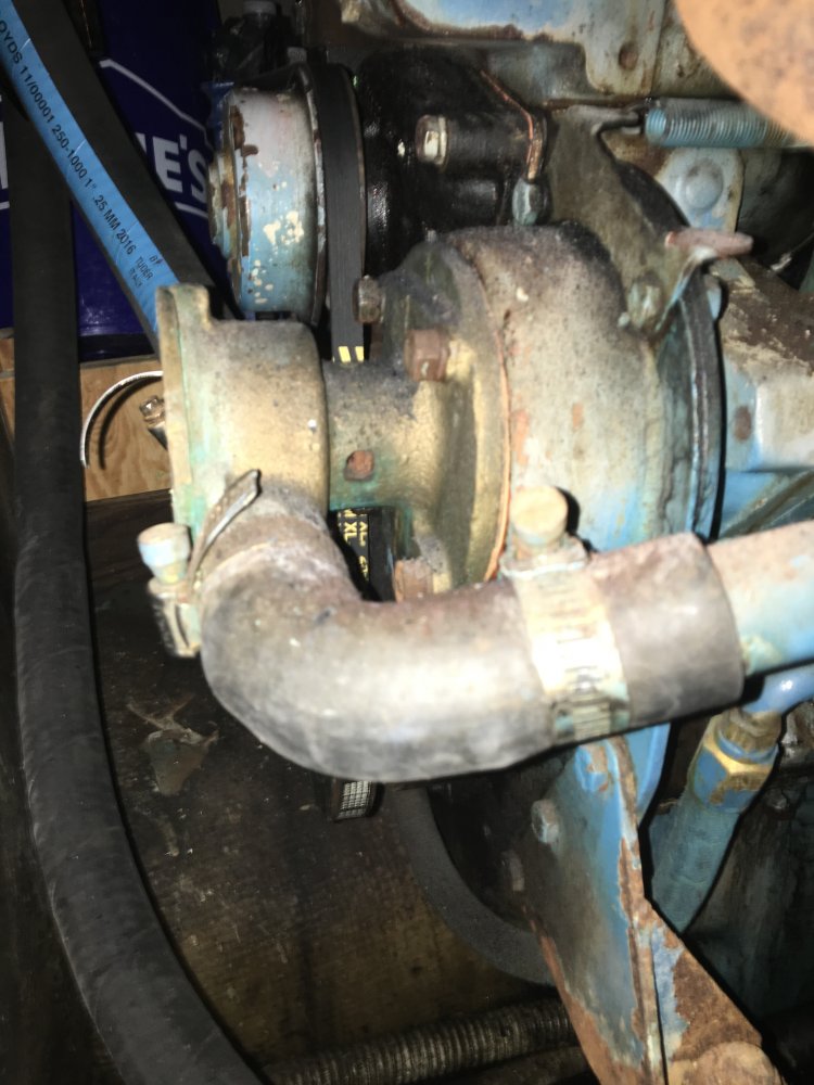

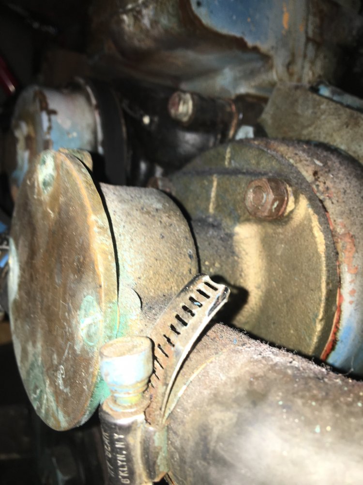

The engineers made the water pump inaccessible on my 1974 boat. I figure it is about time I replace the impeller. I located the raw water pump. Challenge is that the 4 plate screws are inaccessible. The pump is facing the engine bulkhead. It is about 10 inches from the pump.
Here are some pictures. Any one with some ideas I would be greatful in helping me attack the problem.
D5FD48E9-E3F5-4816-B532-00AE04FC880D.jpeg F2C1674A-CC8B-40D2-9F2C-D1316920094A.jpeg A97554F2-189B-46F9-9B4F-4FC4AF8E1F64.jpeg
You can see the 4 screws on the plate in the first photo. I tried to loosen the straight slot screws with a 90 degree screwdriver. No luck. It was slipping in out of the slot. I was wondering what is the pump like. Can I remove the 4 nuts holding the pump to the engine? What will I find? Likely a shaft. Would there be an index point on the shaft. If I remove the whole pump I can then remove and replace the impeller on my work bench.

Its probably just like my 4-108. The shaft that drives the pump has a center raised portion that fits a slot on the pump. You really cant screw it up. You'll need a new gasket to fit between the pump and the mount. Bob
Don't do it!:badbad::badbad::badbad:
Use these to remove the cover plate that has the screws.
First use a penetrating oil.
https://www.lowes.com/pd/3-IN-ONE-4-oz-Penetrant-Drip-Oil/50370416
to help release.
These are a small ratcheting with box end.
https://www.lowes.com/pd/Kobalt-10-Piece-Ratcheting-Hex-Multi-Bit-Screwdriver-Set/1171067
or this
https://www.lowes.com/pd/Stanley-32-Piece-Screwdriver-Bit-Set/1000332301
The gasket is "onion skin" thin and must be used since the cover plate is part of the impeller seal.
Perkins makes a replacement screw with a hex head now.

kroil, blaster, ...... your favorite penetrating oil. everything jim writes is how it is for me too. my 107's pump has total access. so right tool for the job big blade flat screw driver that is a perfect fit for the slots. so it's a 90 degree screw driver or create temp access ports for the screw driver head on. the rubber blades of the impeller are stiff. soapy water is the lube i use to push it in. it's firm to yank the old one and it's firm to get the new impeller pushed in. honestly john, the rubber blades do have a expiration date. every time i change this i am glad i did.
kroil some more.
me, i might cut a big screw driver down and use a crescent wrench on the shaft.
....or dremil tool a hole in the bulkhead then re glass. i build big RC airplanes. i got allot of micro tools that i can open up anything to make ports.
mine boat is fresh water. the pump cover plate end looks new. the screw slots are clean. the switch out of impeller is easy. i'm just saying the switchout is a reasonable project.

Thanks James. I was looking at those tools next. Just tried what I had on hand. It was so tempting to think about dislodging the whole pump. It was the wonder about what was behind door number 2. Thanks.

Yours looks to be the same as our Perkins 4-108. If so ....
... above is what is behind the pump most likely. I replaced the impeller but then the pump was weeping out of the holes on the side behind the front part of the pump indicating the seal on the pump shaft was bad. I pulled the pump and rebuilt it with a kit from here...
https://www.ebay.com/itm/Sherwood-G...ash=item1c48ee4376:g:S6AAAOSwol5Y0Jl-&vxp=mtr
I have a hydraulic press so it was not hard, but it would be without one. Here is a link to someone doing this without a press....
http://www.cruisersforum.com/forums/f54/rebuilding-sherwood-g65-for-perkins-4-108-a-20618.html
If I didn't have a press I'd probably have someone else do it. Mine looked like the one in the link with the bearings rusted. If yours is not weeping water and those holes are open then you probably just need an impeller kit like I got if you have the same pump ...
http://marinepumpdirect.com/sherwoo...bdhngmUI1MT4p_EwAIcBIuH3dJPe6-wRoCzagQAvD_BwE
Good luck with the job and I agree about putting in an access plate. Since our boat sits for long periods between running the engine I replace the impeller every year when we return to the boat. I have a friend that put a rebuilt diesel in his boat and the impeller in the pump was suppose to be new but still disintegrated when they were out and plugged things up. A real mess,
