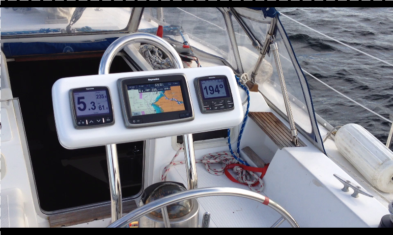

I just recently added a chart plotter, autopilot and MFD and mounted them at the pedestal. All the installation instructions for the electronics all say to mount them 36" away from a magnetic compass but then go on to say that may not always be possible and at a minimum hold 12". To test my location I hooked up the chart plotter before mounting the nav pod on the pedestal guard and held it close to the compass. I couldn't see any compass movement until I got fairly close and found the affect also depended on the orientation of the chart plotter.
I also realized all the cables I needed wouldn't fit in the 1" pedestal guard so I replaced it with the newer 1-1/4" size. They come with some extra length that you are supposed to cut off to get the height you need so I was able to make the installation a bit taller than I could have with my old pedestal guard. That helped increase the distance to the compass. Came out nice, I like having everything at the helm.
