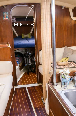

1) When going upwind with wind and waves there is a lot of squeaking, i mean noise between the toilet and aft cabin bulkhead and the fiberglass moulding that hold it at the upper part, below the roof. I have tried to inject oil, grease, lube... still this very annoying noise.
What to do???
I also noticed that the stainless steel pipe that goes from the left side of the sink to the roof also move up and down (at least 1/4") when the boat is sailing upwind in good weather
The pipe is not screwed onto the countertop. (should i screw it?)

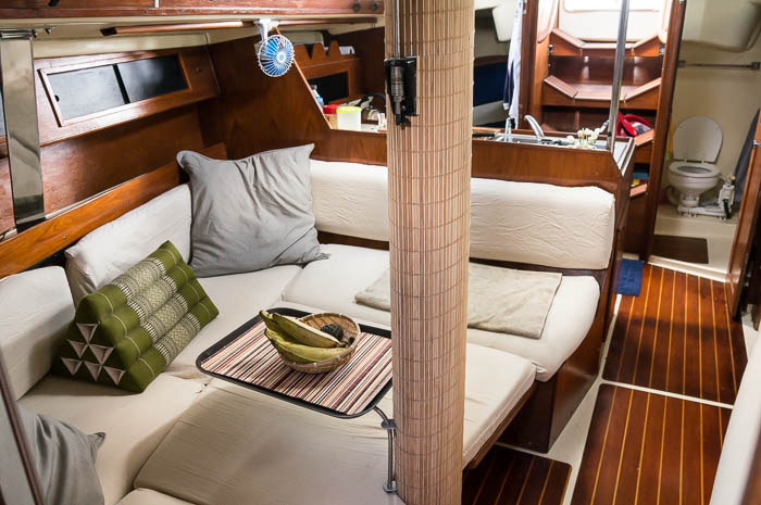

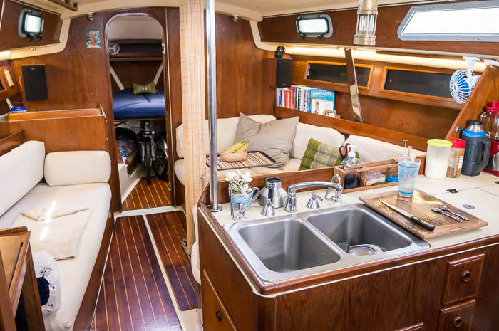

Thanks for your reply. The boat is actually located in St Maarten (West Indies) The pipe i was referring too is located on the kitchen's countertop (see picture)

Oh yes..... I miss understood. That pipe serves as a deck support as well as a conduit for the cable for the centerboard on models that have that. And yes it should to screwed down, but those screws will not provide enough strength. I am wondering.... forward of your mast above the table, is the deck stiffener attached? It attaches to the deck partner and mast to hold things in place. I will take a picture of what I'm talking about and post later.

yes, i think i know what you are talking about. Is it the rod that is just on the fwd side of the mast? see picture below. If so then yes it is attached. actually i have no squeaking there, only on the aft cabin/toilet bulkhead
NYSail
Jan 6, 2006
3,187
Beneteau 423 Mt. Sinai, NY
Yes that's the part. My thought was that if that is off.... or even loose you may get some upward pulling on the cabin top. Above the kitchen is the main sheet traveler.... could this be pulling the deck up? I'm sure yours is like mine and attached to the sea hood. When under sail I use to watch the sea hood flex due to the pulling from the main sail.... I had the sea hood modified and reinforced so this is not an issue any more. Very curious to find out the issue and hope a few other owners chime in on this.
