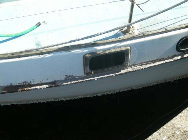

its raining and dismal in "sunny florida" this morning, so the question...The Morgan 33 outisland has a outward flanged hull-to-deck joint. The po removed the rubber rubrail probably due to being chewed up from the dock. I am planning on glassing the joint on the inside for strength and water tightness while i have the bulkheads out. My question is what do i cover the approximately 1 to 1-1/4 inch flange with that will hold up to bumps and scrapes without splitting or rotting. I am not sure if i can even get the original heavy rubber rail and if i could find it it would probably be cost prohibitive. I was thinking about maybe plasteak kind of stuff screwed in from underneath, or wood then some off the shelf rubrail? I even thought of using firemans hose that i would split on the table saw? Any ideas would be greatly appreciated, thanks. Patrick

Looks like a teak rub rail to me....
Usually these we're edged with stainless bar stock. You could use 1/2" braided line held on with stainless staples along the outside edge, like they used to on old dinghys.

hull to deck joint isn't "outward flanged"
what I see in the picture is a flush hull/deck joint and an external wood rub rail. As the fix is different, which one are you guys discussing?

OK MORE INFO
The people thinking its teak-wrong. What i figure is that the po used a grinder to remove old rubber rail. gouged pretty deep with it and what you are seeing is a bondo type filler type mat'l slopped on the hull/joint. Its brown in color. Guess what-i have to grind it off. The barnicles are long gone...the pics where early on-before i sailed it to Hudson bch. I since pressure washed the outside and some of the chaulk is off and looks cleaner. The exterior will be an easy fix for me. Just wanted ideas for the rubrail fix for the future. The outside would'nt look too bad if the rail was decent looking. I plan on replacing all the ports/windows with ss. The po made a makeshift wood frame/plexiglass cover so they do'nt open and let air in. Hey Ross, its like the one on the right-like i said..outward flange. Free teak?????????What have you been smoking!!!I think they charge 20$ a pound for teak sawdust, lol! psst-whats your email address? The boat is properly docked, its just the first time i dock in an unfamiliar area (currents) or something and bump the piling or dock or another boat(not on purpose) it won't shatter and have to be done all over again. Yeah I don't want to jury rig the thing, just thought firehose was tough stuff. I'm not looking to maintain the "classic" look of a morgan oi, hopefully i will improve on it, with luck and lotsove FREE TEAK WOOHOO.

yes Ross, now were cooking
yes i had the same thing in mind. Now what wood wood be linber enough to conform to the contour of the hull bend for/aft. Strong enough to take a mild bump, rot resistant enough for central gulf coast Fla, and reasonably priced? i have a table saw so i can rip a big board down to desired size/shape? I think cypress wood is too soft-i made some companionway hatch boards out of it and it dents very easy, but it is holding up well and is within my budget. thanks Ross

If you can get some white oak
That is plenty strong, will bend very nicely if wet or green. You will need about 70 linear feet of say 5/4x 6. The plastic deck planking might be the way to go since you will have to paint any way. You can learn to make neat joints for long rails along the way.

I like Ross idea...sort of....to much work. Make the bottom piece square. Why? You will be drilling through it for the screw that will hold the top in place. The top piece needs a slight bevel to the top, the rest is squared off. Then you finish it off with a flat piece of stainess! call a steel supply place and ask for a price on 316 1?" 1 1/4?" 1 1/2?" or whatever will tie the pieces together. Tell then you need it slit into the width you want. It's not a big deal. Then drill it and screw it in. OR go with a trim piece of wood. THEN do the same for the top lip of the deck!!! Trim the side with matching thikness, then cap it! You can the paint the glass in between a color. Mine in dark green and it look very nautical. Now to draw a picture.
