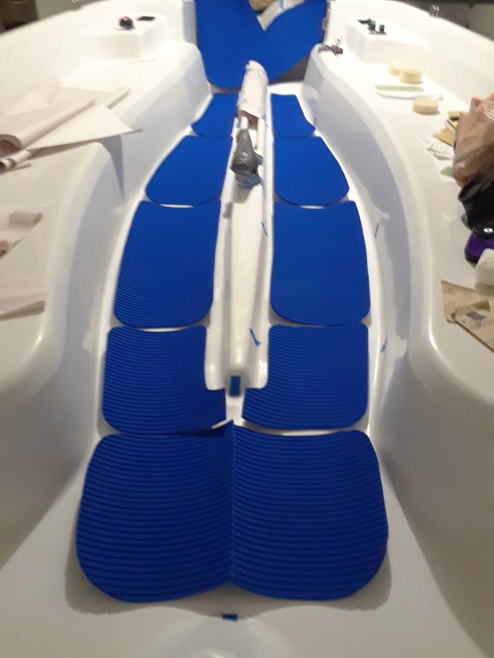

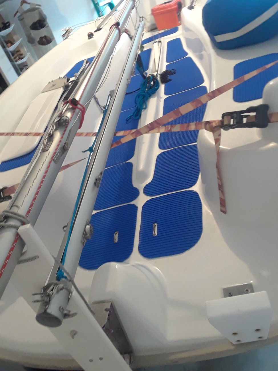

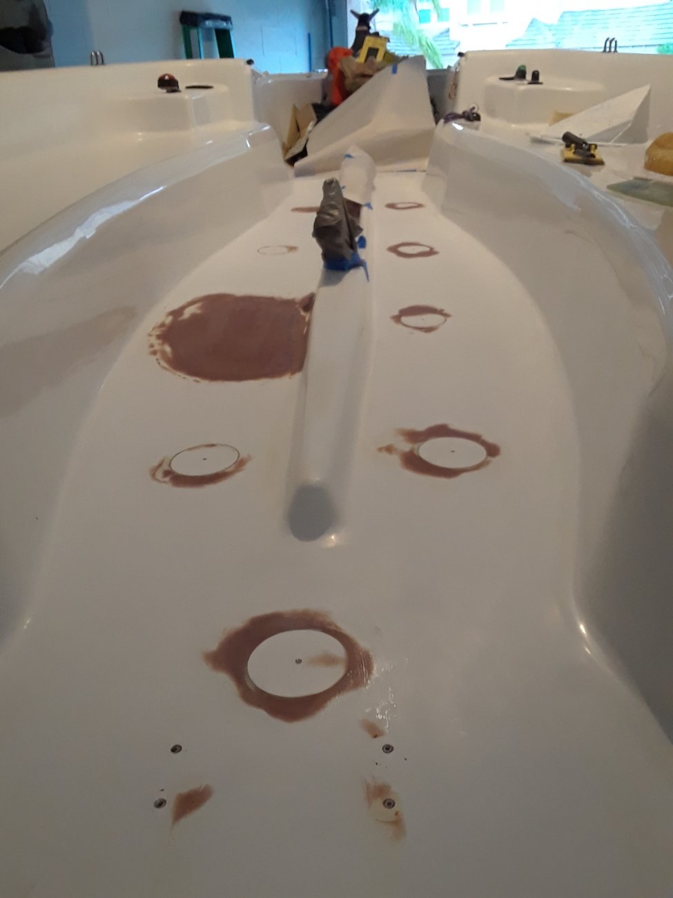

Puck'n a man, the pieces are all back in. Royal Blue Cut-groove Hydroturf is on order.Thank you!

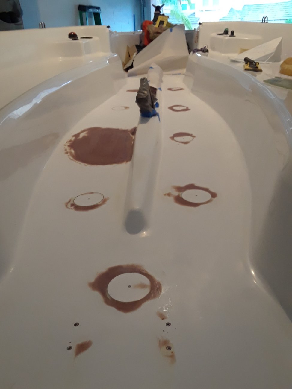

The foam will be sanded down flush to the deck, then the hole saw will drill down to the depth of the luran. A dremel with a router tip will machine out the rest. That leaves a gap for the puck and some adhesive.
The panel and pucks will be flush with the deck.
I probably could just hammer the foam down.

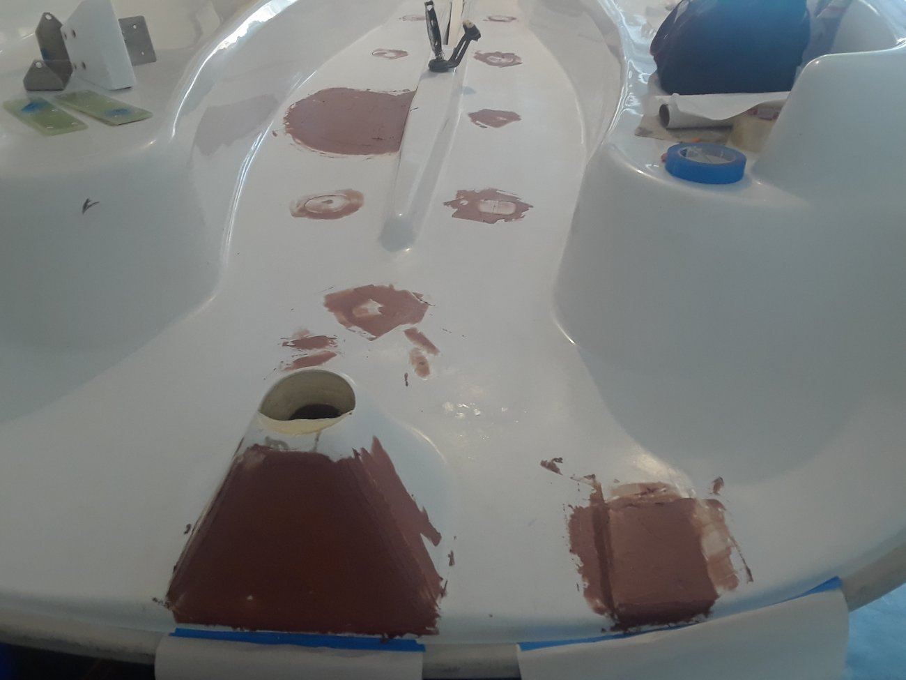

I used a plunge router bit on a dremel to remove excess foam versus hammering it down. It took a whole tube of PL3X but the pucks were sanded rough, wiped with a damp cloth, buttered up, then spun squooshed into location. They were mostly level when i left them, but the glue does foam up slightly, so since i did not weigh then down they rose up about 1/16 inch.

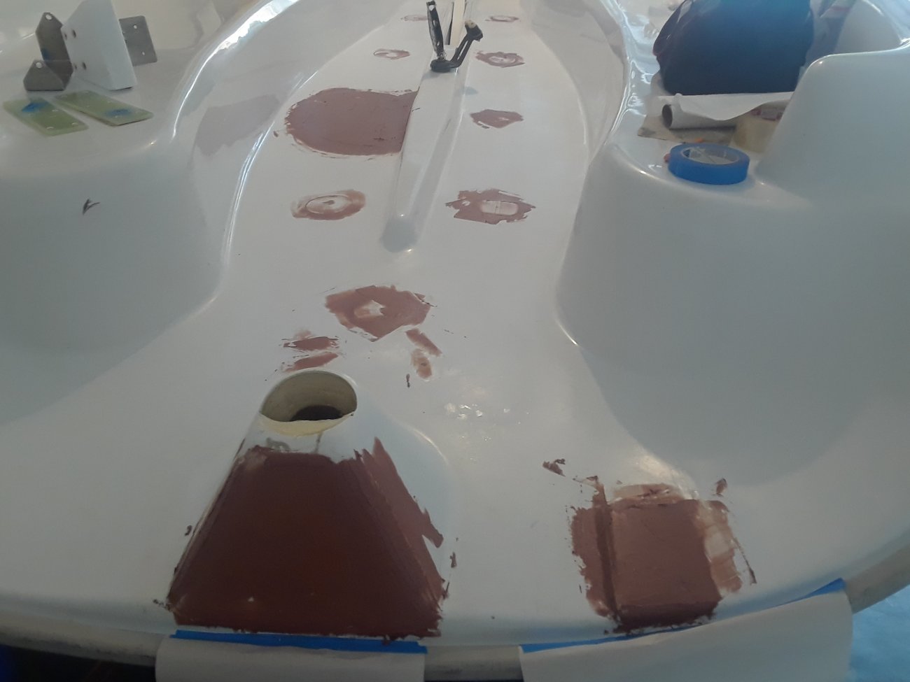

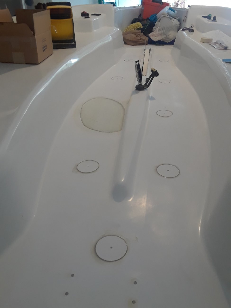

The next day i cut out the glue around the pucks, and refilled them with epoxy and high-density filler. Did the same to the big panel.

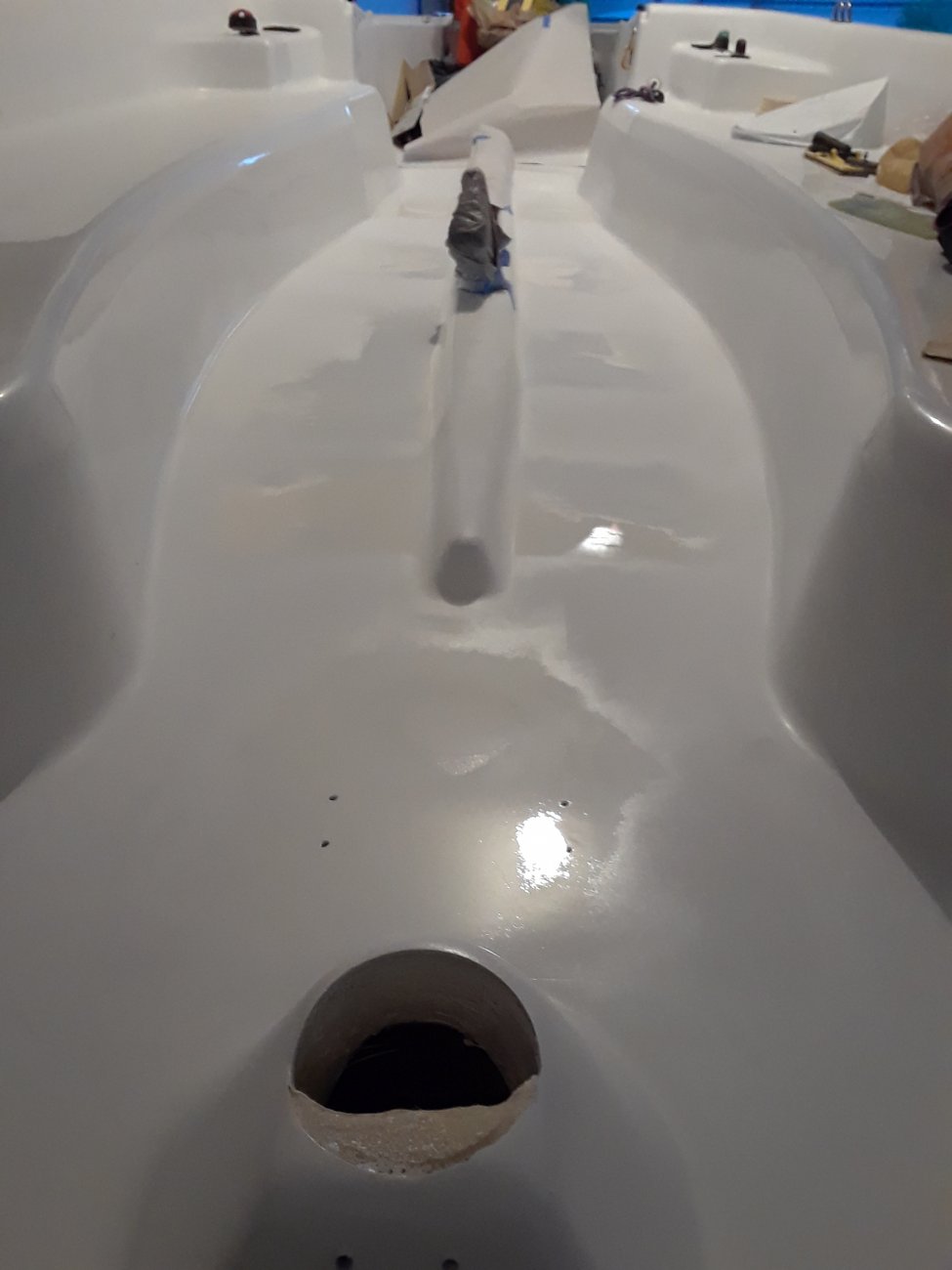

The big panel was glued flat to the foam, and the deck was raised, but still was lower than the factory level by about 1/8 inch. I prepped the area for surgery and then added about 3 layers of cloth to reconnect the deck to the centerboard trunck foot stop.
So solid. Its amazing. I was tip toeing on the big panel and jumping on the centerboard foot rest near the original crack, trying to break the layup.
