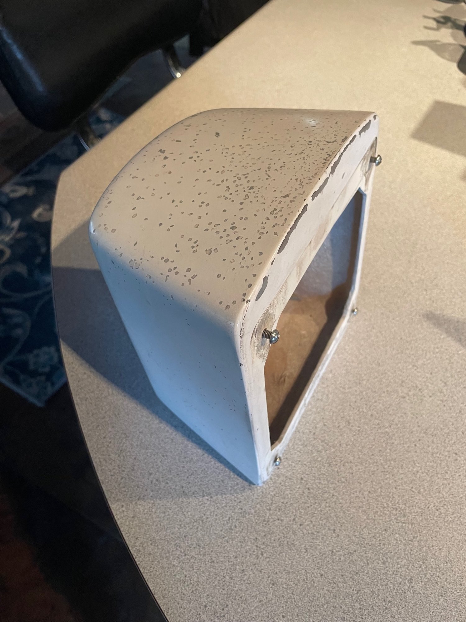

Hello, my original fiberglass boxes that hold my tach and auto-pilot, etc. are pitted from all the years and weather. Would anyone have recommendations on sanding and painting these boxes? I have read that you cannot spray paint fiberglass. Would some sort of primer and paint combo be best. Would just like to make things look new again.

Do you have pictures of the boxes? I don’t think the 28 came with anything like that originally. In general fiberglass can be painted like anything else. A marine topsides paint would probably work well for that. I’ve used TotalBoat Wet Edge paint, after prepping the surface and using their primer, with good results on fiberglass.

Hello and thank you for reaching out. I am a new sailboat owner and this is my first boat. Working through a few projects and while replacing some electronics I decided to give these boxes new life. I will get some primer and topcoat as you suggested. What grit of sandpaper would you use as well? I had figured brushing would leave brush marks but I did read somewhere about a product for helping with that that I assume you add this to the paint. I had thought I could spray paint them until I started doing some research on the web. At that point I thought I would reach out to the experts on this forum.

That should clean up nicely with some paint. Brushing should be fine for something that size. Paints for fiberglass are engineered to flow out, evening out any brush marks as they dry. They can be thinned to help with that depending on ambient temperature as well. Some high end paints have additives that you can use to help with the flow out even more, but on a surface that size I think any mid range marine finishing paint would be fine. I’d use the TotalBoat just because that’s what I’ve used in the past, but Interlux and Pettit make similar products. The thinning and application steps are always in the product instructions. Check the instructions for whichever product you select, but you’ll probably be sanding with 220 grit, priming, and painting, likely with more 220 grit sanding between each coat.
I’d also recommend checking out the BoatWorksToday YouTube channel. I don’t remember if he has any videos of painting a box that size, but he does have a lot of helpful painting and fiberglass restoration videos in general.

Thank you, very much appreciated! I am ordering from Jamestown today. I am going to skip the thinner for this project, save a little money unless you feel its necessary?
And last question, do you just use a white paint for tings like this you do or flat white or off white, etc? This items looks just white and will look better regardless but would like to get as close to original as possible
May 17, 2004
6,262
I’ve only ever used it with some thinner, but that was on larger surfaces. You could try it without. Worst case if you see brush marks after the first coat is you’ll have just a little extra sanding, then get the thinner for the second coat. It’ll take a few coats to cover well anyway.
I’d use white, but that’s a matter of personal preference. From what I remember the steering pedestal on the 28 is white, except maybe for the top plastic part that yellows over time. Trying to match the off-white of anything else in the cockpit would be difficult.
