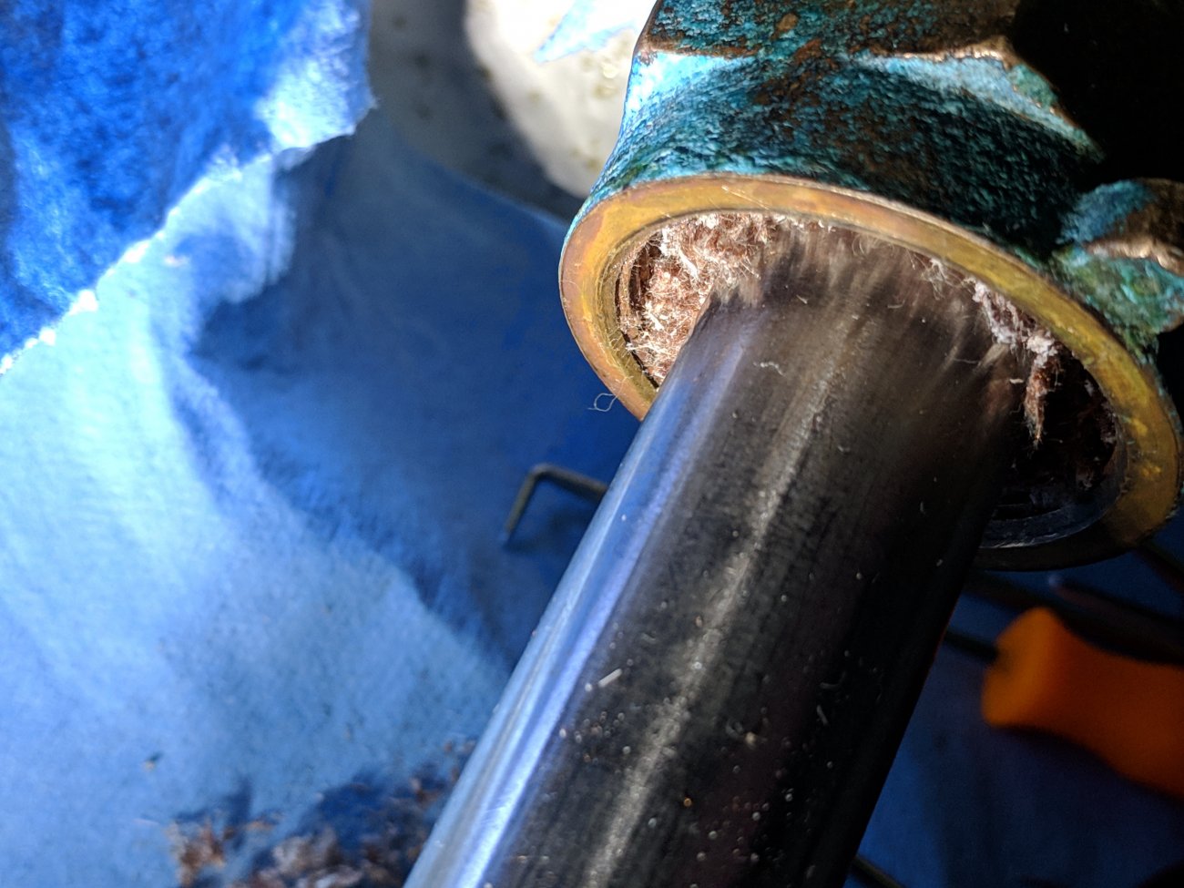

I’m on hour 5 and figure I have about 70% out. I’ve used everything mentioned here as far as tools (17 at last count). Next headache will be cleaning the thing to take the new packing.
I was initially very careful not to ding the threads until I realized I only need the first 5 or 6.

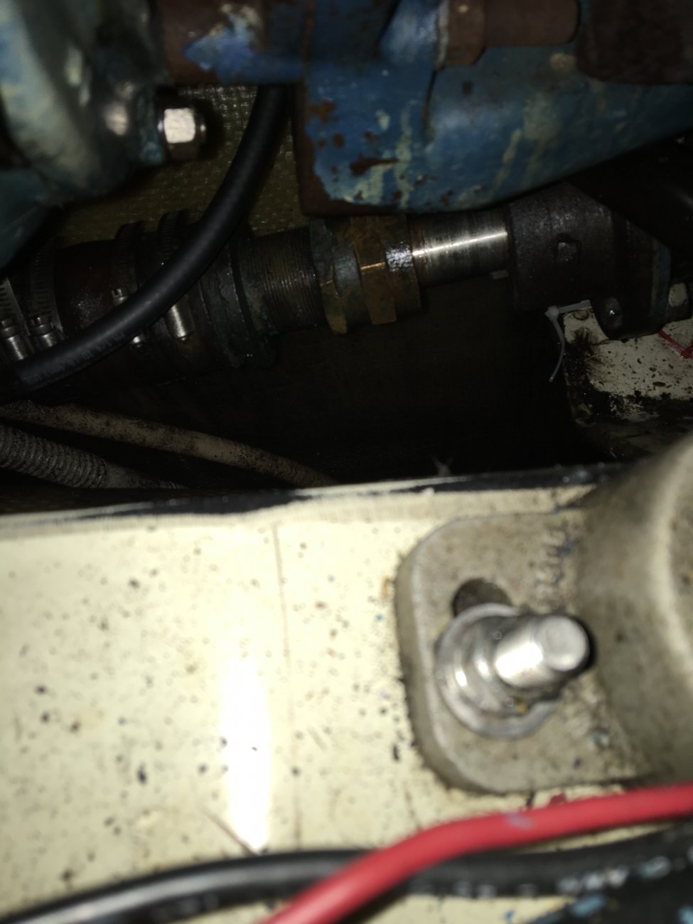

@kampuniform I know this is not a competition. Here is a closeup of my access to the Stuffing box under the engine. Beneath the stuffing box is my bilge, a 4-5 foot deep hole.
At least I do not have a knife blade rail cutting into my vitals.

Well after another 3 hours success! There were 4 rings in there and the last one was brutal. Thanks to all for the suggestions. In the end a pair of bent forceps were the most useful tool.
Now just gotta figure out how to clean up those threads in the nut :what:
