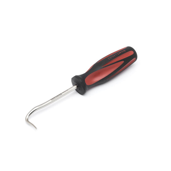

I have broken two of the corkscrew type of extractors. Apparently I am a slow learner.
I now use a cotter pin puller tool. It looks like a pick with a 90 degree bend at the end. Very robust; will not break. It is an extremely useful tool that I use for many jobs besides pulling cotter pins. I also use a small forceps that I bought at Harbor Freight.
Thanks Rich....I also have one of these and have been using it as my primary tool as it works better than my other picks, screwdrivers and mini pliers. The forceps don’t really have anything to grab yet other than bits of fuzz.

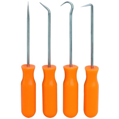

These have been invaluable...from Harbor Freight. They are only about 6 inches long. Thankfully I have excellent access to my stuffing box...
Bingo..! Having repacked many hundreds of packing glands over the years, the one thing I find to be a waste of both time & money is laying down your hard earned cash on the "cork-screw" type extractors. I have a small collection of custom bent extractors, many of which started as a cotter pin puller or radiator hose puller. They work fabulously well. I also have a number of smaller picks too.
As long as the orange handles don't slide off..... D'oh BTDT.... Cheap enough that when, not if, that happens you just toss it. Do be prepared to purchase two sets because those orange handles will eventually slide right off.
Thanks Maine...yes I bought a couple sets for less than 5 bucks. So far they seem to be pretty robust, but being HF I was prepared for failure. So far more effective than my Craftsman picks and hose pullers cuz of size...:meh:
