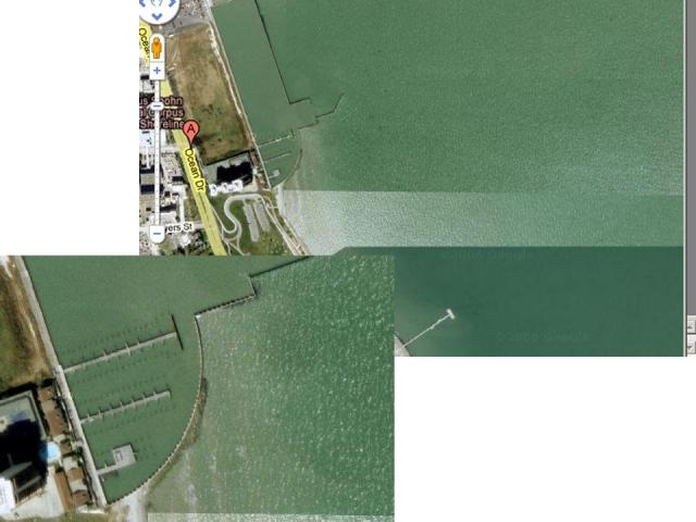

We would need to know a lot more. I did google your marina, Is that attached picture it? If that is a concrete breakwall you should be mostly OK. In Quantico we do have a concrete breakwall and that takes most of the stuff out, although sometimes a big power boat wake will get things rocking and rolling. Also a few years ago with Hurricane Isabel we nearly lost everything with the 10' surges that lifted all the new floating docks off of their pilings.

rpwillia-that is the marina I am in(I don't want to say MY marina, I am not so proud of it)lol As one would pull into the marina from the bay, I park it on te north most pier about 1/3 of the way in from the bay. You can see the prevailing wind white capping the water against the sea wall.

The more I think about it, there is a power boat 35' or so in my marina. I can picture that guy flying in causing a huge wave and causing the damage. I need to move my boat furhter into the marina. I like where I am at becasue I don't have to manuver around anything, but I think I need the practice anyway.
