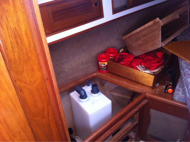

My original holding tank was 3 gallons. The vent was halfway up,(pic on dock) not at the top. :-0 Would only hold 2 gallons before sending up the vent hose. Also like all tanks you can't get the last gallon out before sucking air. So capacity of tank was 1 gallon. Useless.
So I bought a 5 gallon with proper vent, and new hoses. Finally putting it in. But even with 4+ times the capacity, and actually usable, still kinda small. So I wanted to put in overboard pumpout. The boat has a lockable (locked) Y valve for direct over. But none for tank, which must be pumped from deck.
I wanted a diaphragm manual or electric pump, but too big for space. So looked at macerator which will fit on the aft bulkhead. My problem is space. If I put a Y fitting or valve on the tank exit, with the extra hoses to and from the pump, and looking at the space needed for the drawer frame (on v-berth in pic) on top, it would be veery tight. Might not work. Plus other complications.
I do not want to modify the cabinetry.
Jeez long story. Sorry. Anyway if I just put it back in as it was, I'd be done before finishing this post.

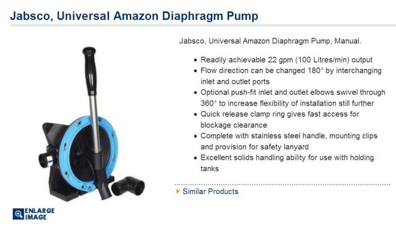

So the the question, finally, is has anyone used a hand bilge pump (pic) with maybe a pumpout nossle(pic) to do it from the deck? One with the 6 foot hose to dangle in the water. Then just pump sea water through it to rinse. I don't want some elaborate setup and I'm thinking this might work.

Could you not T into you manual bilge pump, with a valve of course? It just occurred to me, so I haven't given it a lot of thought for the negatives.
That's exactly the setup I have for a standby pump if the macerator pump should decide to fail.
Good concept. Not feasible on my boat. Manual pump is in the lazerette, head and holding tank are forward. Also the bilge pump discharge hose would permeate. Don't want to have to replace that. With the hand pump, I can easily rinse it, and chuck it if eventually needed.
I'd love to have a manual diagram pump, there's just no space. Tiny holding tank area, and no space in head compartment.

Btw, neither of your tanks is sitting on the right surface for the installed fittings. The 3 gallon tank on the dock is lying on its side (big clue is the cut out imprint for an inspection port, which has to be on the top of he tank)...and the location of the fittings on your new 5 gallon tank is the END of the tank--with the vent in the upper left corner, the elbow is the pumpout fitting. Unless there's a pickup tube inside the tank, you won't be able to empty it if that's how you intend to install it. Or maybe that's just how they happen to be sitting when you took the pictures...??

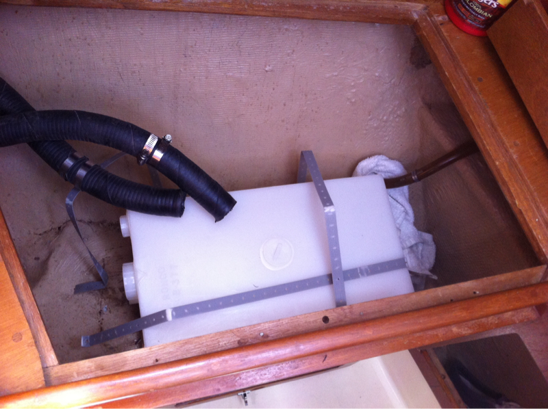

Yes the new tank was just sitting there upended when I took the pic. Actual position will be more like the other pic I posted, with the tank laying down with fittings facing aft.

Oh, maybe I never posted that other pic.
Anyway, the tank will be positioned like this. Pics.
