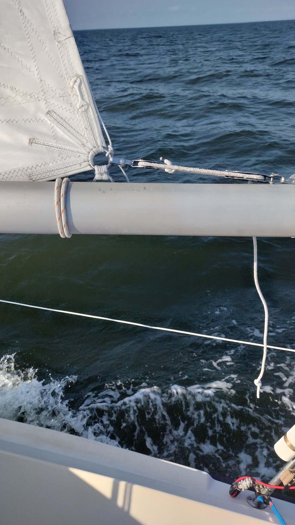

Another option, probably simpler and maybe less expensive, get rid of the car, and track if possible, and replace it with small blocks like this. The picture doesn't show it but the back fiddle block has a "V" cleat. This particular configuration gives a 3:1 purchase, but you can also increase the purchase with different blocks.
