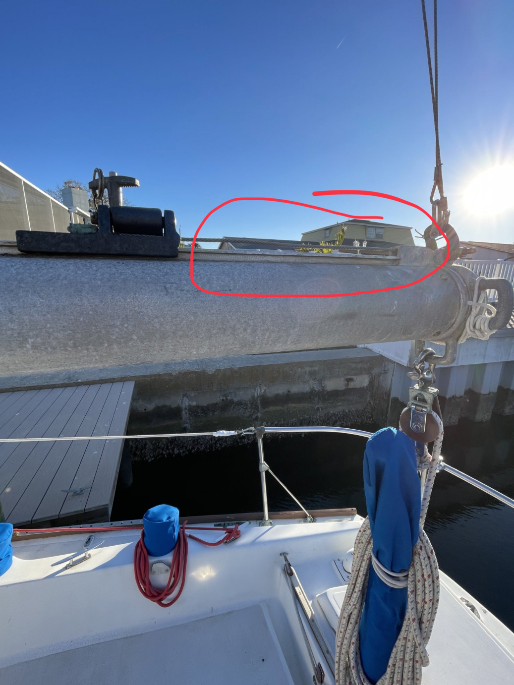

Is there anyone out there that has seen an outhaul mechanism like the one in the attached photo? I bought this ‘old girl’ a few months ago and can’t figure out how it’s suppose to tighten the sail. Any suggestions will be greatly appreciated. FROCKY

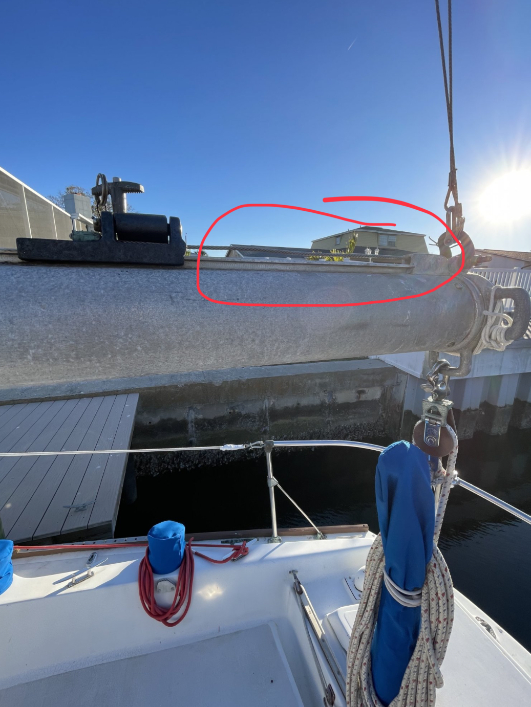

Where does the cable I circled go? I would suspect it goes over a sheave at the end of the boom, then through the boom to the mast…but then where? On my boat, the outhaul goes into the boom, back to the mast, then down to the cabin top and through a line organizer and back to the cockpit so I can tighten it on a cabin-top winch. Yours appears to be cable…so maybe it does to a cable winch?
I am assuming the car on the boom somehow attaches to the clew of the sail, and if the car is moved back, it pulls the foot of the sail tight?
[/QUOTE “Thank you for your response. YES ….the clew of the m’sail d
oes attach to the car. I’ve not removed the backplate of the boom simply because I didn’t know if I might be opening a ‘Pandora’s Box’. I had one friend say he thought the boom on this MORGAN may have been equipped with a rolling boom that served as a reefing tool but that makes no sense to me. If I can’t find someone that KNOWS how this set up works, I’ll remove the backplate and see where that takes me.”]

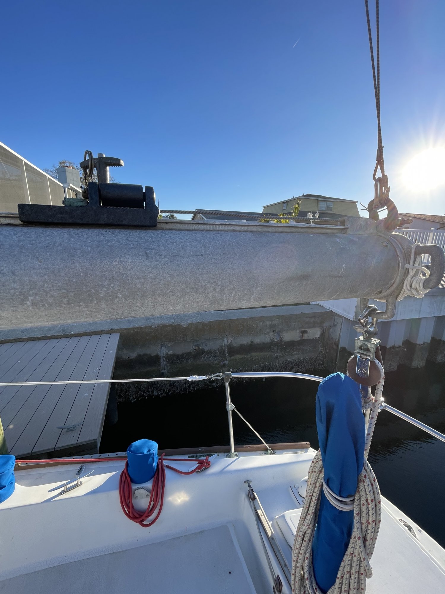

Take more photos including from further away. Take more angles. Also the mast end.

Where does that cable disappear to? I thought it went to the aft end of the boom, but in that shot, it doesn’t…so where does it go?

Aside from where the cable goes I'm wondering why the cart has to be such a beast? And it's on a track from what I can see. What are the dimensions of the track? I'm wondering why in the wide world of sailboat hardware couldn't the OP find a smaller less intrusive cart? Maybe the whole system needs re-working.

G’morning Greg and others. I have a video that hopefully helps ‘splain’ (as Ricky Ricardo from “I Love Lucy” used to say.) but when I try attaching it, I get an error message. . The cable that’s attached to the car does turn down in the aft end of the boom and goes inside. I haven’t figured out where it ‘goes’.

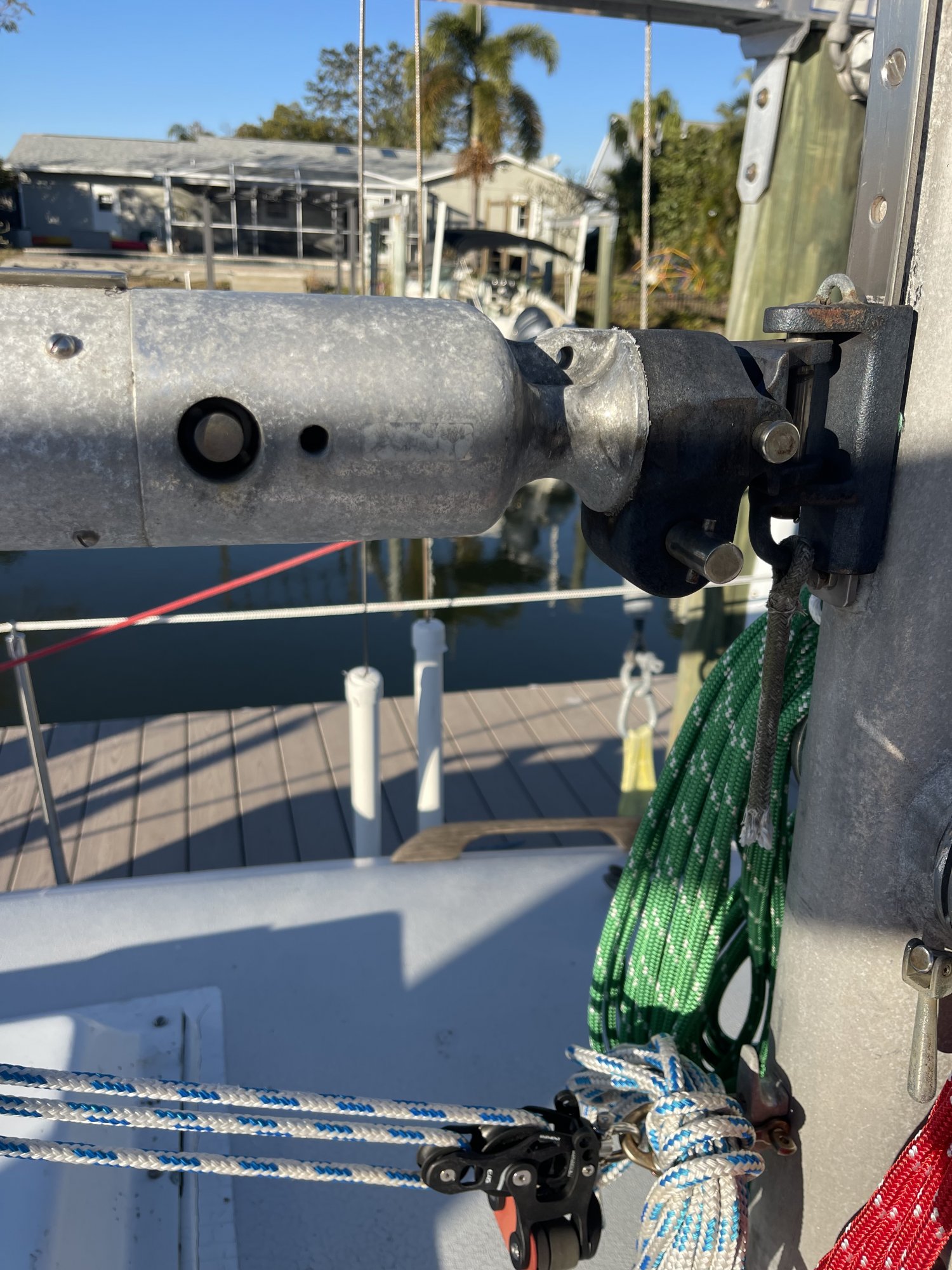

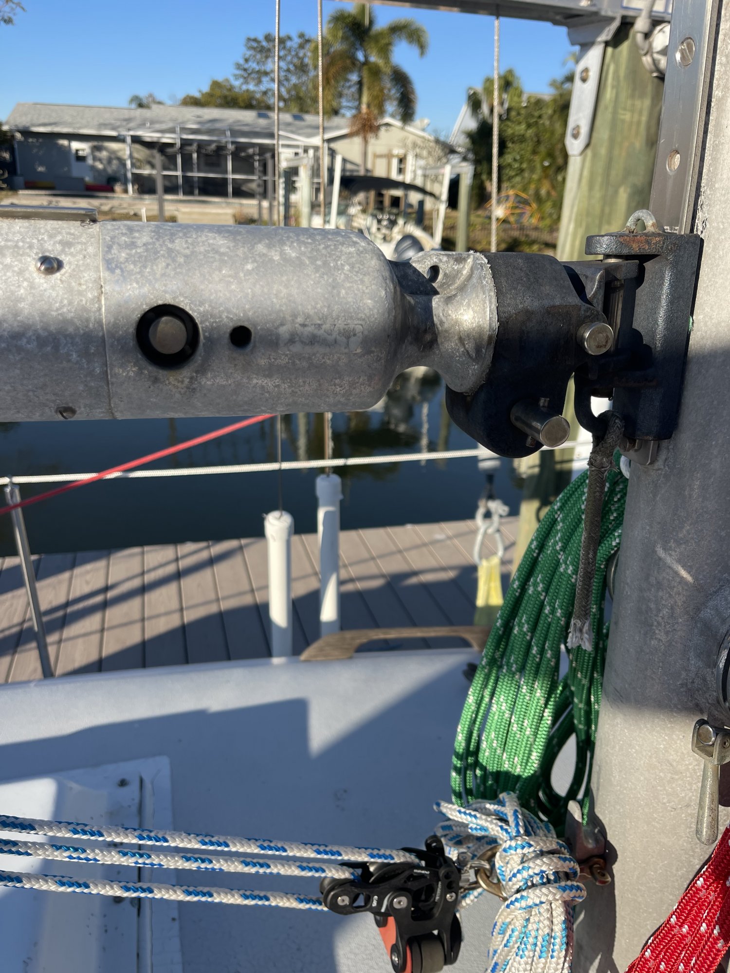

On the forward end of the boom there appears to be something that may accept some type of crank but it’s not like anything I have ever seen.
10,255
Pretty sure that is a crank attachment for roller boom furling. You'd slack the main halyard and crank to roll the mainsail up on the boom to reef/furl. Not a bad system since it allows horizontal battens ..
10,255
another note: since the boom was designed to roll, the outhaul would not have been led aft at the bottom of the mast, rather it would have most likely exited underneath the boom. The wire lead may have led to an internal block; a line may have been anchored internally on one end , led through the internal outhaul block then exit under the boom near a stopper of some kind, like a small cleat or clam cleat. I dunno

On the forward end of the boom there appears to be something that may accept some type of crank but it’s not like anything I have ever seen. View attachment 229339
The R/F boom crank point is the male SS stud that shows at the bottom of the black anodized gooseneck fitting. The crank point for the outhaul would seem to be bigger of the two holes in the boom. Once you start roller-furling with a r/f boom there is no way to adjust the outhaul. The sail wraps around the boom and that's that. This is one of the problems with roller-furling booms - the leech of the sail keeps slipping forward because there's nothing to hold it aft and the sail sets poorly. The same handle may work for both the roller-furling boom and for the outhaul, or there may be two different handles. In any case you will need to find a way to turn the stud in the boom's hole and see if it works the outhaul.

“Thank you DJ ….. that’s exactly the kind of help I’m looking for. I have no use in reefing my main w/ anything but the traditional fashion. I’m beginning to feel like if I want to have some sort of reliable out haul system, I’m going to have to come up with something on my own.”
dLj
Mar 23, 2017
5,256
Your current out-haul may be fine for traditional reefing systems. The out-haul is only used for the clew of the main. Traditional reef points are not tightened through the out-haul position, only with full main up. Reef points have their separate clew (are these points called a clew?) attachments.
You just have to figure out how it gets moved. It does look like that round hole some kind of handle goes into may well be the out-haul adjustment. I agree with @PaulK in the likely identification of the different bits he pointed out.
