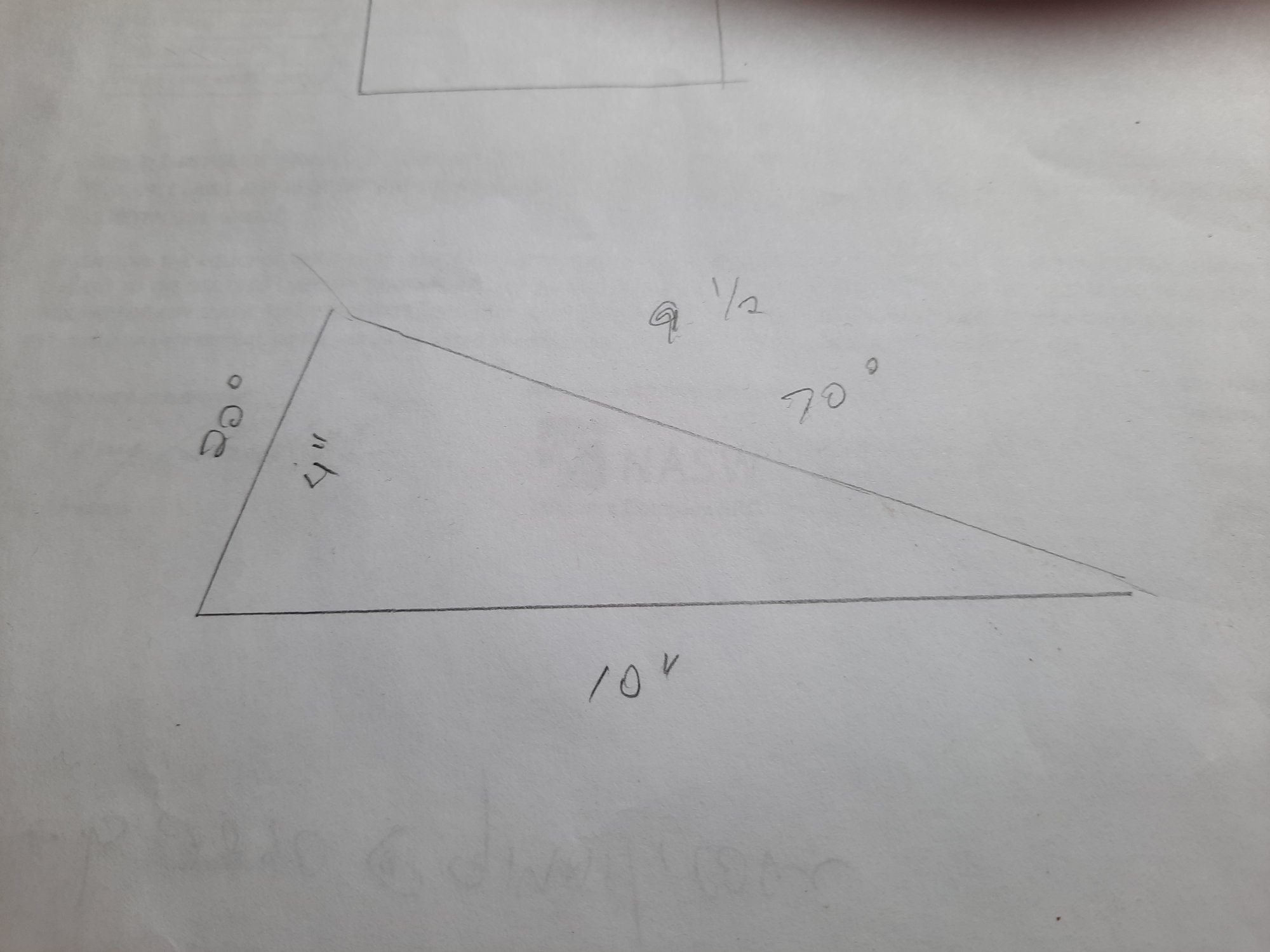

Oday 23 Grand Lake
...on my 1980 23-2, if you look at the block from the side at the stern, the top of the mounting block is a 20 degree angle approx 4" wide tapering down at a 70 degree angle with total flat side of the block being approx 10" in length
