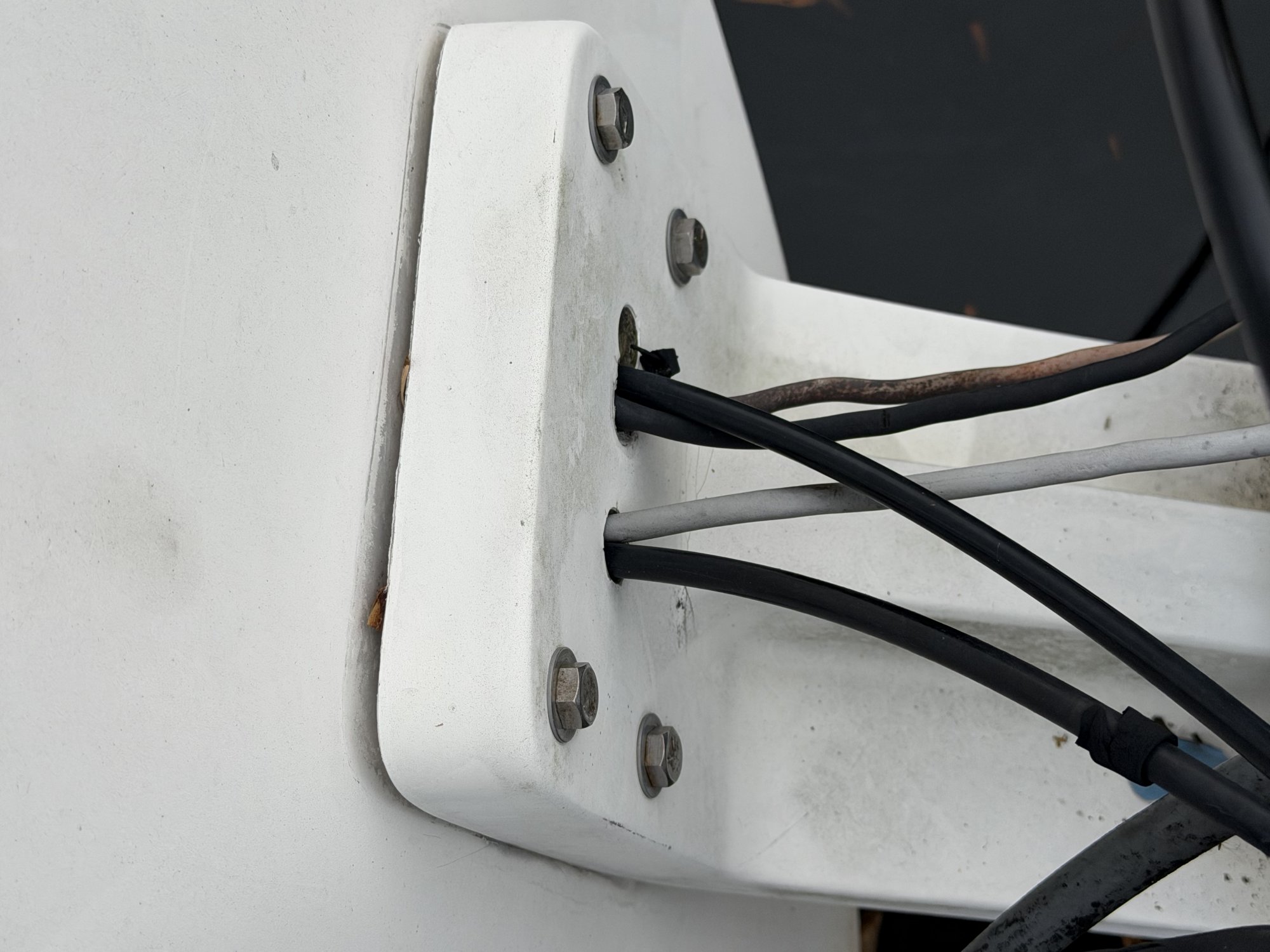

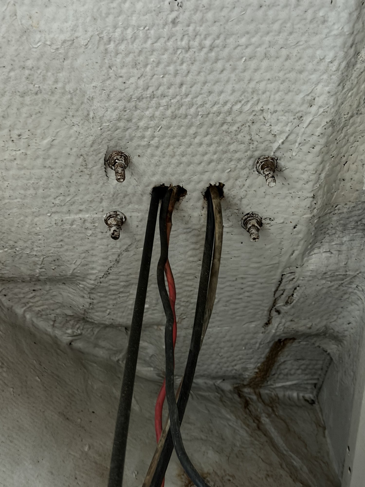

Going to put a new outboard on a 26.5 hunter. This is the state of the mount from both sides of the transom. Epoxy reinforce the top bolts and add a backing plate?

The top left bolt is obviously pulling through. Is that a cored hull?

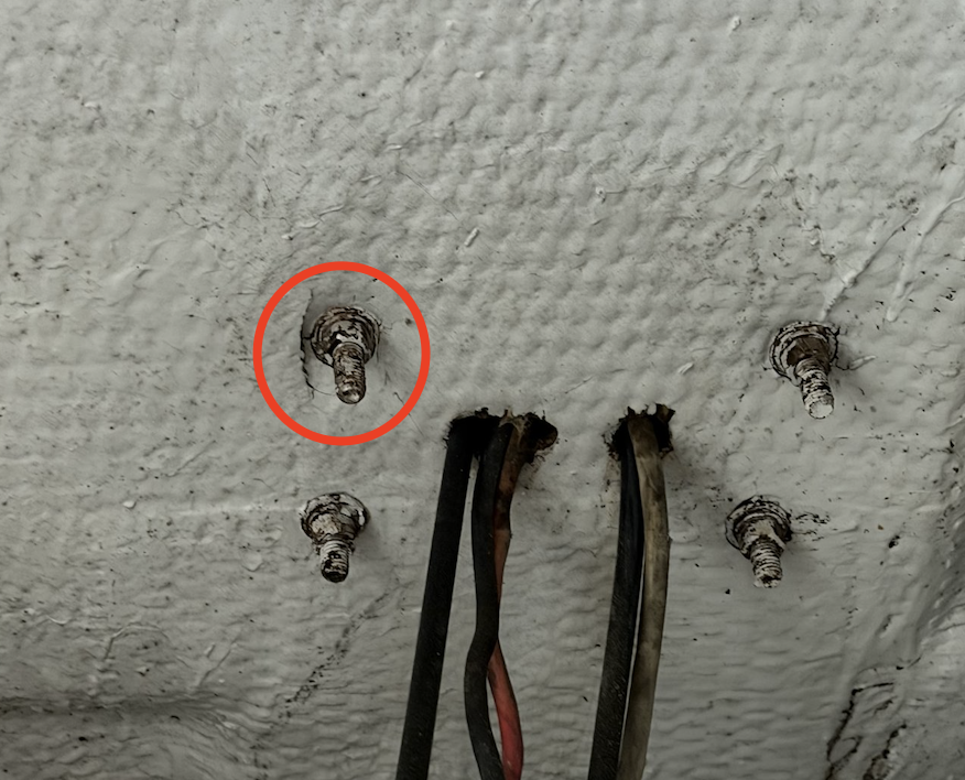

That sunken bolt could indicate a wet core. You need to remove the layers of glass in a small area or drill a hole to see the condition of the core. I once found that my transom was soaked when I torqued down on a bolt and water dripped out

It looks like it's cored, you can see the typical edge hump of the core at the bottom of the photo. There doesn't appear to be any seal on the holes the wires go through. I'd suspect the entire core is bad. In which case, you'll need to cut off the skin and rebuild it. I would rebuild the engine mount area as solid glass. Maybe recore the rest depending on how bad it is. It's not a hard job, but access might be difficult.

I do not know about "obviously cored" but the image does suggest that the bolt and nut, which is circled, has broken through the fiberglass skin. The lack of a solid backing material, the small size of the washers, and over-tightening create the broken fiberglass seen in the image.

Obviously is a bit too much. I agree.

From my experiance ,I am seeing a inner wood core that has very likely rotted . Mine was like this . Improper sealing of the through holes allowed water to be wicked up into the plywood center . In my case ,I cut a rather large section of the interior transom out .
Vertically scored a replacement wood core .Reinstalled the fiberglass skin . I then layed up multiple layers of heavy fiberglass mat .
The final piece was a 1/4" aluminum plate twice the size of the motor mount as a way to distribute the load .( it was free from my employer :) )

If the OP is not in salt water, I'd recommend using Unistrut washers as backing plates. 1/4" thick steel with a heavy anti corrosion finish for a reasonable price
