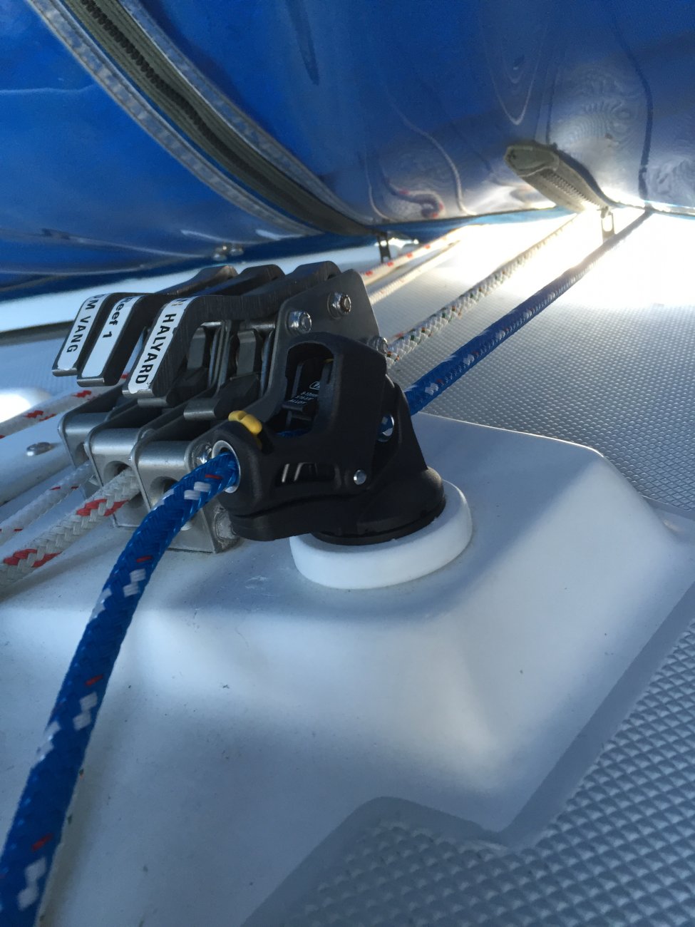

4) The Mainsheet V-Cleat / jam cleat just sucks, I'm wrapping it on the starboard cabin top winch, but that doesn't seem ideal.
Here’s the cleat my rigger set up for me on our C310. That original clam cleat was terrible and unsafe. The swivel lets it lead cleanly to the winch.
We also redid the traveler control lines to make them easy to adjust from the cockpit.

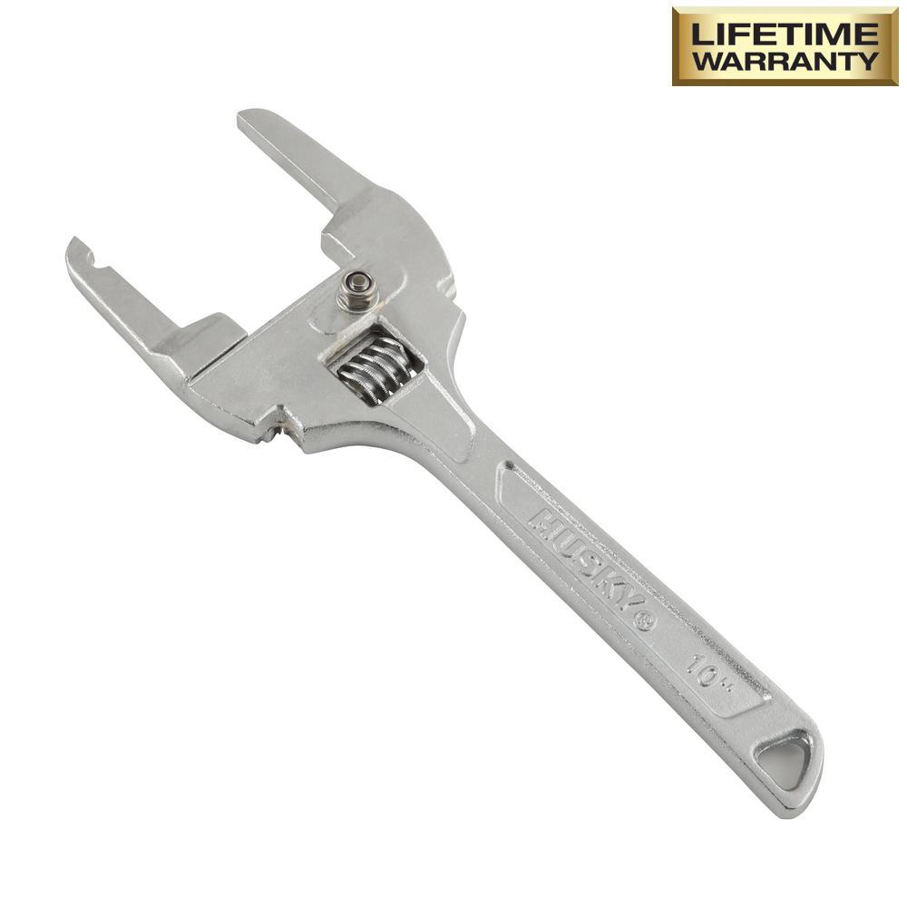

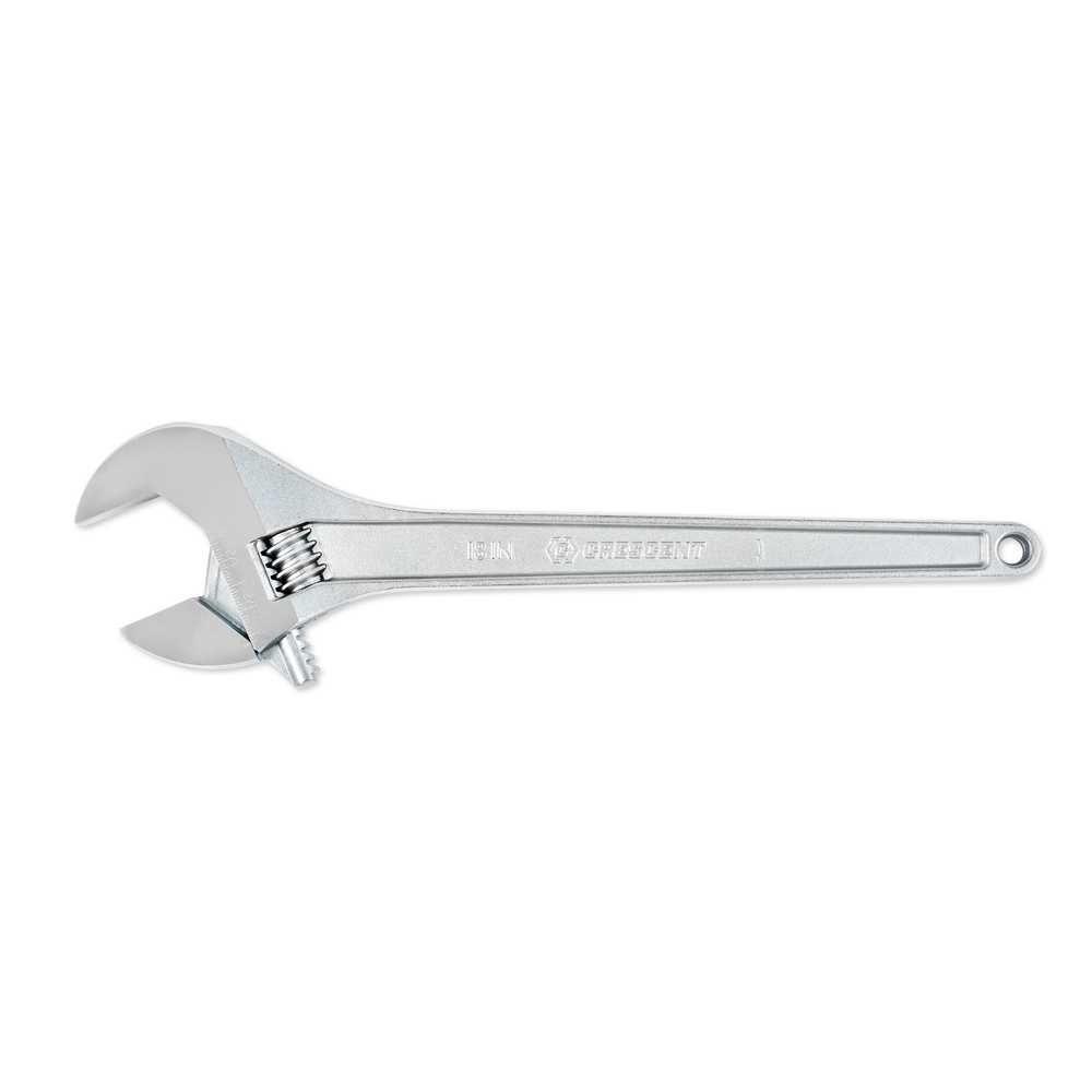

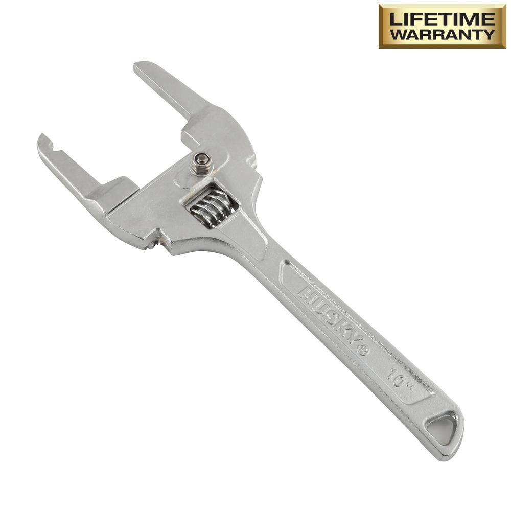

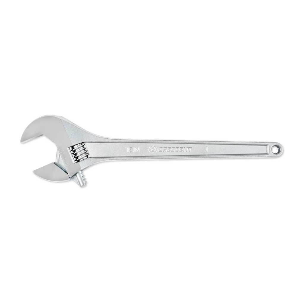

Ok dumb question, filling the water tank. How do I know when it is full? Do I have to have someone monitor it under the V-Berth as I fill from the deck or is there an over flow?
Also I want to get some wrenches for the stuffing box adjustment, I'm not at the boat but if anyone could tell me the size or just get 2 adjustable wrenches to keep on the boat then I'll do that. Also a dumb question for sure...
24,899
Not a dumb question. And you answered it the way I solved the problem.
I needed one each of these
husky-wrenches-16pl0134-64_1000.jpg crescent-adjustable-wrenches-ac218vs-64_1000.jpg
I tie lines to the ends just incase I drop one so it is not lost in the abyss know as my bilge.

Most Catalinas are same size on locknut and packing gland. I have two different sizes 1 7/8 & 2. CD sells wrenches that fit in the space - you jut need to measure for the size (3 or 4 choices). I have a bias against adjustable, too many busted knuckles and rounded bolts (but I do have them)

For the packing nuts, I carry two of the large adjustable wrenches John showed. They carry them at marine supply stores, but the same wrench is available at hardware stores for half the price. Look in the plumbing section. And do yourself a favor and keep those nuts saturated in PB Blaster or something similar.

Ok, Thanks all, I do actually like having sized correct wrench when I do work, especially on motors. I figure for now I'll at least grab an adjustable spanner wrench and 10" or 12" adjustable wrench. I'll measure next time out, hopefully this weekend for sure.

When you check the packing gland for wrench sizes, remember that you need very skinny wrenches. I find that the adjustable plumbing wrenches work well because they fit side by side on the gland nuts.

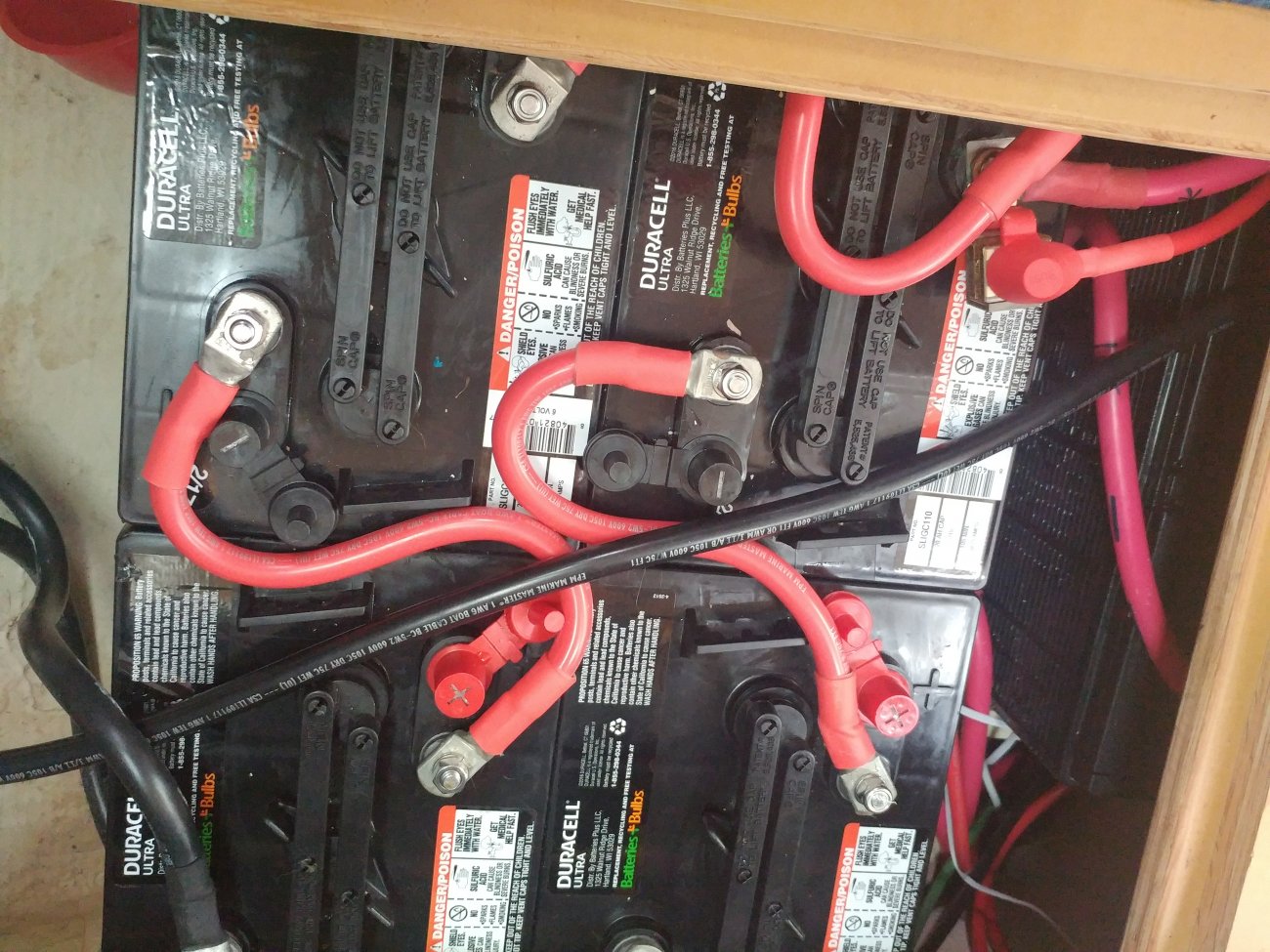

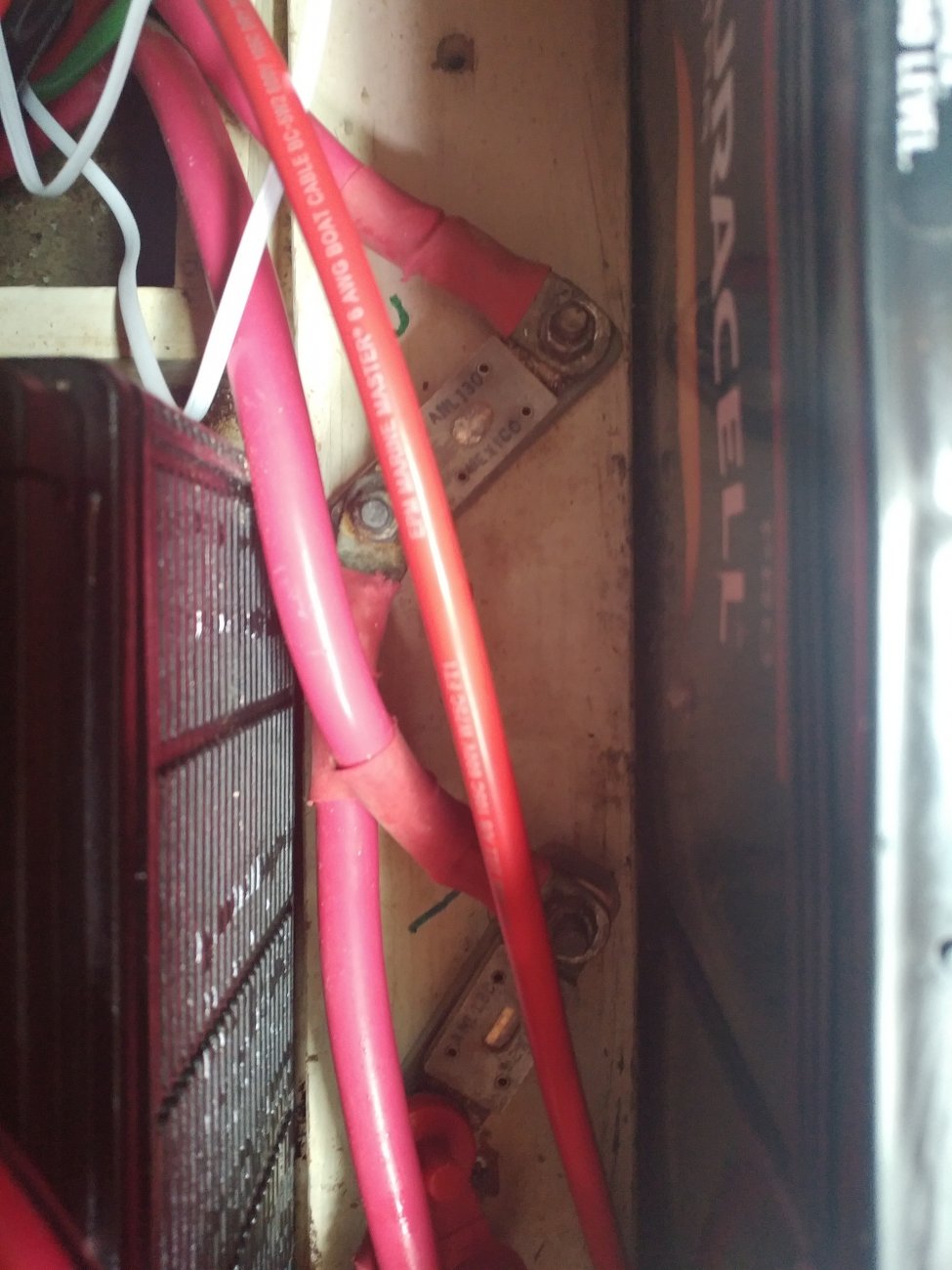

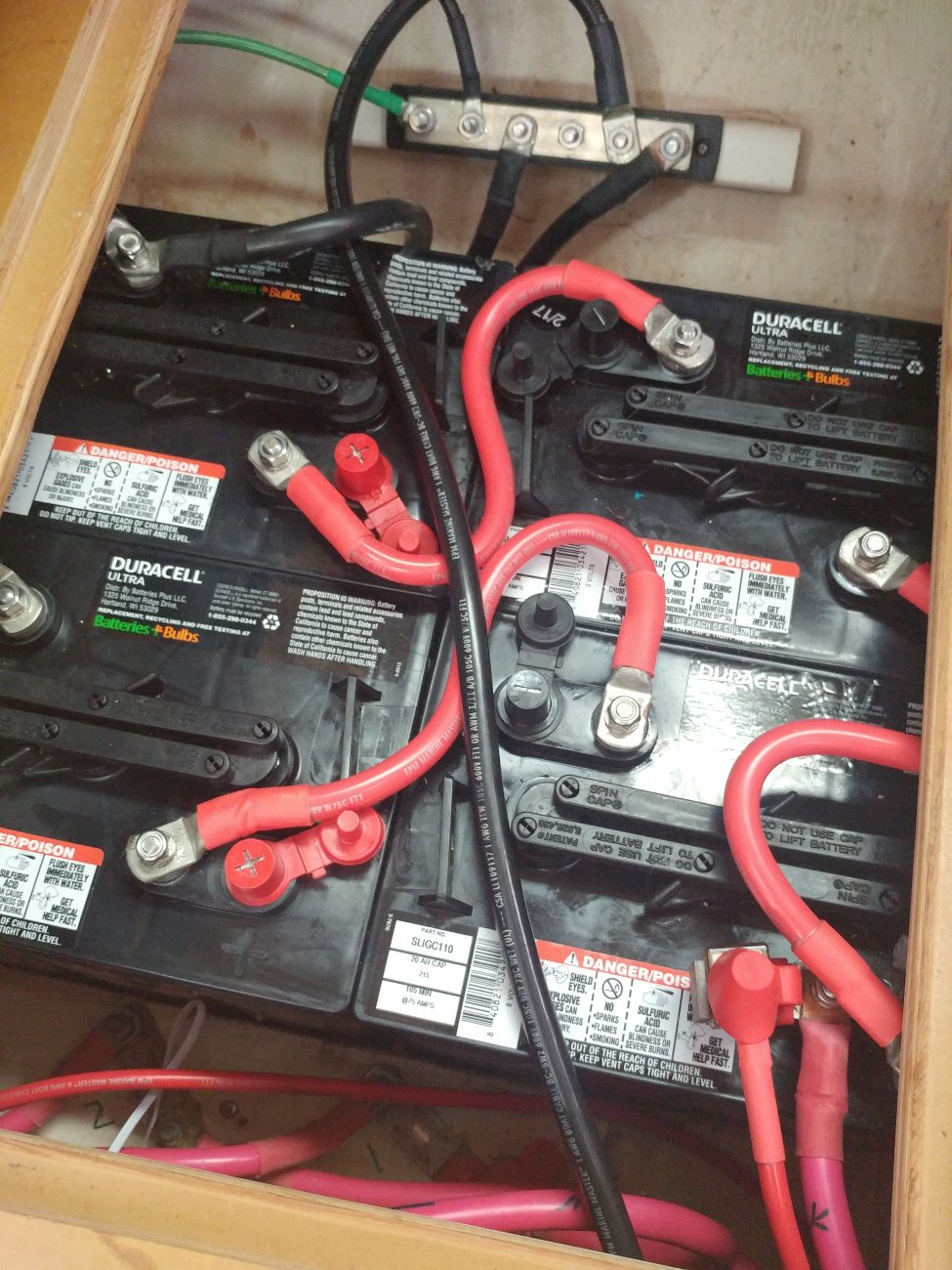

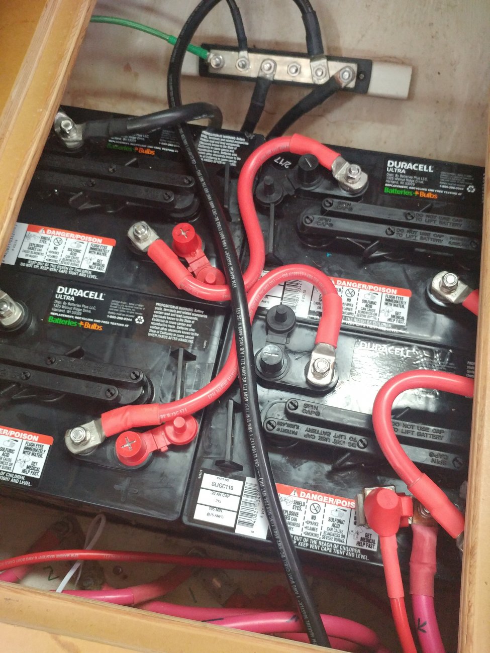

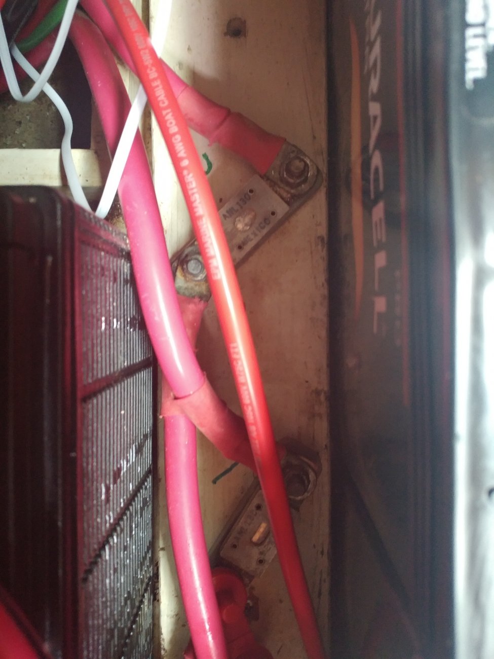

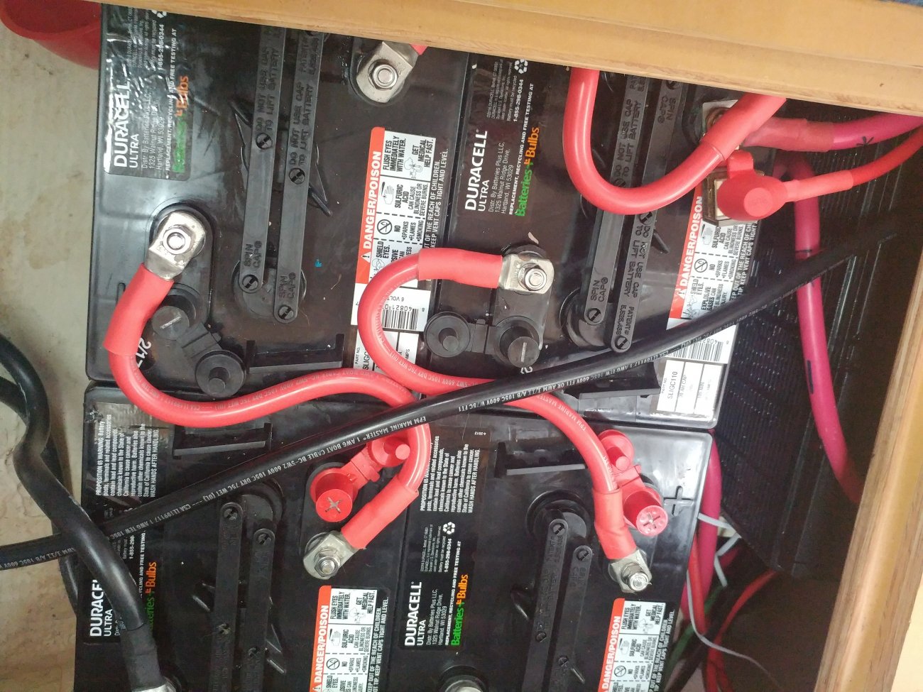

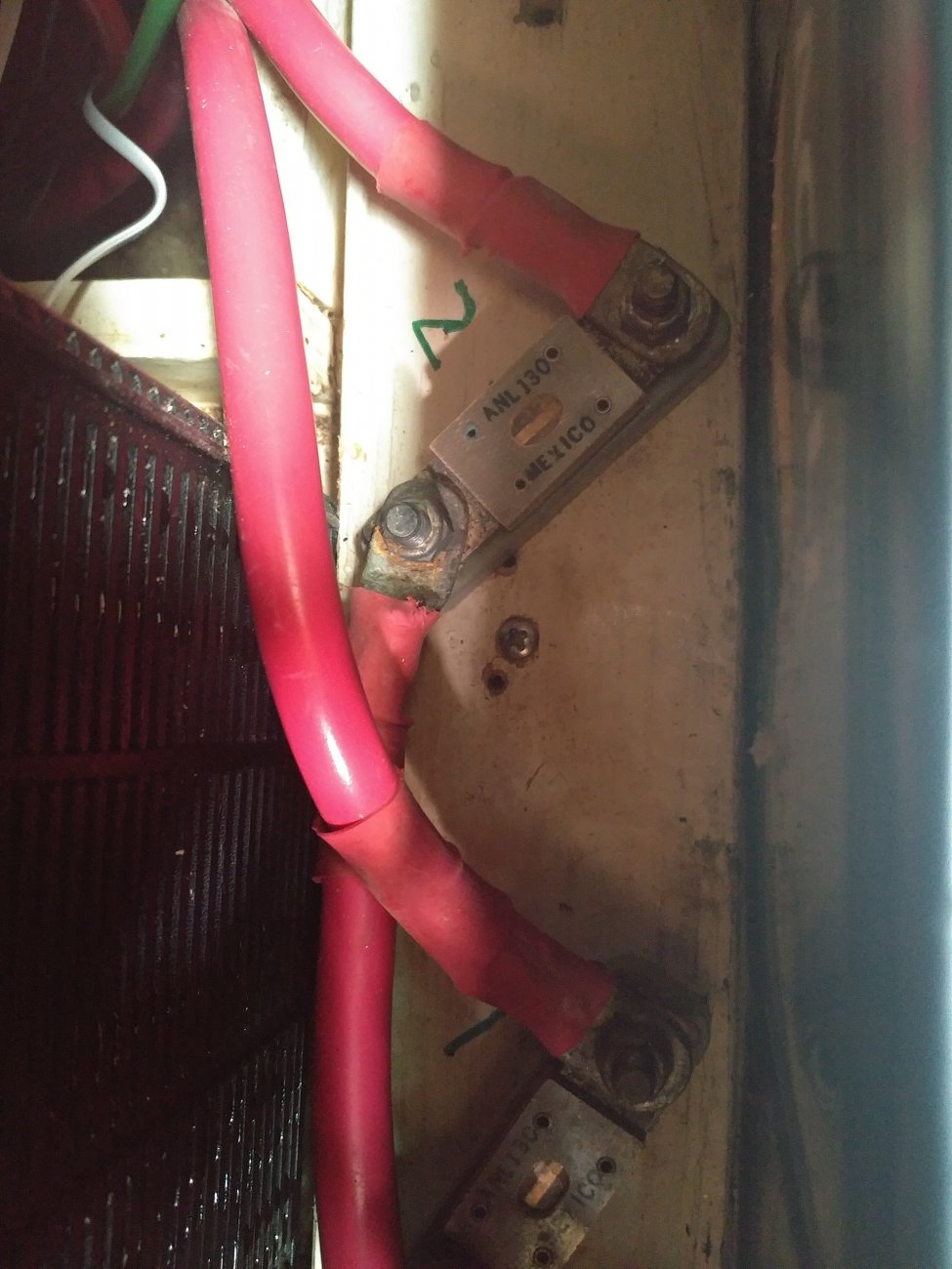

Had fun today, tank was pretty full so didn't need to top off. Did a lot of cleaning and organizing, weather was a bit iffy so stay and enjoyed the AC and stereo. Took this pics of my battery set-up.
