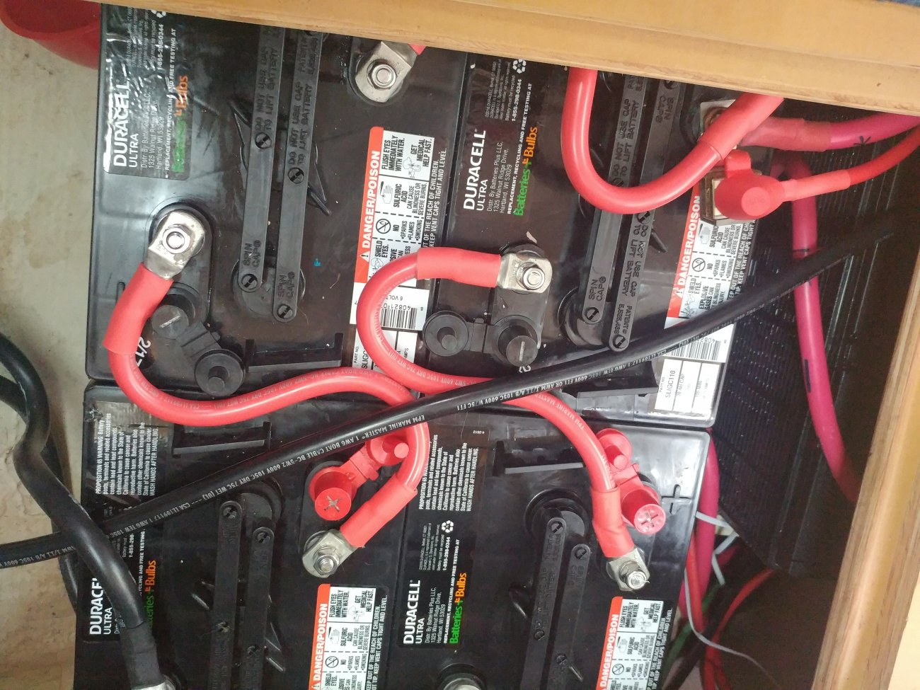

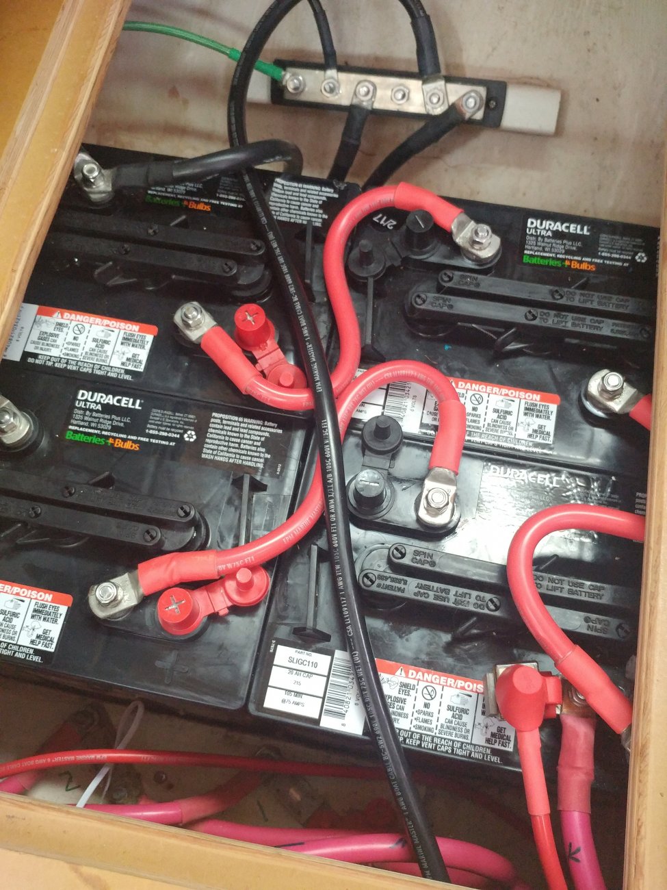

Had fun today, tank was pretty full so didn't need to top off. Did a lot of cleaning and organizing, weather was a bit iffy so stay and enjoyed the AC and stereo. Took this pics of my battery set-up.

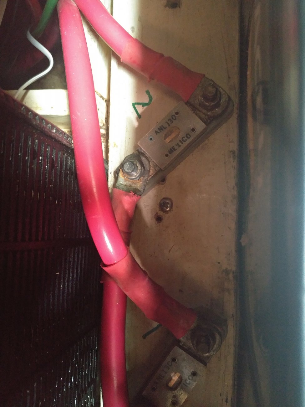

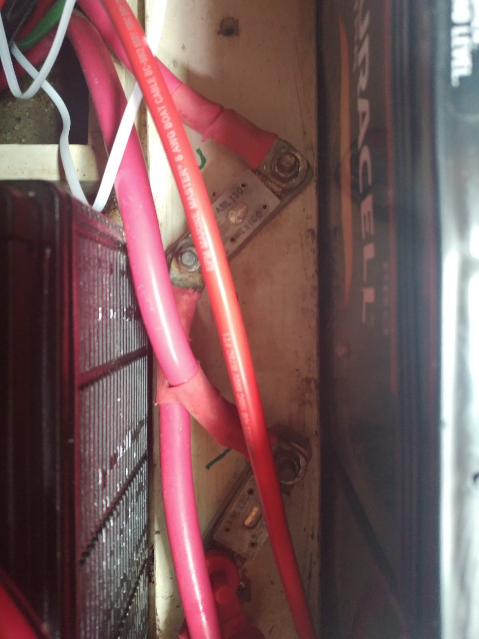

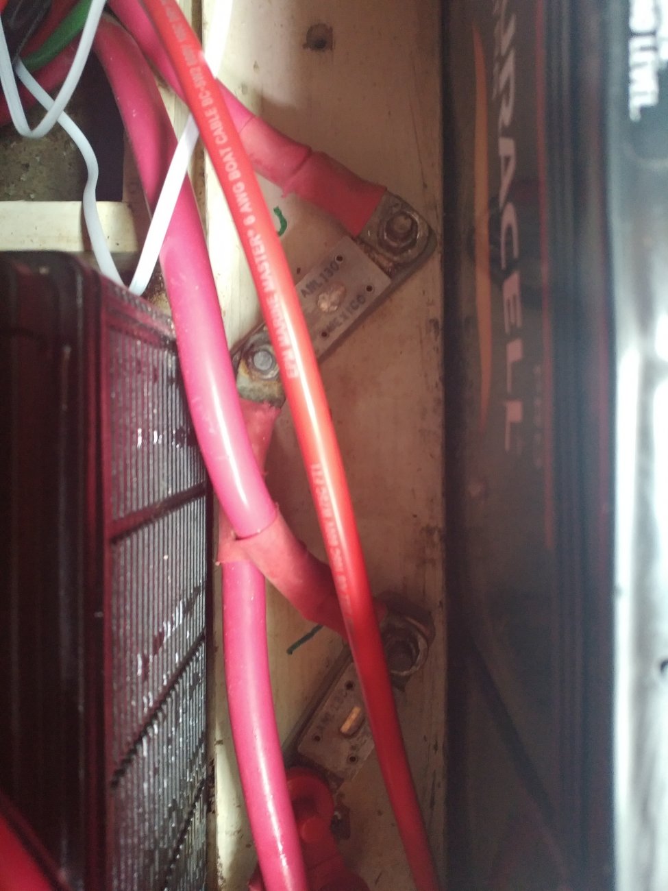

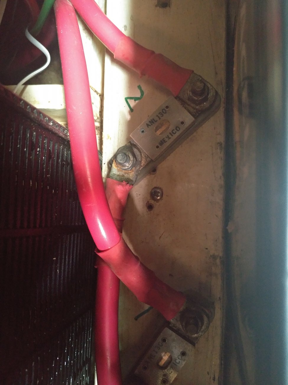

Your battery set up looks good. I have the same batteries but only two. Your ANL fuses/connections look like there might be some corrosion? If you ever replace the ANL fuses you might want to go with Blue Sea. They are ignition proof and I would question whether those stamped with Mexico on them are or are not. Being they are in the battery compartment I think they should be but could be wrong.
What's the black box also in the battery compartment, next to the ANL fuses? Curious.

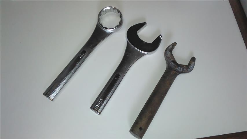

Most Catalinas are same size on locknut and packing gland. I have two different sizes 1 7/8 & 2. CD sells wrenches that fit in the space - you jut need to measure for the size (3 or 4 choices). I have a bias against adjustable, too many busted knuckles and rounded bolts (but I do have them)
I agree. After 20 years I finally got it right. I had an adjustable and a fixed, but the fixed one kept slipping off the lock nut, never had a problem with the adjustable because the gland nut is always easy to turn, or should be.
It turned out that four of the six sides of the lock nut were smaller than the other two!
I found a BIG combo box wrench and the store cut it in half for me!
1 3/4" works great.

Ya, honestly I'm not sure! I tried asking the previous owner he doesn't remember, it is tucked up tight in the compartment inboard.

You might want to fit some red and black caps on those exposed battery terminals. A casually dropped metal tool landing in the wrong way atop the batteries could really ruin your day.

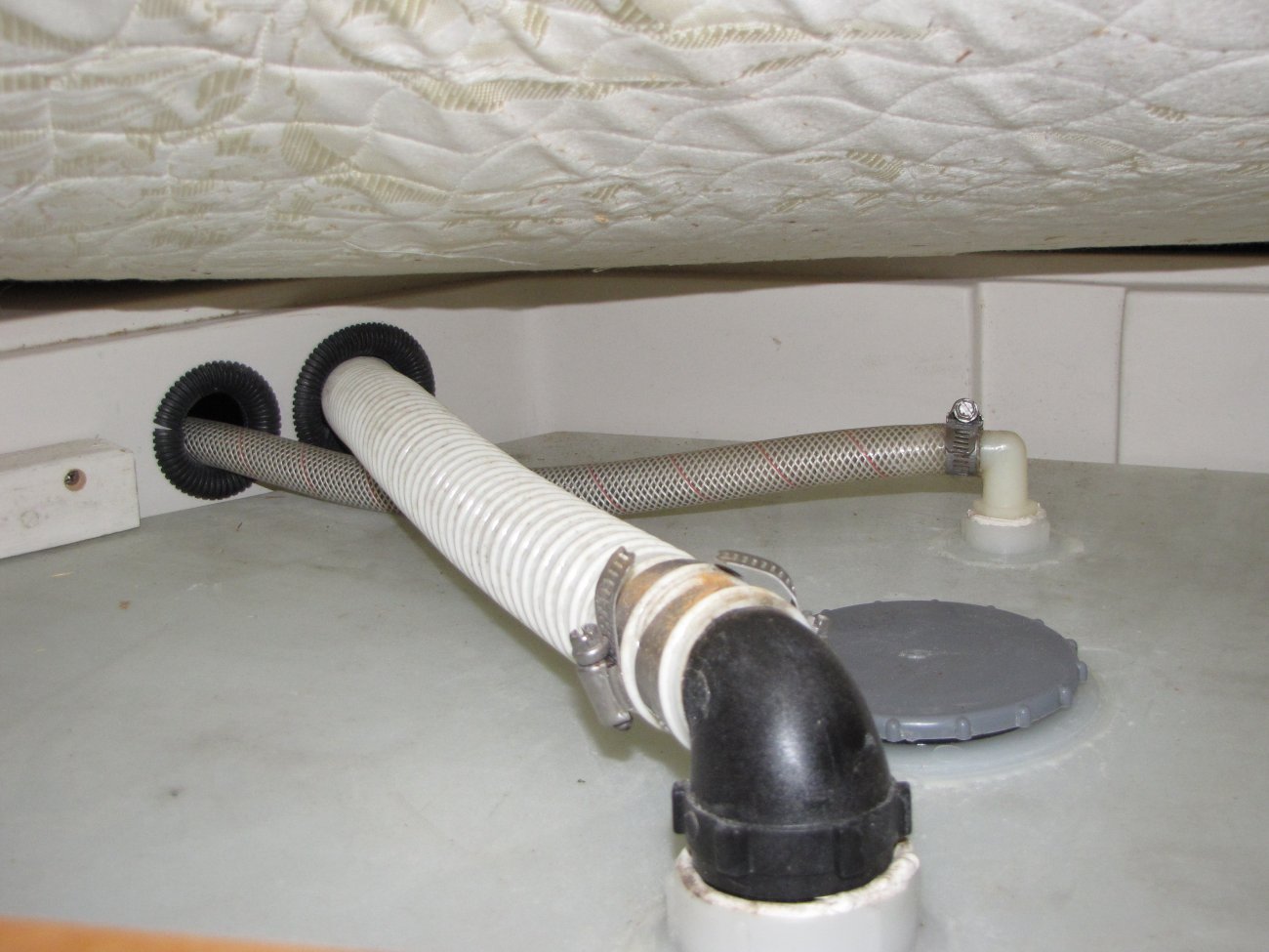

My vent for the water tank exits in the anchor locker as well. My concern with overfilling the tank is that, if I remember correctly, the elbow for the vent is at the top of the tank, and that is what lifts the board under the mattress. If anyone were to sit on the mattress while it is lifted, the elbow would probably be damaged.

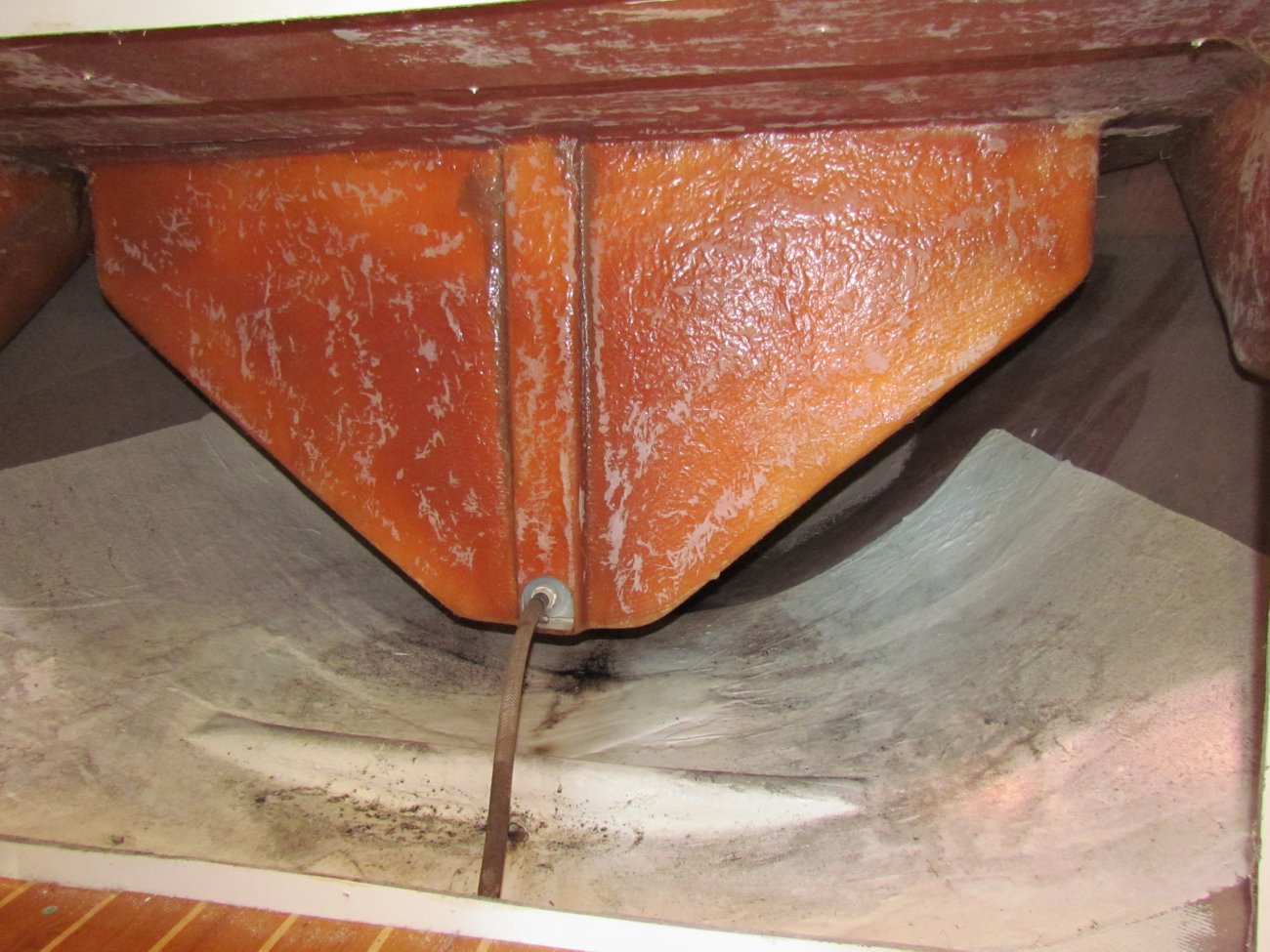

The first time we filled the water tank on our C310 (hull #31), by the time I realized it was overflowing out the anchor locker it also overflowed under the bed and into the bilge. Now I’ve got a flow meter that lets me put 35 gallons in-works as long as the tank is empty to start. I’ve got the parts for a tank monitor, but have to pull things apart to put the sensors on it.

Hard to add sensors to tank.
I sealed the gray cover with silicone...no more leaks.

I added sensors to the outside of the tank. Actually not that hard to do on the fresh water tank. The holding tank was a little more difficult.

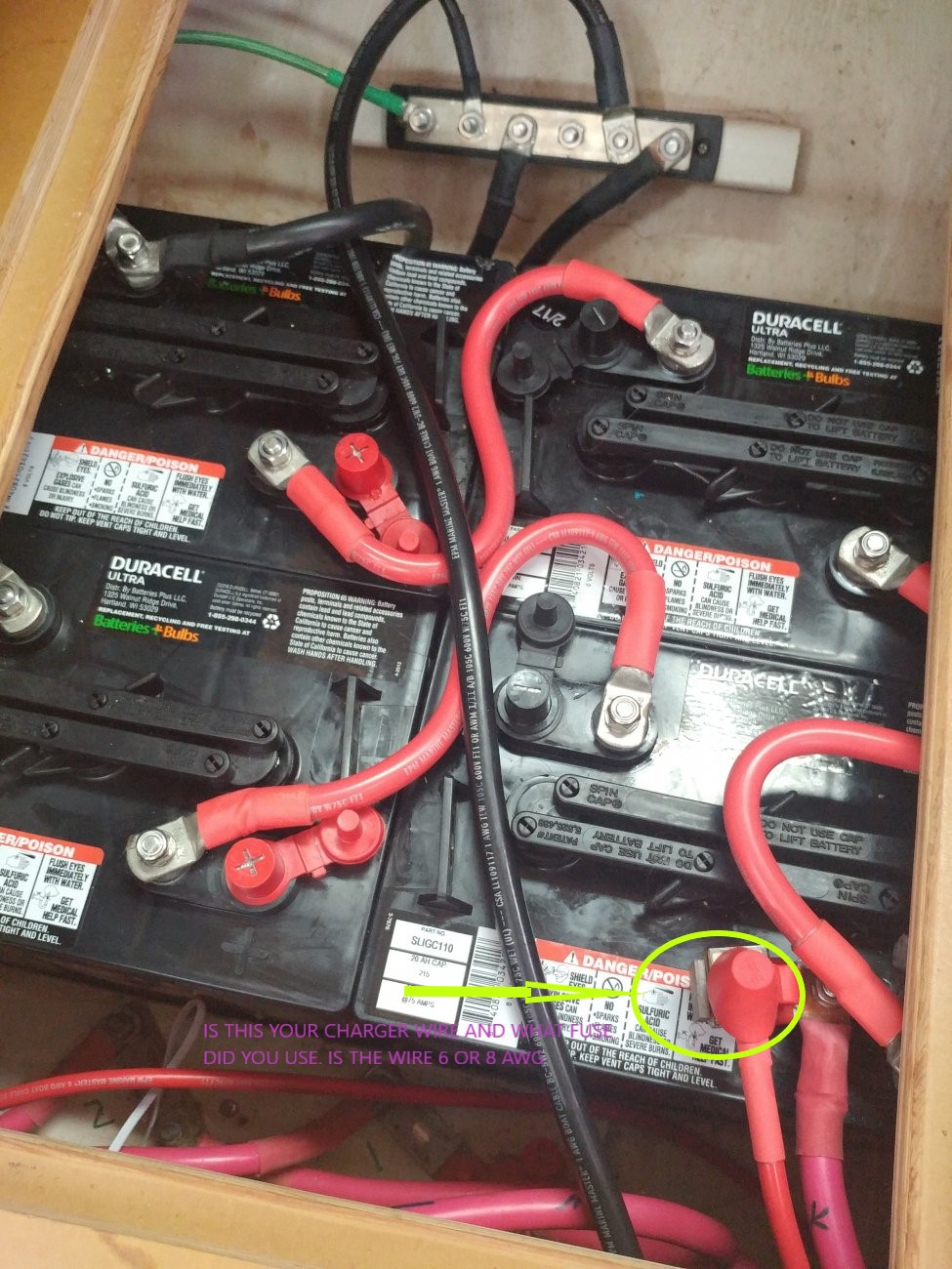

@2 OLD PIRATES they are all in there, the starter is under the wood and has to be removed to see it. I really am struggling with a full understanding of this area, so next time out I'll see about taking it apart and tracing the wires. It all works really well and there appears to be no issues with charging it. I got lucky that I didn't have to figure this out myself to make but now really need to get a solid understanding of what I have.

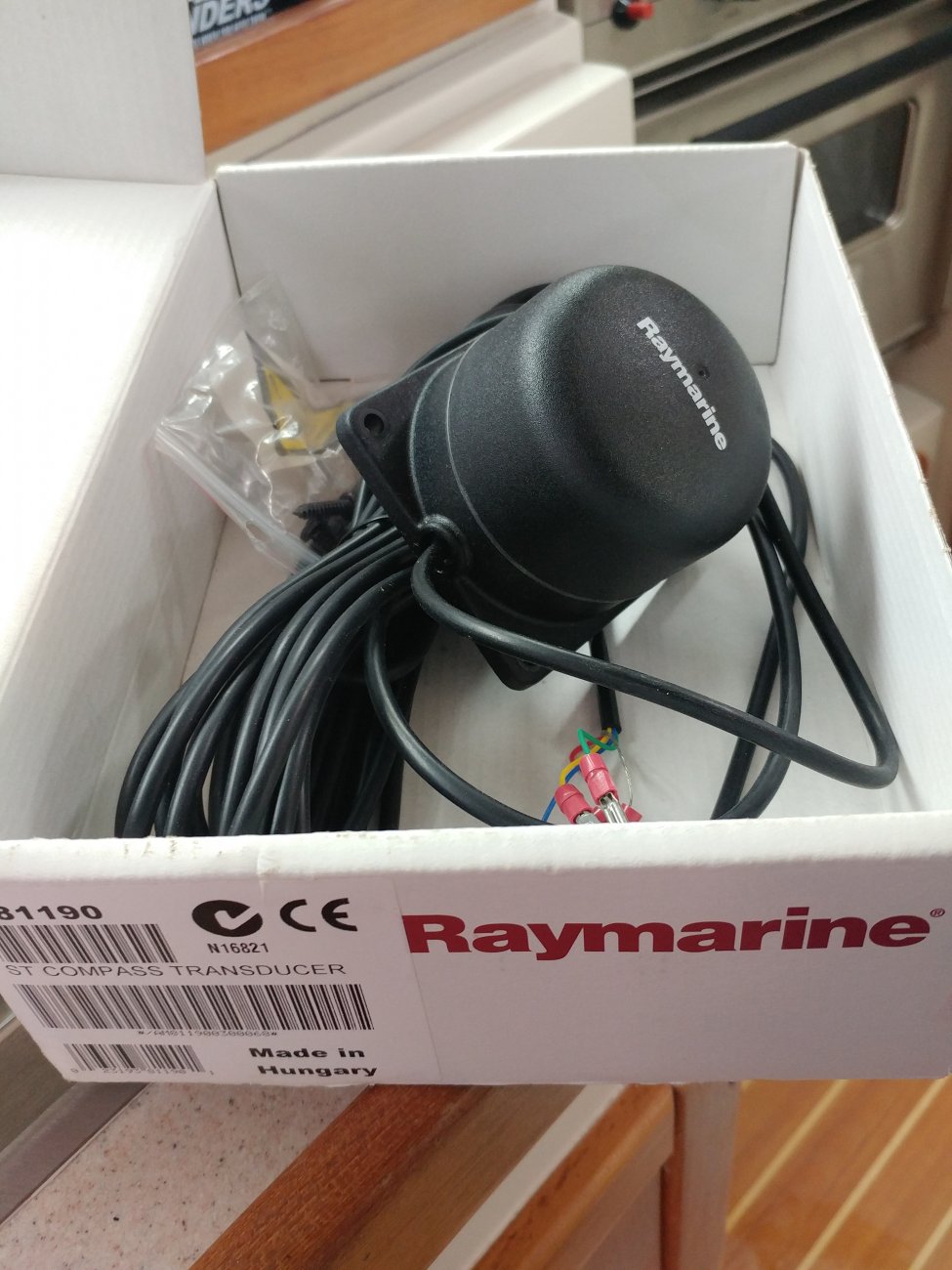

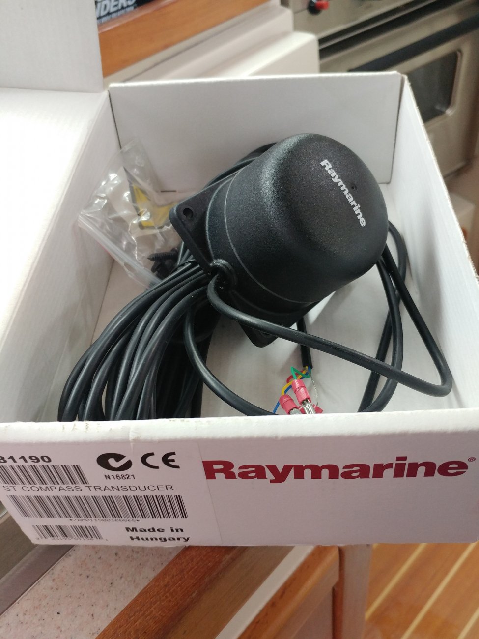

Crap weather for Alabama today but made the boat my remote office and also found this.20190419_124336.jpg
Box says ST Compass Transducer, nothing on it says that and it looks new. Any ideas?
10,254
Looks like the flux gate compass that I have connected to the Raymarine autopilot
