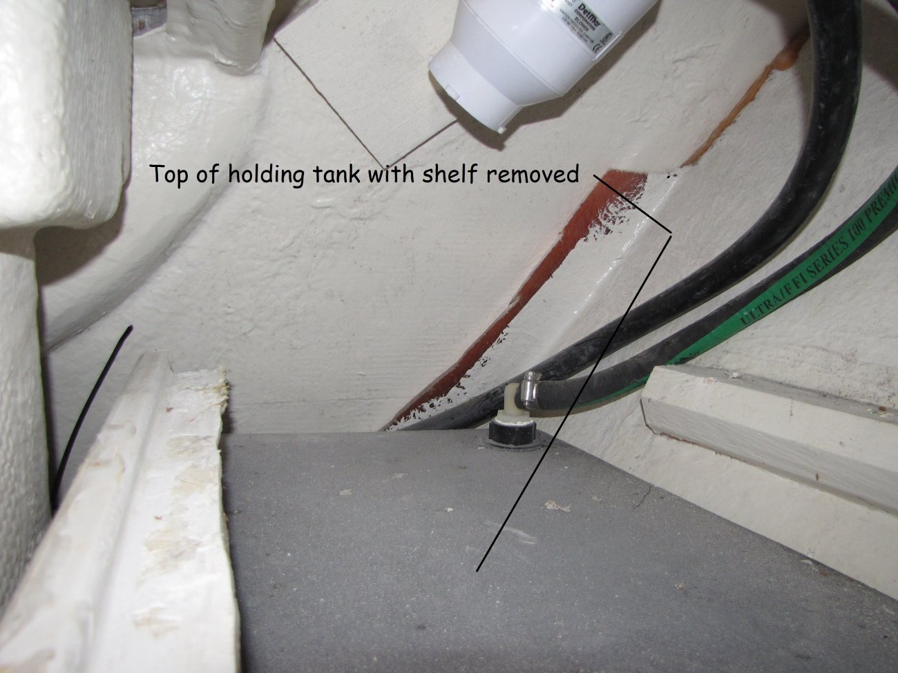

Use a screwdriver blade, pliars or whatever works to knock the screen loose.
It's not hard to replace the vent thru-hull with an open bulkhead thru-hull. You need to remove a thru-hull from the INSIDE of the hull. There's a nut on the threaded barb..remove the vent line from the the thru-hull, then back that nut off the barb...you may have to scrape some bedding compound out from under it. Push the vent thru-hull out (there may be bedding compound under it on the outside of the hull too)...stick the new one in...apply new bedding compound on both the inside and the outside...tighten the nut, put the hose back on the new barb...you're done.
--Peggie

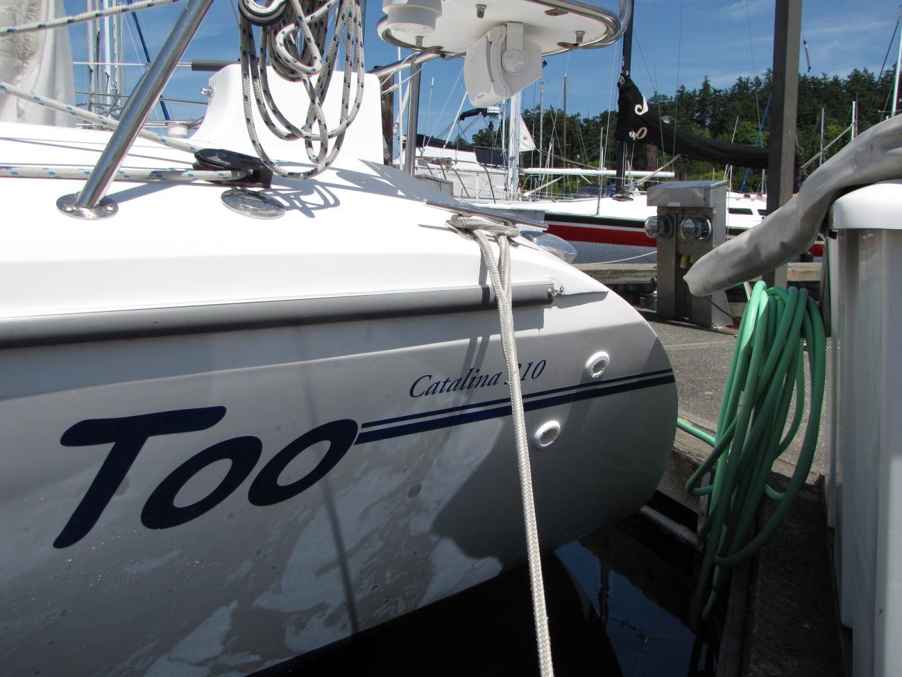

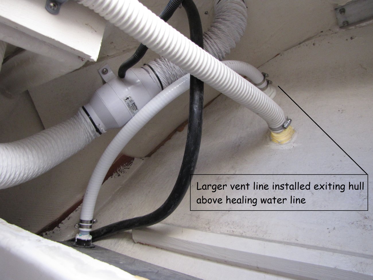

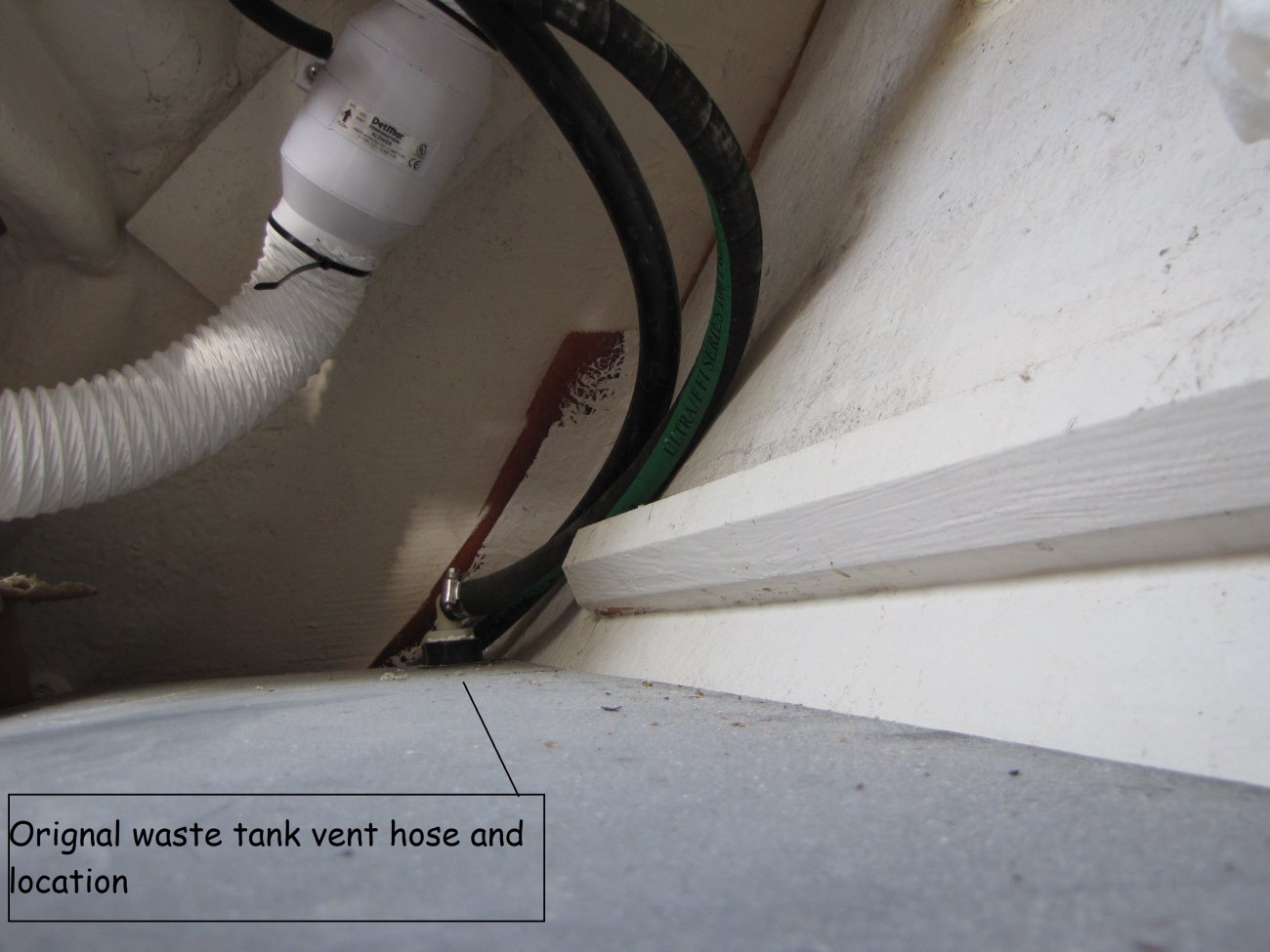

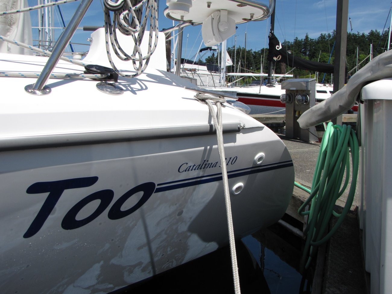

Peggie, the factory tank vent is about 1/2" ID max. and mounted on the transom (mine looks just like the fuel vent!). You could remove it, enlarge the hole, and put a open bulkhead thru hull, but it would face up, and take on water in the rain. I just removed mine, patched the hole, and put a new fitting just above the bilge pump thru hull on the side. Easy peasy. Someone here has some good pictures of the process-I keep forgetting to take them while I'm doing the work!

Routing a waste tank vent to the transom is just one more example proving that boat builders--even the best ones--are the WORST sanitation system designers (assuming there actually was any design to it) on the planet...I've even seen vents off tanks installed in the bow run all the way to the transom! Moving the vent thru-hull to the side of the boat was definitely the smart thing to do. I just hope that resulted in a shorter straighter vent line too.
As for photos..installing the new thru-hull was no different from relocating a vent line from a rail stanchion to a thru-hull in the hull, and enough people have photo documented that job to provide a pretty good idea of how to do it.

With a 1/2 inch hose, remember that fittings will lessen thet, maybe by half. Using "Pi r squared", doubling the I.D. makes 4 time the cross section .

At least they didn’t run the vent forward to a stanchion!! Actually, the length stays about the same, but that’s because the tank is all the way aft.

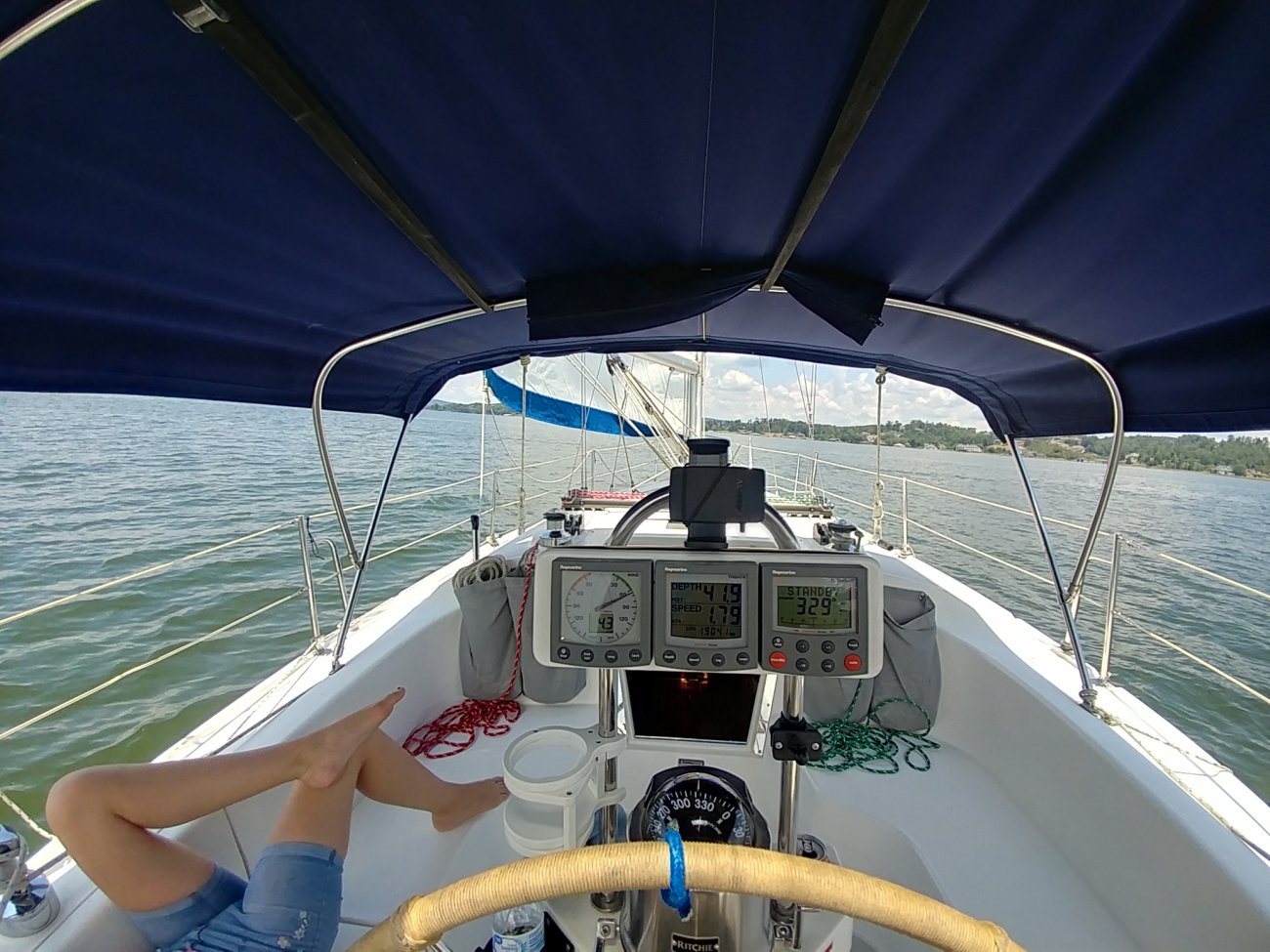

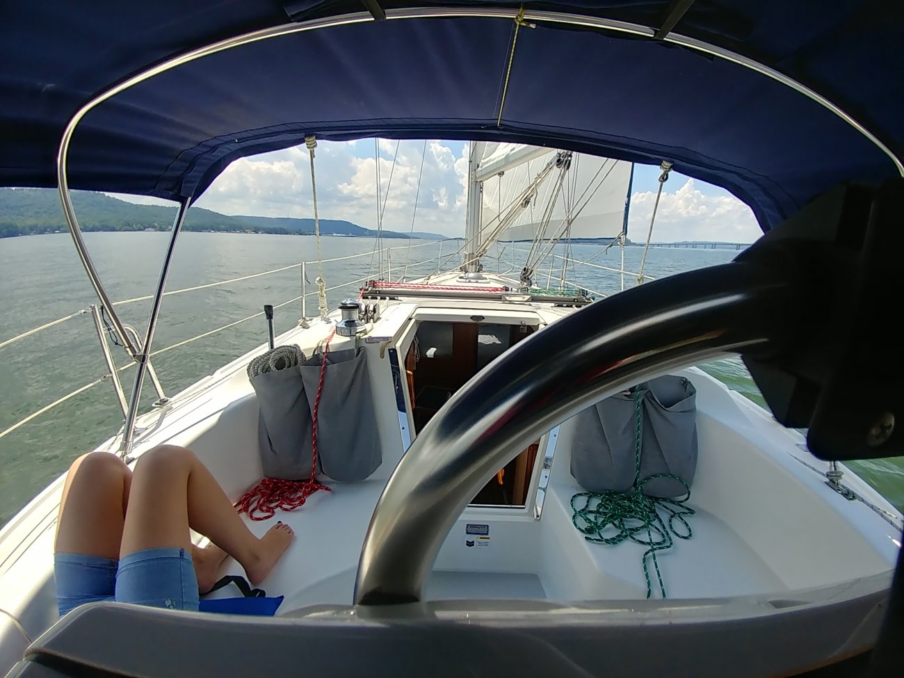

Sailed today, its been 3 weeks since I was at the boat and a month since we sailed. The heat and lack of wind in Lake Guntersville is the reason I missed my goal to sail every month, I missed July.
My daughter got up early with me and after a motor issue we left at 10:30 AM. It was a lite wind day so we were in no hurry. The good part was we experimented with different points of sail and trim, this was helpful for our point of reference. Did get a few decent puffs so some how managed to cover the most distance so far. Was a good day with my girl for sure, and I remembered to take pictures this time.
