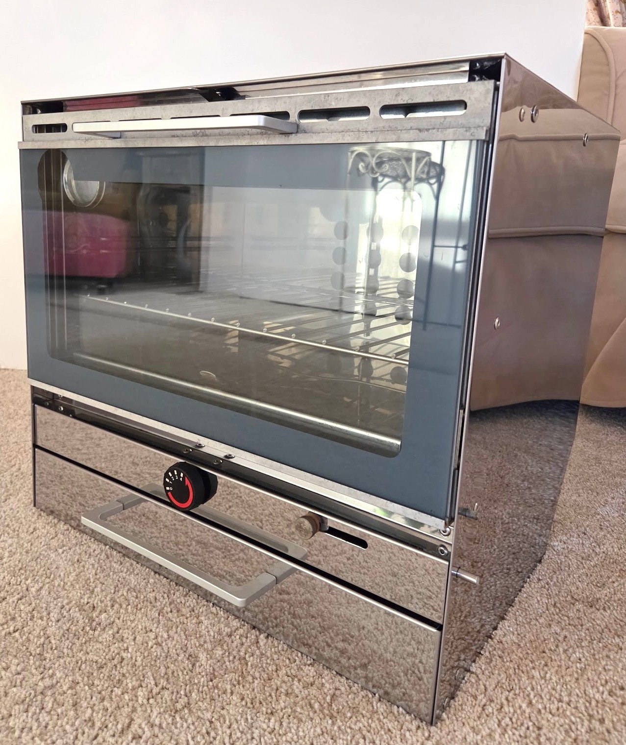

As I said earlier in this thread, I have a brand new in the box Origo 3000 and all the fixings. However, I am now keen to find the oven, or a full Origo 6000. Anybody got any current leads?
