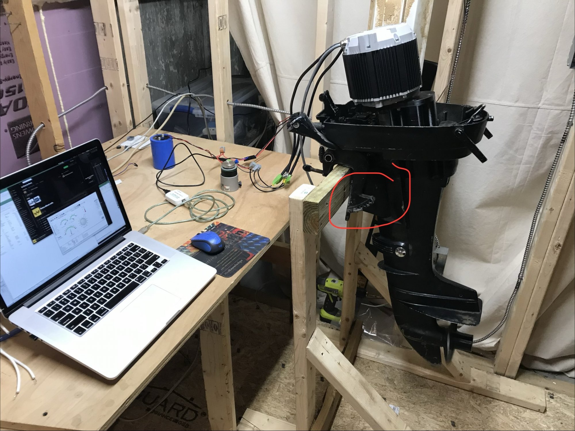

Sorry about the picture quality, but there’s a pin that slides in near the base of the mount. If you lift the motor and look up at it you’ll see the latch arm that grabs it and holds it down. It’s released by a little lever near the starboard mounting screw.
if yours is anything like mine (admittedly a 6hp but I think it’s the same design), after 50 years the grease has solidified and the latch doesn’t move freely.
Be nice if its a simple fix and just gummed up. Just trying to get my bearings on what is what (get caught up on the names of things without a visual)...from what you mentioned. I've poked around a did some work to my Mercury, but I am new to these motors...and motors in general so forgive me for bein a noob. We all gotta start somewhere right...
Can you help me understand where and which way this "pin" slides in near base of the 'mount'?
- Does this pin slide in laterally?
- Can I see this pin while looking down at the outboard while its on my boat.. or do I have to take it off and get it up on a stand?
- The 'mount' is the bracket with the 2 clamps that holds the motor to the boats mounting plate, right?
"Released by a little lever near starboard mounting screw"
- Can I see the mounting screw while the motors still on the boat (in your circled red area)?
- Is the "lever" hidden up and under it?
- 'starboard mounting screw'.. out of the 2 clamps..this is the clamp on the starboard side, right?
So your saying that possibly, best case senereo, my latch is just siezed up by old hard grease. If I clean it out and get new grease on there it mught just start latchign again?
What kind of grease do I use?
Appreciate the help!! I'm lost here without it.

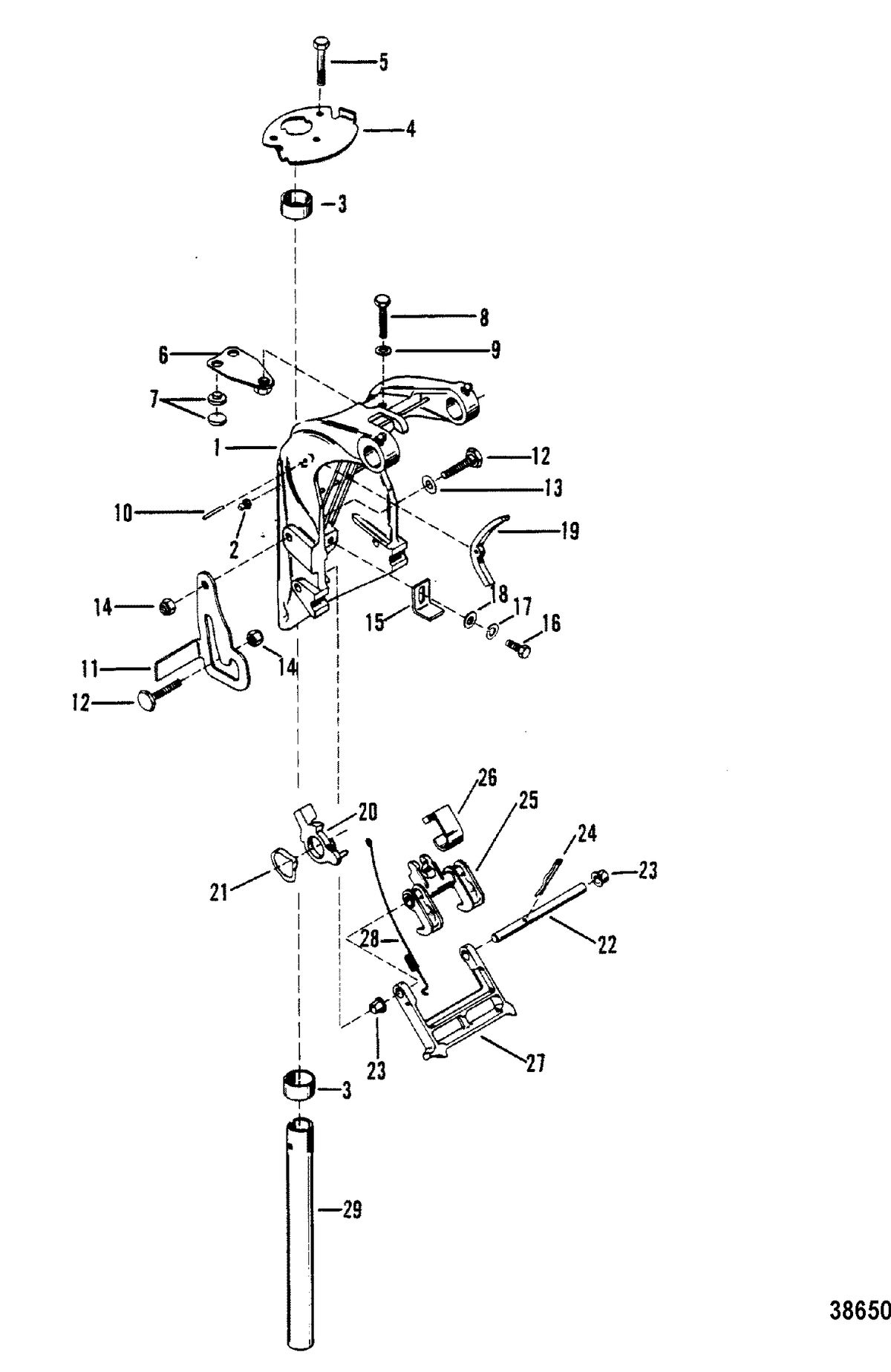

Then put it in reverse gear. Then pull the motor away from the boat near the propeller. It should not pull away. There is a mechanism just outside of the lower that moves up and down when you put it in forward and reverse. As I remember it was an adjustment on a rod that had to be extended to lock in properly.
If you do not have a trailer then you will have to remove the engine.
The images you have posted are not where the adjustment is. Look at moving 3/16" rods just behind the lower.
Here is a link that might help.

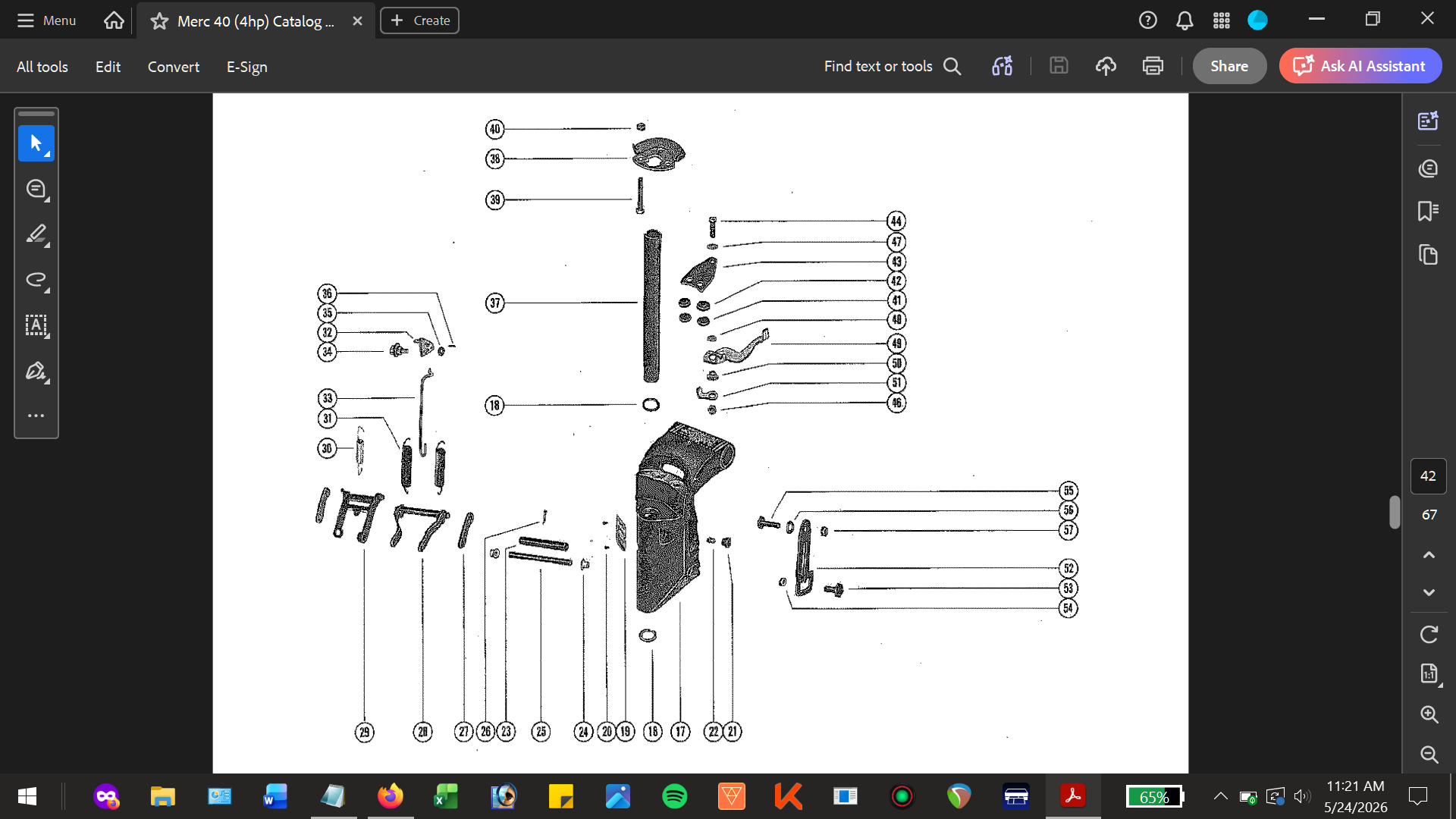

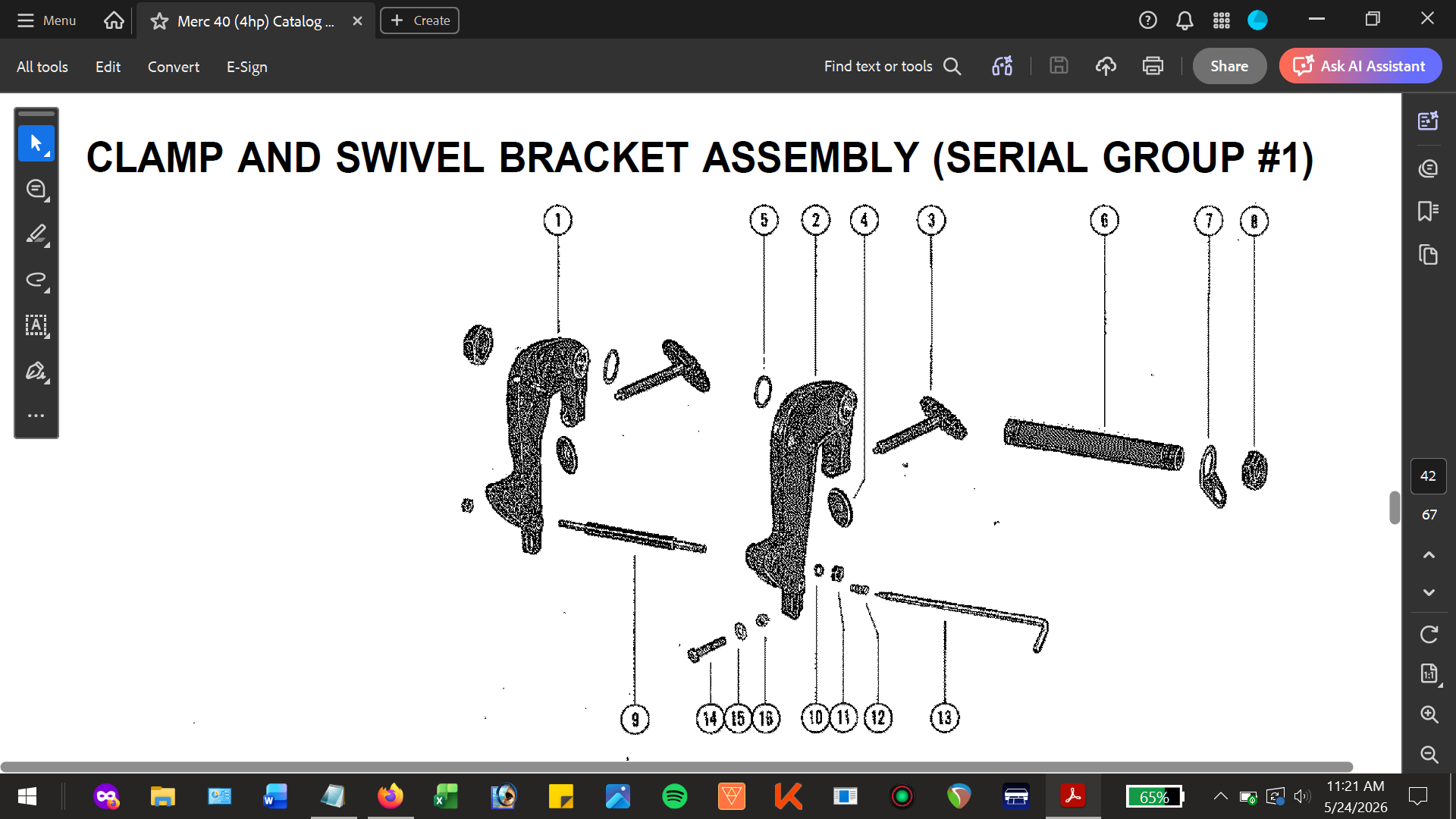

Had a 50 HP Merc ( circa 1981) that had a similar problem. There was a bracket with a hook that swiveled down to engage a horizontal shaft similar to #9 in the schematic. The hook was either broken or bent that prevented it from engaging the horizontal shaft when in reverse allowing the motor to rotate upward when power was applied.

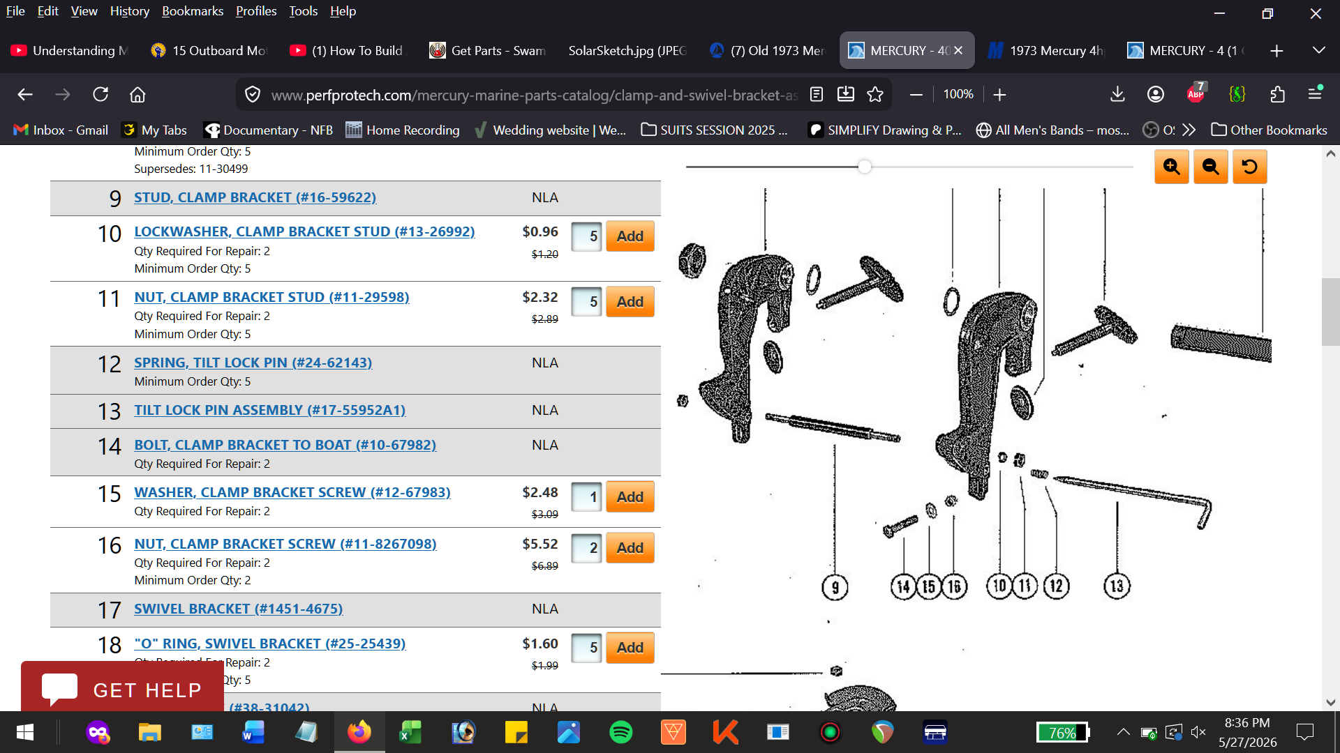

This looks like the one... not sure if it matters but my serial number is lower than what is stated at the top. Mine is 3654641. I have never really looked up inside it yet, but it all looks very similar to mine, if not exact. I know mines a USA and 1 cyl and 4 hp so that must be the one,
MERCURY - 4 (1 CYL. PRODUCT OF USA) - SWIVEL BRACKET ASSEMBLY

That last diagram has the parts, numbers 10 thru 26. Might I suggest you go to your friendly Mercury dealer who might have some small mercs up on a stand and you ask someone to show you the assembly. That will give you a good idea of what to look for and you can pick up some grease while you're at it.
