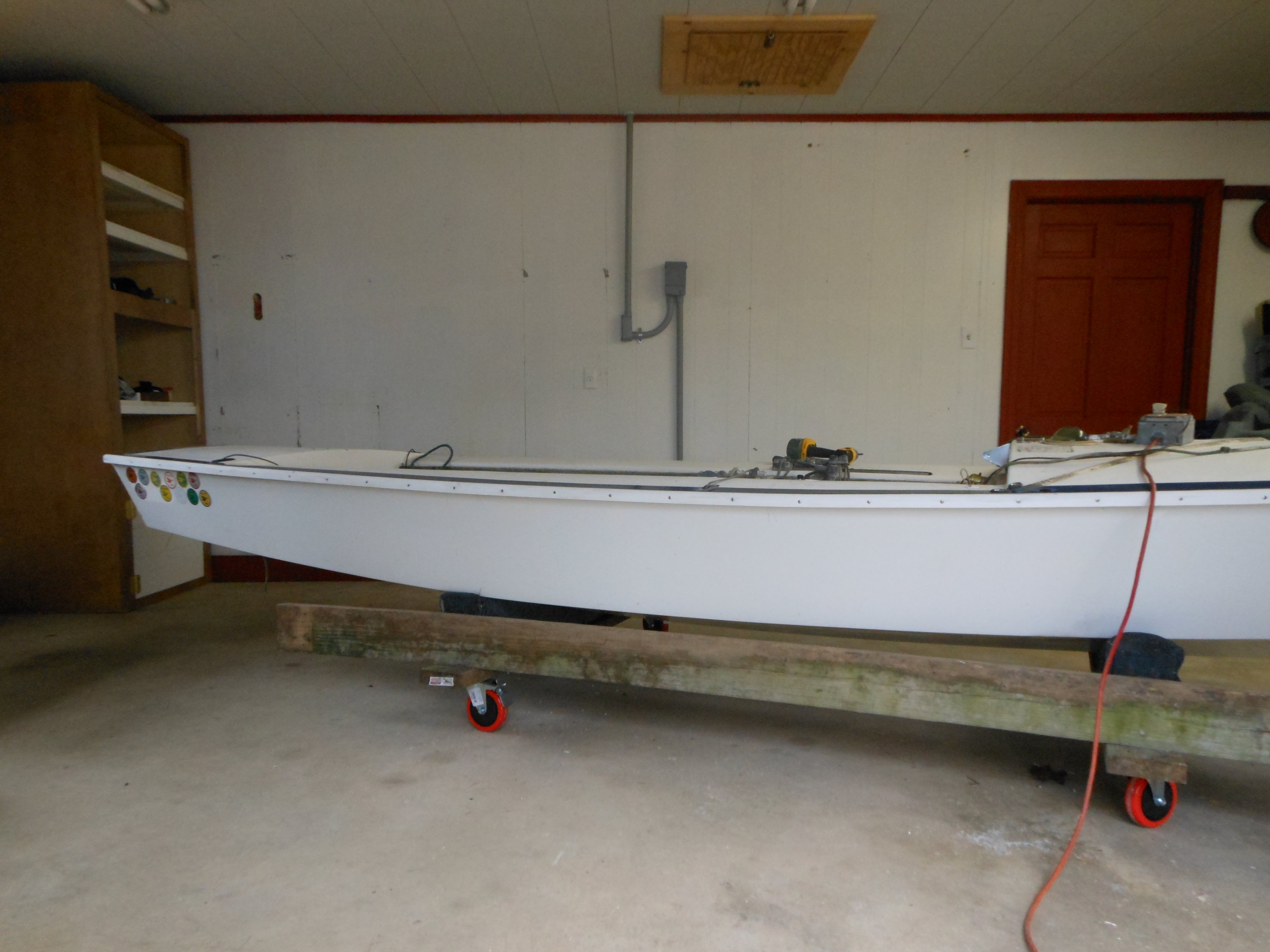

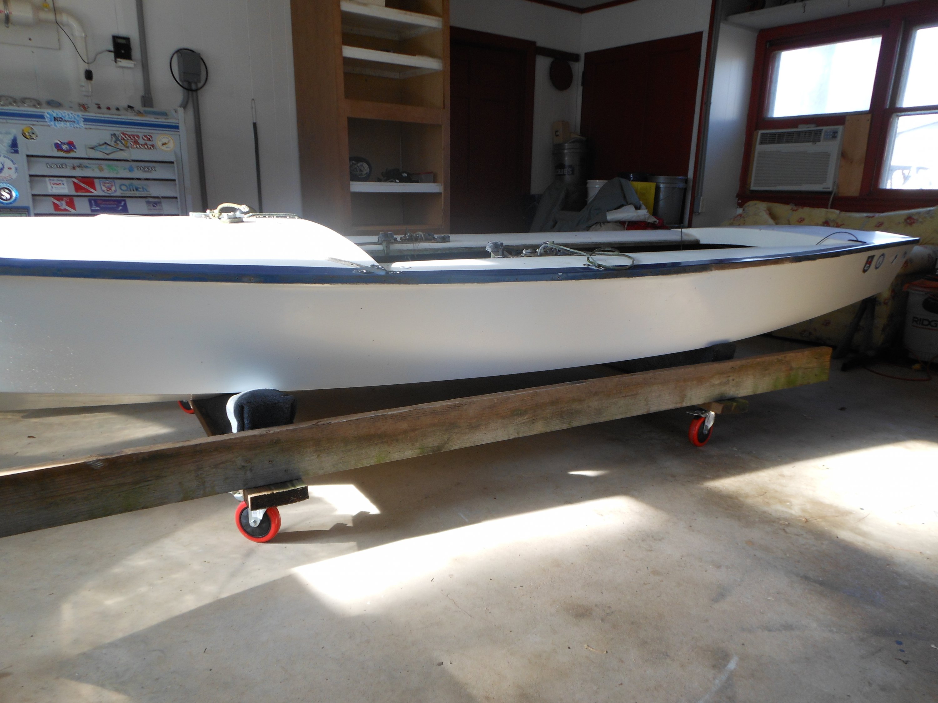

So after a trip to Tractor Supply to get some 5 inch urethane wheels that swivel with brakes, I have a rolling work cradle inside the old scuba shed, now known as the boat house. The six 10 adhesive epoxy worked well for filling the rub rail screw holes in the hull. Next up is installing the composite to replace the teak, and the new mast step.

I would be glad to share as the work moves along. I am tackling the mast step this weekend, and if the weather holds I am going to rip and shape the composite to fit. Trailer mods are also coming. I am installing a 12' tongue extension for beach launching and new rollers and mast storage for transport.

Sorry for the delays on the updates, work happens. I find myself endlessly noodling about the boat in my brain while at work. Carefull planning and forward thinking got 1 rub rail attached to the hull today all in one piece. I plan on the other side tomorrow with pics to follow this weekend after fairing the hard topside edge. The 610 worked like a dream and drilling new holes where I want them is a breeze. Speaking of which, the blow has got me juiced for the coming spring season. That's all I got for now till weekend pics. How is everyone else making out getting ready for the spring?

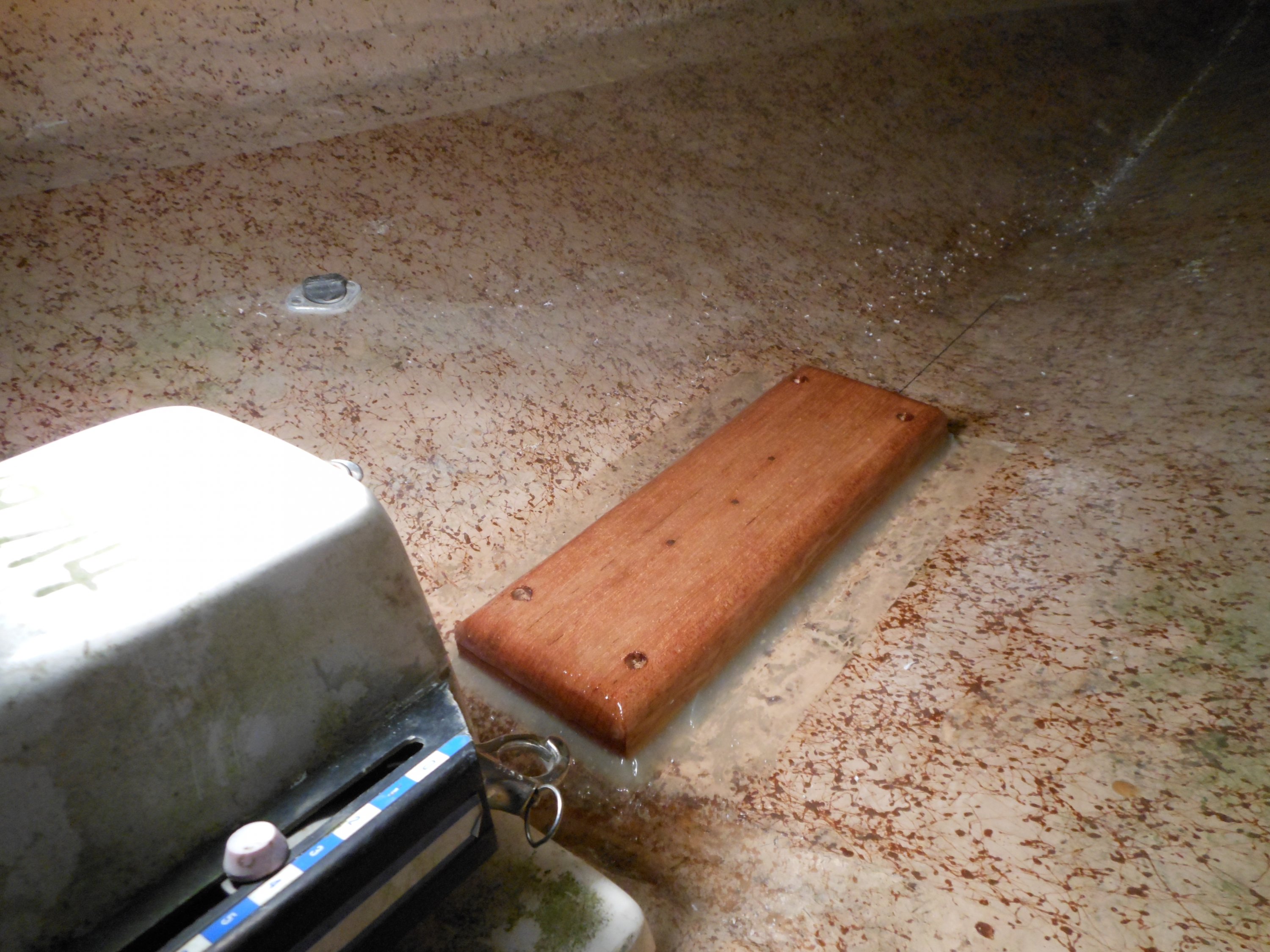

composite rub rail.JPG mast step mount.JPG So today I made banner progress, the weather sure is helping! Last week whilst ditching work early in the afternoons, I got the new composite rub rails installed and faired. Today I tackled the install of the new mast step mounting block. I prepped both surfaces, wetted out the wood, applied a tube of 610 epoxy with a notched spreader and fastened it to the hull. I then used the squish out to construct a nice fillet around the entire piece. I then wet out the rest of the wood block to seal the grain, prior to applying re-inforceing tape as time allows. Pics attached.

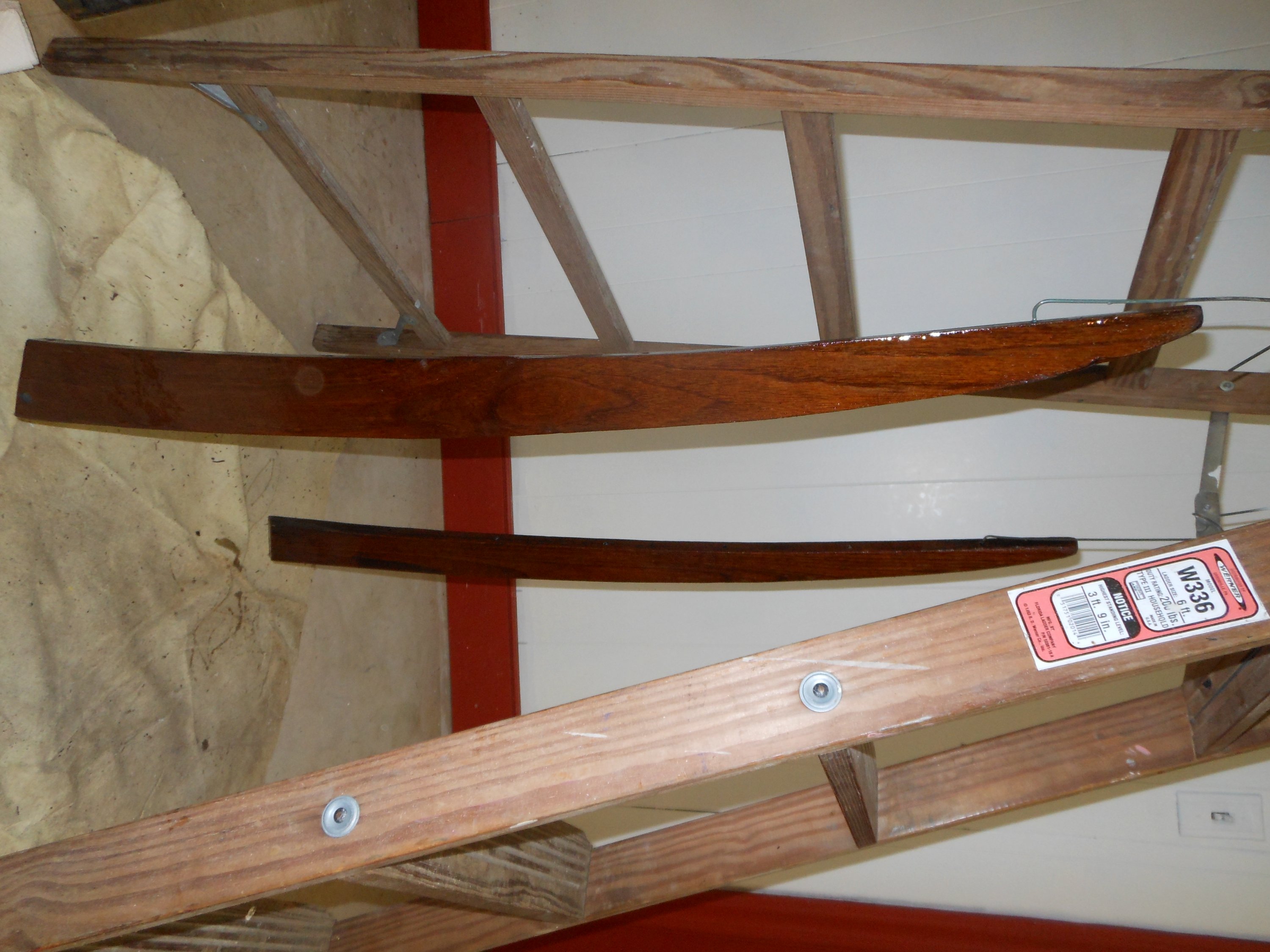

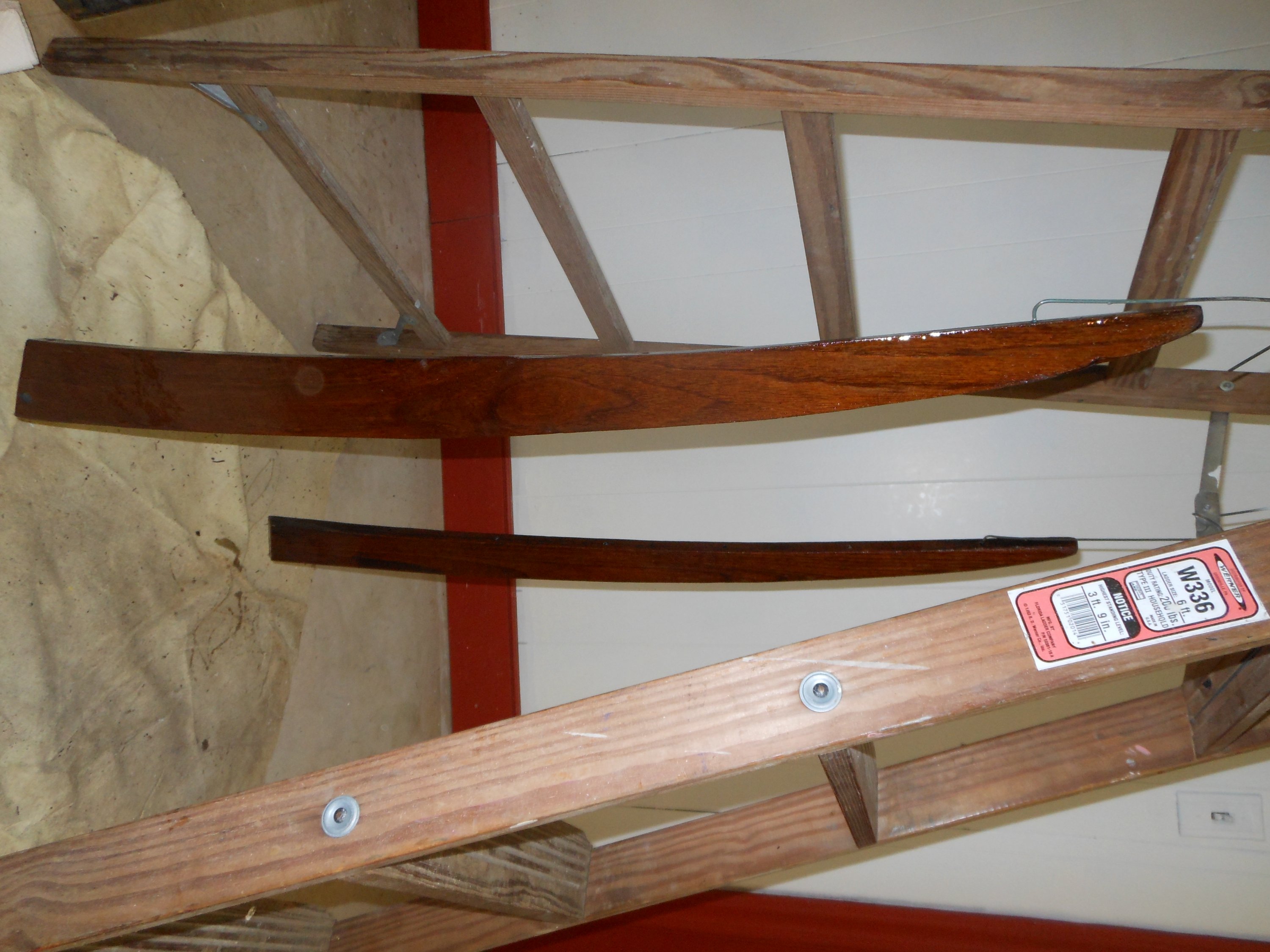

Well I made another good showing this afternoon as well as last Sunday. The weather has been helping out! Last week saw the installation of the reinforcing tape around the mounting block and the attachment of the new composite step from APS. I also took apart the badly damaged tiller and splash guard and stripped them to bare wood and made some repairs to both. I also installed a brass sleeve in the rudder for the addition of a tiller to rudder SS bolt as a keeper for capsizing so the everything stays with the boat whilst I get my $hit together. Today I wet everything out with west system. God I love bright work, but hate the maintenance! Thought I would share the pics prior to covering in paint for UV protection and low upkeep. lol! Time is getting short but I plan to be ready.
