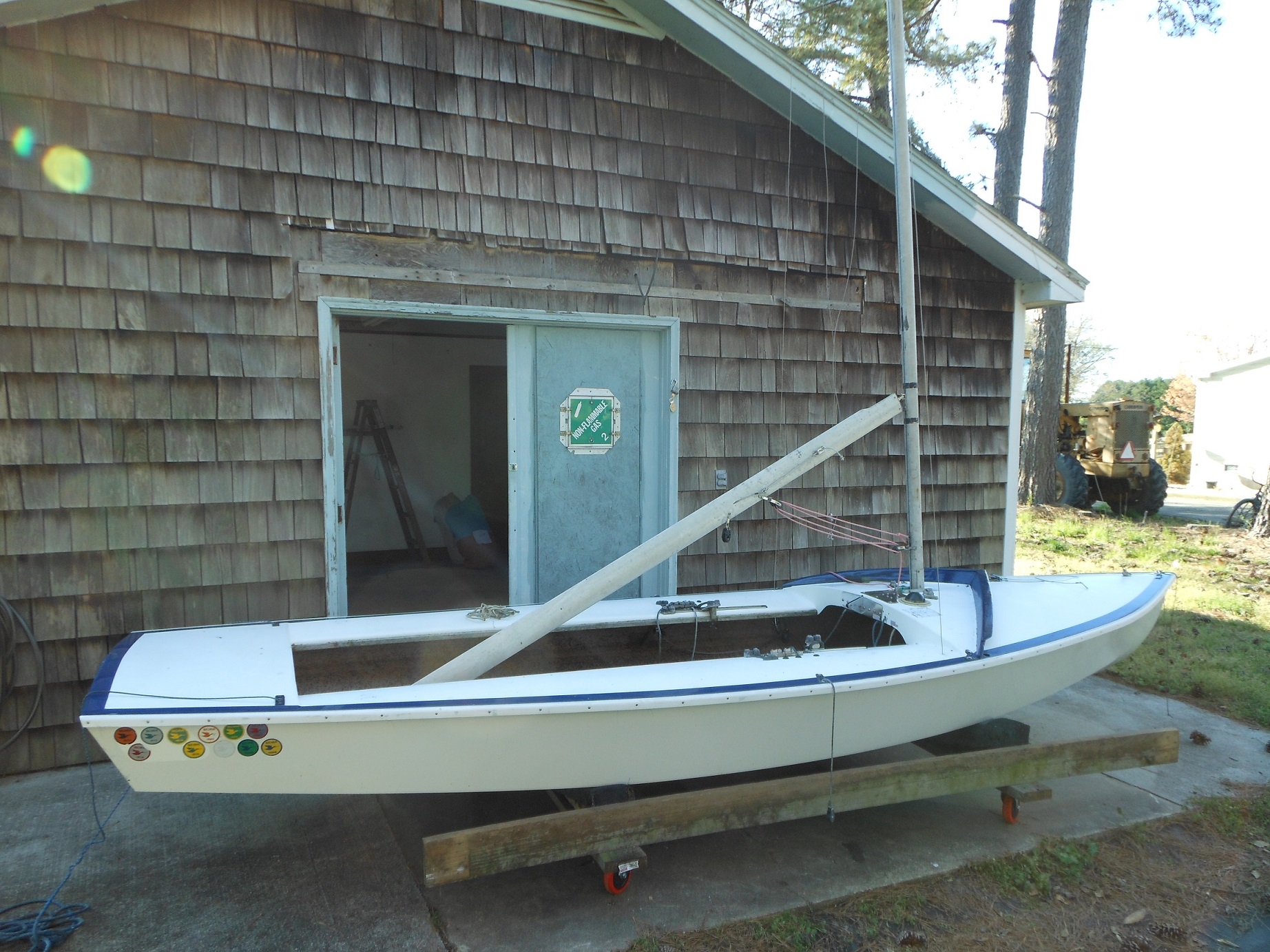

I hate when work gets in the way of boat work!
I am going to paint the wood I wetted out with the west system. Is there any paint that is a " no go " for UV protection? My current line of thinking is some rustoleom spray from the big box to make it quick and easy and no biggie to maintain. Any potential isues?

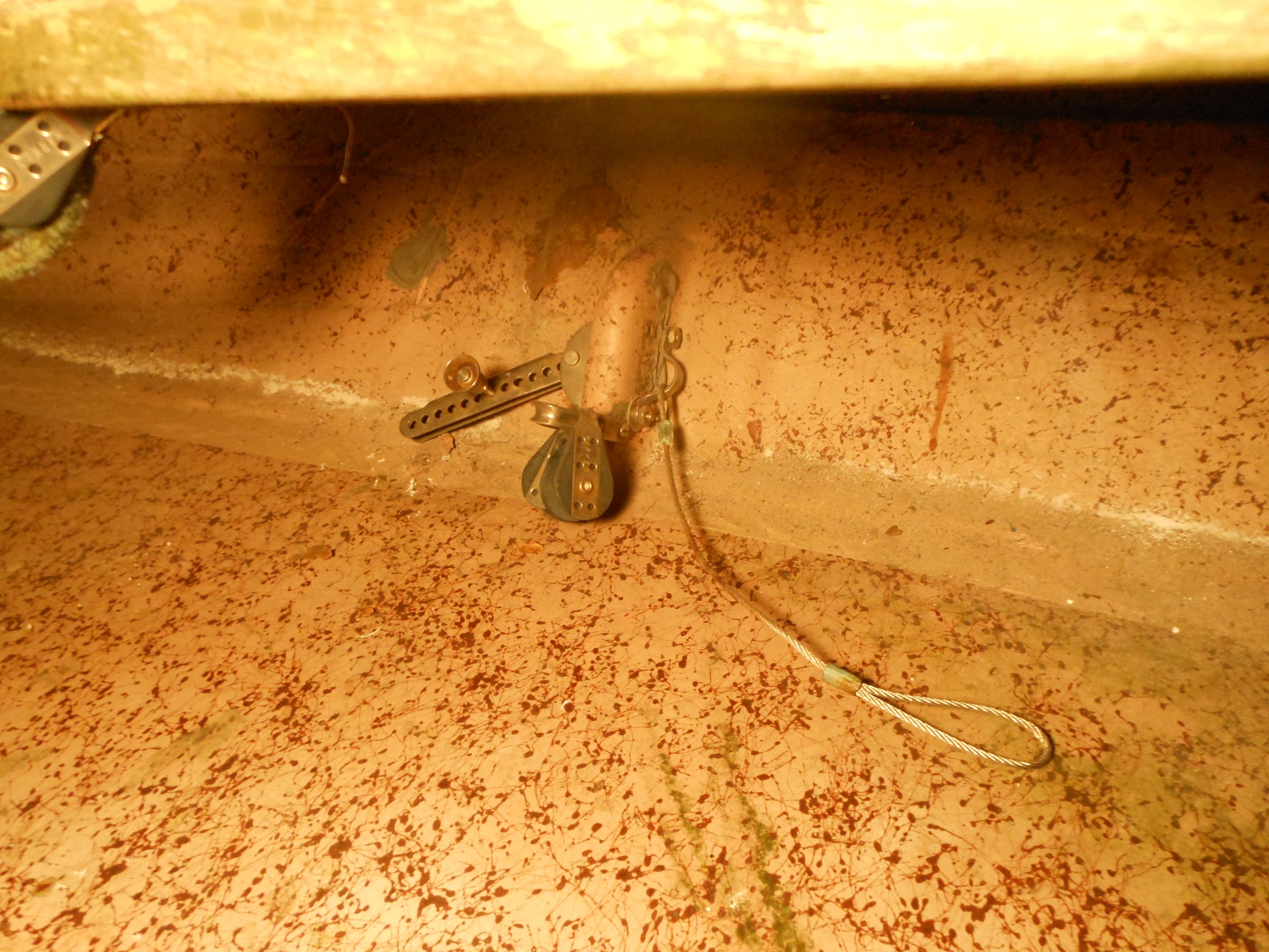

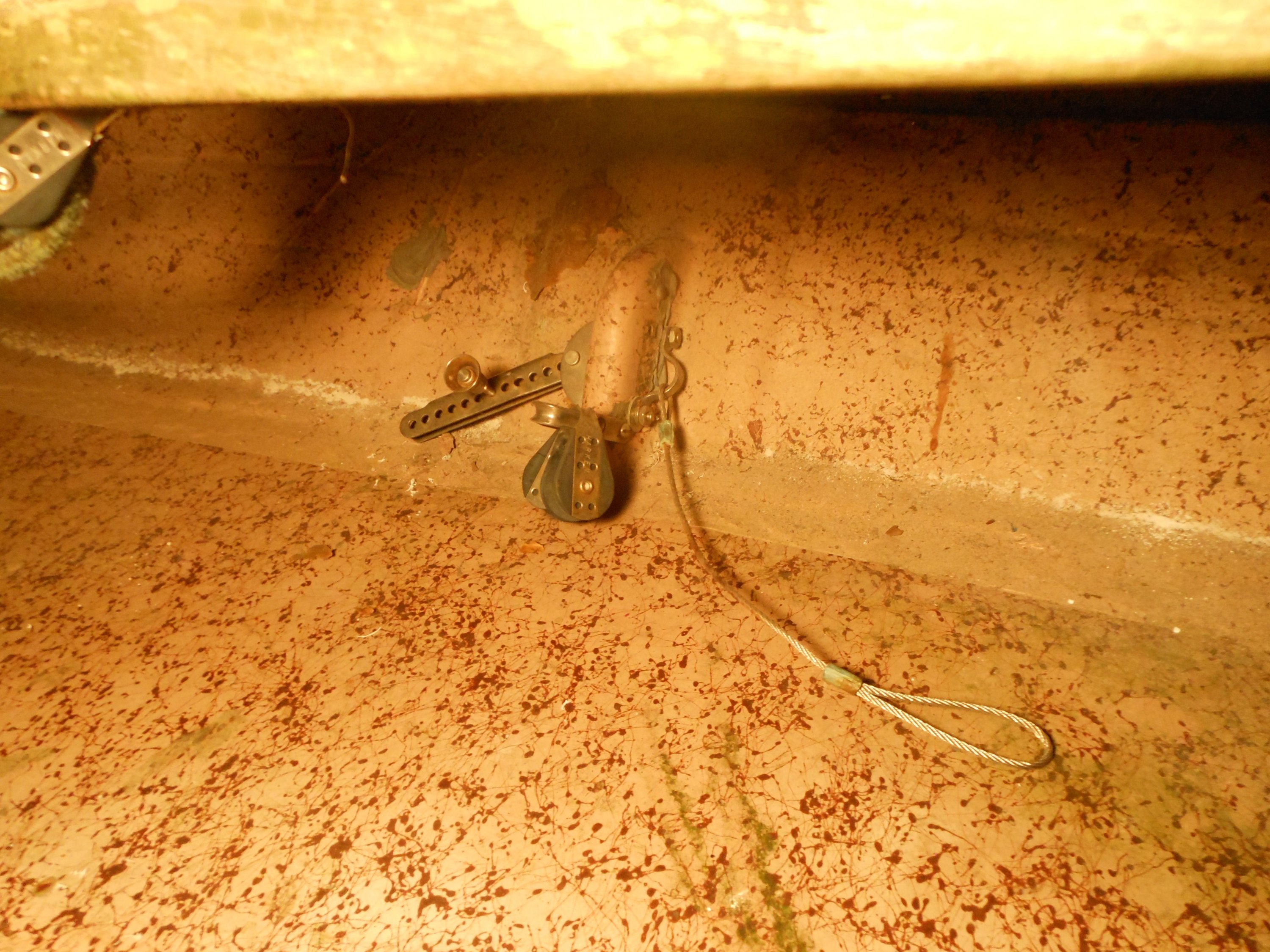

The work is progressing nicely! I am on to the standing rigging and got some questions. What I thought was a highfield tensioner is not?? How do the shrouds attach to what I got here? What is that short piece of cable for? Is there a quicker way to complete the task then what I got to speed up set up time prior to launch? Any and all help greatly appreciated.

View attachment 121149 The work is progressing nicely! I am on to the standing rigging and got some questions. What I thought was a highfield tensioner is not?? How do the shrouds attach to what I got here? What is that short piece of cable for? Is there a quicker way to complete the task then what I got to speed up set up time prior to launch? Any and all help greatly appreciated.
Eric
This is a "shroud adjustor." Allows you to set the rake of the mast, and quickly disconnect for trailering. You pull out the pushbutton pin, insert swaged eyelet of the shroud end, and pin it with the pushbutton pin. On my GP14, one steps the mast, and it is held in place by a bar in the foredeck cutout. So it stands unsupported while you get the shrouds connected. Once the shrouds are connected, then the forestay is lashed to the stemhead fitting with a couple turns of 1/8" polyester utility cord. This is done because the jib has a wire luff, and when hoisted, a highfield lever in line with the wire halyard or other tensioning device tensions the rig, and the forestay goes limp.
On the opposite side, the wire strop is probably used to lift launch the boat. I had similar on my GP14 that came up through the side decks. And in the stern there was an attachment point down on the floor. My second GP14 came with a wire 3 lead harness with clip on hooks. When I visited the club where it was raced, I saw they used a lift to launch the boats, which were stored rig up, and that's when I realized about the lift harness.
Practice speeds up rigging and launch. If you want, you could consider a checklist, maybe take it to Kinkos and get it laminated, then use a grease pencil to check off. That way, you can go down the list and check things off, thus keeping you focused and not forgetting anything you need to do.

Brian,
That makes a lot of sense to me now. My hull has a large shackle in the floor near the stern that was also giving me the quizzical look. I knew the pin moved in and out but had not crawled in there to see that it cleared the other side to insert the shroud end. Thank you a bunch! The check list is also a very good idea until I get squared away.

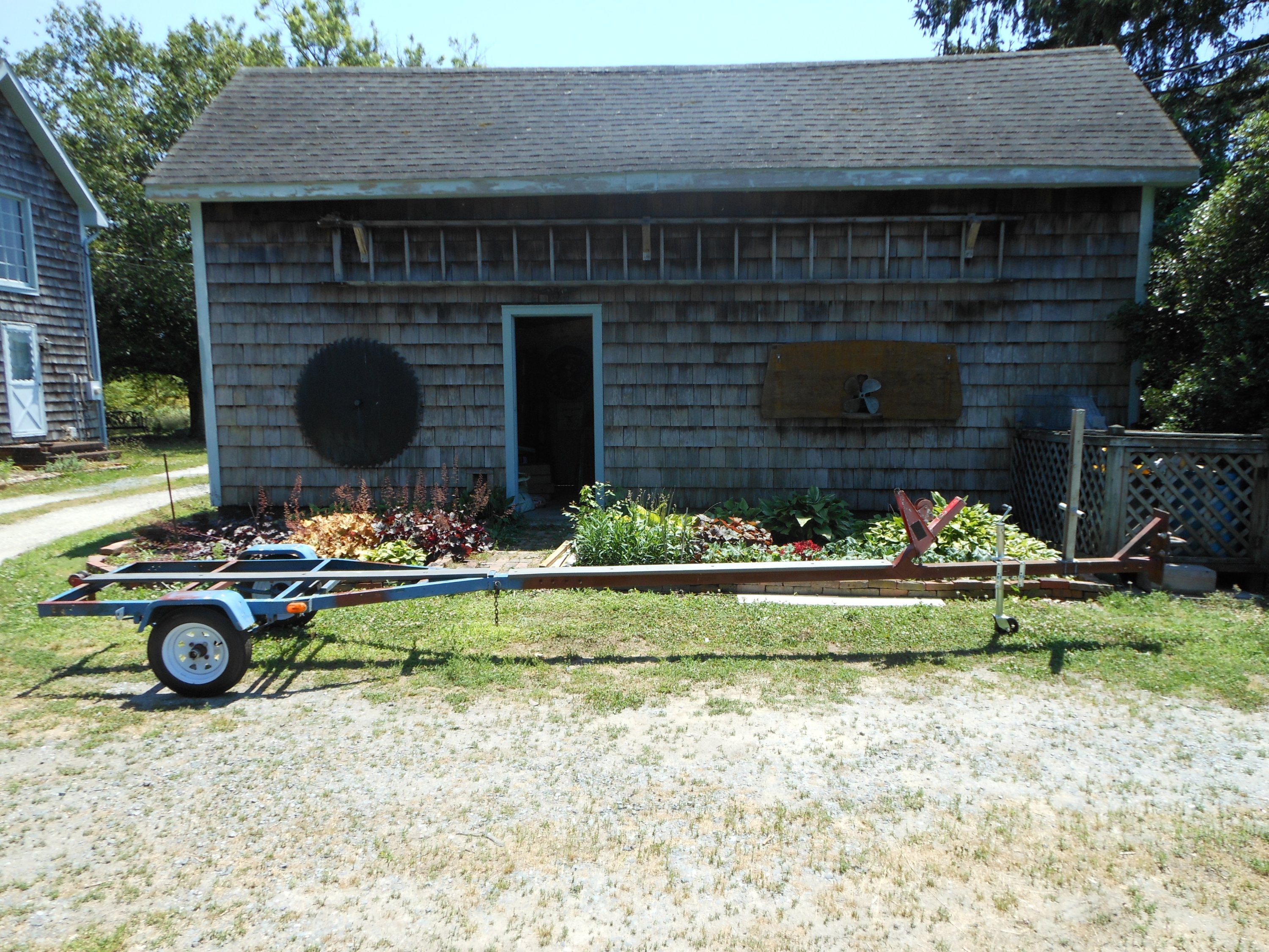

With all the talk of trailer trouble, I thought I would post trailer happy. Fabrication is finished except for the bunks, and I am going to need crew to set the hull on the trailer to fab them up. After that it off the motor vehicle office to make an application for a home built trailer. Then the launch. Work is realllly bugging me for time, so the project is way over my deadline, but I can see the end.

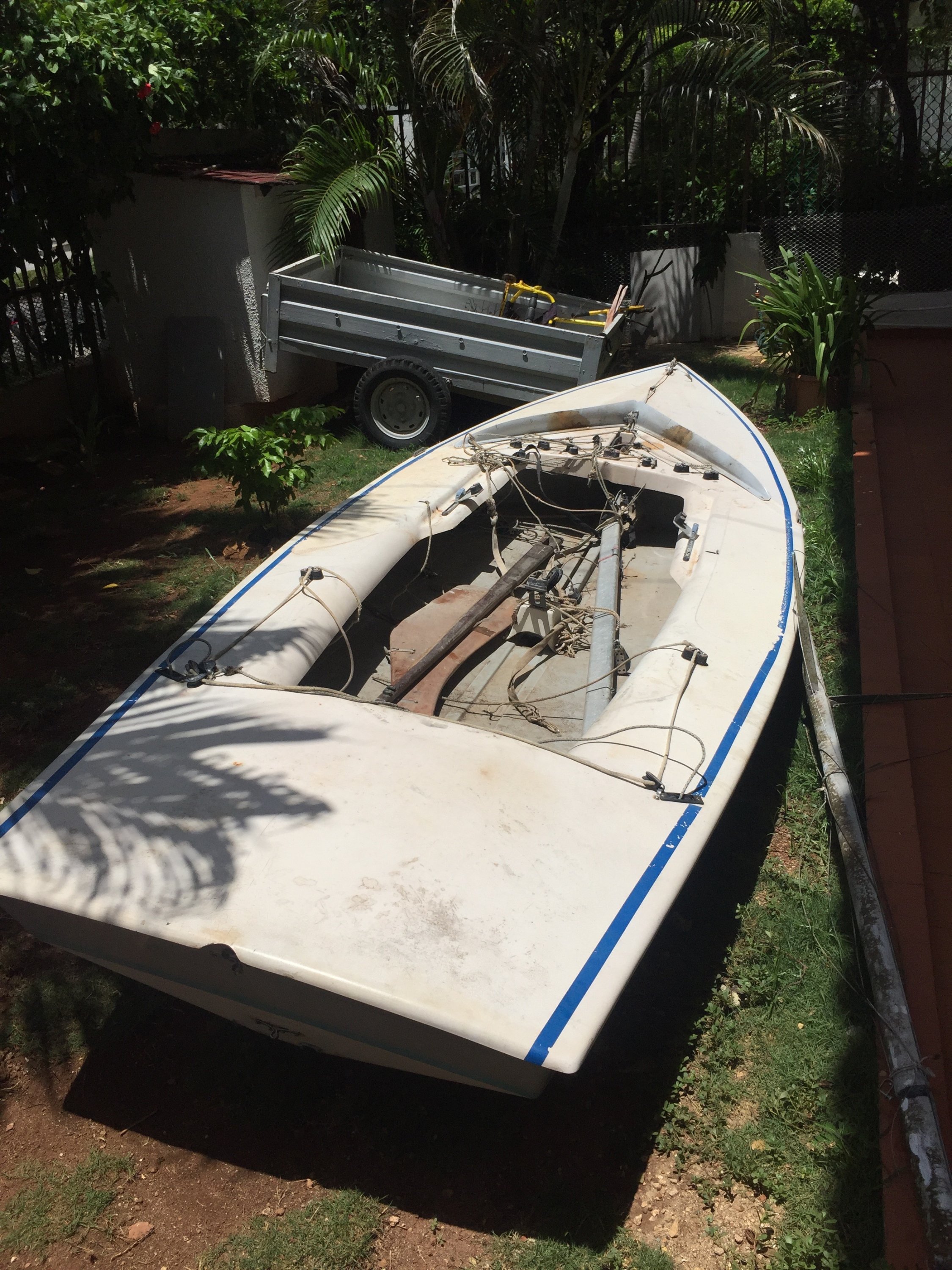

So I am grown up enough to admit that I may have a problem, attached is snipe number 3. I picked it up this morning for 200.00 It gives me all spare blades and standing rigging, plus another trailer. The hull is clean and light enough to race.
