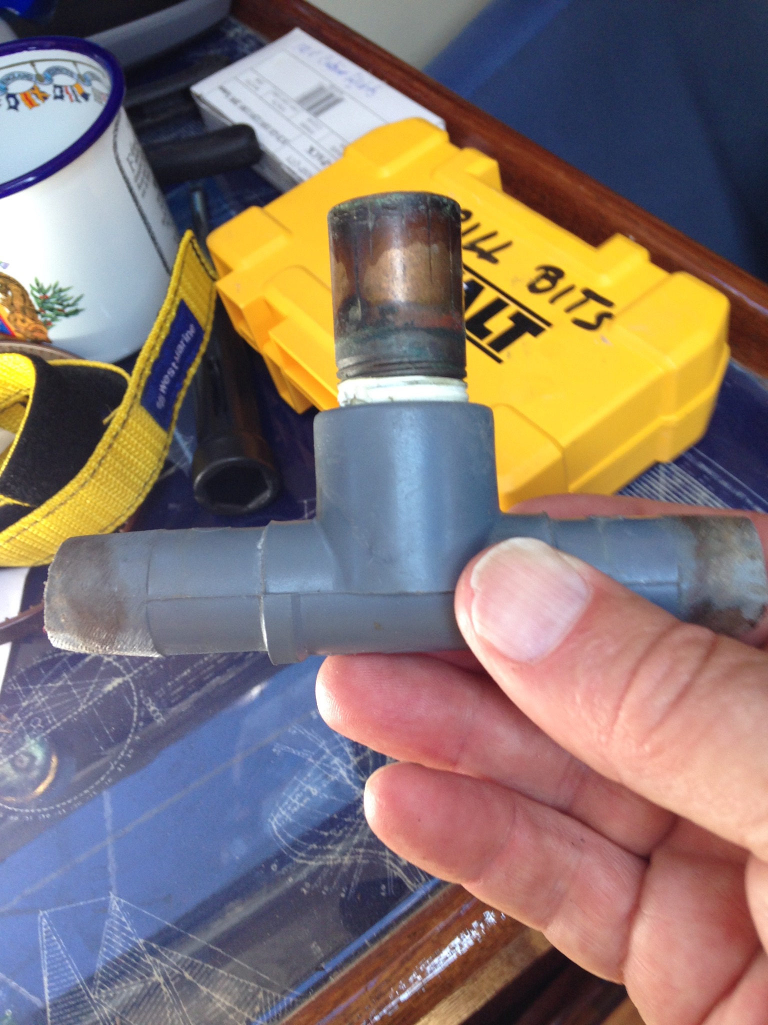

As a precautionary alert, and okay, a little bit of a rant, you never know what previous owners may have done. Here we have the tee fitting for the double sink drains on our Catalina 30. As you can see a PO, instead of taking the time and effort to properly install the hoses on a proper tee, made their own custom unit which did require the time and effort to grind off the barbs! Granted this is the drain and would normally not be pressurized but it is still connected to a thru hull, which btw, was only single clamped. :deadhorse:IMG_1081 (2).JPG

Don't feel bad I just replaced a white plastic PVC ball valve, that split along its entire length, because it had been threaded directly to a thru-hull fitting. The owner was very, very, very lucky I noticed this before he launched.

I think you will find that t-fitting configuration was not OEM, and a dead give-away of rogue DIY'ing. The sinks should be rigid plumbed together using proper threaded plumbing fittings and only then coupled to a discharge hose.

Nope, for a Catalina 30 of this vintage 3/4" clear vinyl hose is the correct factory install. http://www.catalina30.com/techlib/PartsManual/Systems.pdf

That was never a hose adapter just a pipe nipple with one of the threaded ends cut off. A very popular PO trick..
