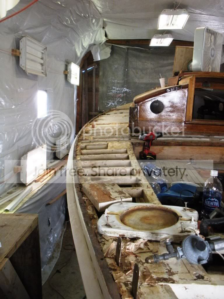

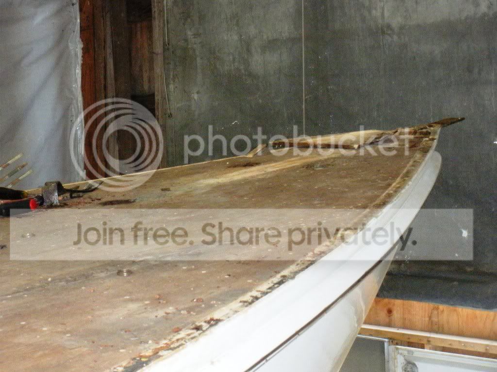

More fun lately. We're getting down to the bones and finding less issues than anticipated.
You can see how dry this old wood is.

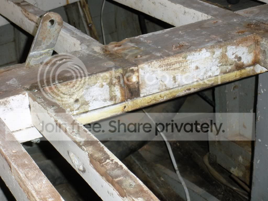

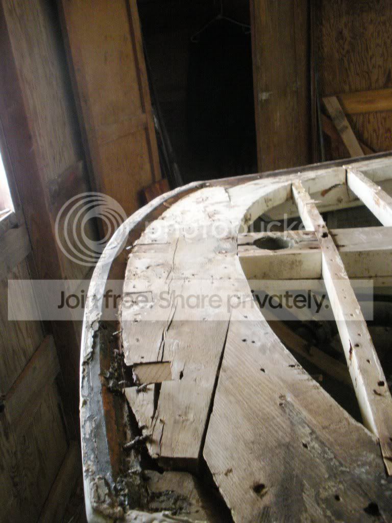

Broken deck frame

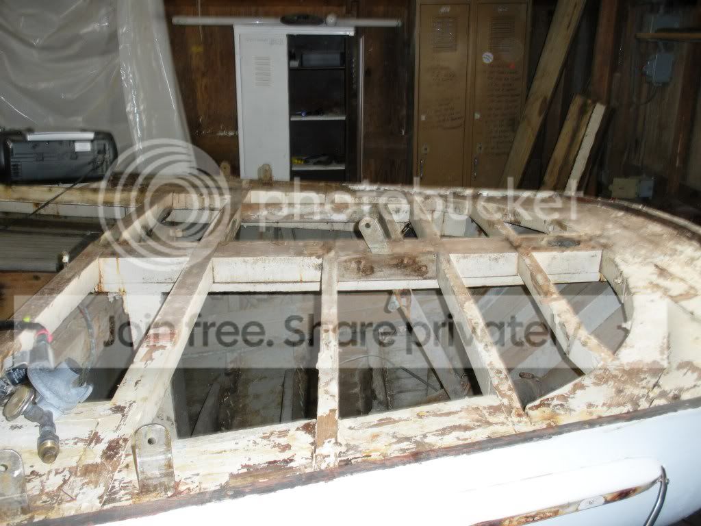

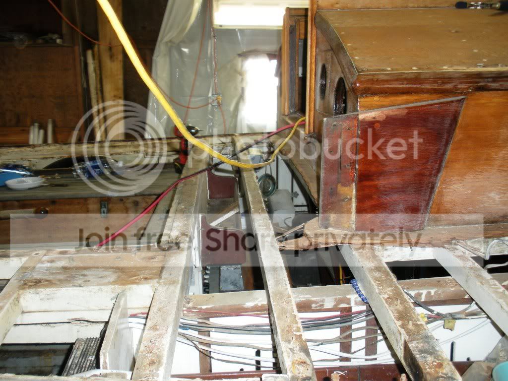

The cockpit hangs on three rods per side, interesting...
Getting into the bridgedeck where the decking was soft. No rot underneath.

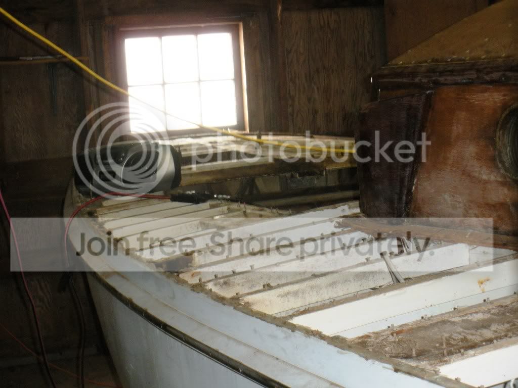

Starboard quarter

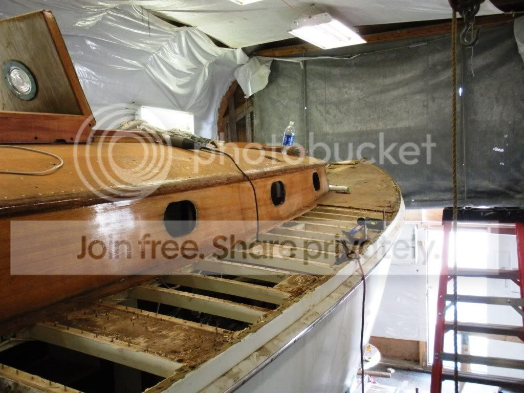

Port forward
Starboard forward

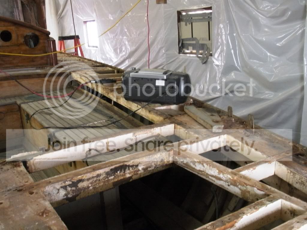

Bow sans bowsprit, sure looks strange...
