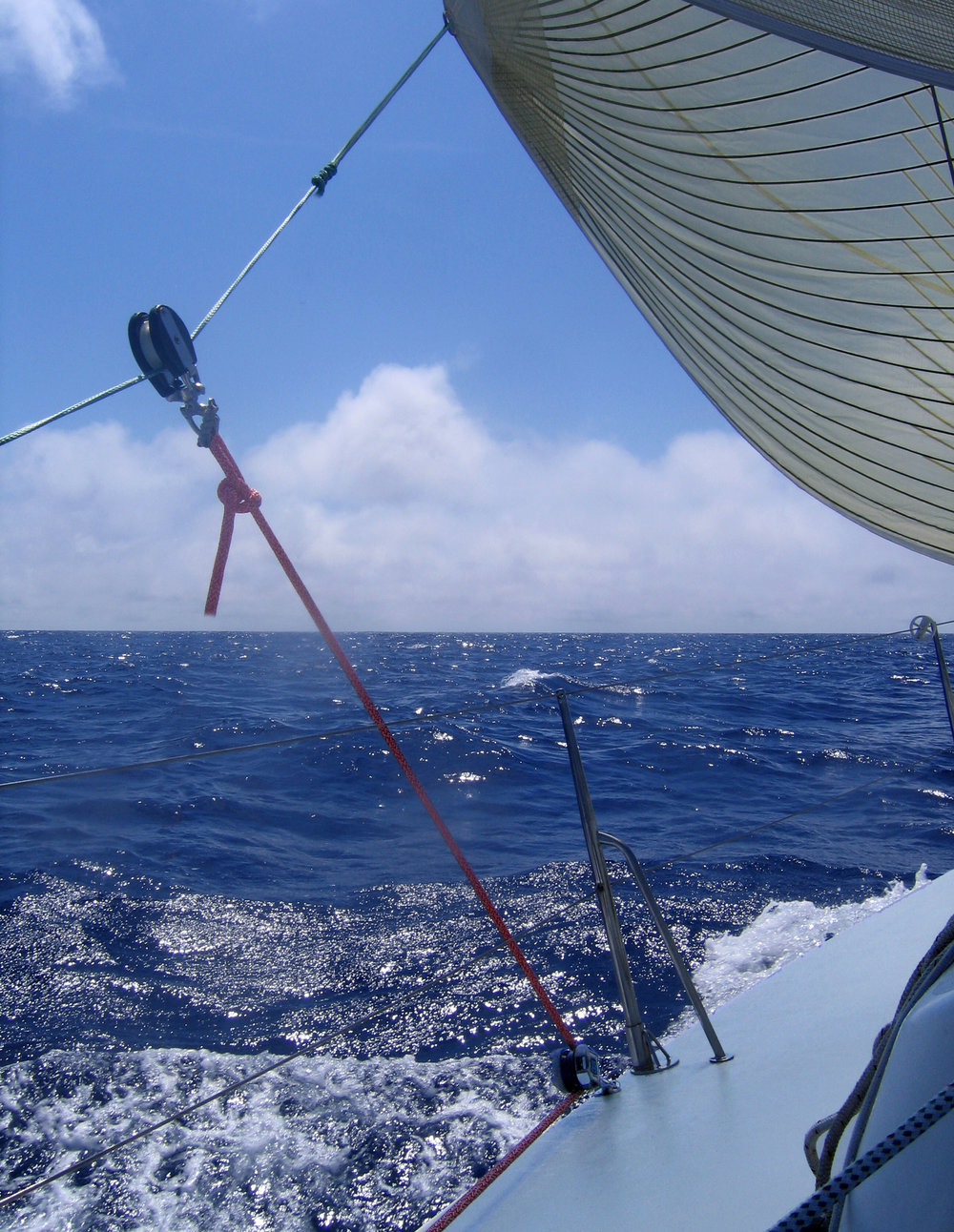

I do realize that I would have to move the rails farther back to accommodate the larger foot
You don't necessarily need to move the rails. You could just live with it, you can still sail with a bad sheeting angle, just not as efficiently.
You could also go with a twinger/tweaker setup where you attach the sheet as far aft as practical and control the sheeting angle by running the sheet through a low friction ring which is attached via a line to a forward location such as your old fairlead. This sounds more complicated than it is.
You also extend the old rail rather than move it, but that might cost a lot.
