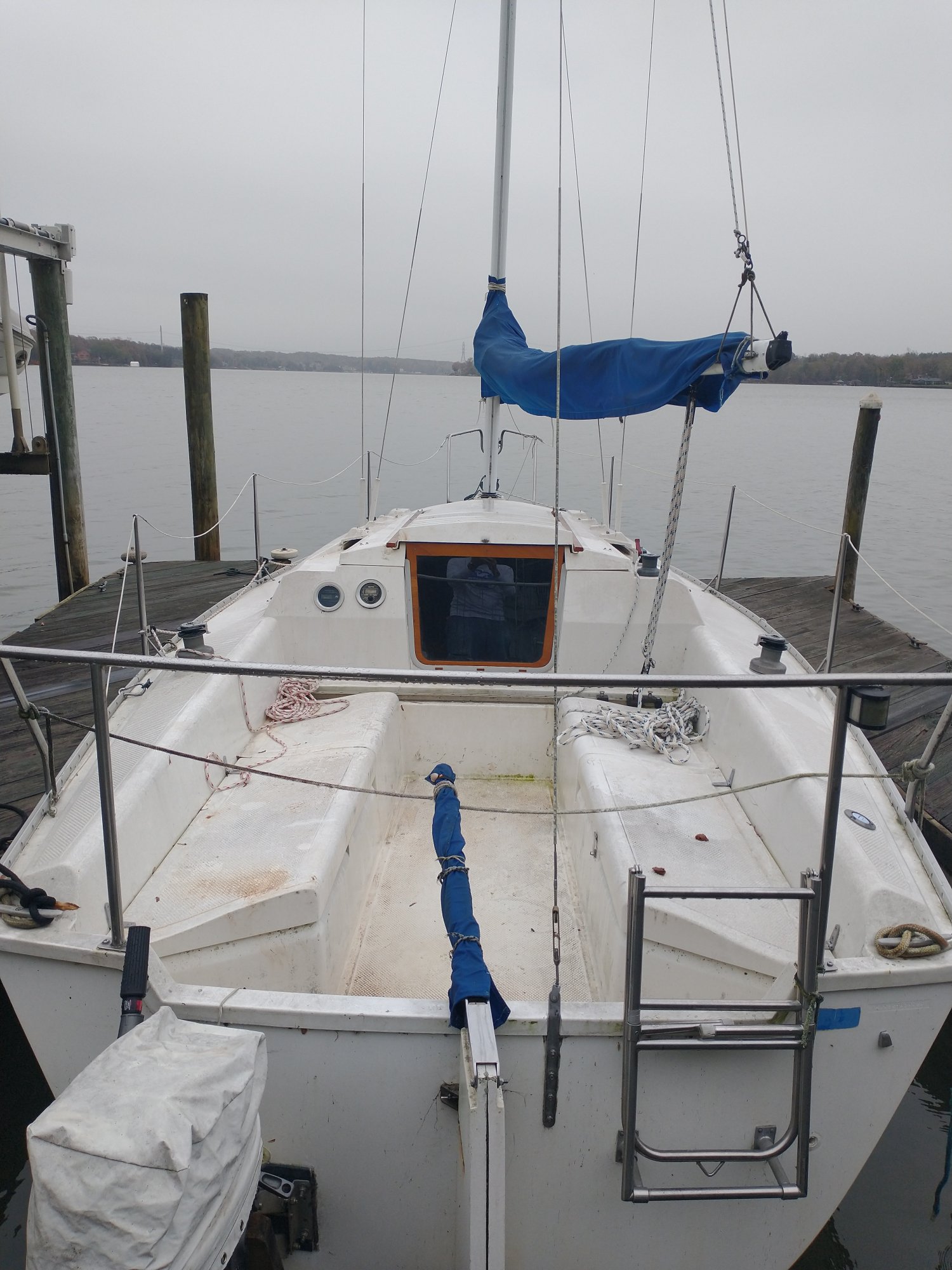

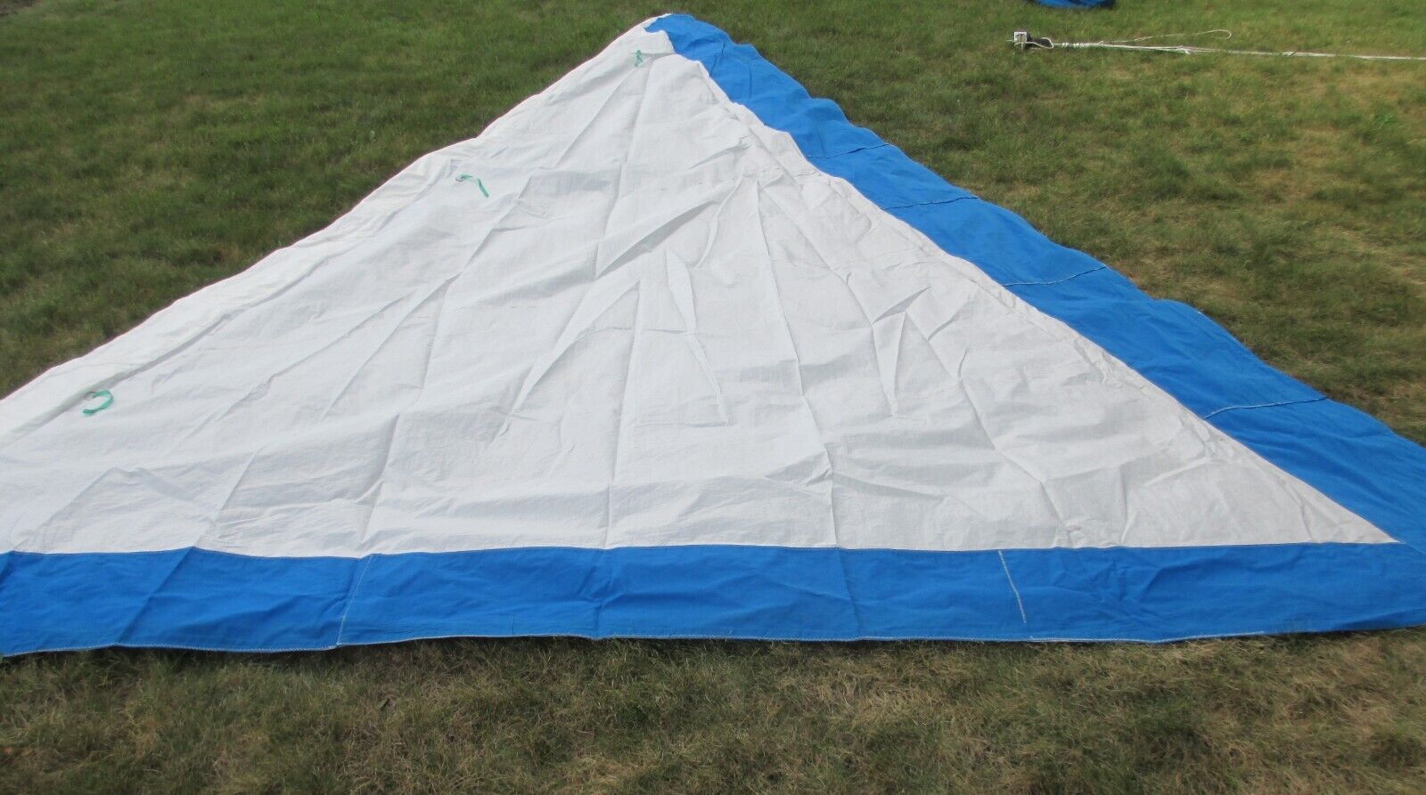

I've got a 1986 Hunter 25.5 with a roller furler. I've blown out an old sail and need to replace it.
I found a used sail for it but I'm wondering if it maybe too small for the boat or furling system. The one that tore was had a 29 luff and the new one is 22

MEASURE APPROX. 20' 8" LEACH x 22' 4" LUFT x 13' FOOT

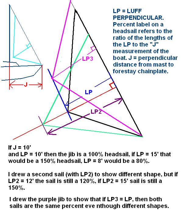

The short luff will set the foot of the sail high off the deck. Similar to a Yankee.
What is a Yankee sail? A Yankee sail is a jib with a high-cut clew of about 3' above the boom. A higher-clewed jib is good for reaching and is better in high waves, preventing the waves crash into the jibs foot. Yankee jibs are mostly used on traditional sailboats.
Here is a link that might expand your thinking on sail shapes for your boat.
