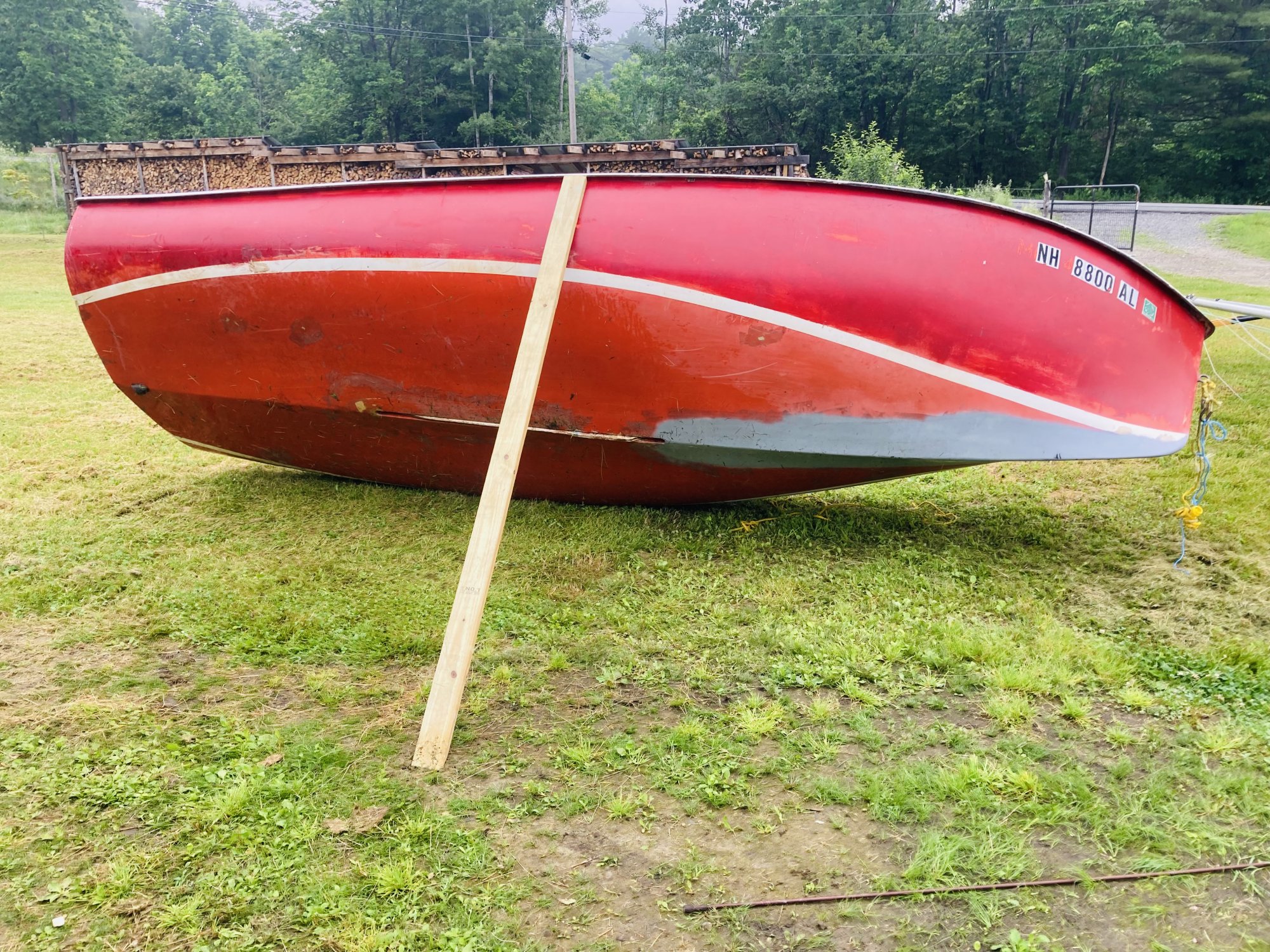

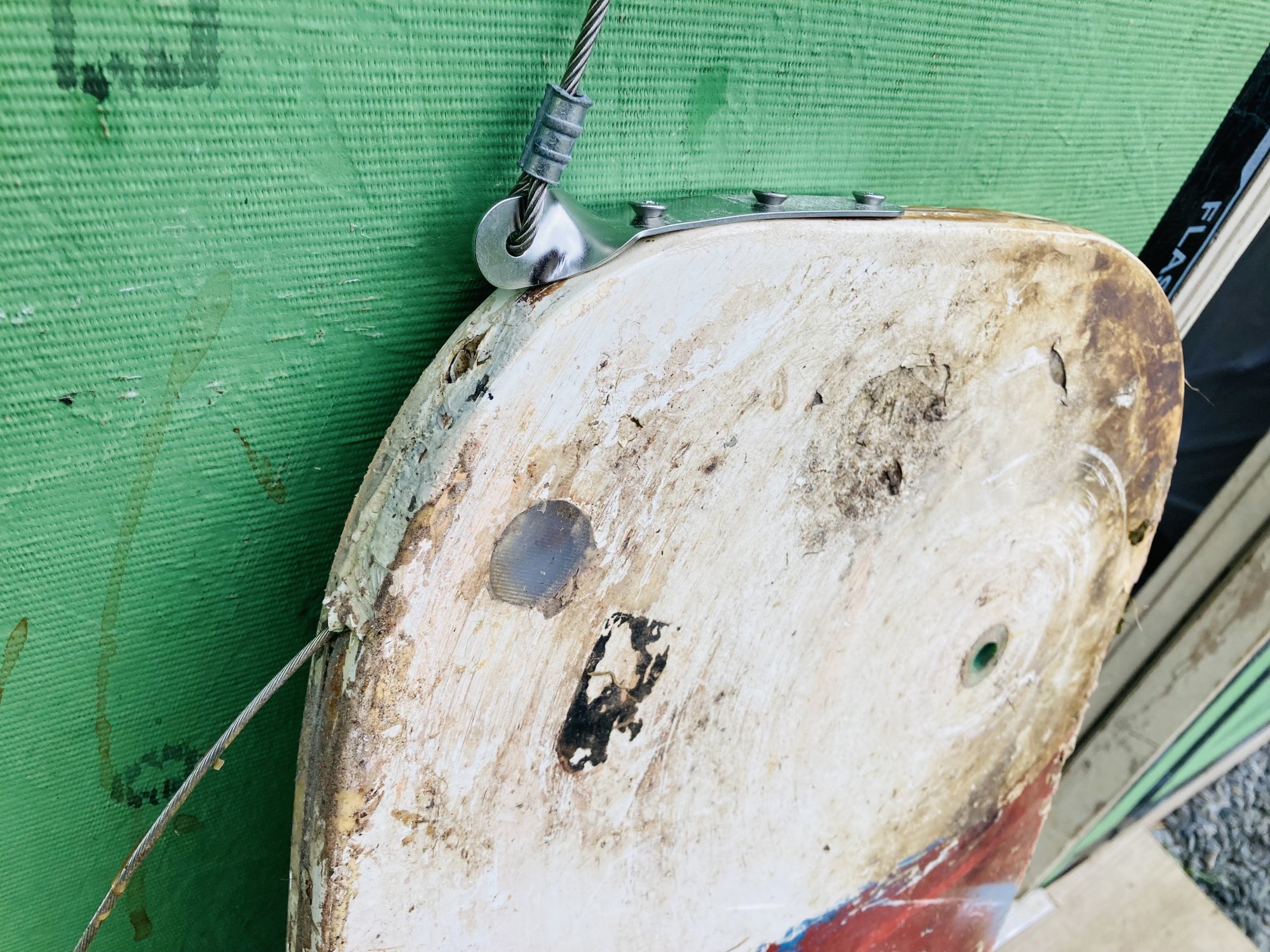

Here is a photo of the boat and the new cable:
After finally setting everything back up (using the great diagram here: Chaplain's Oday Sailer), I tried to pull the CB up, and it goes up most of the way, but still hangs out the bottom some because the bracket hits the opening in the CB case before its up all the way. How can I fix this issue? I thought of instead placing the bracket on the top part of the CB (left in the picture above), but the down cable is in the way.
