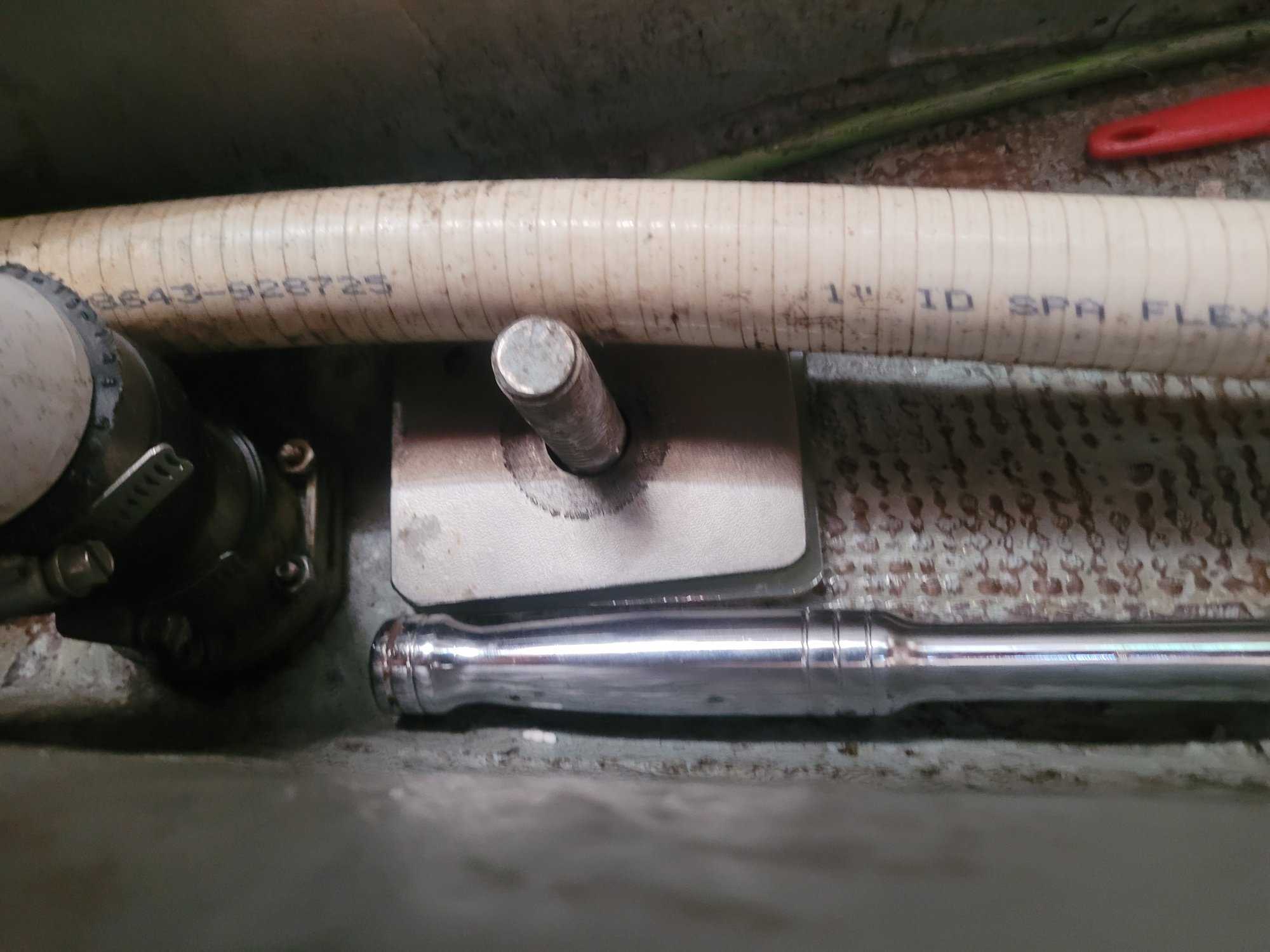

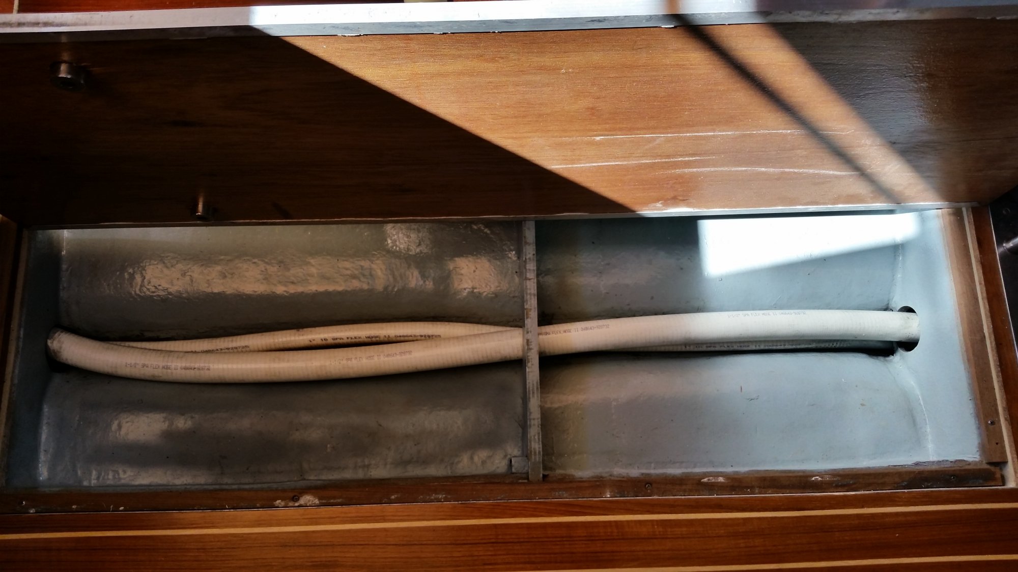

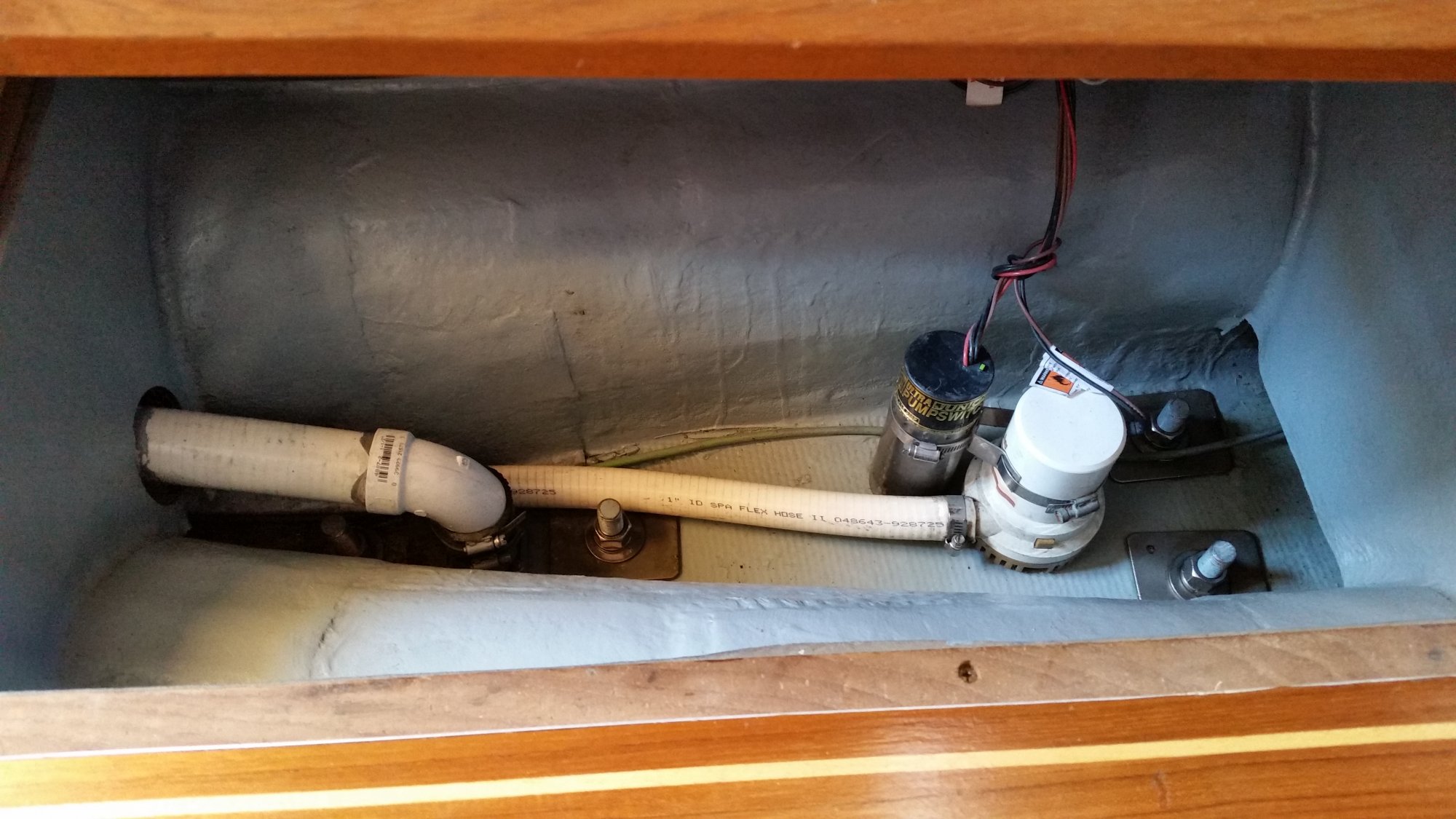

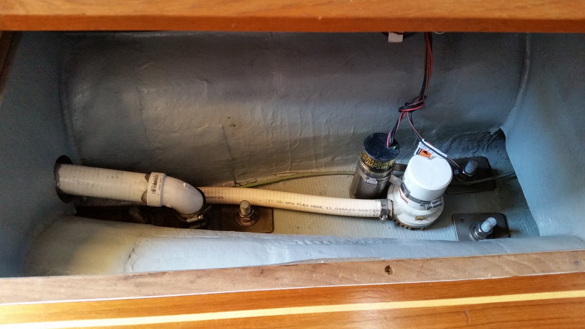

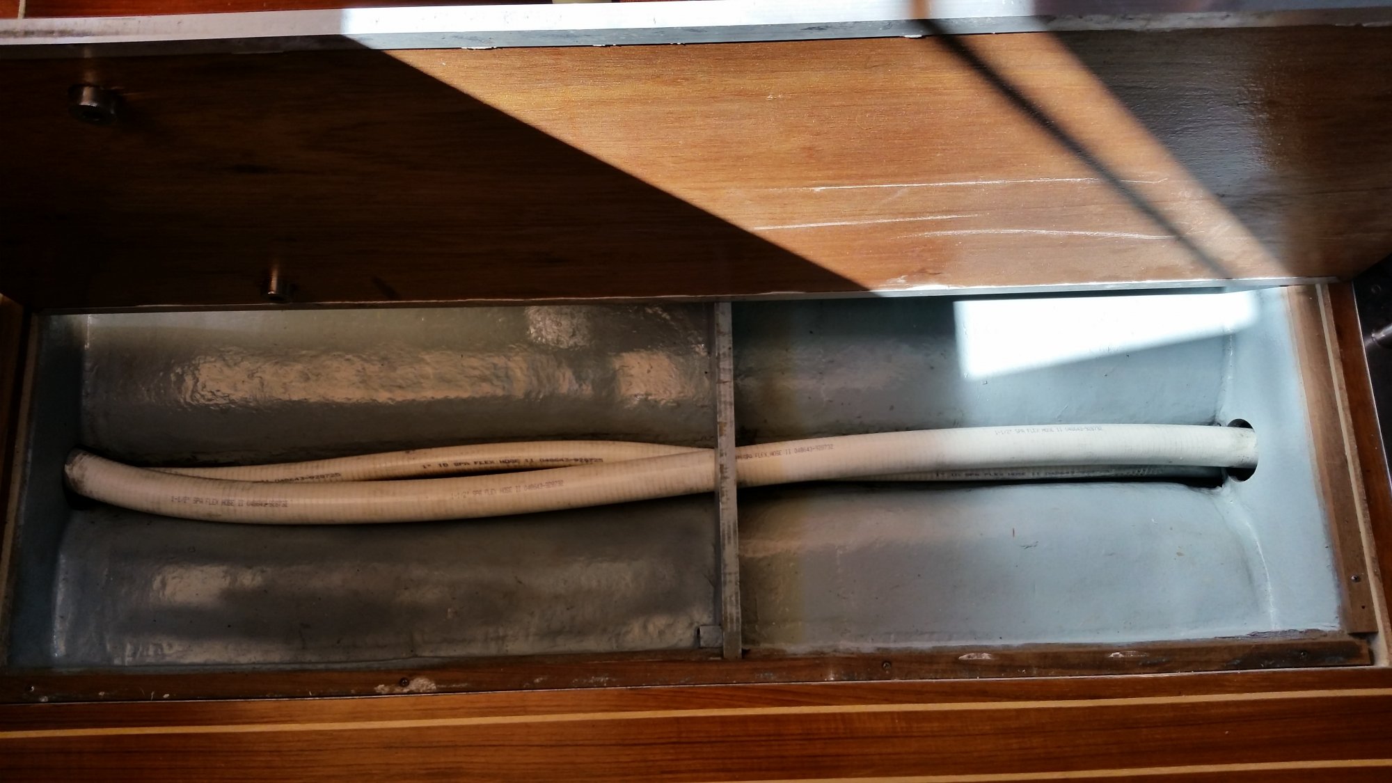

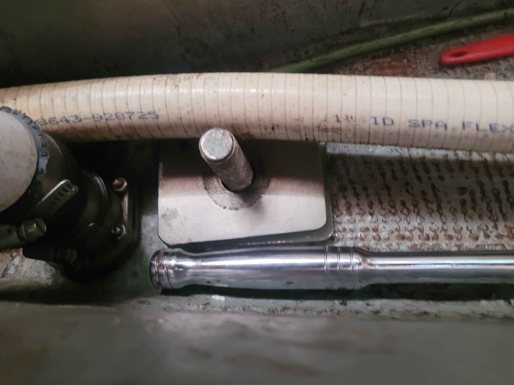

I replaced both bilge pump hoses on my 35. I used smooth walled flexible tubing.

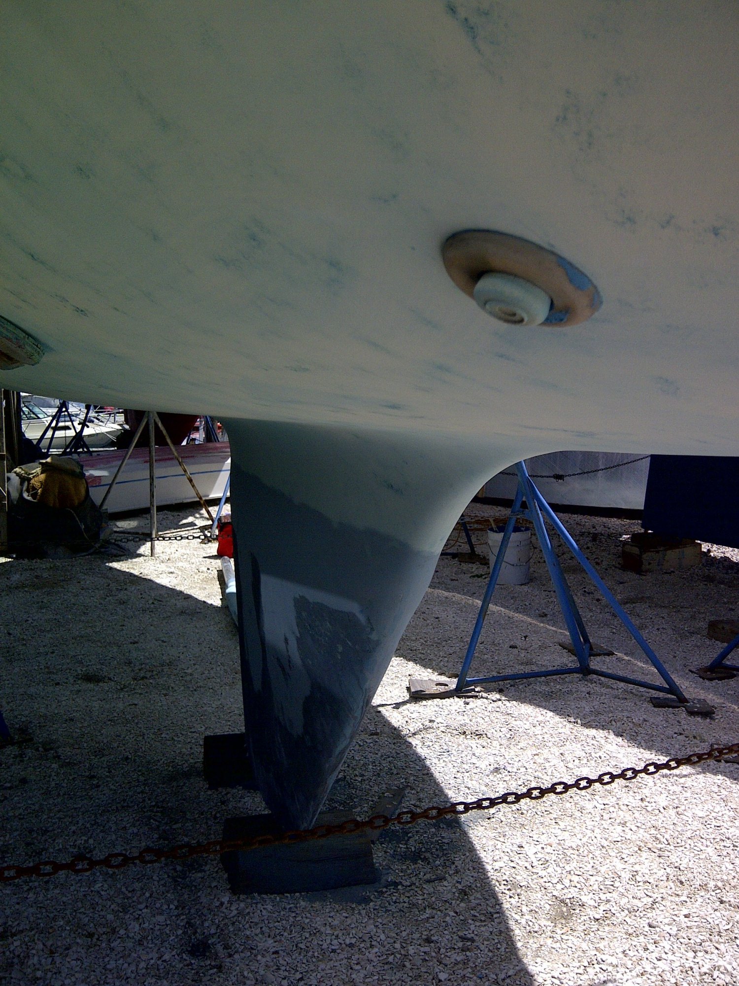

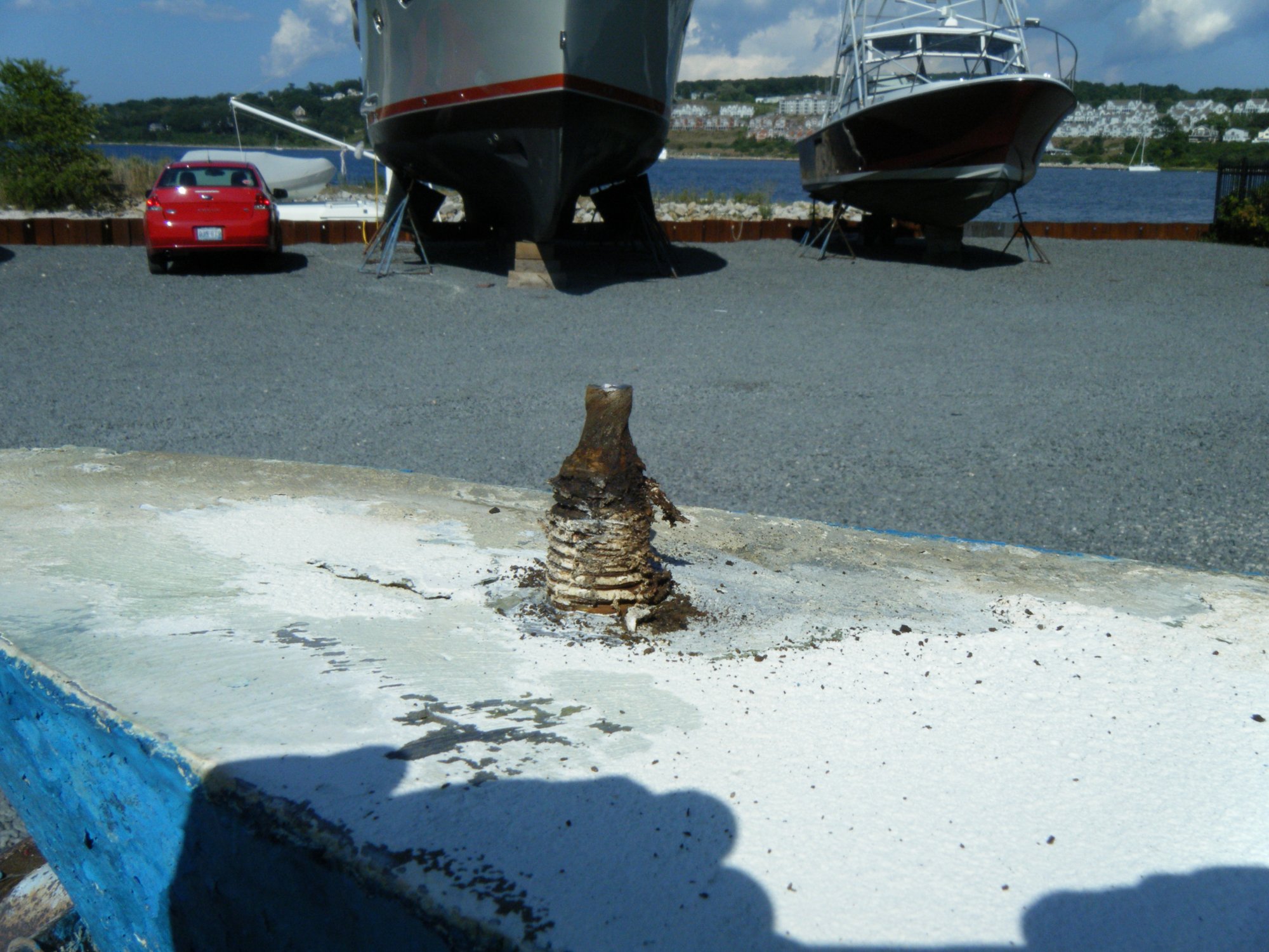

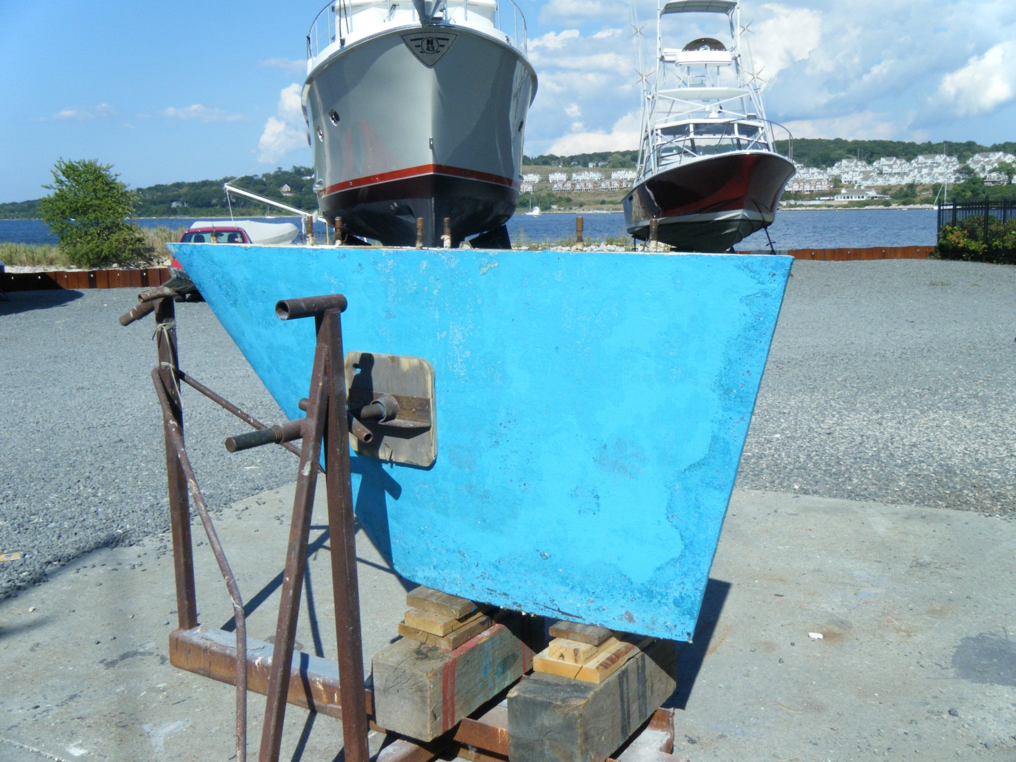

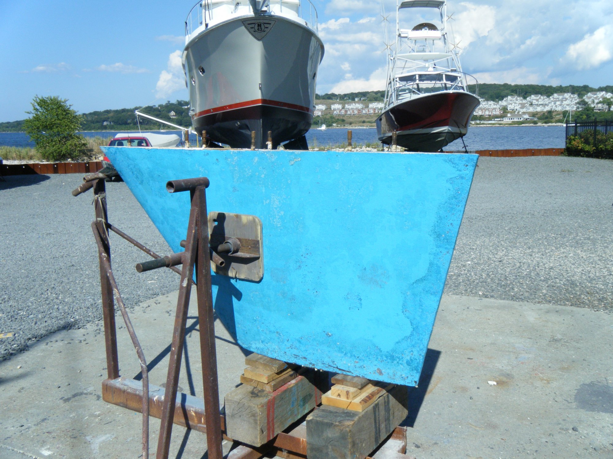

Thanks, but those are older pictures. This is what the bilge looked like when I put the boat away in 2025;

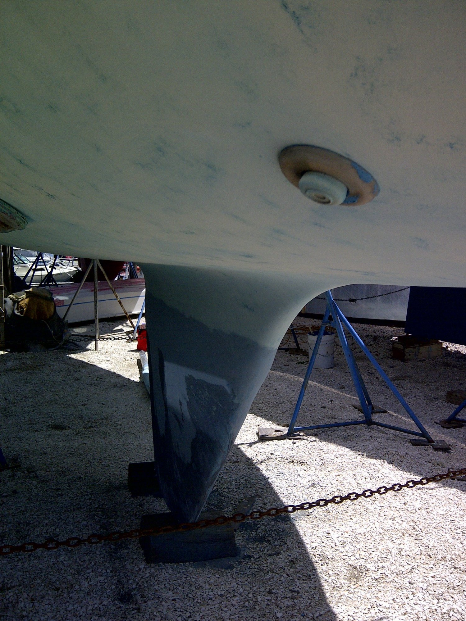

The keel was dropped and the keel bolts replaced in 2010.
This is why;
The keel was rebedded with 5200, and then the yard put a layer of fiberglass cloth around the joint.

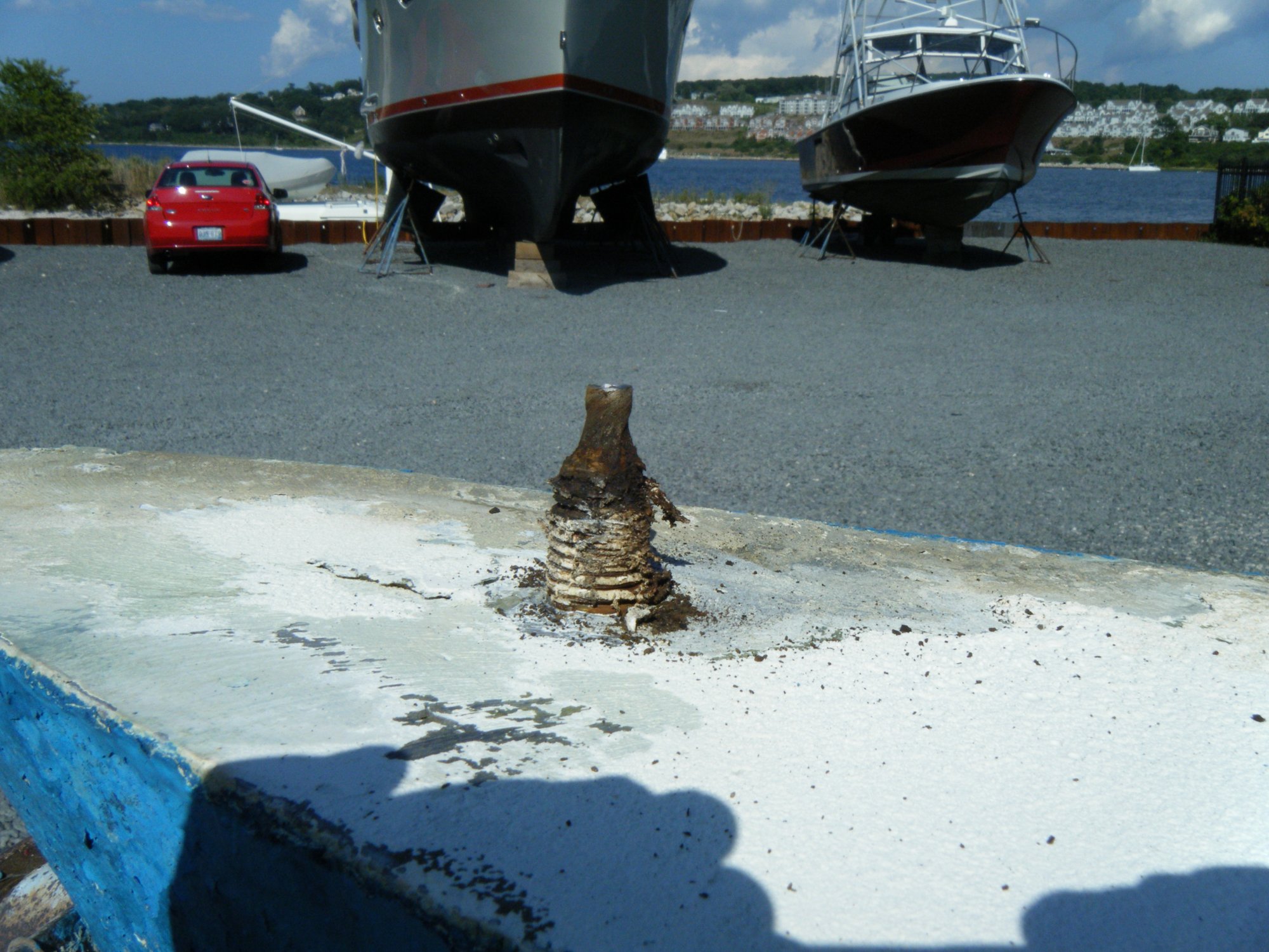

- Pic. from when I had the bottom soda-blasted in 2013

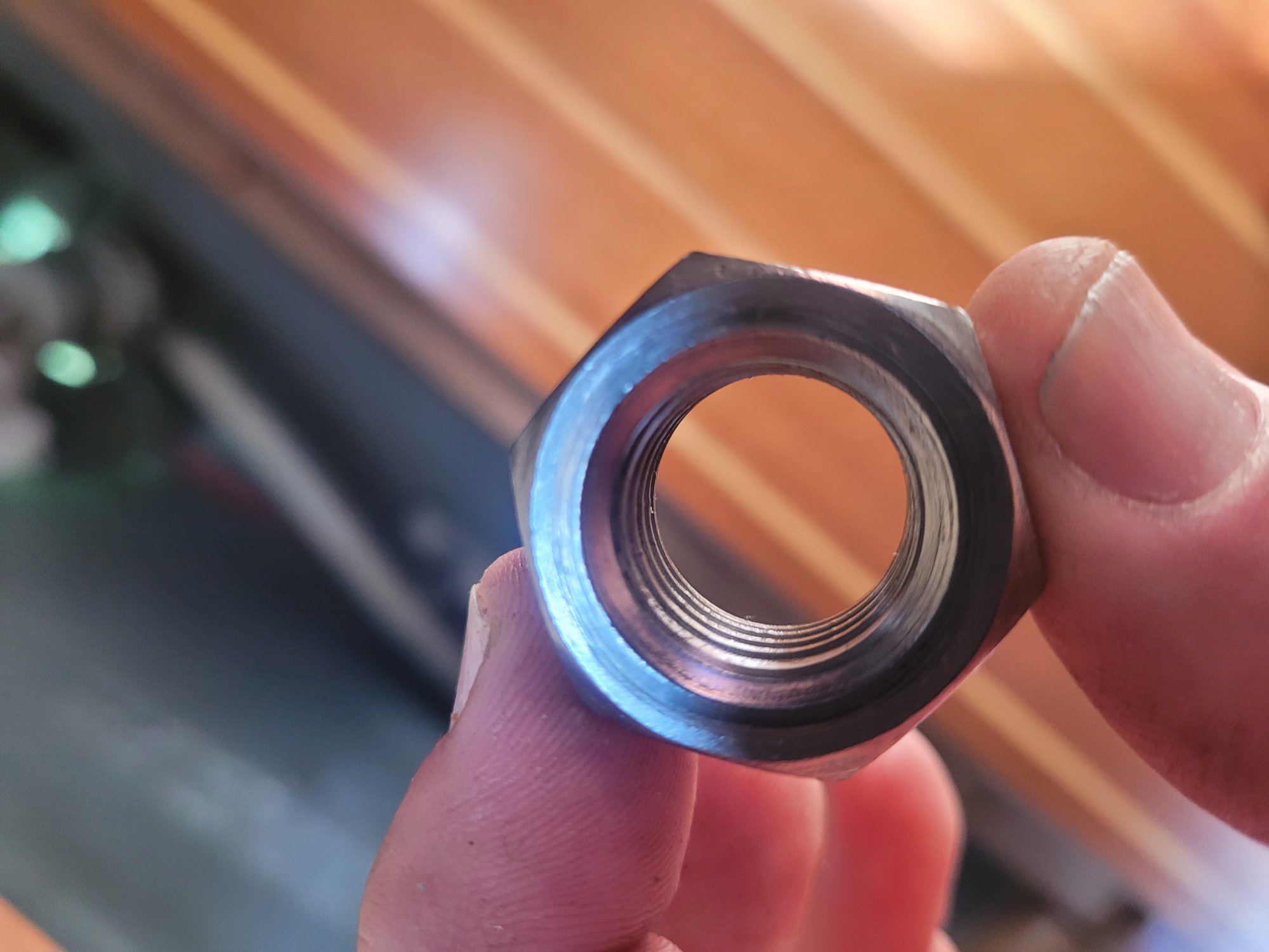

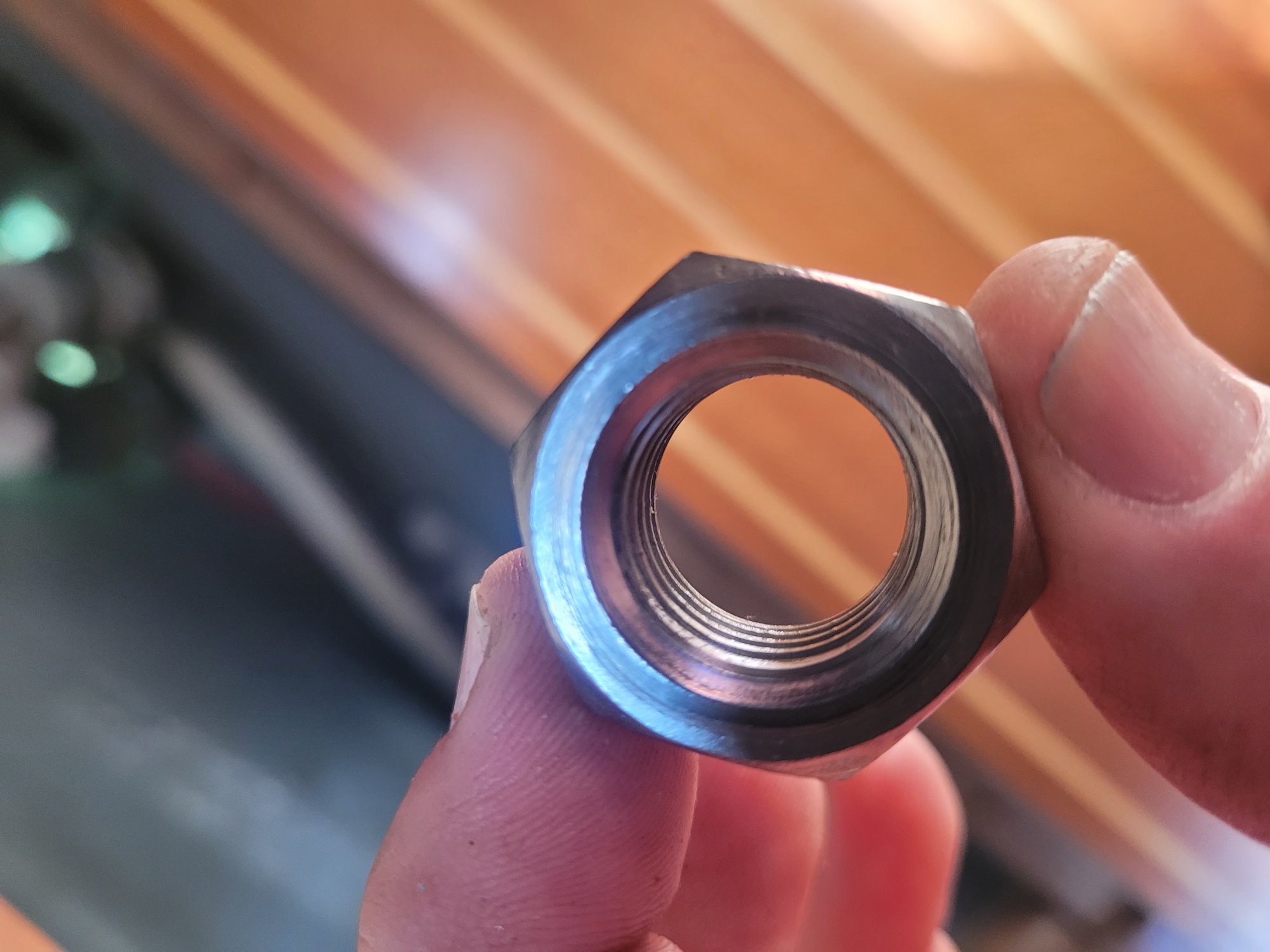

Every couple of years I remove the keel bolts, polish them with a toothbrush (the red handle), put a light coat of Tef-Gel on them, then re-torque them as tight as I can get them with a ½" 18" breaker bar (the silver handle).
Pics. from 2025 haulout.

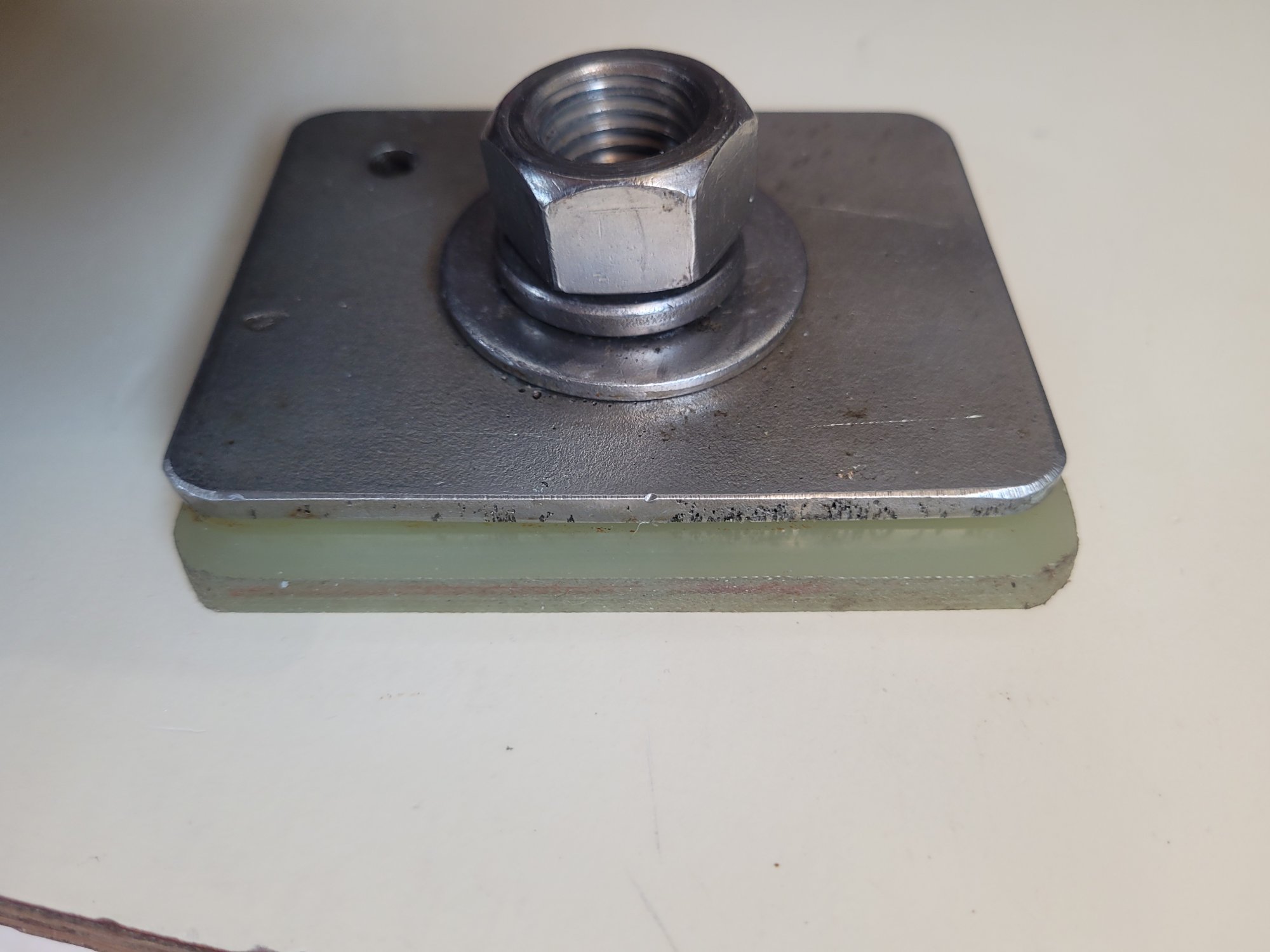

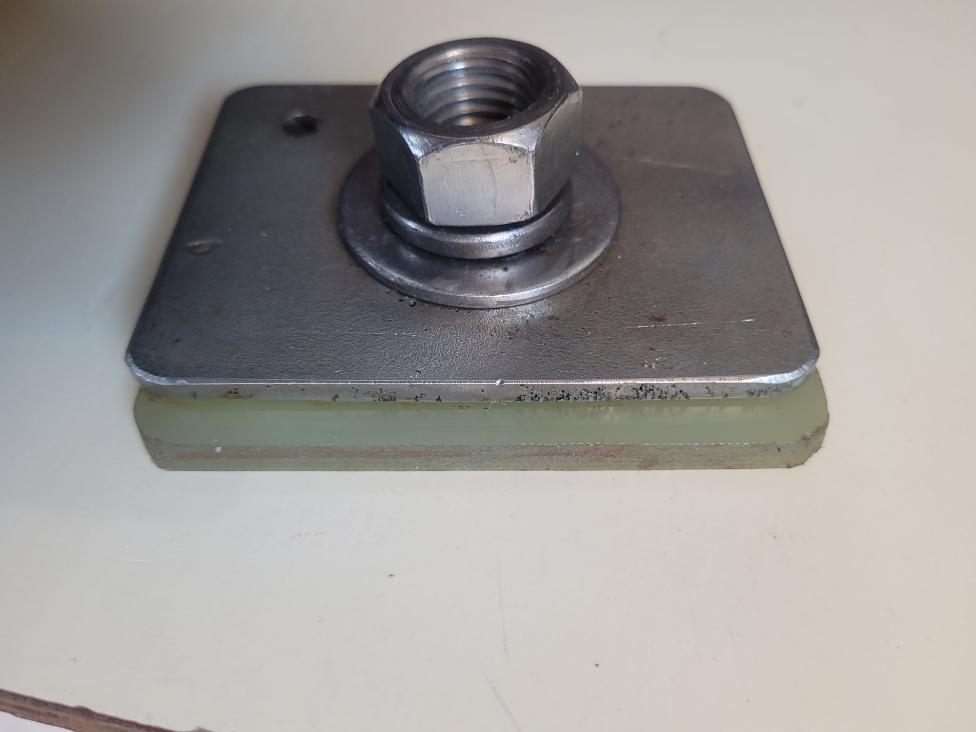

I have also added G10 Backing Plates under the original 304 Stainless Backing Plates to keep them out of any water that finds its way to the bilge. The original 304 backing plates were drilled out when the keel was dropped to accommodate the larger keel bolts.
NO leaks.

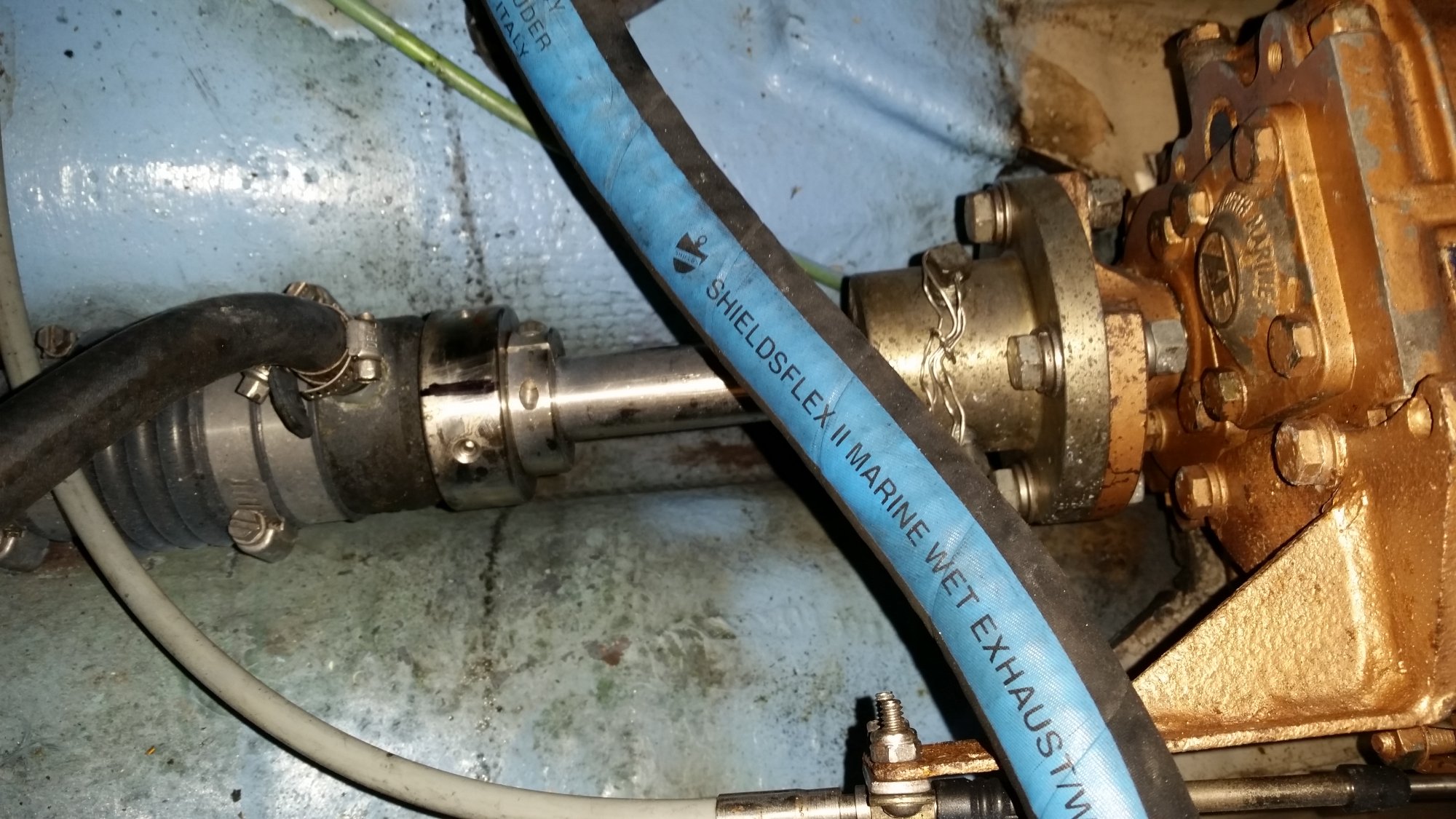

PSS Shaft Seal.
Pic from 2025 haulout.
Battery operated shop vac. I have the older version of this, which I keep on board;
This is why;

PSS Shaft Seal.
