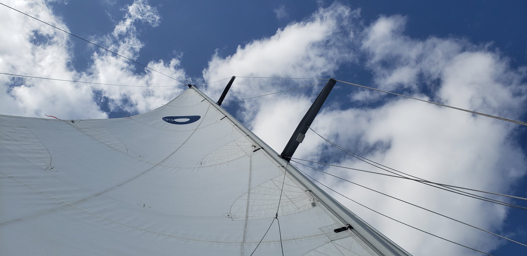

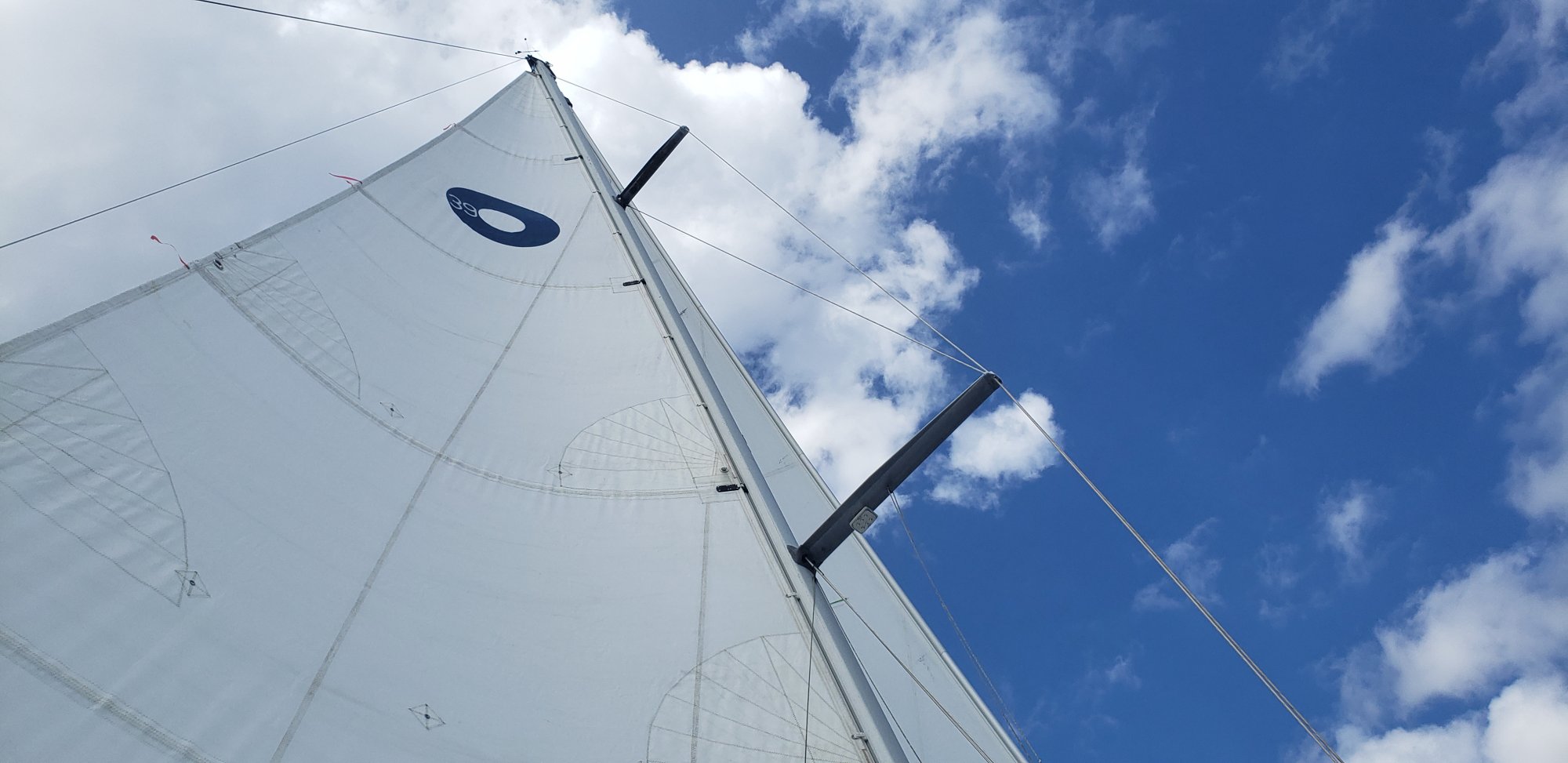

As far as the rigging it seems to be in good working order, I have gone thru measured for straightness and checked to make sure the tension on both sides it the same, she seems to sail pretty similar on both tacks. I did bend the mast back a little (about 2") because I thought the main may have too much luff curve ( about 7 inches, which I have yet to get a good answer from anyone on to see it that is good or bad) but I think this is was unnecessary, as we don't get much weather helm until about 18knots, and I did this after a race we had where it was gusting to 30knots all day 20+ all day and I had bad weather helm, and had a hard time flattening the main. But I don't usually sail in that kind of wind, so I have pretty much set the mast back straight again maybe 1" of bend. The recommendations I have got is to keep it straight, tight forestay and no slopping shrouds on the leeward side. How tight do you set your for and fore and back stay I have an old tension gauge, not sure it will give me an accurate number read but I can use it compare it to the shrouds?
The sails are Dacron with a full batten main, loose foot and 135 roller furling jib. I am not in love with them by any means but that is an expensive investment and am trying to make sure I'm not missing something first. Also I don't think they look to bad when trimmed. They are still crisp, I don't think they are too stretched out. I am only guessing this because the previous owner didn't use the boat and I have had it for 2 years now and have probably only put 100-200 hours on them. (Couple Bahamas trips and about 10-15 races) I have been working on getting quotes for new sails. It has also been recommended I send these sails in and maybe look into seeing if they need "a tummy tuck"(this is from one the most experienced sailors in our location). My thought on that is I would rather buy a new sail then spending 500 bucks to fix this one, and again I'm not having the weather helm issues. Although the last race we had about 10knots wind and I ran everything pretty loose (Mainsail foot, halyard and jib halyard,) I did get some luffing (more then I am use to seeing) in the front part of the main (in the luff curve area of the main) when pointing I wasn't able to trim it out with the sheet and traveler, but the tell tales flew nicely. So the main may be the issue.
