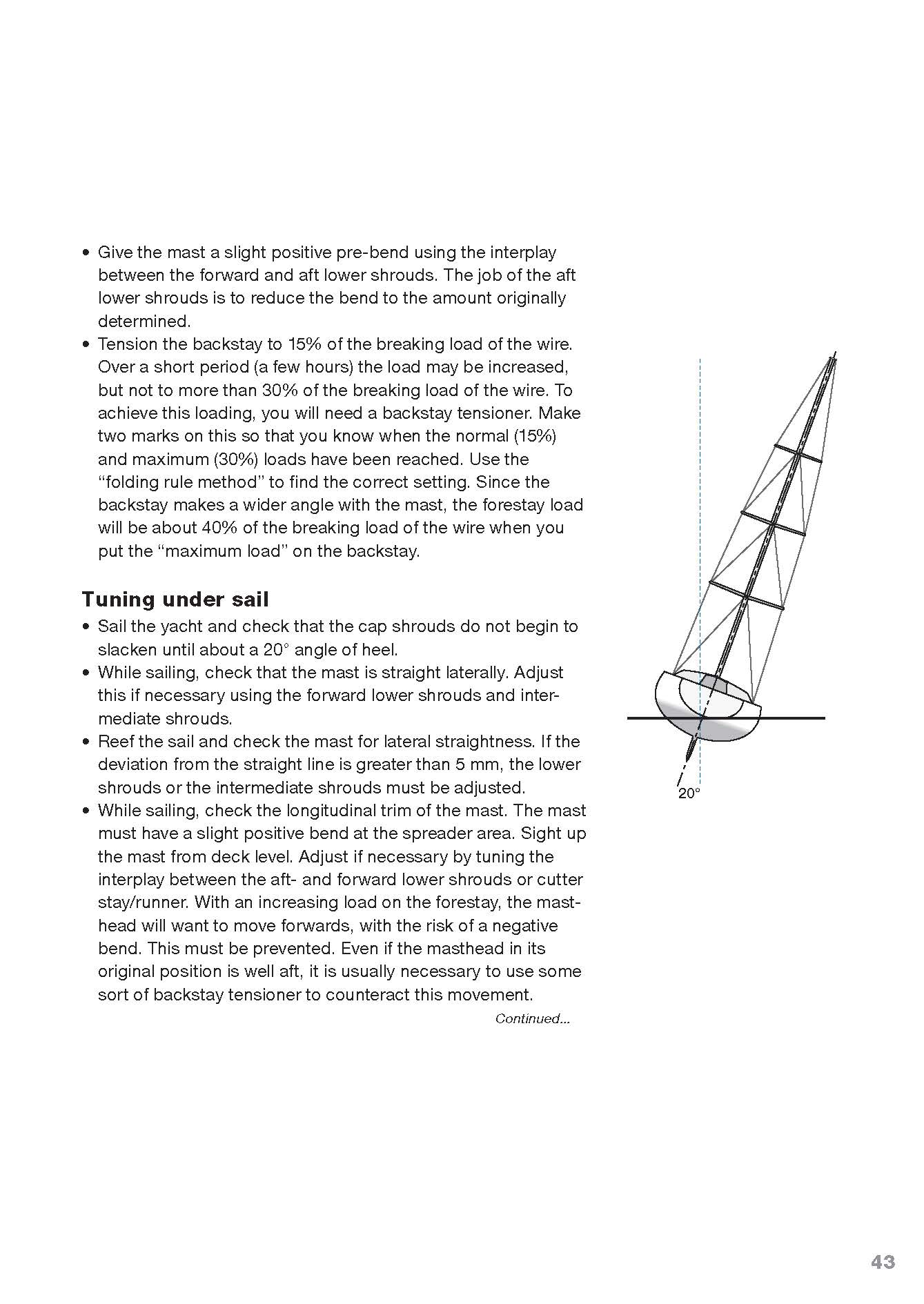

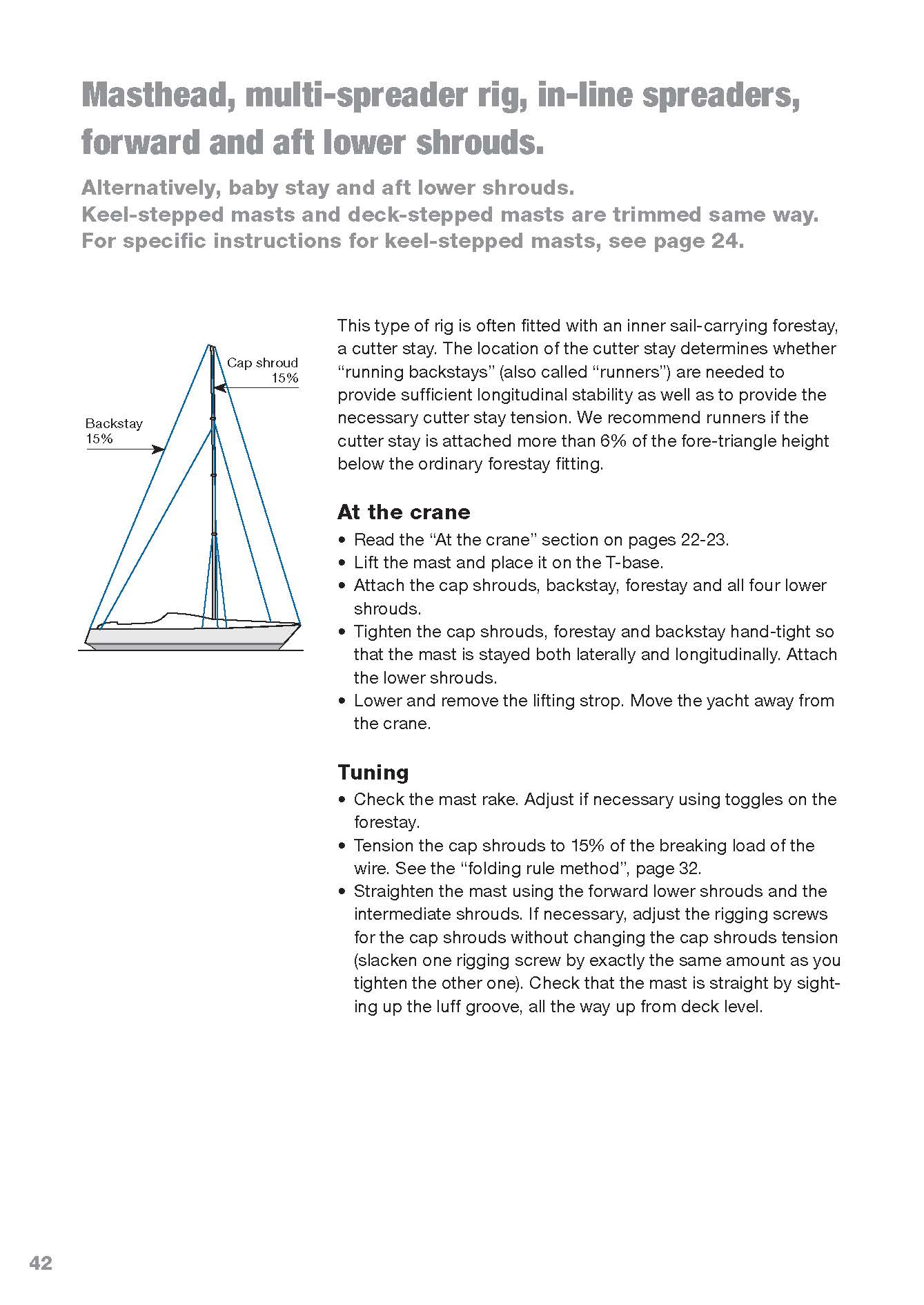

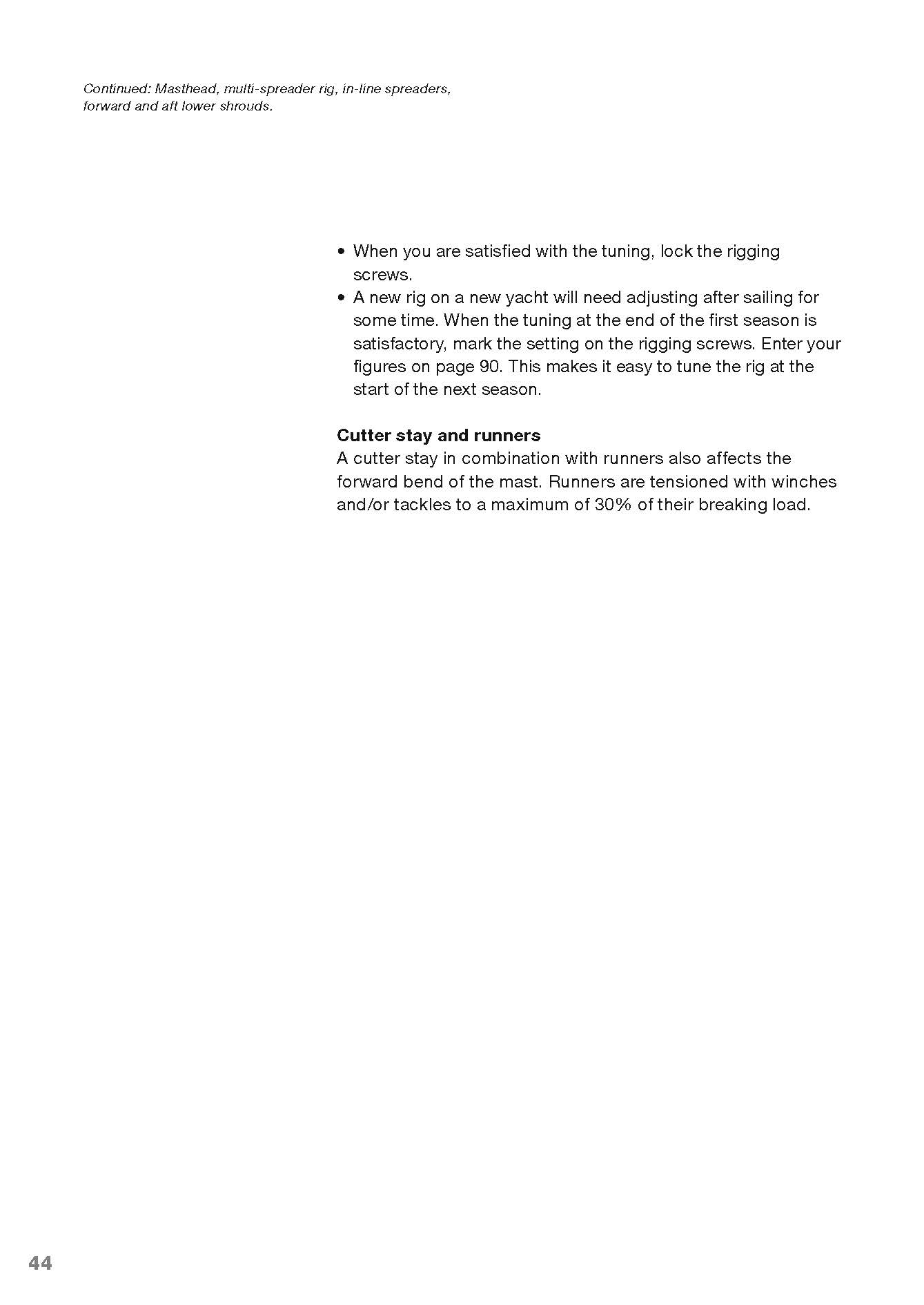

If you want to learn how to tune a rig based on the geometry of the rig, down load a copy of Selden's Hints and Advice .
Read Pages 42, 43, and 44 for how to tune a masthead rig with multiple inline spreaders and forward and aft lower shrouds. also read pages 1-33 for important introductory information.
See below for pp 42-44 . You'll notice that the instruction tell you to put "a slight positive prebend" in the mast using the forward and aft lower shrouds. prebend on a masthead rig can vary from 0.5 to 2 inches of bend on a medium size boat, depending on the mast extrusion. If it's a telephone pole, all you need is less than an inch.
There is no advantage using more bend than is needed to a) prevent pumping and mast inversion when the backstay is eased downwind b) prevent inversion when the spinn pole is used. If you put too much bend in the mast of a MH rig, the forestay will sag.
