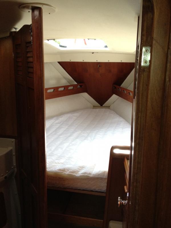

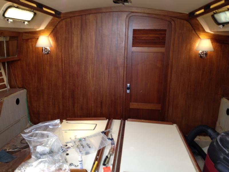

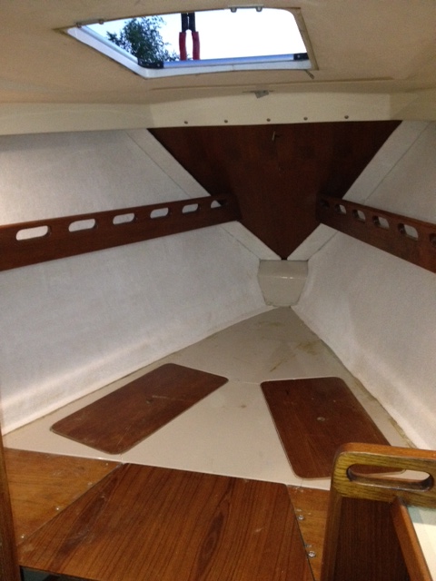

Headliner is in. The indirect led lights look great with the new headliner. You can see from the photos that I still need to clean up the screw holes that fastened the curtains around the windows. I injected holes with gorilla glue to provide a backing for the gelcoat. I'll first remove the rust stains and then fill the holes with gelcoat but I'l wait until I do any work needed on deck. I'll use any leftovers to fill the holes.
