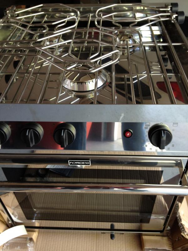

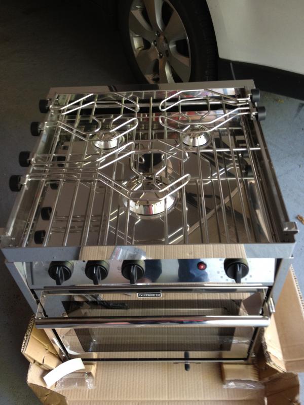

The force ten 3 burner stove showed up at the local West marine. The thing is spectacular. Everything polished stainless.(even the burners) The wife will be afraid to cook on it.
I will be prepping for the install later this week. I'm traveling a lot for the next week. I may not get to it for a while.

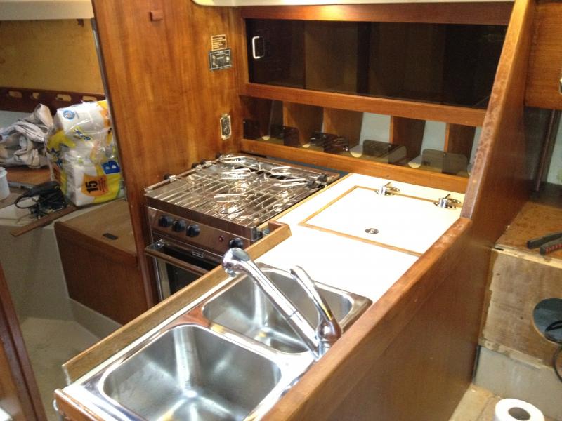

The Galley is nearly complete. Sink is polished and re installed. New faucet, counter top, added insulation to the Icebox. I will not be replacing the two hand pumps. One that pumps out the icebox and the other for sea water. They no longer match the polished stainless of the sink and range. I'll likely go with electric pumps.
Polishing the sink proved to have the highest impact of anything I have done so far. It was a huge improvement. Two hours of work to do the polishing. I had expert advice which is needed. Polishing to a mirror finish is an art more than science. Purchasing a new sink may be the best option for most. Now that I have seen the results , i would spend the $600 for a new polished sink with out hesitation.
Photos later today once I hang the range.

Galley nearly complete
Polishing the sink and upgrading the range to a three burner (all mirror finished) made a huge difference.
I have not decided on the color for the metal corner fiddles. I'll decide tomorrow and complete the galley and move on.

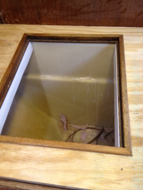

I just spent the day finishing the icebox on the port side and touching up wood work. I added two Finspray pumps to the galley. One to pump out the port icebox and the other for Seawater. Checking off the icebox took a lot of work. Adding the pump, routing the hose and checking for leaks (both the box and the hose) I have yet to build shelving for the icebox but that may wait until the winter.
Started cleaning up the starboard side Icebox. It had refrigeration so it has a good size hole. It will be a project. I Will post pictures soon hoping for suggestions.

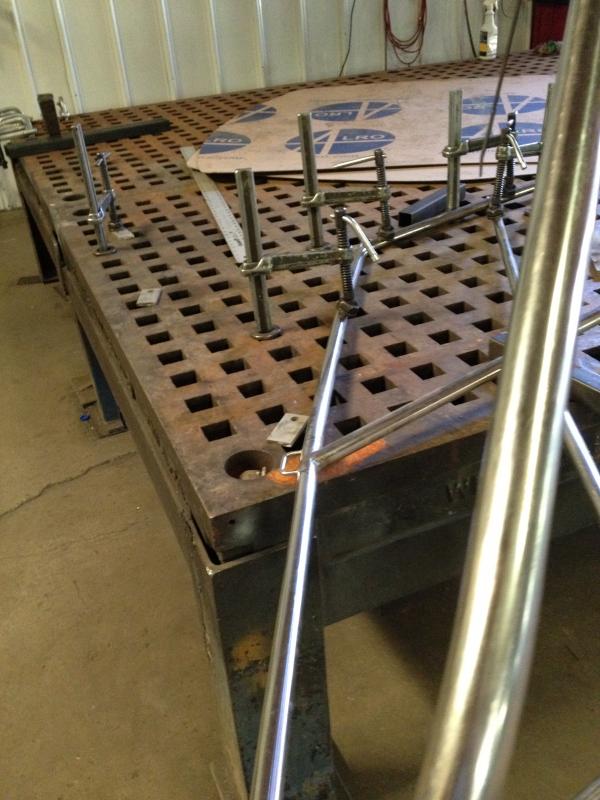

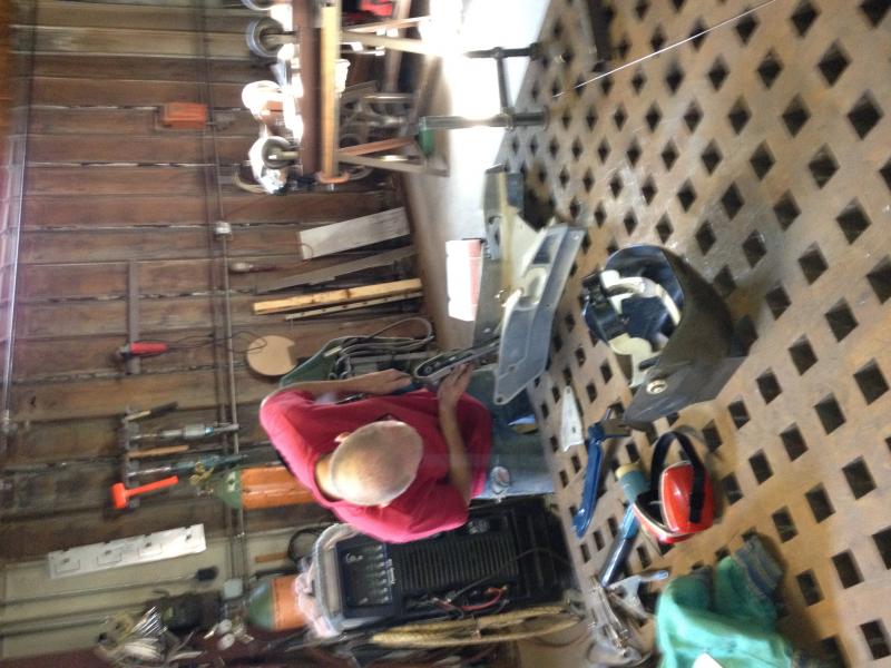

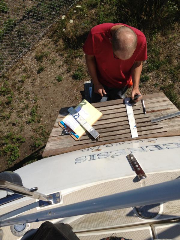

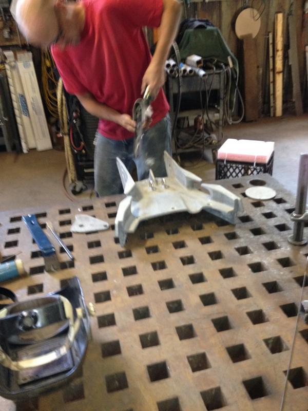

My plan was to finish things up in August. Wednesday the project kicked into high gear. Tuesday, I lined up all the projects I needed the shop to do. I arrived an hour late Wednesday morning and many were already completed. The Stainless shop (Aggressive Metals of Lake mills Wi)was waiting for a big order to be finalized so it was a perfect time to pick up my work.

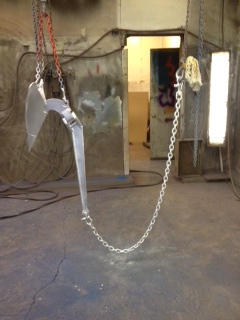

Anchor was blasted primed with zinc rich primer and top coated with bright silver.
Ladder mounted on the swim platform.
anchor pulpit removed and welded.

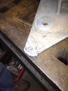

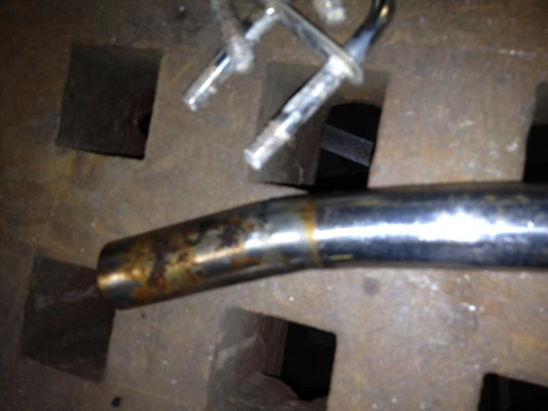

One stantion removed and inspected (see photo) corrosion and a crack. A lost cause.
Stainless trim added to Companion way door frame.
Bow rails removed straightened, welded and polished.
These guys are masters.

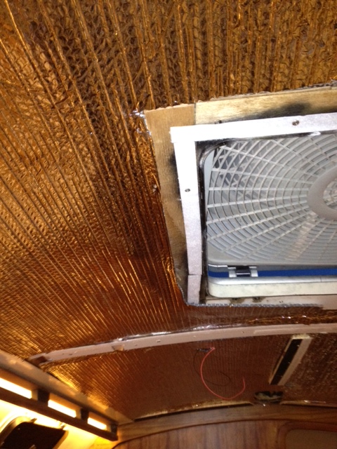

My punch list has over 30 items on it. I have no choice but to take much of this month off to complete the boat.
Now doing the headliner. I stumbled upon a great product from Home depot. It's basically double foil sided bubble wrap. Installation is a snap. Used the cheapest contact adhesive I could get my hands on. The stuff weighs no more than bubble wrap but it blocks 96 % of the radiant heat. I could feel the difference as I installed it. The main cabin is much cooler than the cabins at each end that do not have the foil. Low cost as well.
I'm using velcro to hold the headliner panels up. Works great.
Note the box fan. Could not do the project without it. Installing the inverter first was a stroke of luck.
This boat is now done dry.
