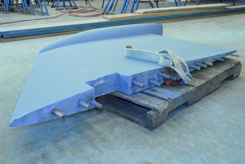

I found some photos in my archives of the keel I mentioned in post #67. The boat is a 1971 O'Day 23, and the pics were taken in 1995 or thereabouts. The pictures are small, they were scanned into a computer from the hard copies. In one view, you can see the hole where the foreword bolt and it's backing washer pulled through the laminate. The other photos show how we stopped the leak until we could get her hauled.

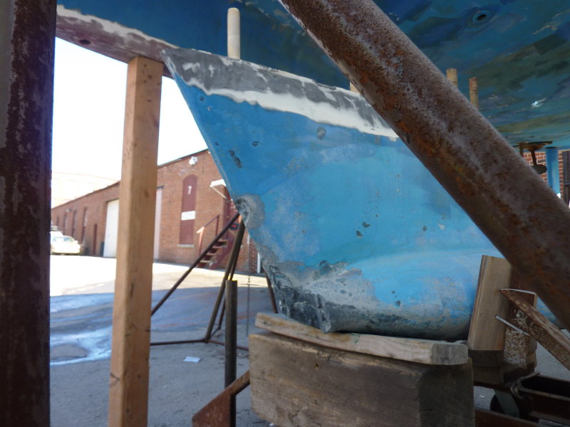

For those who don't think bolt on is robust enough this was a Hunter 340, a boat many pooh-pooh as a "production boat". Pretty darn tough, if I do say so myself....
Check out this chunk out of a lead keel below!!! That was a HARD HIT, about as hard as it gets. This boat did not sink nor lose the keel. It was not even leaking. All keel bolts were still intact despite there being only a few of them compared to some other builders in this size range and this was. It was remarkable that just five bolts survived this sort of punishment.
This was a FULL BORE hit to solid immovable granite. Both the keel and hull survived to sail another day. While the keel was re-set, it was more to inspect and die test the bolts.
If that 4100 pound lead keel on a 11,000 pound Hunter 340, with only 5 keel bolts, can handle that, how do you suppose the 3850 pound 12 bolt keel on this 36' 8900 pound day sailor would do? It would likely move the granite!!:)
