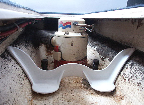

There seems to be some question about ways to strengthen the sump of a boat with a molded-in sump to which the keel is bolted.
I used to own a Niagara 26, for a decade. This was the smallest sloop built in the early 80's by high-end builder Hinterhoeller Yachts.
The external lead fin keel was a Petersen design and bolted thru the flat bottom of the sump with some unidirectional roving or bands of heavy glass fiber laid up inside that went continuously from each side of the hull bottom, down and across the sump, and up the other side for about 18". Each big ss bolt top came up thru one of these "floors" (to use more correct terminology, IIRC).
Since I have a pic of a view into the bilge of my former boat, I shall attach it to give a better idea of what this looks like.
IMHO, this is the easiest upgrade that a good boatyard could do for an similar design with a suspected weakness in the factory layup, like an O'Day.

That looks like a great solution, presuming of course that the core in the stub is still sound. Keeping the joint between the keel and stub sealed is important to core integrity. Also, I think that I would widen the footprint of the roving on the hull, as that is really your only attachment area, and then narrow it towards the top under the nut.

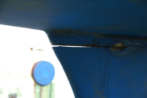

My vintage C-30 has the plywood shoe in the fiberglass keel stump. I have no problems - yet - just the slightest hint of the ubiquitos smile at the forward 2 " of the keel joint. The intent of the floors is to get the compression loads off the plywood.
