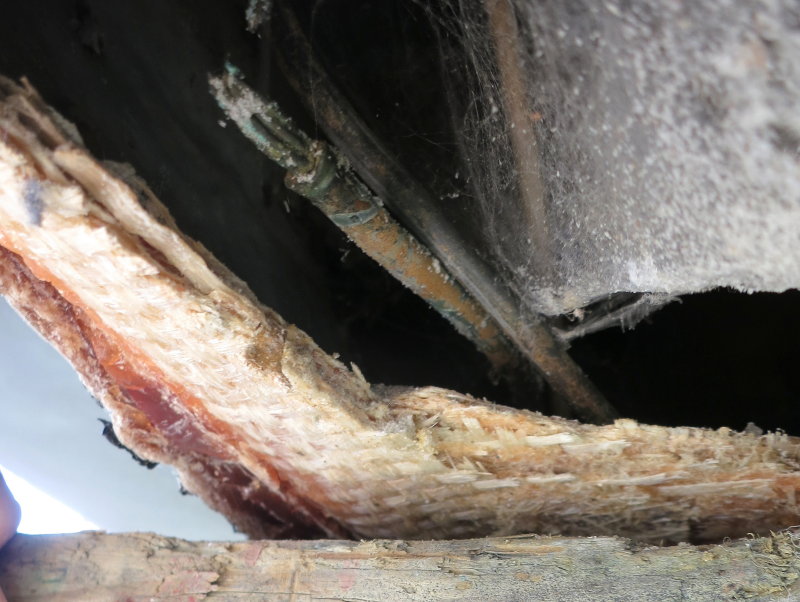

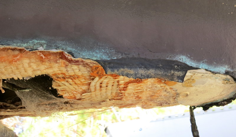

Just a heads up but I came across another Oday that lost its keel. This time it was a 322 and I saw it with my own eyes, examined it, and I personally took the photos.
The keel stub on this boat was even thinner than I had had calculated it to be.. I will post some pics when I get home.
Please, please, please if you own one of these boats have your keel stub thoroughly inspected.

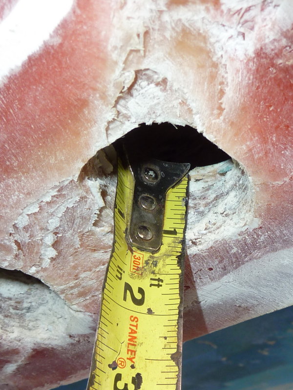

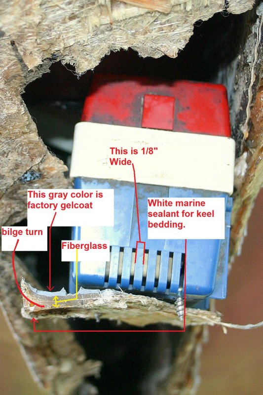

So here are a few of the pics I took. The boat was on blocks and pics were difficult to grab but the bottom line is this particular O'day 322 had a VERY, VERY, VERY thin keel stub. I did not have a tripod and could not take pics with the clamp and tape measure I had. I did my best to physically measure it. I borrowed a long reach shop clamp and clamped it inside and out where the polyurethane was still intact. The keel stub on this particular O'day 322 was a approx 1/4" thick +/- perhaps 1/16"....
This was an O'day 322 and for comparisons sake a Hunter 34 has a nearly 7/8" thick keel stub and a Sabre 32 about 1" thick. I was able to measure this O'day 322 at about 1/4" - 5/16" thick....:doh::doh: What really matters is what happens in the real world and we know that a number of these boats have had keels fall off. PLEASE be CAREFUL!!
If you own one of these O'days PLEASE have your keel stub carefully inspected.
O'day 322 - The tiny black wire on the right is a small Datamarine depth cable.
O'Day 322 Keel Stub
O'day 322 Thickness:
I used a long shop clamp to clamp over the thickest remaining part of the stub. I then marked it with a Sharpie, loosened it slightly, and carefully removed it. I then found some scraps that would fit into the gap. What I found was a 1/4" piece of marine ply. The remaining gap is approx 1/16" thick making this keel stucb, where measured approx 5/16" thick but this was on-top of polyurethane sealant.. Safe to say this stub was 1/4" to 5/16" thick.
This was from the O'day 302:
