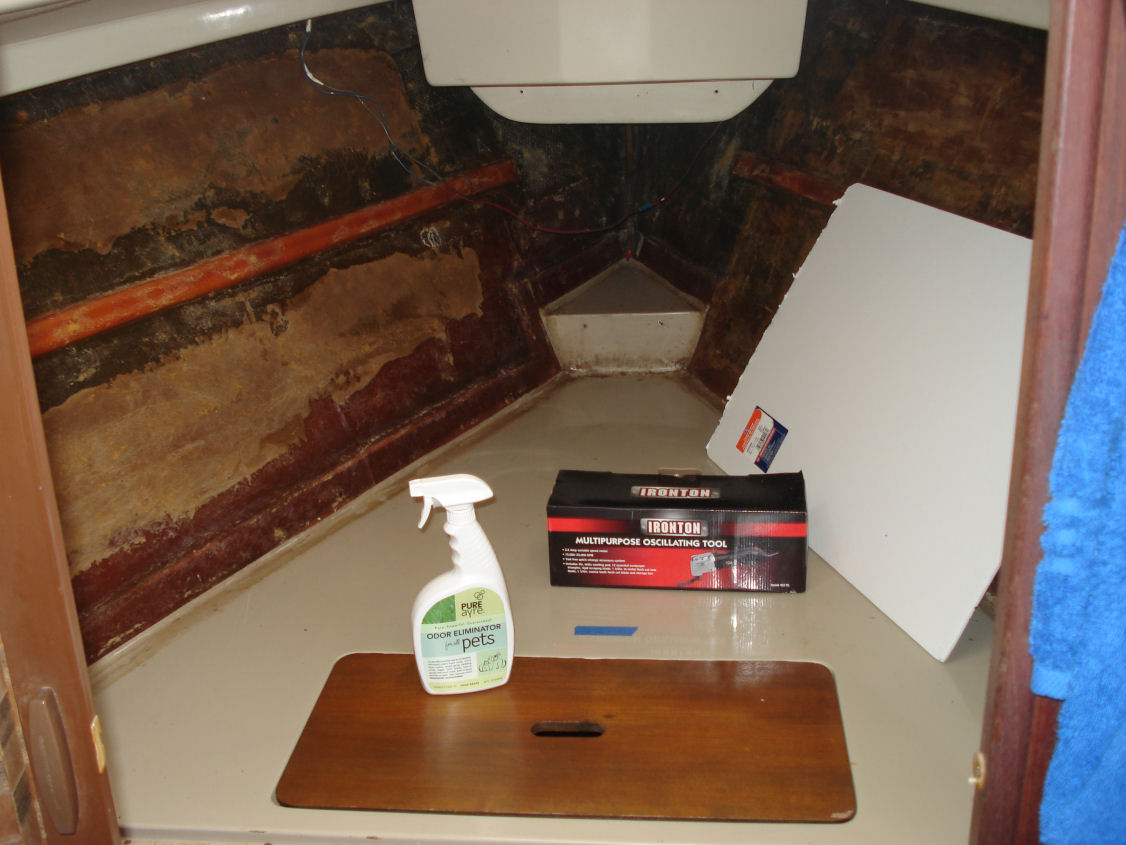

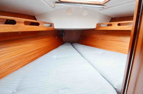

I have decided to go with a 30L/14W/10H tank which adds up to 18 gallons. I might just squeeze it in but am prepared to enlarge the access hole a little if necessary. This tank will be special order with all ports on top and a dip tube for the pump out. I need to make sure I have 5" clearance on top for 90 fittings but should be good. I am using Pure ayre to try to get rid of odor under the hatch. I ripped up all the nasty carpet and will replace with new hull liner. The old cushions are being washed. I want to add a shelve on each side what type of wood should I use? I want something like the attached photo

Teak is traditional choice. Bottom of the shelf could be marine grade plywood, our PO used laminate in the salon. cap with a teak rail.

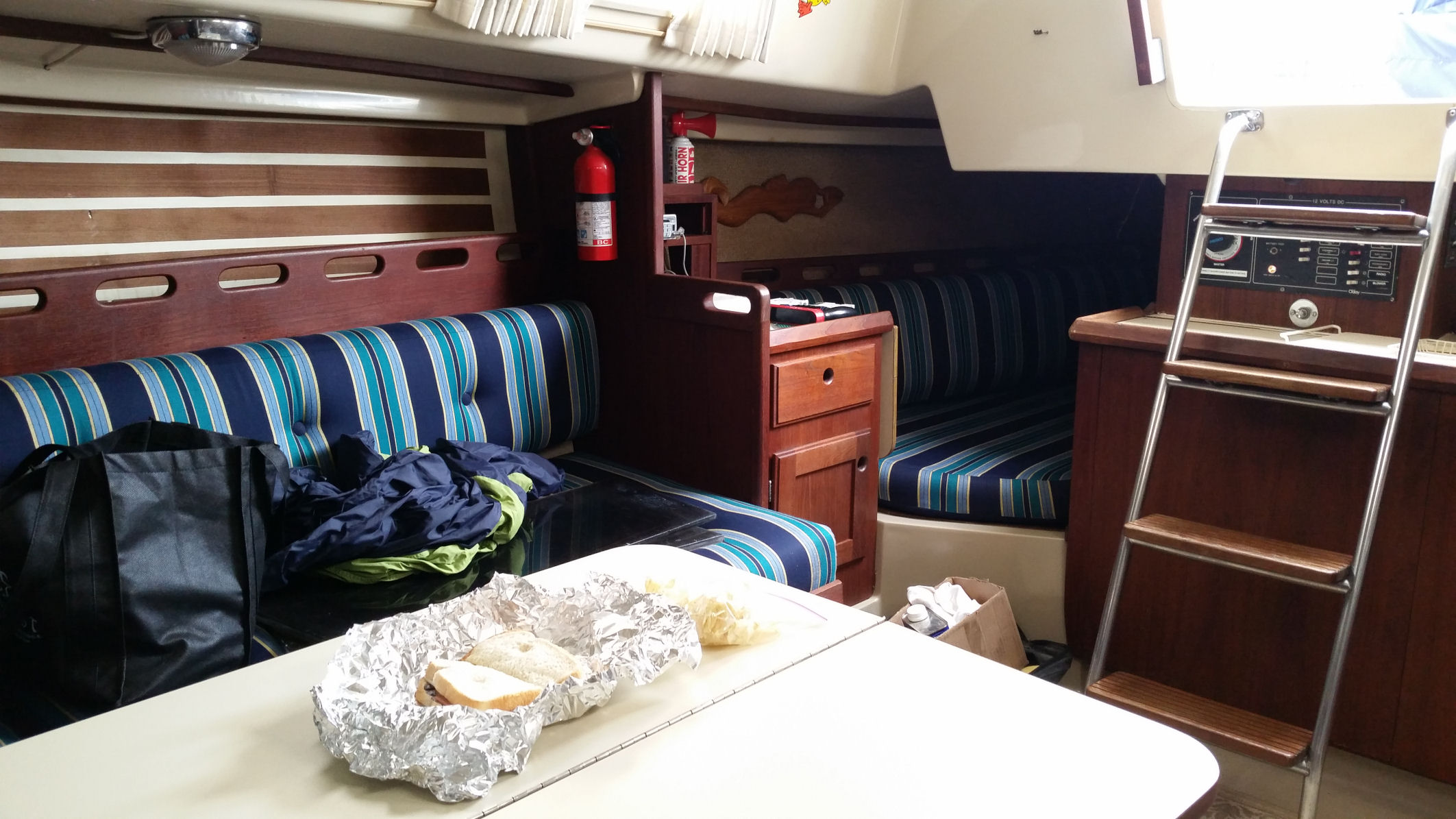

Where might I find a teak rail? See the shelves in the salon and quarter berth, I would like to find something like that.

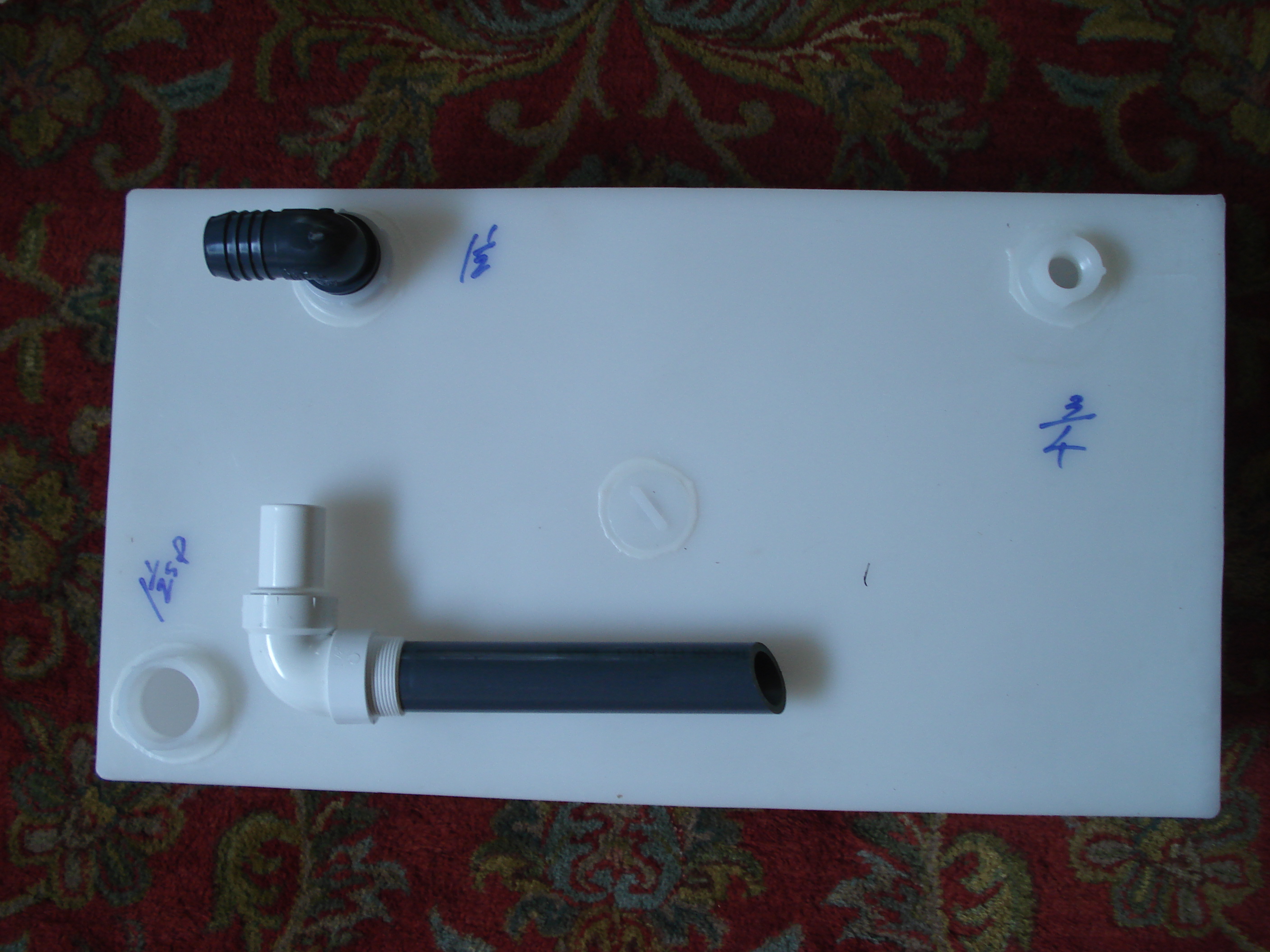

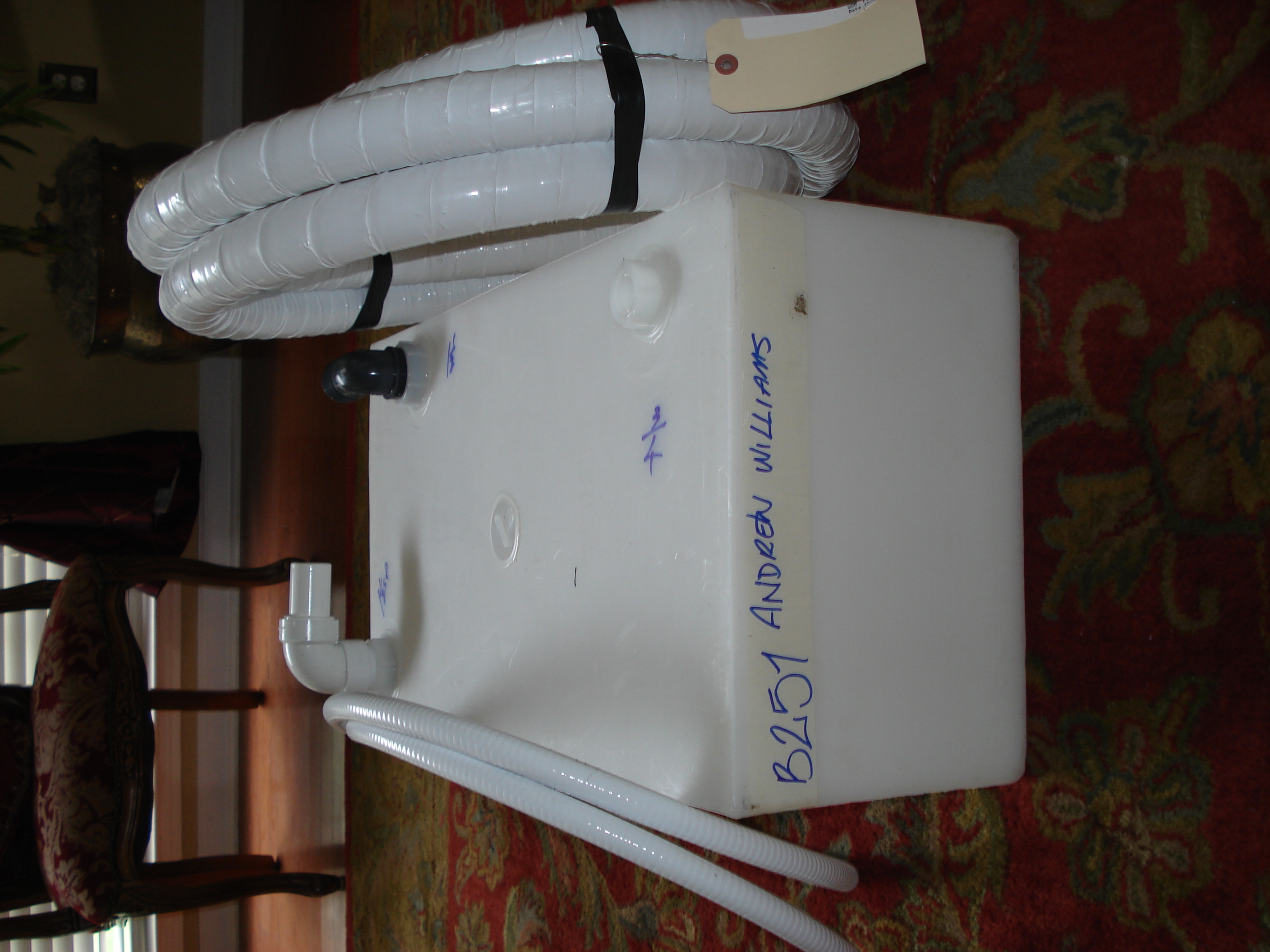

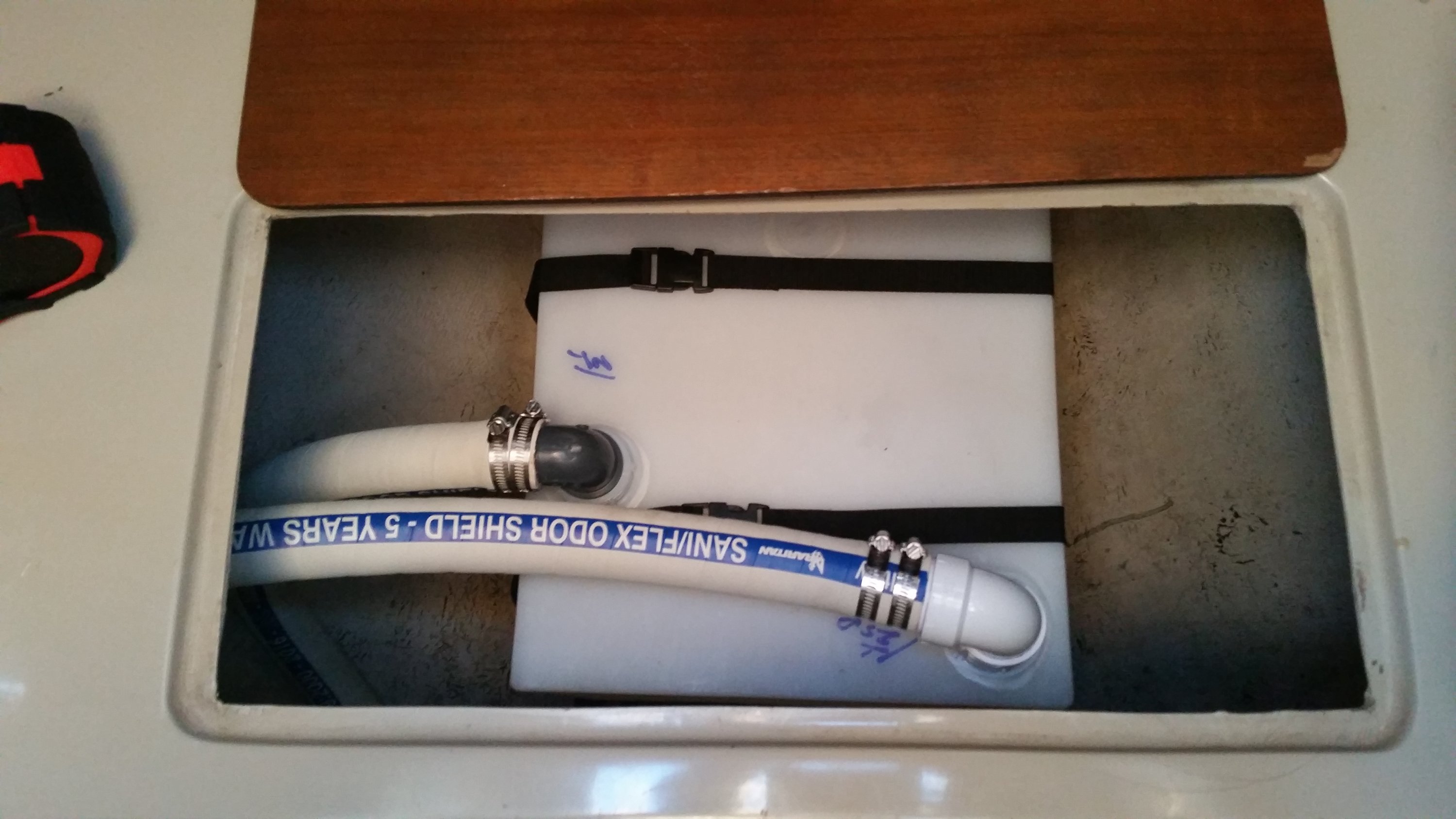

I have finished the installation of the new holding tank. In the end I went with a 15 gallon which is 1 more gallon capacity then the old tank. (Ronco Plastics B251). I could have gone a few inches wider without enlarging the access hole but they didn't have a tank with those dimensions available. I could have had a custom tank made but it was not worth the money to me for the few extra gallons. I used the expensive but very high quality Raritan Sani / Flex Sanitation Hose - 1-1/2. The tank vent was drilled wrong, it was 3/4 not 1" so I just put a 3/4 to 5/8 adapter elbow from Lowes and used Trident VAC XHD Sanitation Hose - 5/8"..all from defender. Peggy really recommended 1" for the vent but the head is only used for #1 and only #2 for an absolute emergency I figure 5/8 should be ok. I am on a lake at a marina with a pump out very close to my slip. I have all fittings on the top with a standpipe for the pump out, I highly recommend Peggys book, it really made me understand a boats sanitation system. The one unanswered question I have is should I have looped the inlet hose to the tank for an vapor block? I do plan on flushing the the line after each use with 1/2 to a gallon of water to make sure nothing but water sits in the line. Now to the next project..replacing the hull liner!

I do hope you mean after "each use" to mean at the end of the cruise???

No sir I mean after each use of the head..I know thats a lot of (lake)water but you have to make sure all contents are pushed in the tank and do not sit in the hose. That limits me to just several uses an outing but I do sail on an inland lake and have a pumpout near my slip. I will try to pump out after each day on the lake if it gets used.

You don't have to fill up your tank with flush water just to prevent hose permation. A quart/liter once a day is enough.. Most people don't realize that any toilet that's working anywhere NEAR factory spec can move bowl contents at least 6 linear feet or 4 vertical in the dry mode. So if you learn to use the dry mode to do more than just empty the bowl, you'll leave very little in the toilet discharge TO rinse out.
The one unanswered question I have is should I have looped the inlet hose to the tank for a vapor block? I
No. The joker valve in the toilet provides all the "vapor" lock needed if you replace it annually as part of spring recommissioning. However, if the run from the toilet to the tank is uphill, you can conserve flush water even more by putting a loop in the toilet discharge line immediately after the toilet (aim the discharge fitting straight up) that's a few inches above the top of tank, so that you'll only have to pump long enough to push the bowl contents--or your rinse water--over the top of it...gravity will do the rest.
You MIGHT want to check out the link in my signature...it goes to a comprehensive "marine toilets and holding tanks 101" manual that you prob'ly should have read before you installed a new tank, but which will make it a lot easier to prevent problems.

Nice work! Thanks for sharing the pics. May your new plumbing last at least another 30 years!
