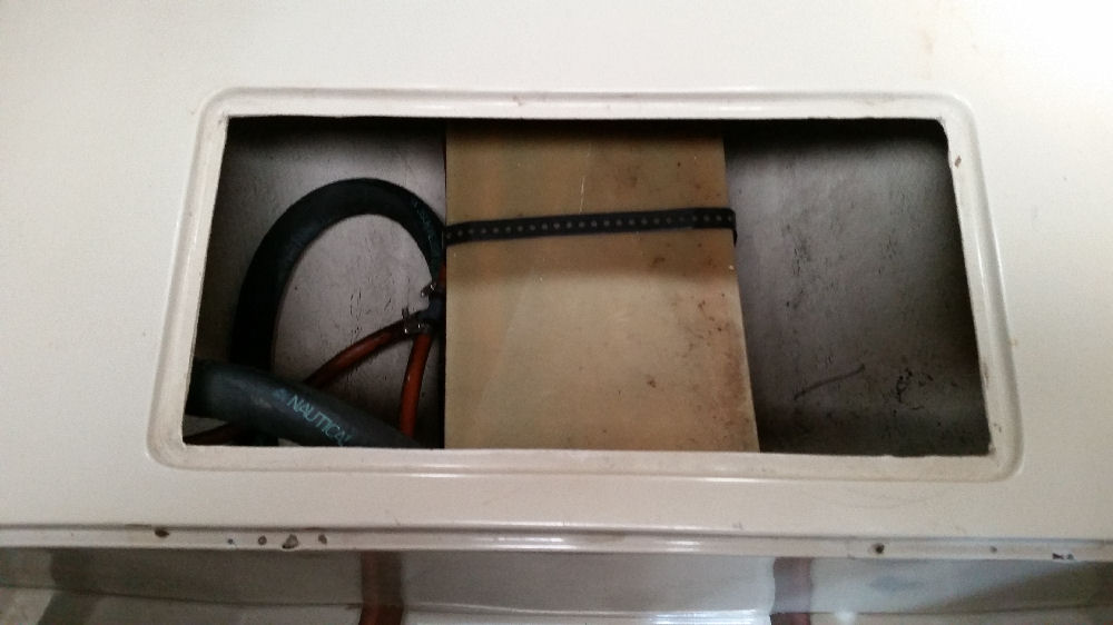

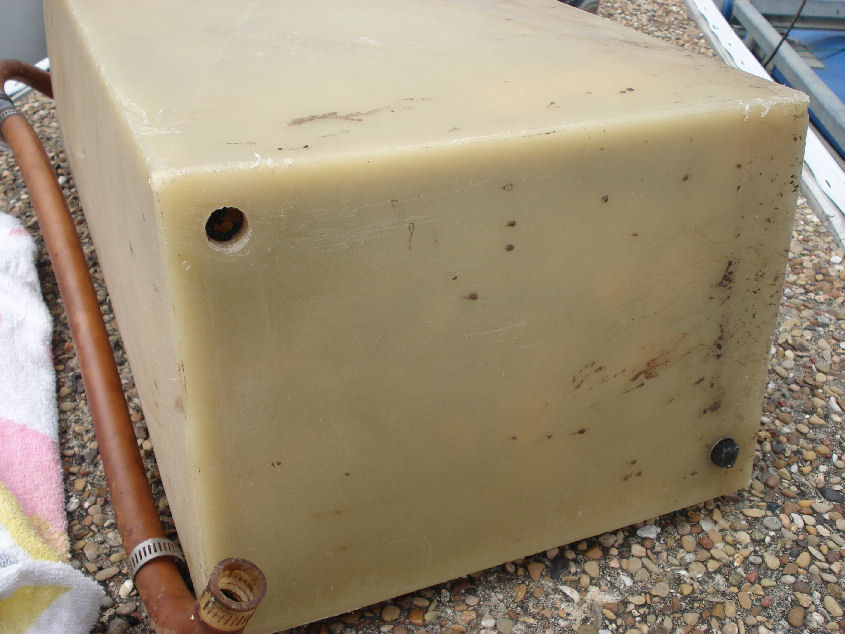

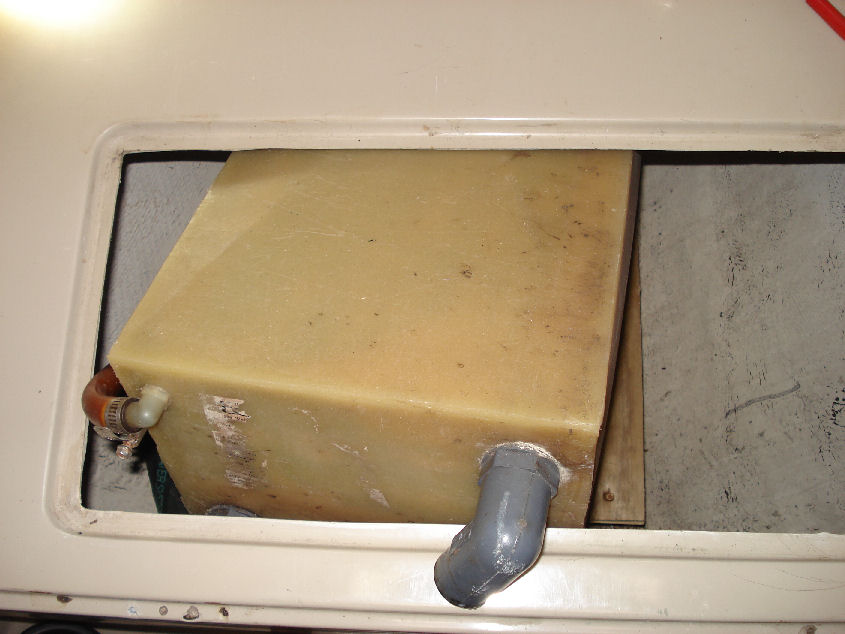

Also why does it have 2 vent ports? 1 is on the top (logical) the other appears to be on the bottom in the back though it is hard to see that area (see photo)
Dec 2, 1997
9,011
- - LIttle Rock
I'll answer your second question first. A port at the bottom of a tank can't be a vent...I suspect it may be a separate dedicated port for a macerator pump to dump the tank at sea.
Now...about a tank replacement. Your best source is Ronco Plastics (no relation to the VegoMatic Ronco) Ronco Plastics Marine Catalog They make TOP quality thick-walled water and waste tanks for a very reasonable price and have more than 400 shapes and sizes, over 100 of which are non-rectangular, and they install fittings in the sizes and locations specified by the customer when they make the tank. Once you've picked a size/shape, I'll be glad to help you spec the fittings sizes and locations. From your photo, it appears to be under the v-berth, which is the best place for a tank unless that would make the run from the toilet too long.

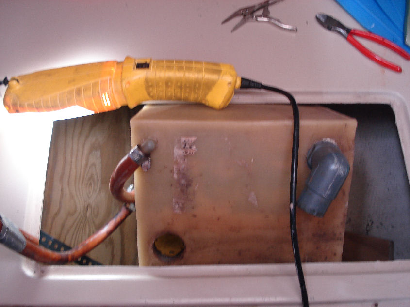

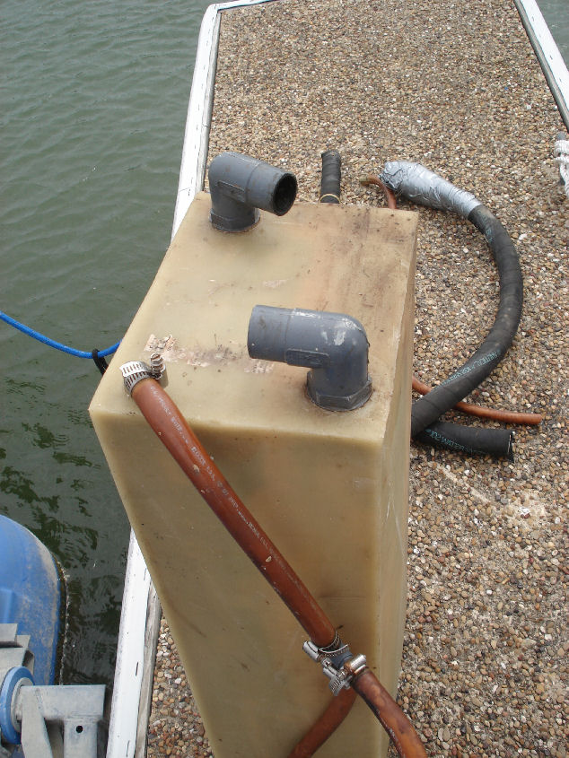

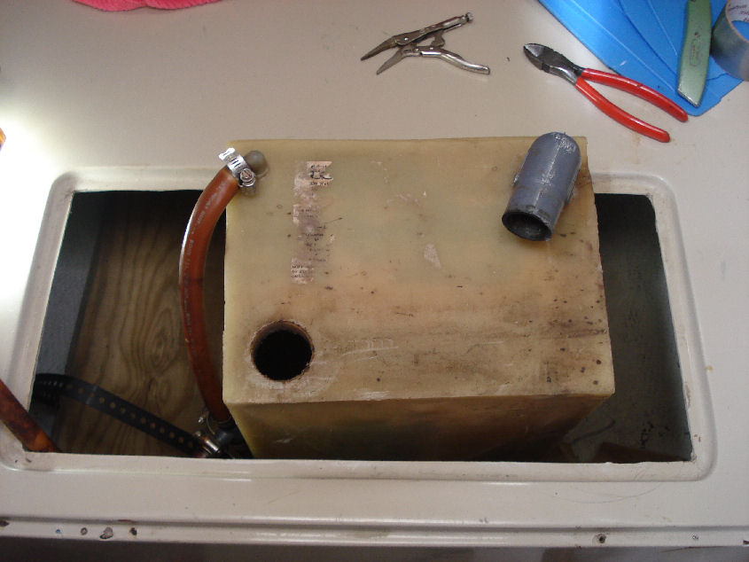

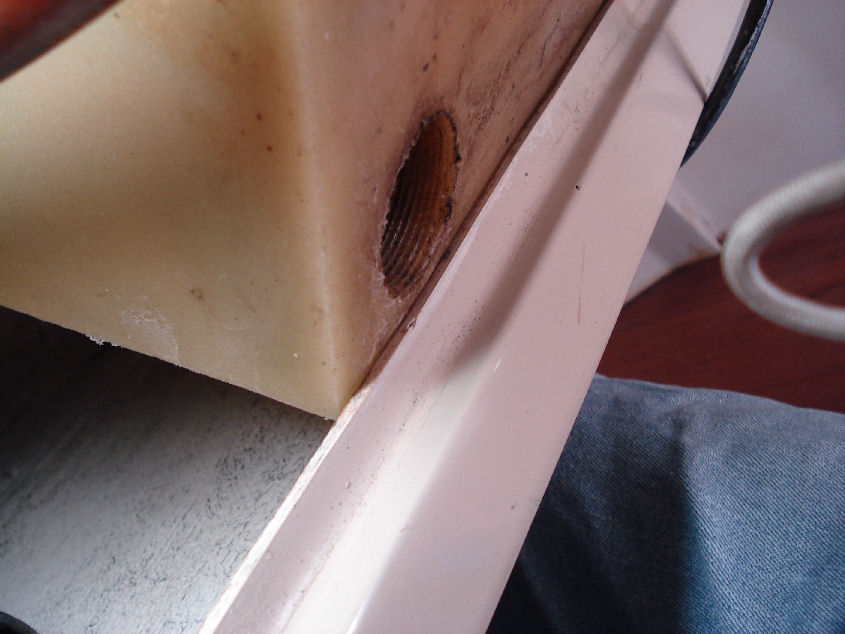

Ok success today! Everything but the toilet removed and already smells 200% better down below. I cleared the plugged vent line at the thru hull (damn spiders) and flushed the system thoroughly with fresh water and pumped out as much as possible. All the lines came off by hand, no need to cut any off. Being careful I bet I didnt spill more than an ounce of sewage. The difficult part of the project was removing the tank because it is a very tight fit through the access hole. It was necessary to remove the inlet and discharge elbows from the tank, they are threaded and just turn out. Also, the wooden tank mount had to be taken apart and slid aside to allow more room. Just required removing 5 wood screws that where easy to get to. So close! Still, I had to pry out just a little with a screwdriver. The big surprise was the vent and the drain hole plug on the back of the tank were installed wrong. Somebody, I assume the manufacturer, put the vent elbow on the bottom and the drain plug on top! Good thing there were 2 vents, the one in front did all the work while the one in back must have filled up to meet the tank sewage level all the time. See the picture..note the TANK IS TURNED UPSIDE DOWN IN THE PHOTO AND I HAVE THE ELBOW REMOVED.

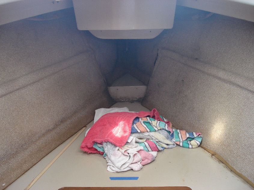

The dimensions of the factory tank are 29.25 long, 9 high and 12 wide. That equals 14 gallons, not 15 as advertised in the owners manual. Now I have to decide on the tank size. If I go larger I definitely have to widen the access hole. But I can only go a few inches forward to the beginning of the blue tape that I have marked because there is a stiffener that runs across underneath. If I go wider the tank must be shorter unless I have it specially made to a V in front. The only option I see is going higher as there is plenty of room for that but how high? If I can add 2 inches to the the height that will give me 17 gallons. Maybe I will make a wooden box at those dims and make sure it will fit. Should I have the intake on top? The pumpout on top with a standpipe? I know I want a 1" vent on top.

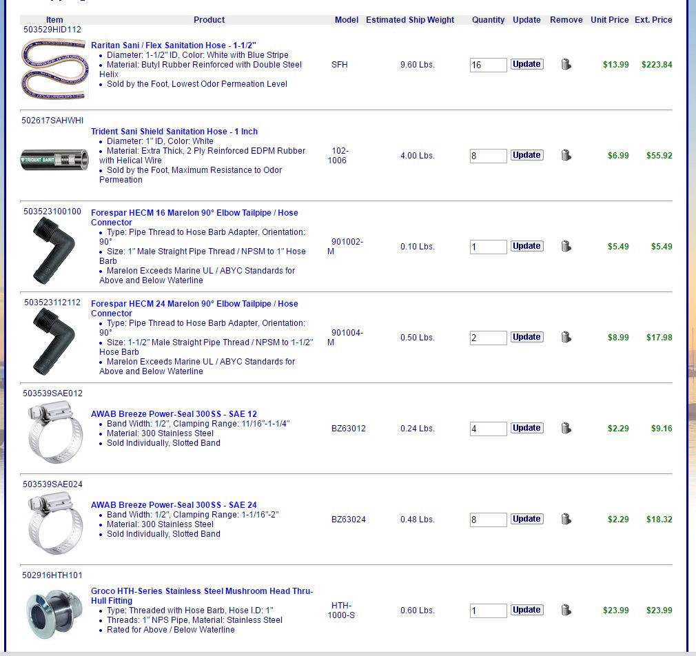

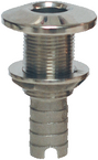

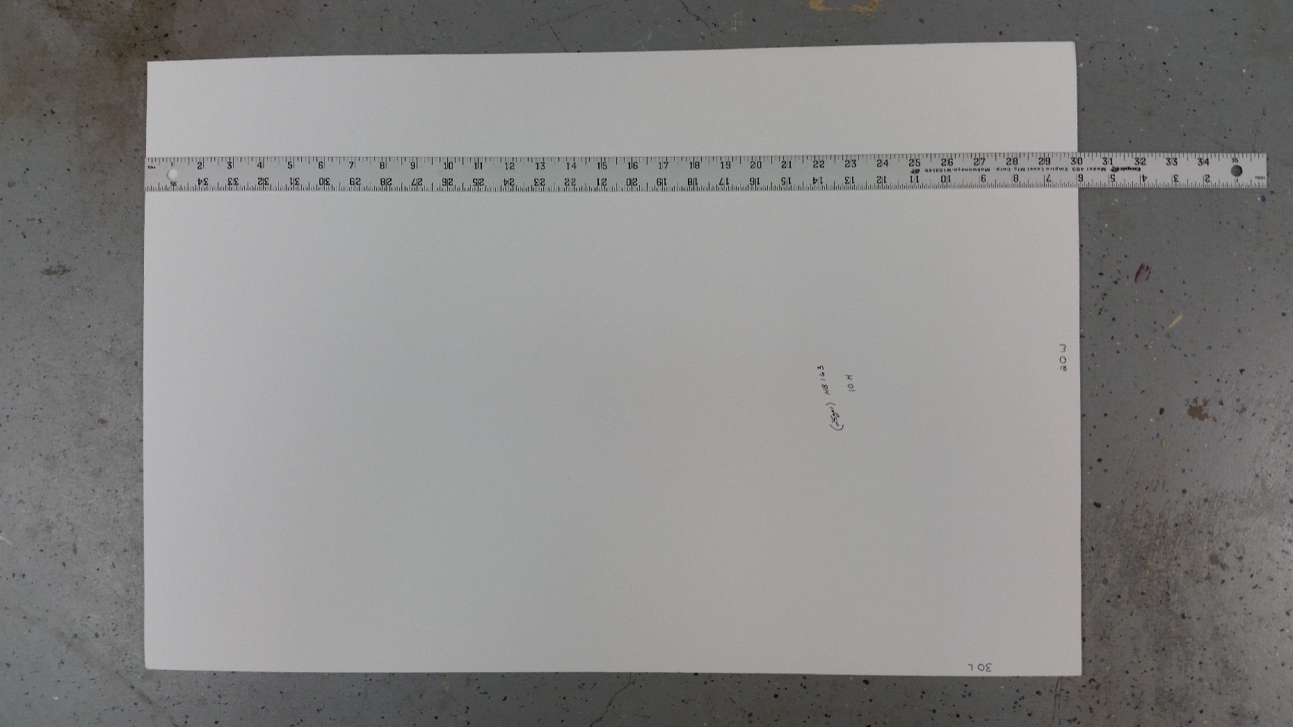

Made a template from some art board. 30L x 20W x 10H. Will go to the boat on Wednesday to see if this will fit with minimum trimming to the access hole. I am hoping that if I raise the tank higher the extra 8" width will fit at the front (V). If so I will order a Ronco HB163 25 gal. If not I have to go with less width and less volume. Should I put the inlet on top? If the discharge is on top can I have them install a tube that reaches the bottom of the tank or just do a side discharge with the tank slightly canted towards discharge elbow? I want a 1" vent on top per Peggys advice. Also, this is the thru-hull I am considering. Overkill????
