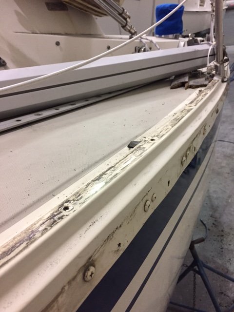

Here is a photo. I do not think the screws hit core. No evidence of wood fibers when I removed the old ones.
I'm not following a couple of your comments - "I have seen holes filled with epoxy that were then screwed into, screw was coated with mold release. One hardened the screw could be unscrewed and there was a ready made pre drilled and threaded screw site to attach something." Please explain further. "mold release?" These are screws only with no nuts on the back side. They are fairly short, maybe 1.5 to 1.75" long including the 1/2 inch or so thickness of the old teak rail I removed.

The screws can be inserted into the epoxy while it is still curing, but you have to wax them, so they do not get stuck. I have not done it.

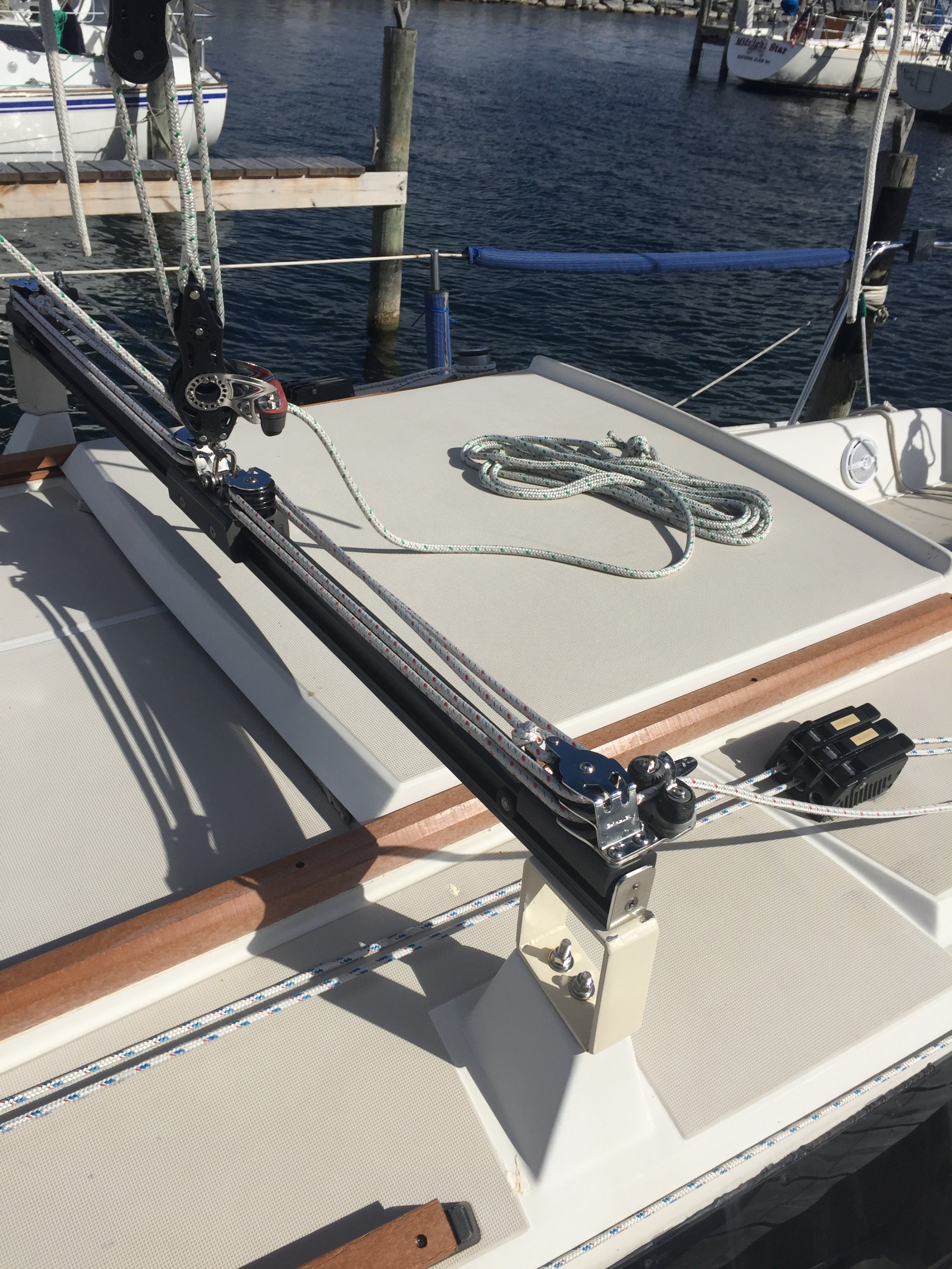

As far as the plasteak, I think it bonds because I have cut it, and it has a rough face just like wood. If you saw Starboard, the edge is often glossy. I have never tried to bond shiny, uncut starboard with 5200. You can see in this photo how the side is matte. The bevel is shiny because it is routed. Those sliders are glued down and screwed. You will have no problem with a toerail.

AG has it right. Question. Are these screws with machine thread, wood thread, or metal threads? If Machine thread then the O'day may have a threaded metal plate (like some Hunters) imbedded in the fiberglass to receive the screw. Then you only need to worry if it is stripped and requires rethreading. The epoxy screw idea is best accomplished with a screw that has a large thread(i.e. wood thread screws). Essentially you are creating an epoxy hole with screw threads. The inserted screw when removed leaves the threads to be used to attach your hardware. Ok for hardware that will not have heavy use (IMO. I would not trust it for a handhold I want to use to stop myself from being thrown into the water. For that I want a fixture to be through bolted and a strong backing plate. I want to loose grip before the handhold looses grip.)

I would guess they are 1 - 1/4" wood screws. That is what is used on my 272.

I'm no expert on screws but given the description above, I think they are wood screws. My shop is doing the hand rail install. I'm trying to do as much prep as I can. If I need to leave the epoxy uncured then I guess I defer that task to them.
What I'm hearing is that I do not need to pot out these holes before apply epoxy
