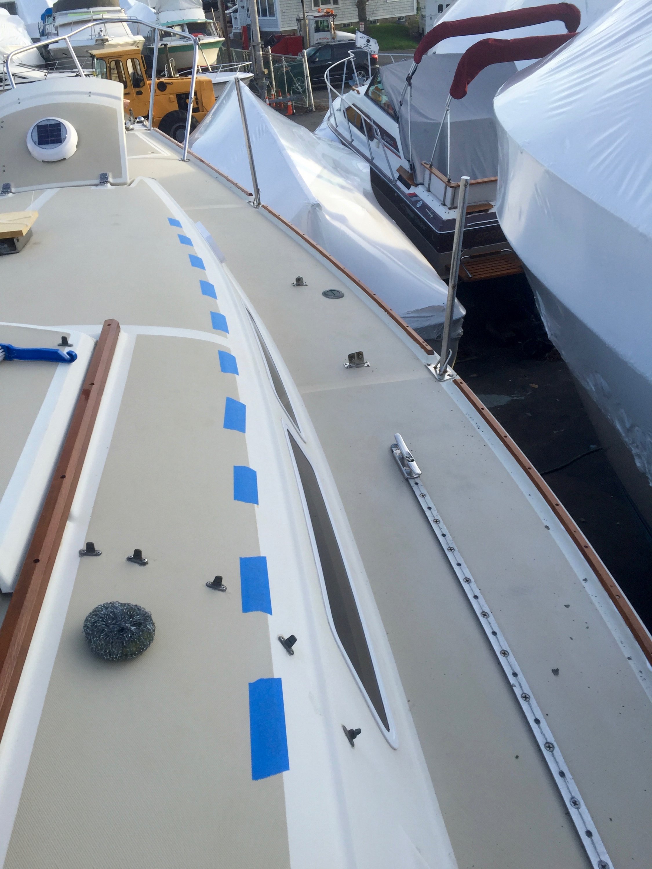

I have been working on replacing all the teak on my Oday 28 Take Two.
I have 6 of the 8 toe rails installed just the last two to go... They are the ones with the greatest curve to them.

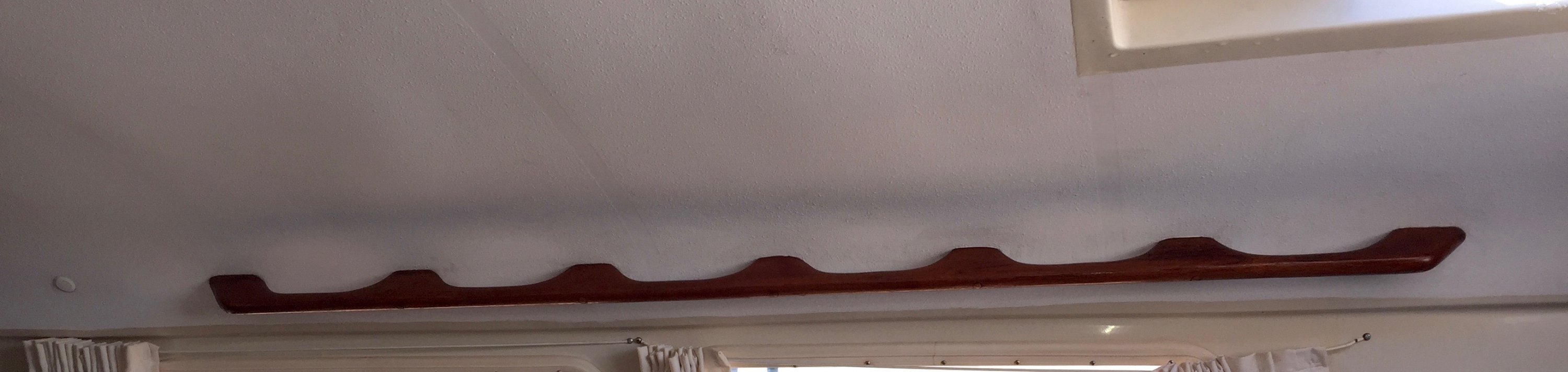

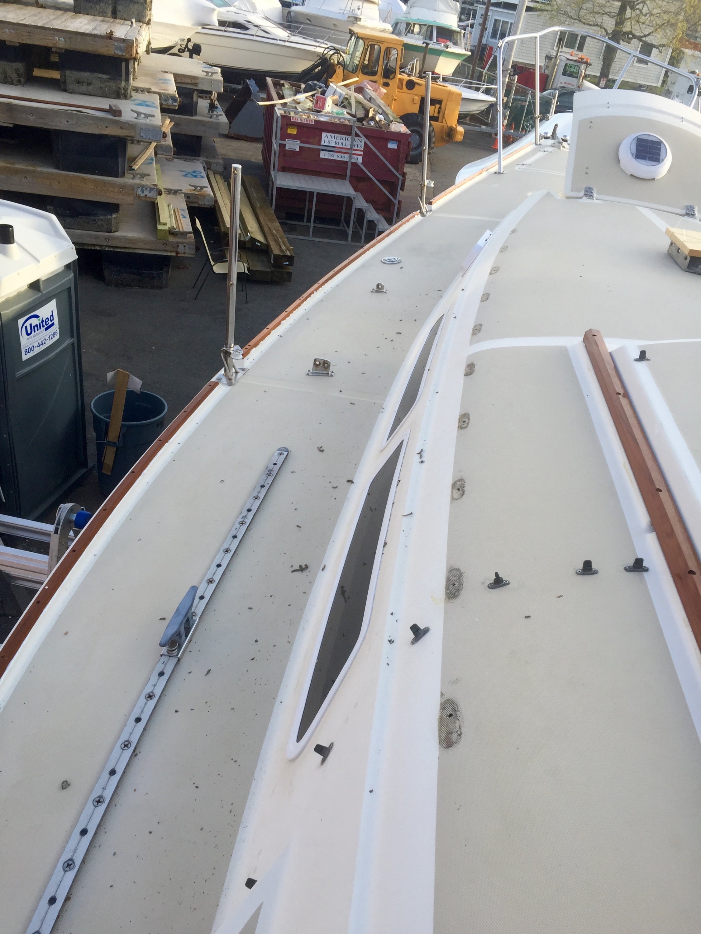

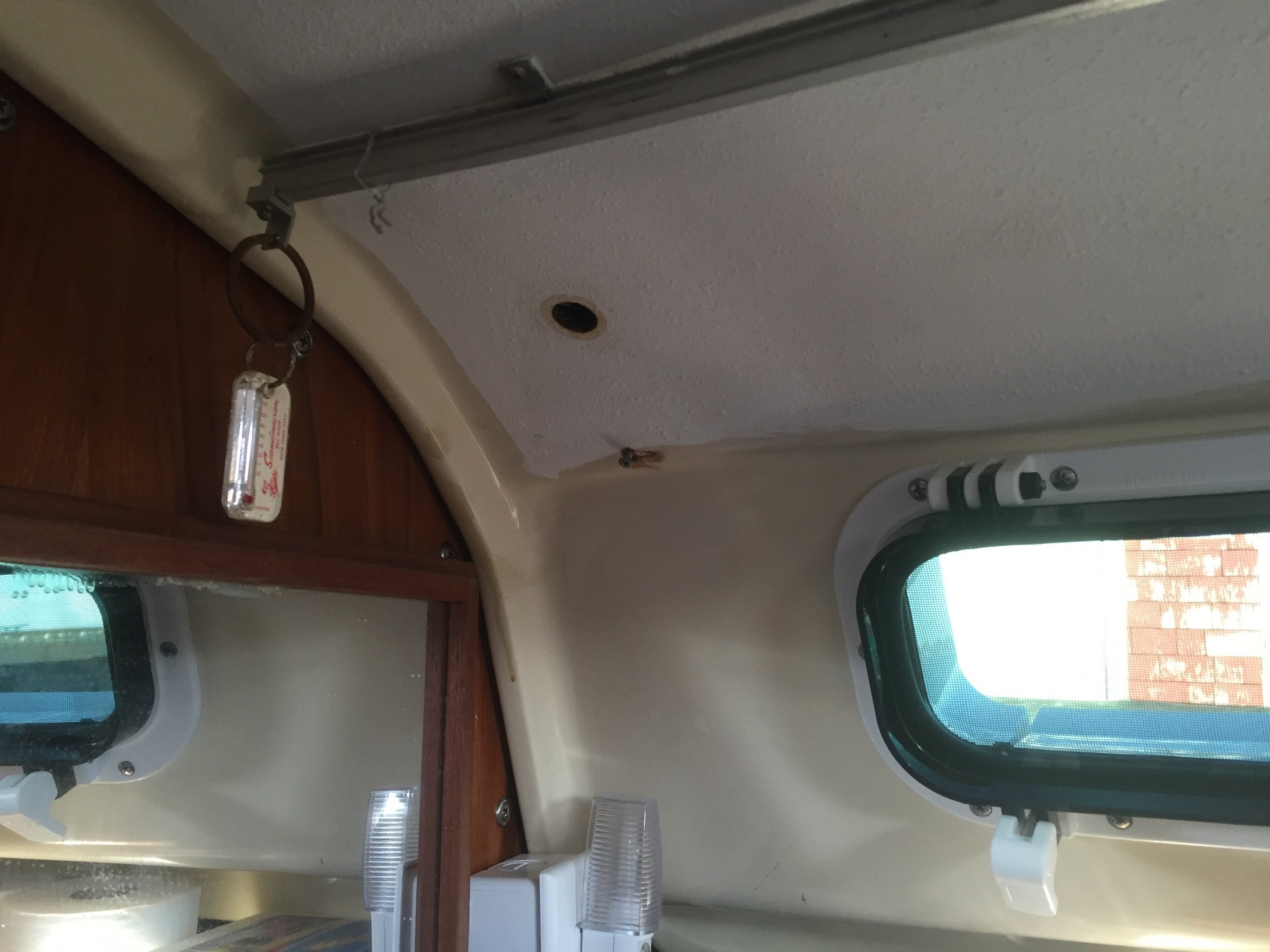

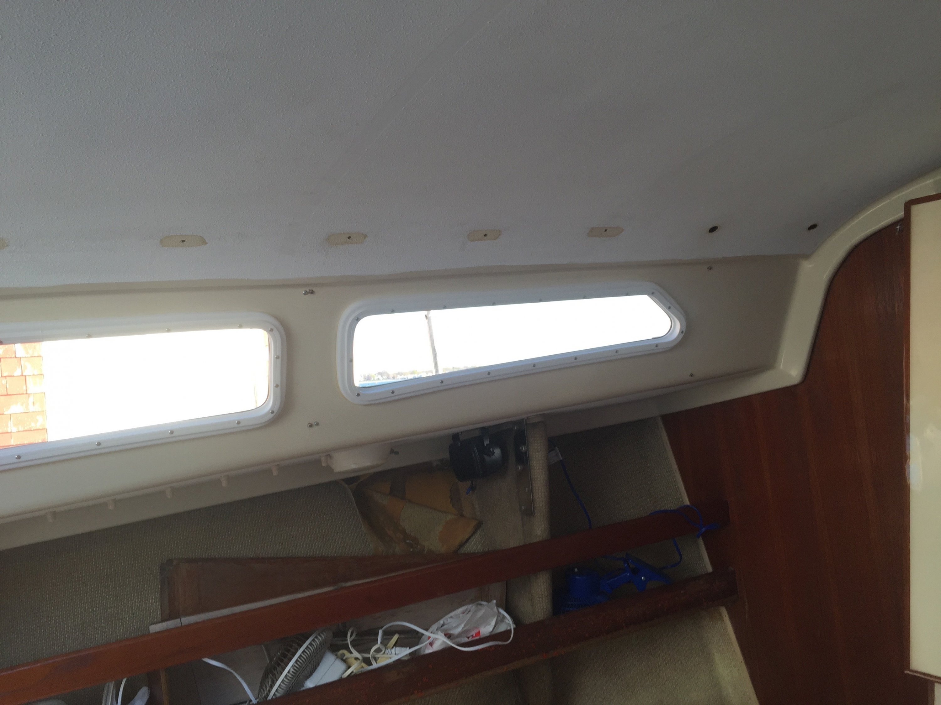

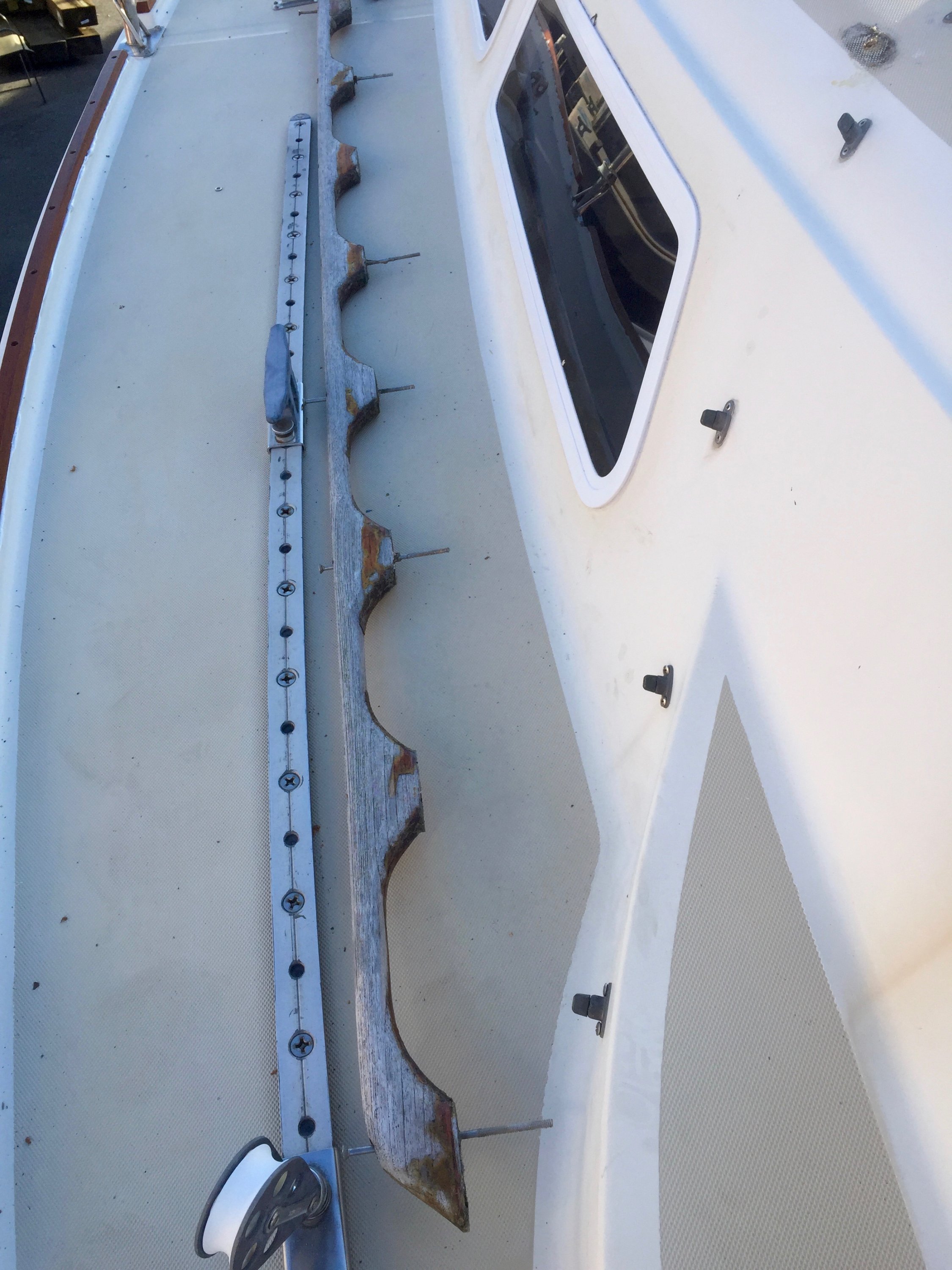

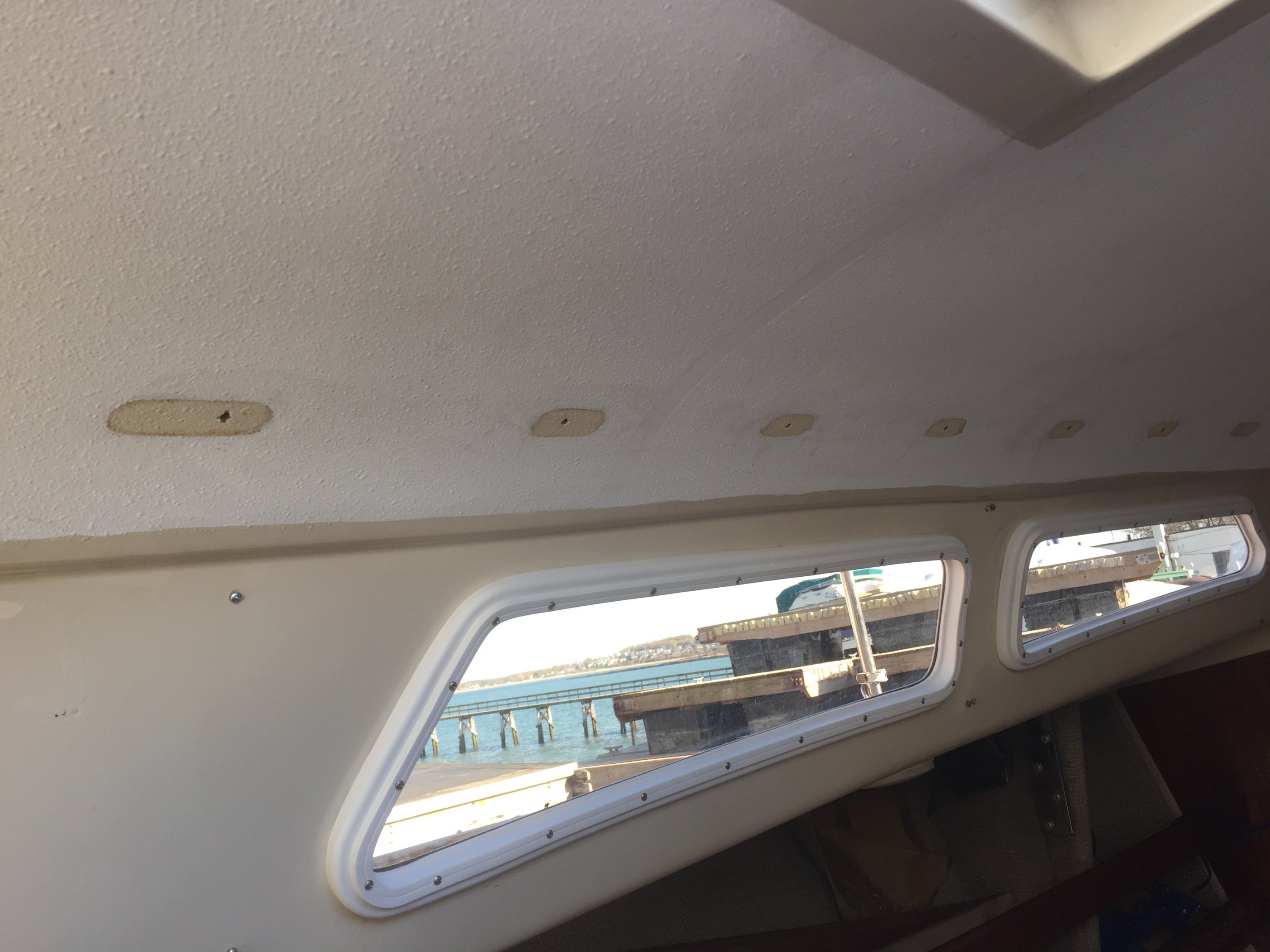

So here what I've discovered;
The outer handrails have long bolts that go though the cabin top into the inside handrails where the washers and nuts are. I was surprised to find the bungs had been drilled out to allow for the shaft of the bolt that extended past the nut. One other surprise... although it should not have been, the last bolt is located in the head. I thought there were only 2 bolted without the inside handrail but there is a 3rd.
The bolts are not uniform. The forward three are shorter.
There is a lot of adhesive in the holes with the bolts. There are hard to remove. I used a bolt I did get out to knock out the others from inside the cabin.
I rand out of daylight so I did a quick cleanup put some tape over the holes. Not sure if I'll be able to get the new handrails on before the rain expected in two days.

Great pics! Looks like you've got it licked at this point. The handrails on the 27 are similar from the standpoint that the attachments go forward into the head area. On mine the heads of the screws (not bolts) are visible in the cabin and just have a decorative washer under them.

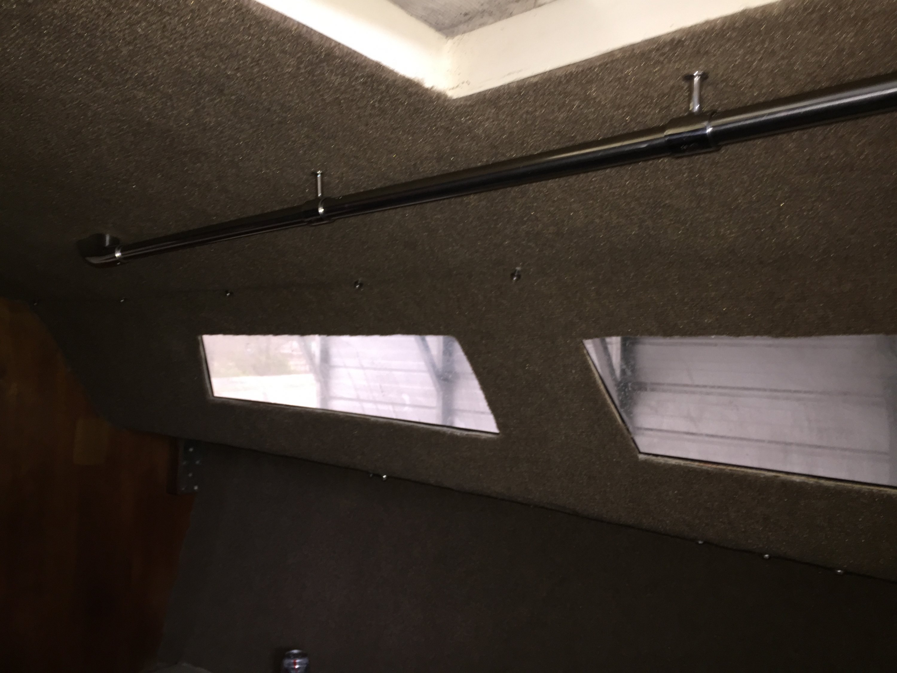

I replaced my handrails with Plasteak, and I installed cabin handrails made of Stainless. I mounted them under the slider rail.
The end mounts screw upward into T-bolts sunk into epoxy below the slider rails. The middle hangers are hung on bolts screwed down from the slider mount.

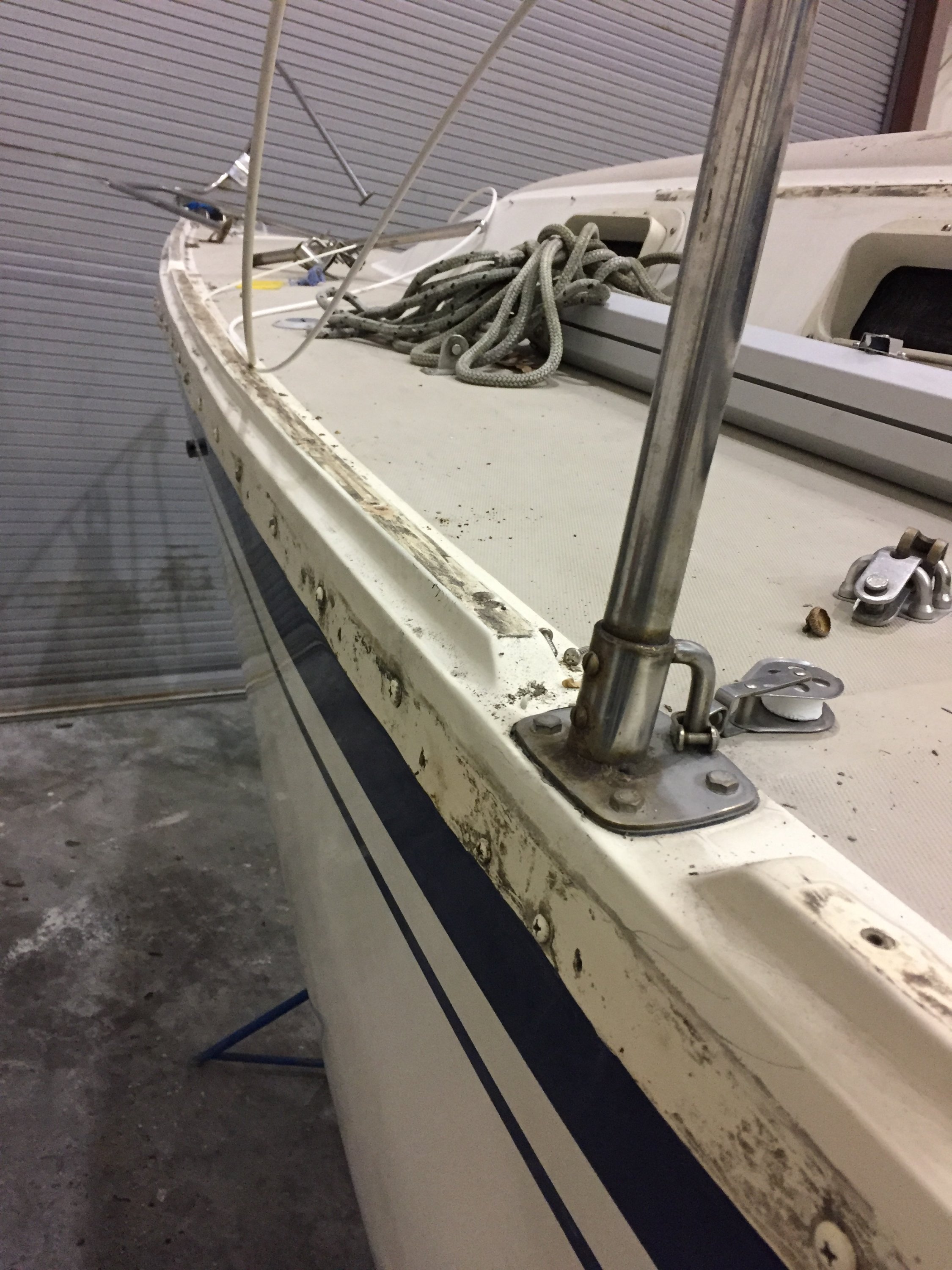

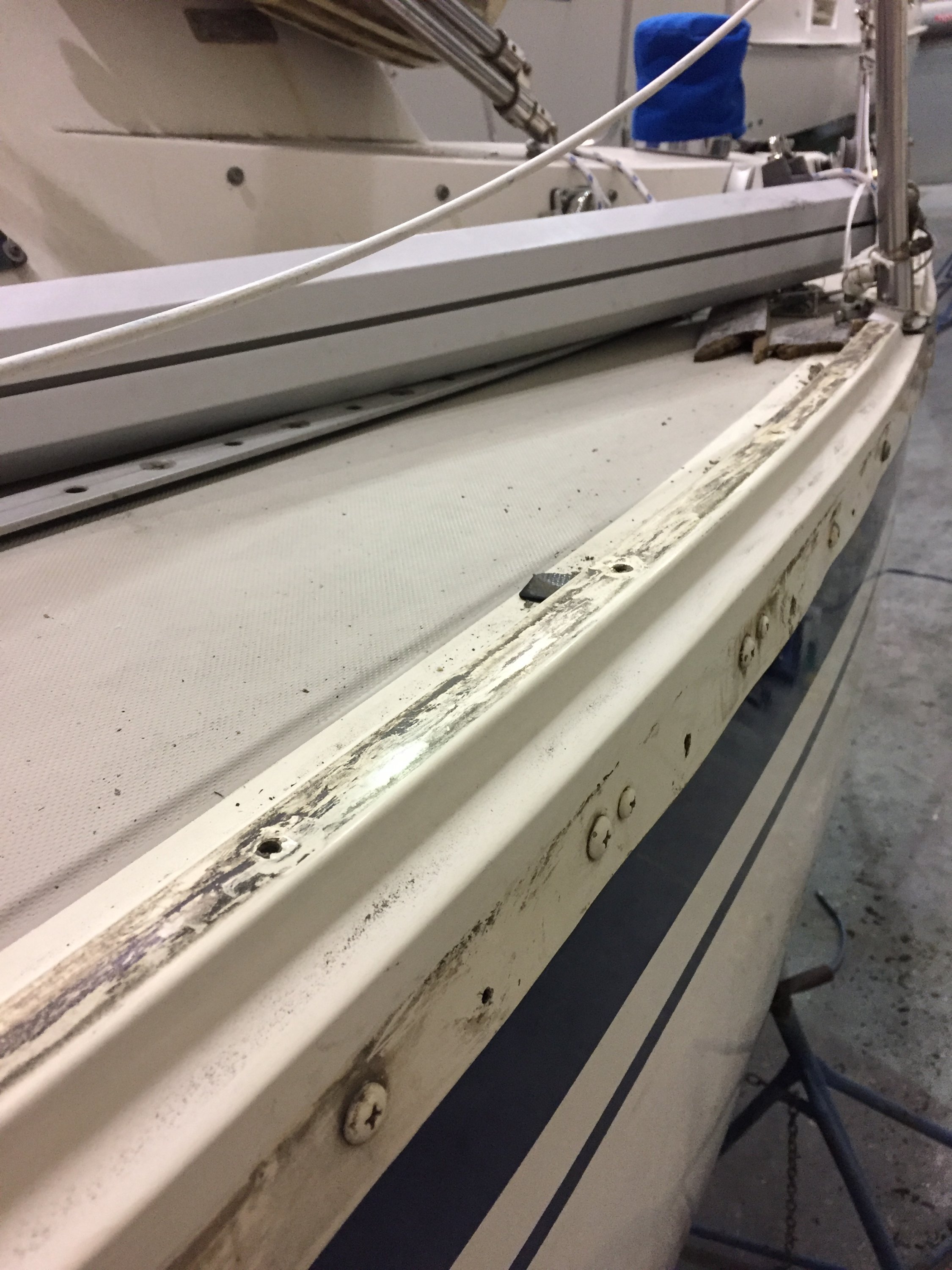

after removing the old teak rub rail and toe rail and eyebrow I've been busy cleaning and preparing the surface, cleaning it and removing old sealant. I used a scrapping tool and a rag with acetone and lots of elbow grease. Spent hours on it and it much better than it was but still has residue. Probably need to remove it all before installing the track and new rubber rub rail. Any tips on how to do this?

I mailed in the old hand rails, toe rails and eyebrows to Plasteak for replacements. for the toe rail and eyebrows 'll clean the surface and epoxy the old holes, then drill new holes to install the replacements. Do I need to hit new areas when I make new holes or is it safe to drill thru the epoxied areas? what about the hand rails? Do I use the old holes so as not to introduce new holes in the ceiling of the cabin? What sealant is best for all this stuff?
