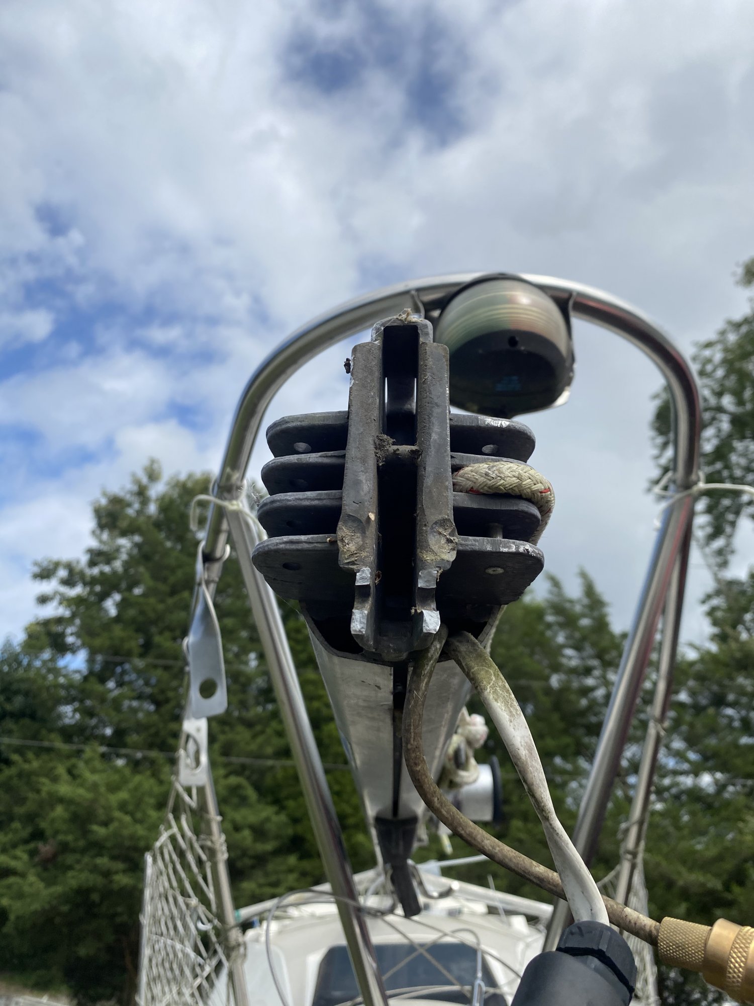

Hello everyone,

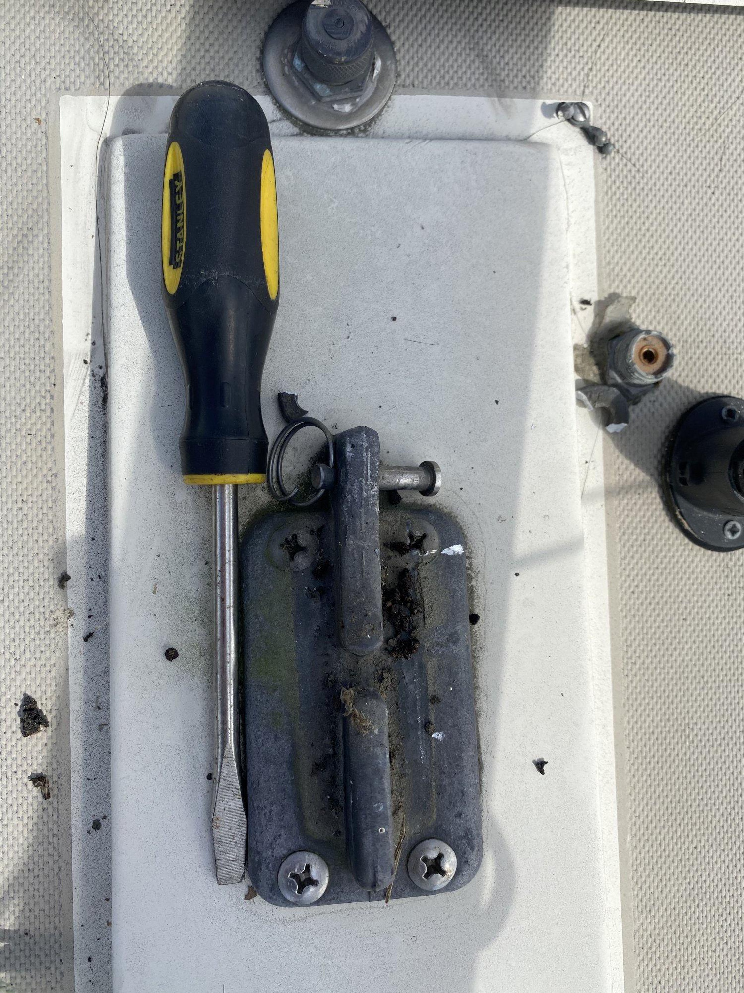

Just managed to damage the loop at the mast foot hinge. The base plate at the boat is fine. However, the section at the bottom of the mast snapped both hinges loops.
I found the part number apparently is Z-145SF-10/245 but I cannot find that part anywhere does anyone have any idea where to find such part?
Is for a 1986 O’day 222
Also, I think the mast should continue to work as it should since most of the baseplate still intact and the all the lines are fine any thoughts on that ?
I appreciate any feedback I’m fairly new to sailing and this is my first boat. Thanks for reading.

Try d & r marine..... Rudy may have it or will have an idea where to get it. Good luck!

That’s a Z Spar base, same one my 1988 192 has. Contact US Spars for a replacement. I think you may need to replace the base and the step on the boat because the step for that particular mast extrusion was changed. I can’t remember exactly though.

Z? Z Spar maybe but now Us Spars.
Could be Keyon-Isomat but contact Rig Rite
Dwyer mast?
dave: not exactly sure. that’s something I’ll have to check next time I’ll stop at the boat yard. I’ll definitely look for that.
I did contact rig rite and they do have a replacement part. With their option I will need to swap the mast base plate. That’s a solution but if I find the replacement 1-1 I rather take that route.
