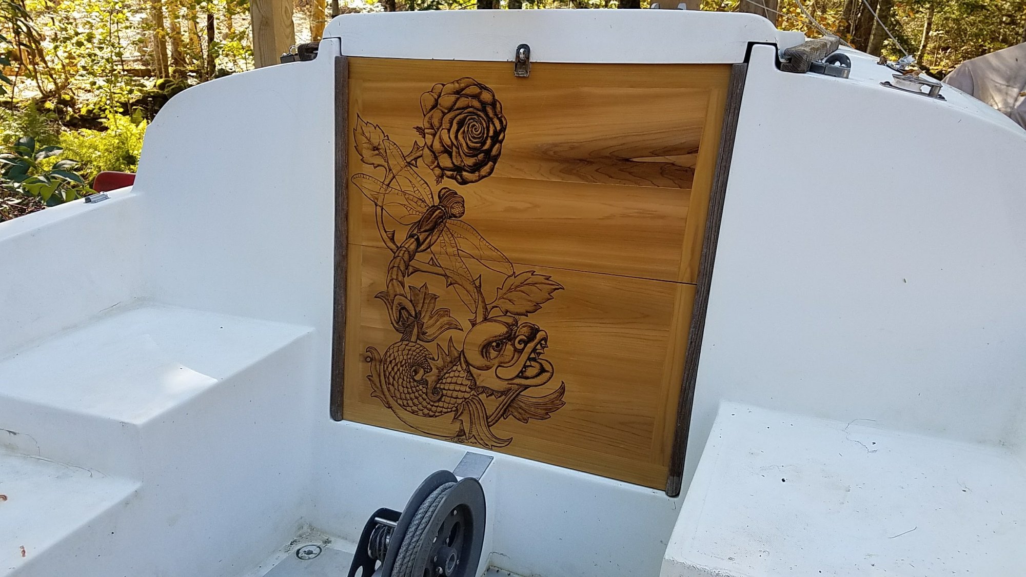

Beautiful work on your own hatch doors. Is that wood burning? And what type of wood?

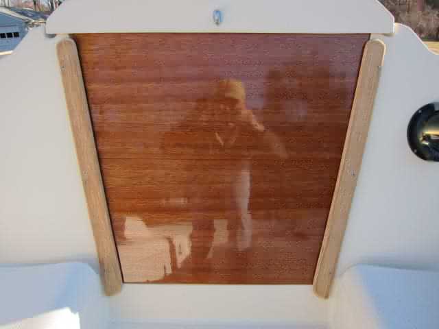

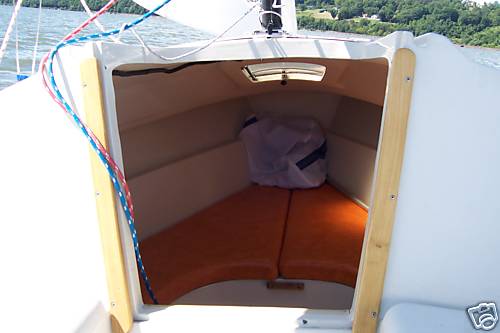

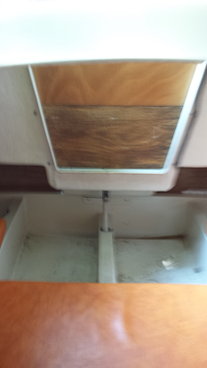

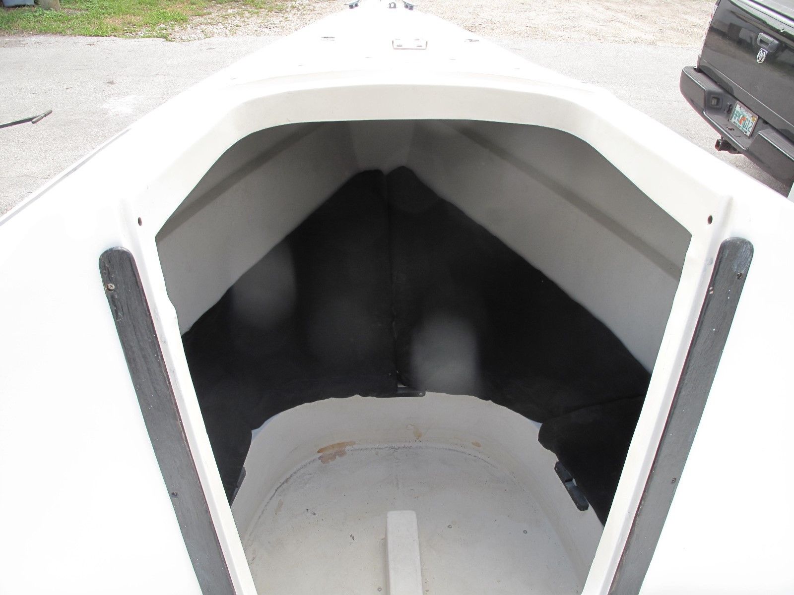

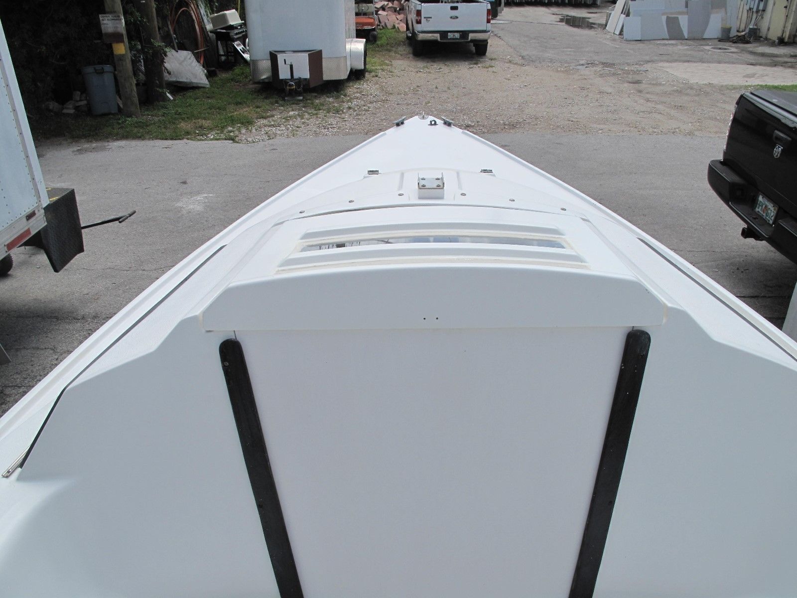

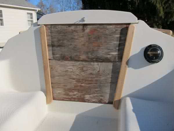

I don't have an O'DAY 19 either, but have made companionway drop boards for similar boats.
Here are a few pictures of O'DAY 19 drop boards to help others picture what you need. Too bad none have dimensions <GRIN!>

Thank you. Yes it's woodburning. I made them from Spanish red cedar. Not a strong wood if you expect to sail in heavy weather, but easy to handle and work with. If I ever get to take Dragonfly out for and ocean sail, I'll do something with plywood.
-Will

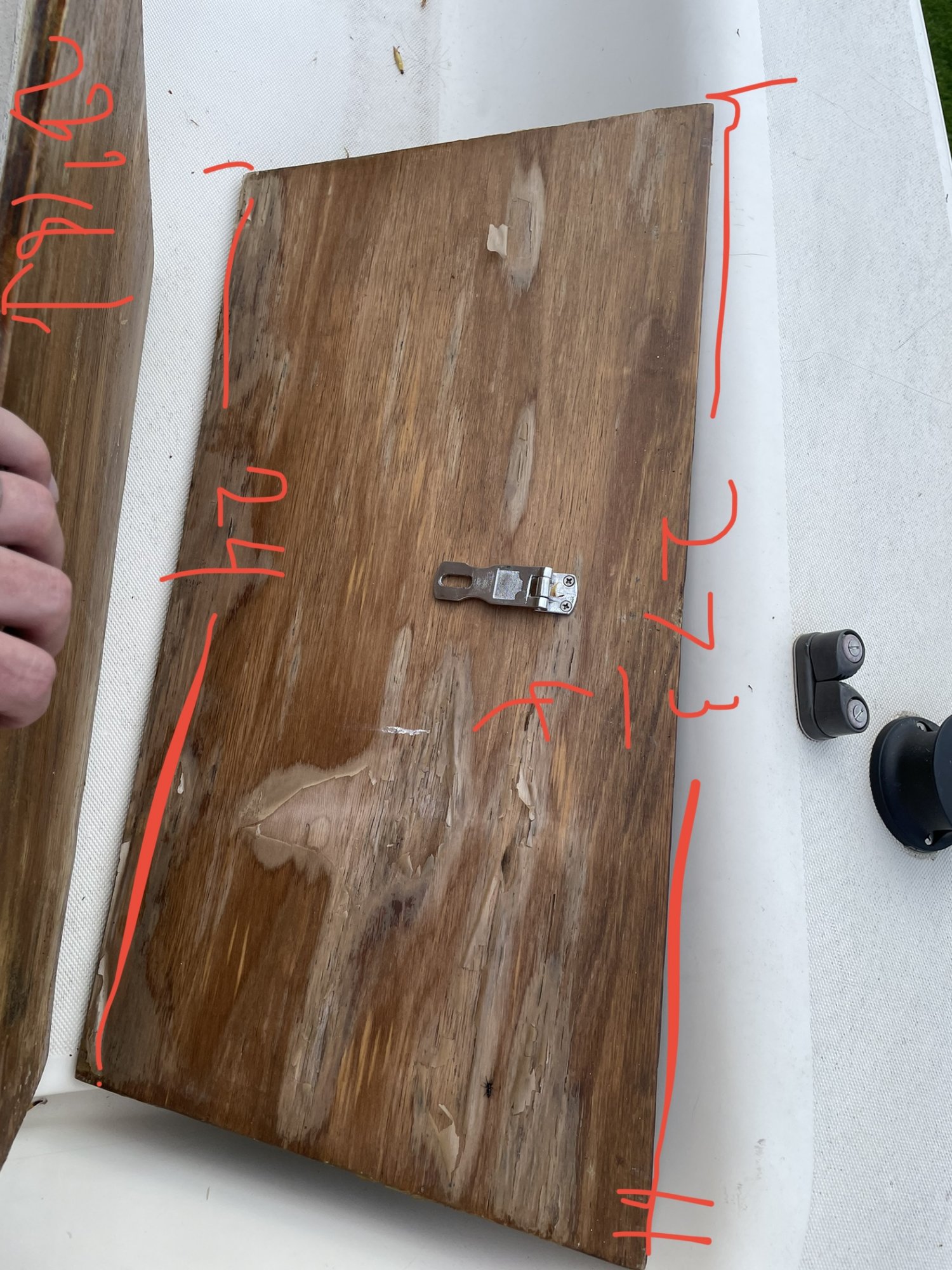

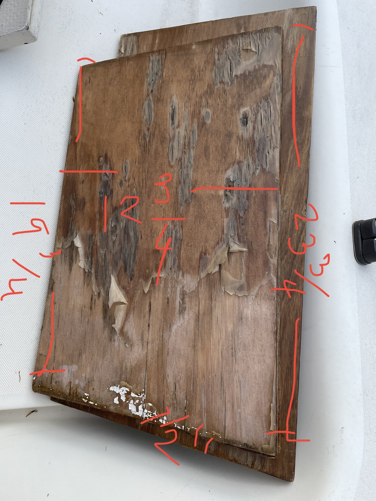

Just got my O’Day 19 about 3 weeks ago, lots of little projects including the companion way doors! Here are mine with measurements.
Thanks! Love the one where the new door shows your reflection.
