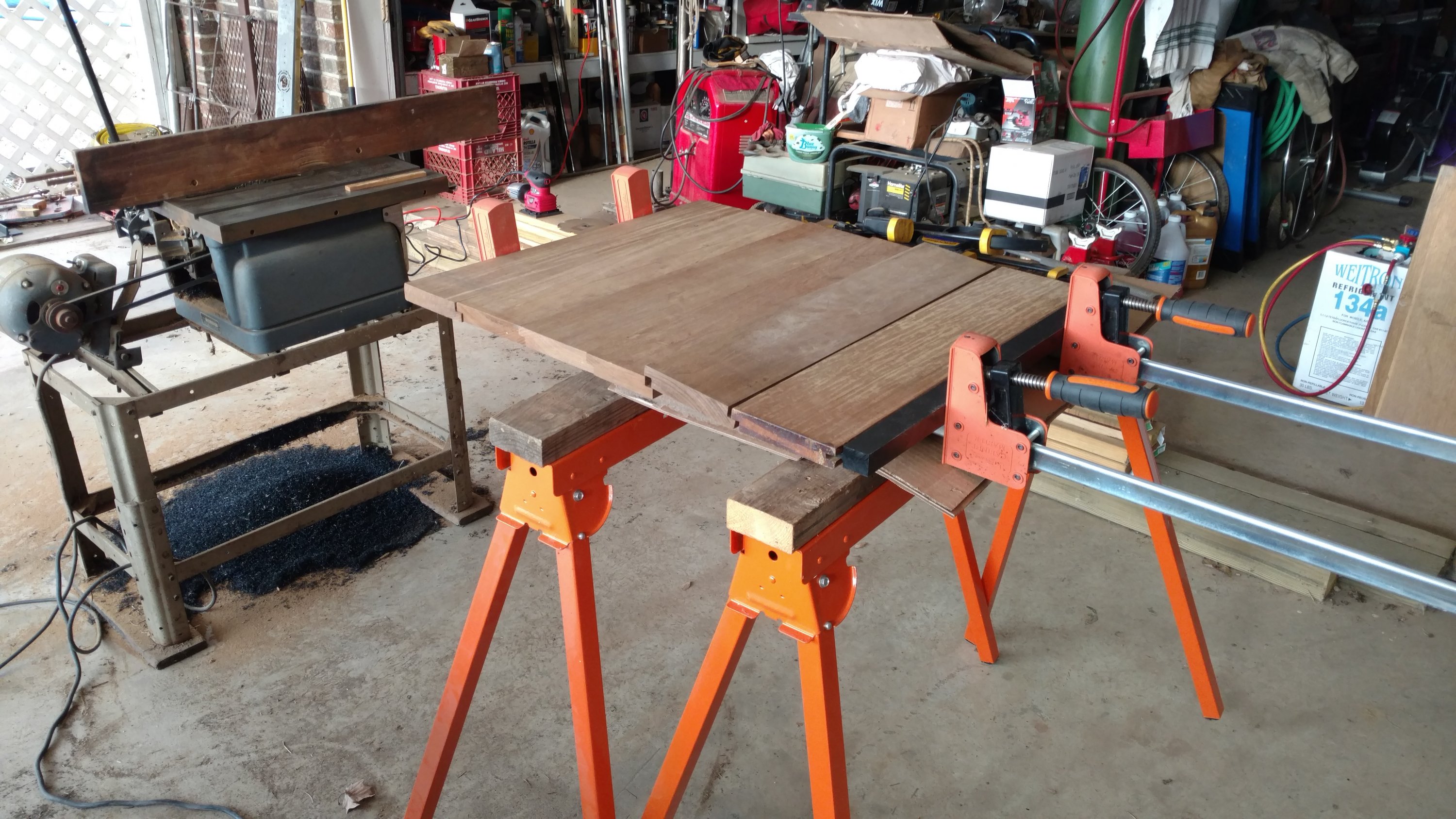

1. Making the Panels: The panels would need to be glued up to meet the width required for each board. both boards together total 26" so each one has to be 13" wide, plus a small overlapped bevel between the panels (I will add that to the lower panel). It is a good idea to make the blanks about 1/8” - 1/4” over-sized. Subtracting the 1-1/2" top rail means my panels need to be 11-1/2" plus 1/4” wide and my rough cut planks are between 5-1/4" and 8" wide. One glue joint is needed.
I have to say, I have worked successfully with many types of wood before, but the only projects I had done with cedar up to this time were rougher carpentry type jobs, casing doors and window, wall paneling and my deck railing, all in finished 3/4" stock. 1/2" cedar is very fragile. I made two attempts to glue up my half inch panels that ended with my dadoes splitting out before I found a way to manage. At first I setup my clamps and laid out wax paper for my parts and did a dry run before applying a 2 part 20 min epoxy and getting it in clamps. The first time, the pressure of the clamps was uneven and the 1/2" thickness couldn't counter the bowing force of the clamps. POP and one panel was lost. I built a table top clamping jig to hold the panels flat while I clamped them but this time, my premeasured 20 min epoxy hardened in just 3 minutes and another panel was lost along with the limited amount of spline material on hand. I ended up not having the dark/light contrast and I never got it into my jig. I switched to Gorilla Glue. Gorilla glue is better for this type of gluing anyhow, since it uses the water to penetrate the pores better than epoxy and is a stronger material bond (the glue itself has strength) than yellow glue. It even holds end-grain joints together well. The nicest things about Gorilla Glue is that it sets faster than wood glue, but slower than 20 min. epoxy, is water proof and it doesn't need as much clamping pressure because it is gap filling. Care has to be taken to moisten the glue surfaces first (I think of it like painting with water colors - the paint flows where the water wash is spread before-hand) and the water also improved penetration and the activation action of the glue. Always use water with Gorilla Glue.
I tried a different approach because of Gorilla Glue's low clamp pressure needs. I covered the length of the glue joints with waxed paper and wound packing tape around the parts to hold them together. This proved to be fast and with five or so turns, quite adequate for pressure. The pressure was also very evenly distributed with a winding of tape around either end, one around the middle and two more dividing the two halves again.
Here's one panel with the end-rails taped together.
When I took the tape off, I only touched the panels with a 220 grit Porter Cable mini-belt sander to knock the excess glue off and level any minor wondering of the joints.

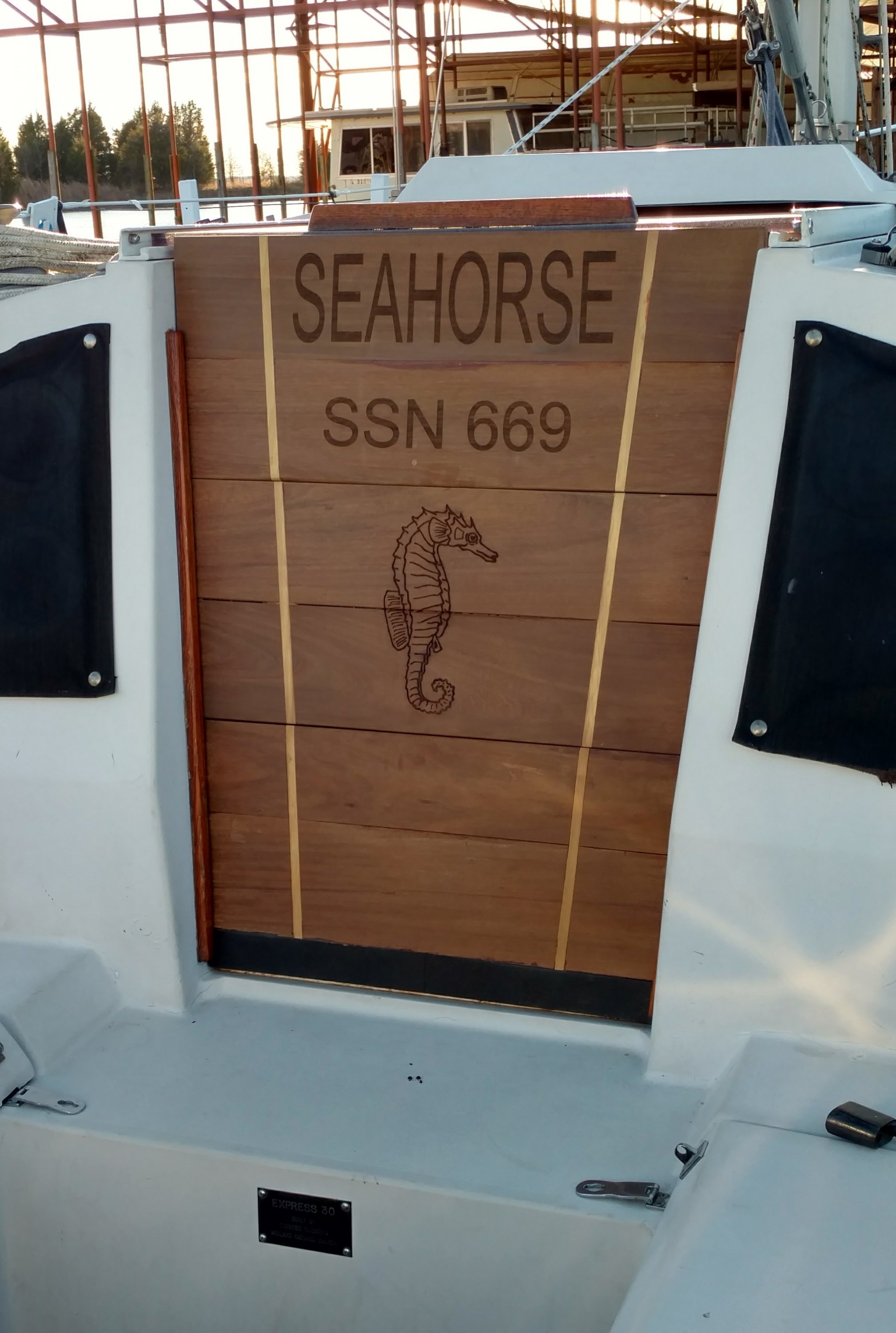

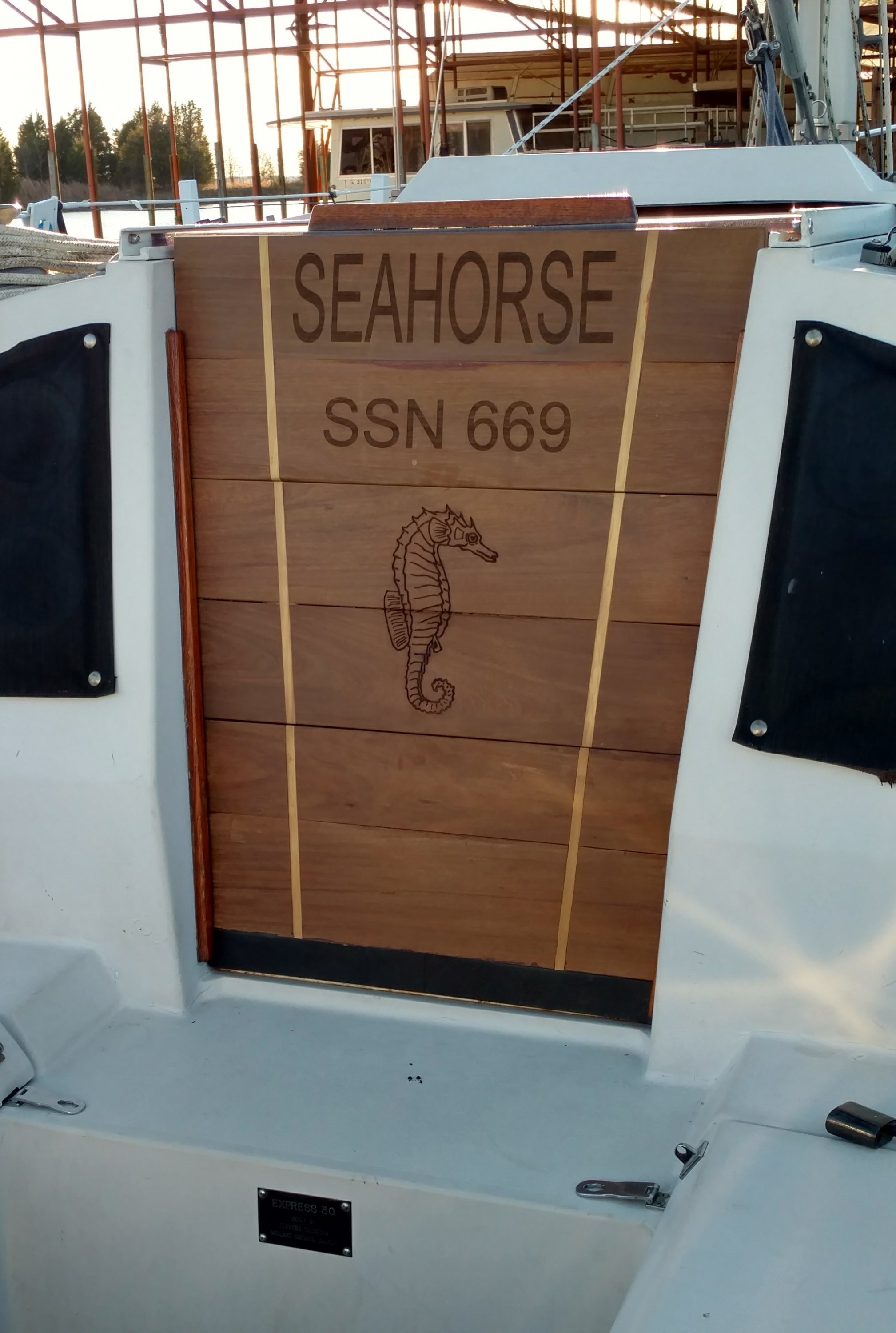

Here is a pic of the hatch boards I made for my good friend John (jssailem). The name of his boat is “Hadley”. After his grandson of the same name and a WWII destroyer (DD774) of the same name where his grandfather was the keel laying Captain (first captain of record). Please correct me if I mangled this John.
The wood is Ipe more commonly known in boat circles as iron wood. It is inlayed with 0.15” maple. There is a 1.5” strip of maple running down the inside center. I gave it to John rough sanded, his job was to finish sanding and varnish. The inside was also run thru a panel raising shaper to bring it down to fit in the companionway slots.

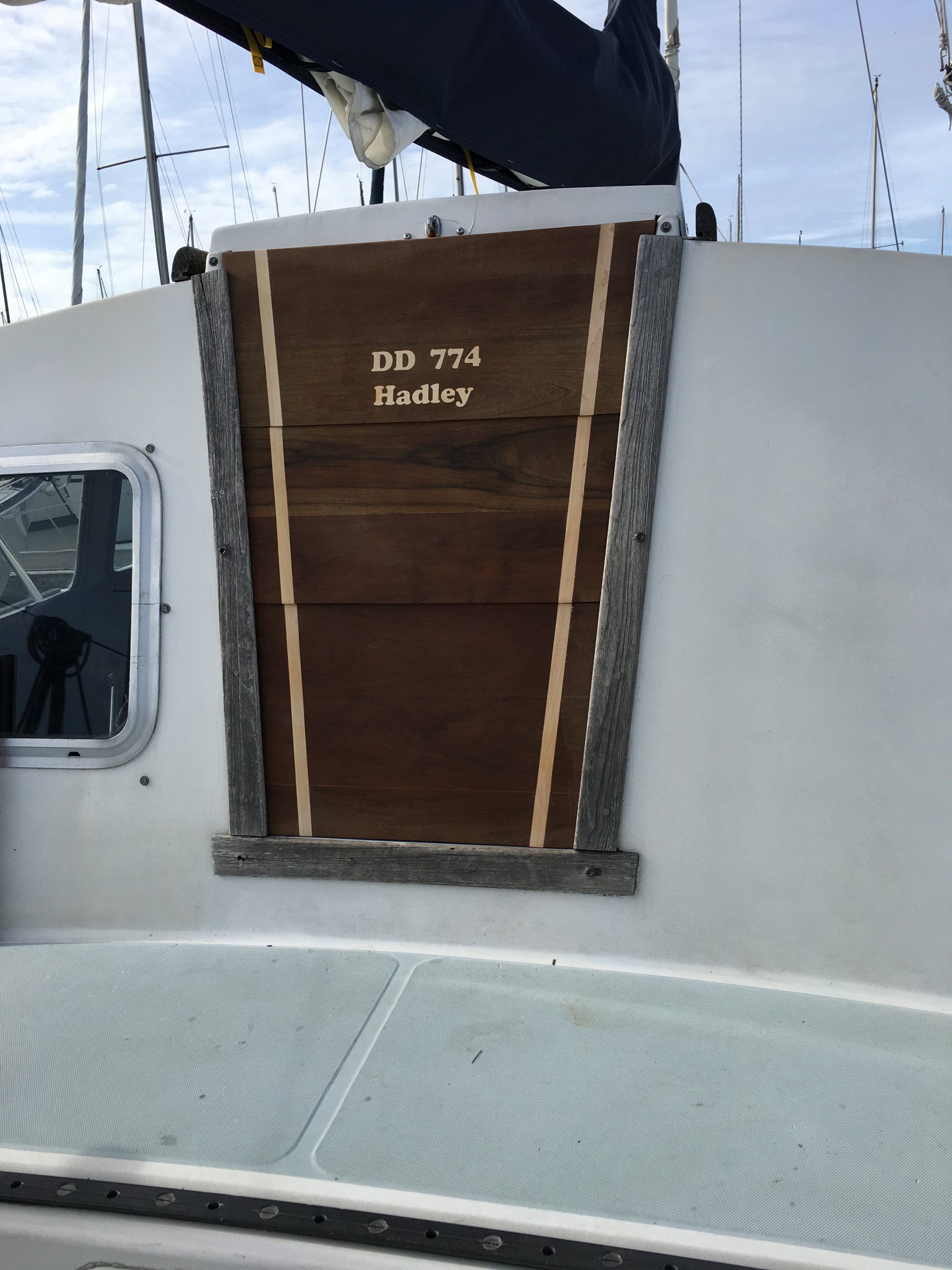

Les made these beautiful boards. I am very proud to have them on the S/V Hadley.
The USS Hadley served our nation during battle for Okinawa. The brave sailors aboard the Hadley knew the ship was named after my Granfather, CDR Hugh Hadley. They preformed remarkably during trying times and in the process accomplished historical acts.
Hadley is also the name of my granddaughter.
You history buffs might find the USS Hadley story an interesting study. My Grandfather lost his life aboard the USS Little trying to protect the Marines on Guadalcanal. For his heroic efforts a US Naval ship bore his name.
